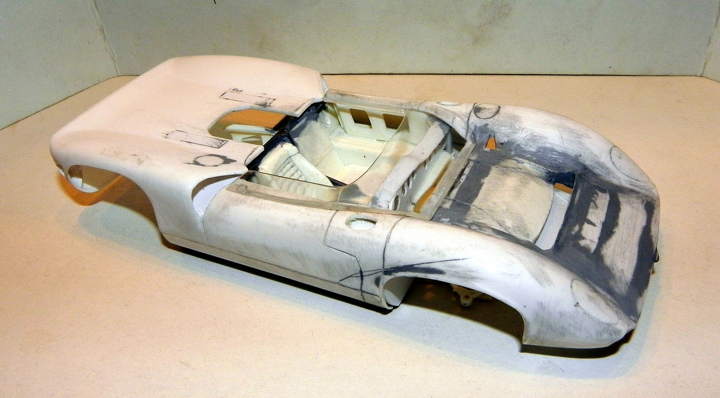

Phildaupho Posted August 10, 2016 Author Share Posted August 10, 2016 Thanks everyone or the encouragement. I have started the project by removing cast in areas of the body that obviously need to be altered. Definitely a major part of the project will be the required body modifications. Quote Link to comment Share on other sites More sharing options...
Phildaupho Posted August 11, 2016 Author Share Posted August 11, 2016 Yup! I'm joining the crowd too! Now, I learned something interesting by checking out this thread. I didn't know that the Ford GT-40 evolved from Lola Mk6 Coupe. I never would have guessed that! I too have the huge 1/12 scale Tamiya kit of the Lola............heaven knows if I'll ever get to that one!I see you're using Harold's engine kit for this one-------can't go wrong with that! Harold is one of the best resin guys out there and a really nice guy to boot! I've known him for years, and he certainly sweats the details in all of his items.The great thing about this forum is that there are people out there who can give advice. It has been pointed out to me that the Lola T70 used a Hewland transaxle rather than the Coletti which is part of Harold's Ford GT40 engine kit and advised that I should look at the correct Hewland in the MPC Eagle Indy car which I fortunately have a couple in my closet. Quote Link to comment Share on other sites More sharing options...
Phildaupho Posted August 11, 2016 Author Share Posted August 11, 2016 Body/Chassis/Engine progress Body – so far have enlarged the cockpit opening, molded in new front vent based on GT40 part, added inner material to rear fender top vents, added nose beak. Chassis – trimmed various parts of chassis structures to fit under body work, widened chassis floor to meet body, trimmed seats to leave only right seat, filled area under missing left seat, removed dash area from front bulkhead in preparation for new dash and bulkhead cross member Engine – now using MPC Eagle engine, correct Hewland transaxle, rear suspension and cross member Quote Link to comment Share on other sites More sharing options...

Phildaupho Posted August 25, 2016 Author Share Posted August 25, 2016 More bodywork creating fuel filler location, rear fender vents and front body suspension adjusting holes. Even during 1966 the car ran in many different configurations of vents, ducting and even engine induction. My version is largely based on how the restored car looked in photos I took in 2010 although the model will have the correct early Weber carbureted Gurney Weslake Ford. The real car has numerous separate body panels but I have chosen for strength and integrity to eventually only separate the rear body work although the entire front section will be removable as a single assembly. In regard to the tub I have widened the side tanks to fit the body and enclosed the sides. I re-fabricated the front bulkhead and dash area. The rear bulkhead has been given some shape with the roll bar assembly coming next. Quote Link to comment Share on other sites More sharing options...
Phildaupho Posted August 27, 2016 Author Share Posted August 27, 2016 I have been on a bit of a roll with this project and wanted to get a few modifications done before other things got in the way. In the last couple of days I have finalized the shape of the rear bulkhead, established the roll bar location, separated the rear body section from the rest of the body and mocked up the front and rear spoilers, which are made from baking, pan aluminum. In front I attached a mounting lip to the body while in back I cut a slot into the body. Quote Link to comment Share on other sites More sharing options...

Phildaupho Posted August 28, 2016 Author Share Posted August 28, 2016 Coming along very nicely, Phil!Thanks Steve - I am now at a point where I realise I am going to have to virtually complete the engine-transaxle-rear suspension assembly as virtually a complete and separate model to establish its location and attachment within the tub as well as the shape of the cut-outs above on the engine cover and the NACA duct behind it and the opening under the engine in the tub. Quote Link to comment Share on other sites More sharing options...

Phildaupho Posted September 22, 2016 Author Share Posted September 22, 2016 Since the last update I have made numerous modifications to the rear of the Lola after studying many Internet images. The area of the tub/chassis surrounding the engine has received additional structure and detail, which is evident by comparing it to the box-stock GT40 tub/chassis. The engine cover/rear bodywork now has a NACA scoop behind the cut out for the carburetors and I added slight flares to the tops of the wheel wheels. The area under the engine has been opened up and slots have been established in the bottom of the tub for the lower suspension struts. Changes made to the front body since the previous update are not as apparent. The tops of both doors have been extended inwards and the left side door now has inner structure. On the bottom side I filled some of the areas left open on the slot-car body. The model is now getting to the stage that I can start focusing more on the engine and suspension. Quote Link to comment Share on other sites More sharing options...
