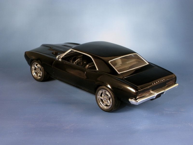

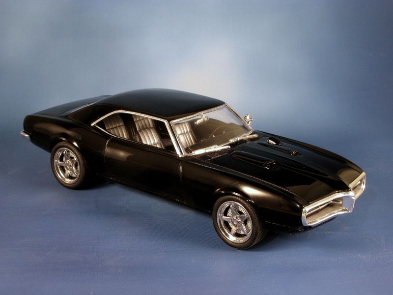

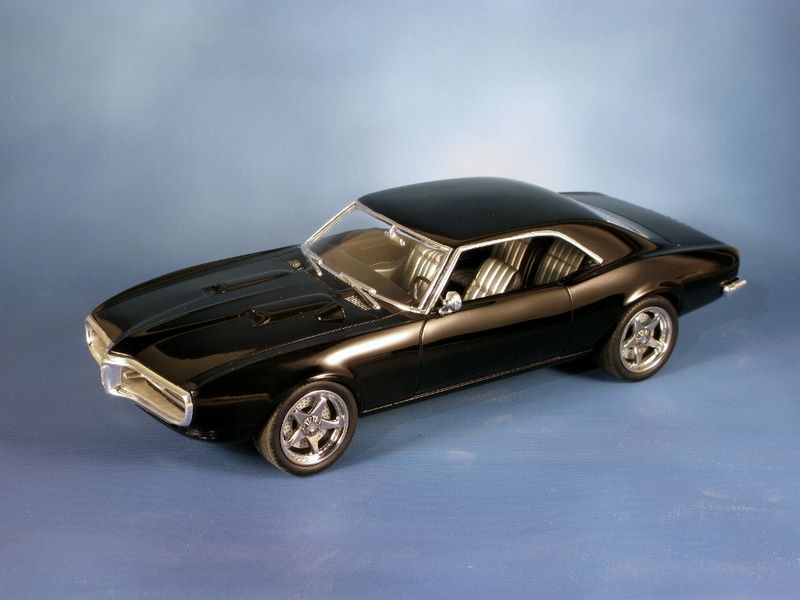

Here's my latest one. Started with the Chip Foose version and added a few tweaks. Hid the headlights and removed the three accent lines on the quarter panels.
I also challenged myself on the black paint as a learning process. It's got a few quirks but overall it's not bad but I know where the defects are.

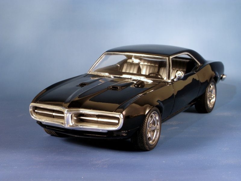

Glad you like the look. I always like the front end of the chargers and though what if the firebird had hideaway's.

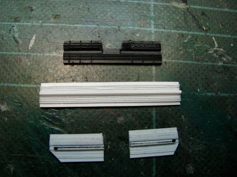

So I cut out the headlights to were that middle chrome bar ends, smoothed the grille out and made two extensions that would pick up where that bar left off.
At firts I though I could scribe the grille lines in some evergreen but that gave me a rough look. (see bottom of the picture)
So I redid it by stacking some evergreen strips. (Middle) I think I uses .40x.40 for the middle bar and alternated .10x.20 and .10x.30 on eache side of the bar.
Don't quote me on the sizes I tend to use what looks good to the eye but that should get you in the ballpark.
That looked better.
Pictures do it better justice, I couldn't get as level paint on the hood and there are some pinholes where I filled in the accent lines on the quarter panel.
But I try to learn a little something with every model and this one was painting black. Plus it was fun.
And you are right Firebirds do look killer in black.

Love a black 1st Gen Firebird!.
Really like that front end treatment too. Looks like the custom front end AMT put on thier "Quarter Masters" custom Firebird that came with a drag boat.
Nice kit never know about it but I guess great minds think alike...  :)
