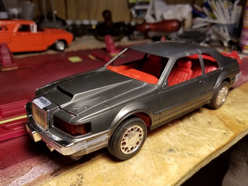

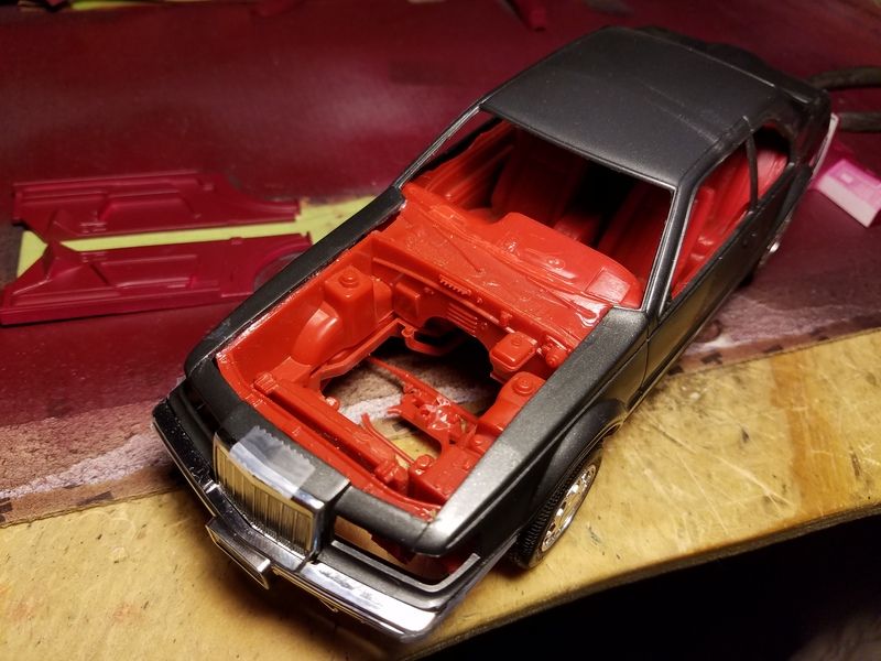

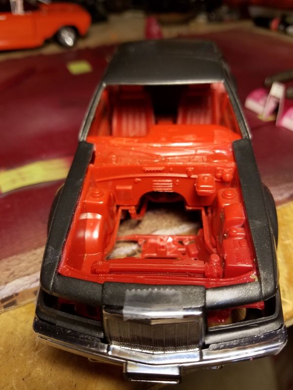

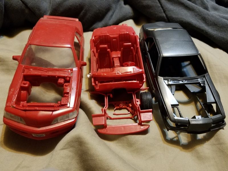

Yep, you heard me correctly, stock chassis. Not Pro Street. Car won't be stock, but the chassis of the car will be. I always loved the Revell Lincoln Pro Street kit. I finally got one to build up recently but I always thought about trying to turn it back into a stock chassis'd street car. Well, I went to a swap over the weekend and found the Lincoln Mark VII as a parts kit, and it was missing a lot of stuff but enough to do what I wanted to do with it. I also came across a glue bomb Revell Thunderbird Turbo Coupe as well. So I got them both. Got them home, and the hacking began.
I scribed the sides of the Thunderbird engine bay until it popped out, and did the same with the Lincoln. I had to do a slight bit of sanding on the sides of the Tbird bay and it fit the Lincoln pretty well. And after a little bit of super glue it stayed in place. The interior will be modifed once I am at that point. I will be cutting out the sides and using the Mark VII door panels and dash. The seats and console will stay the same. The hood will be modified to be flat like a stock Mark VII.

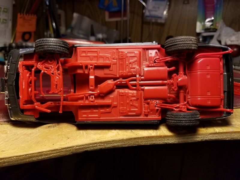

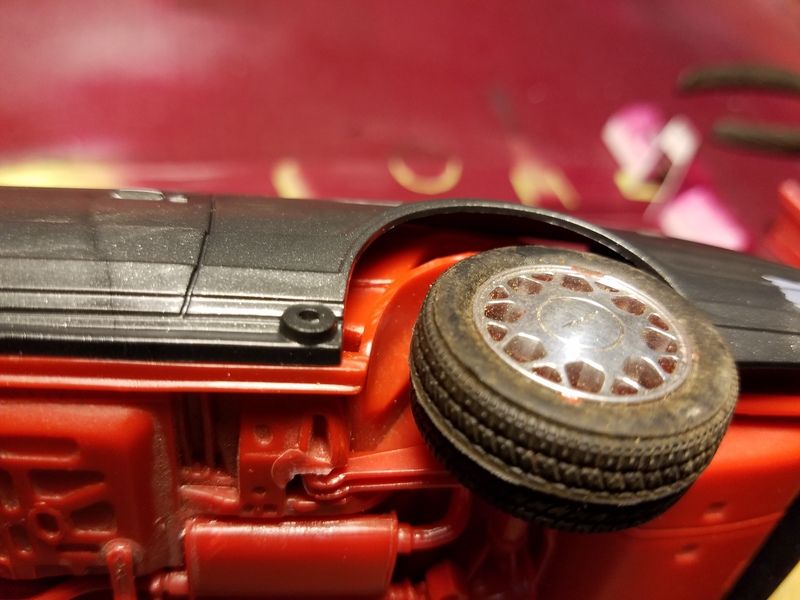

Other challenges I have ahead of me are a slight wheelbase issue. The front needs centered a little better, and the rear needs moved forward a lot. I think a slice from the chassis and a slice out of the interior tub will let the chassis move forward enough to put the wheels where they need to be.
So here is where I am so far.
Plans for the car are some Mustang Pony wheels from the 1/24 Revell/Monogram convertible. A 302 and 5 speed also from the 1/24 Revell/Monogram Mustangs. Then perhaps the supercharger setup from the Revell Saleen Mustang speedster.

Nice start.  Like the idea of doing it as a stock chassis.  Unfortnately to get the Licoln body to fit  the Dobbertein chassis they did some skicing and dicing. So if would take a lot to get the body back to stock.
Share this post
Link to post
I did check out some pictures in comparison and the rear wheel openings are definitely moved forward a couple inches. I MIGHT move them back a little. I haven't decided. I didn't want to cut up the body on this thing but I still might.
Share this post
Link to post
It's not just the wheel wells moved forward, the whole body is shortened in the 1/4 panel/C pillar area. Correcting that is a bunch of work. There used to be a resin corrected body available a while back, and it was done pretty well.
Share this post
Link to post
Mike echoes what I'd like to mention about the Lincoln body. You'd have to make some kind of "Z" cut just in front of the leading edge of the rear wheelwells, and then slice rearward to the trunk area. IMO, and this is just me, I think the C pillar itself is fine. It's the trunk and quarters (between the doors and rear wheelwells) that would need to be stretched just a bit.

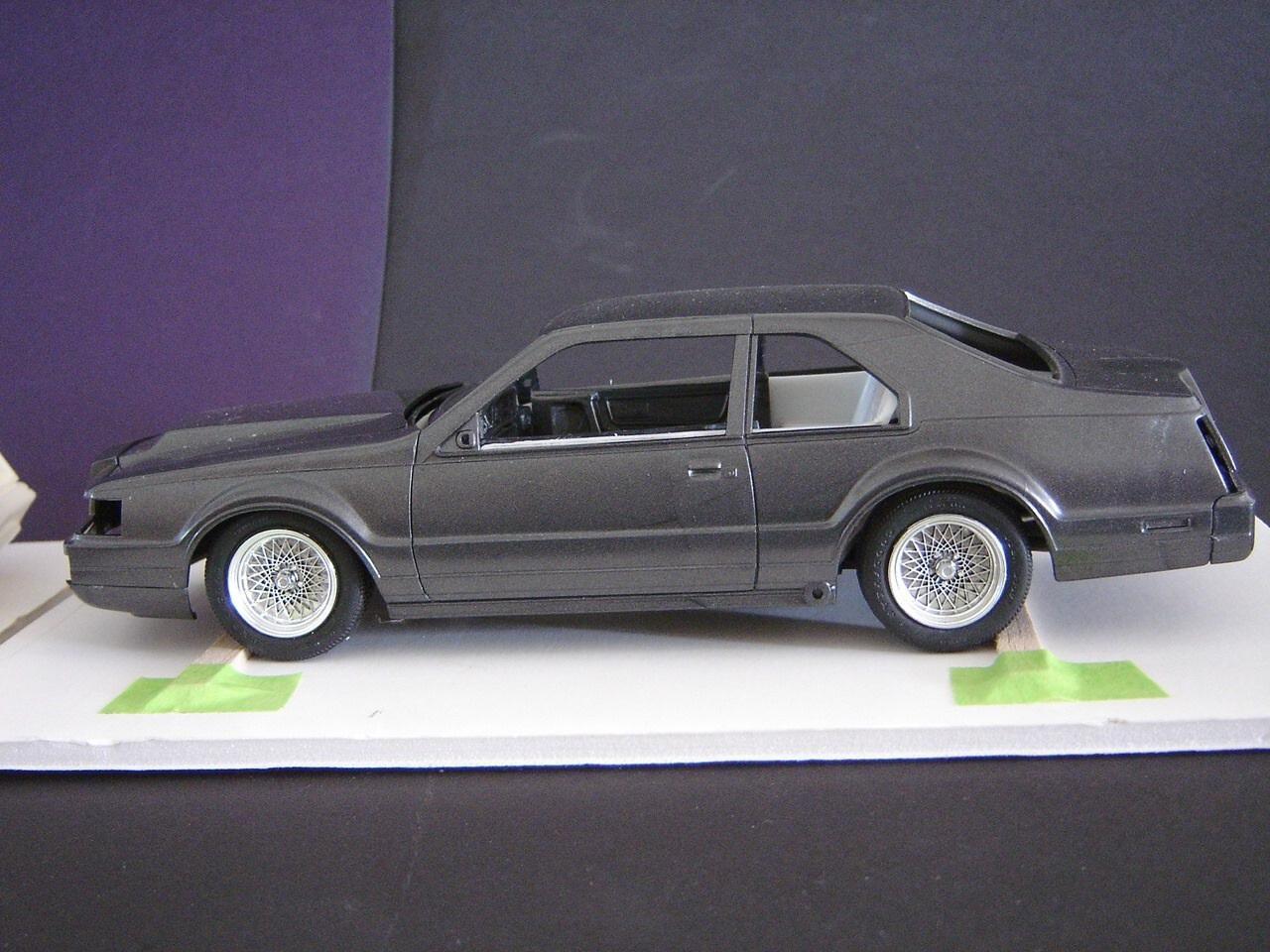

I am doing something similar with my Lincoln, but go in another way in the chassis, I know it will not be correct/factory stock but since I wanted a street/performace/custom Lincoln I used the mid/late 1980's Mustang chassis/interior, it almost fit perfectly, some cuts here and there in thei interiors, used the Buick Grand National "BBS style" wheels and tires,  here is an old photo of this project, that is still pending to be finished...some day!!

Oh man!! I love it!! I was wanting to go with the same wheels but I couldn't remember what kit had them! Thanks for the tip. hopefully you don't mind me using the same idea.
I really like the stance of yours as well. Once I get the wheelbase figured out and the chassis sorted out, I wanted mien to sit like that but a little lower out back. I am also going for the street performance car look.

How does the chassis/ engine bay from the revell lx notch fit under there? That's what I would use
Share this post
Link to post
I haven't tried it. But I would imagine it would be pretty close. I used the Tbird engine bay because it has the area below the windshield that the Mark also has, and in greater detail. But the engine bay itself would be nice from the Mustang. I will pull it out of the box and take a look sometime this weekend.
