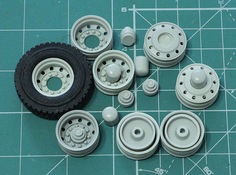

Awesome job Sergey!! Very proud to see the wheels and hubs I mastered, on it! (Everything in the pic was mastered by me except the tire.)
