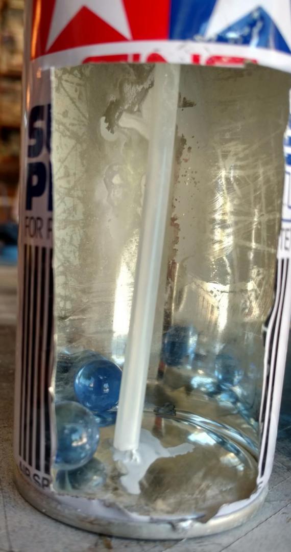

Inside of a Tamiya rattle can(photo)
I was decanting Tamiya primer yesterday and thought this would be of interest to some of you.  This is what you see if you open up a rattle can of paint and it makes it easier to explain a couple  of tips I give out from time to time.  In this picture you see two main items, the dip tube and the glass mixing marbles.  You can also clearly see the domed bottom.  First thing you may notice is that the dip tube does not go all the way to the bottom.  There fore you will never get all the paint out of the can by spraying it.  You are always going to leave some wasted paint behind.  This is one of the main reasons I decant the paint to begin with.  I am thrifty and want to use all the product I paid for.
Second tip is to store the can upside down.  As most of you know, if paint sits for a while, it separates into components  and settles out, with the solids going to the bottom and the solvents and binders going to the top.  If the can sits upright a couple of things happen.  First is that the dip tube opening is down in the thicker solids and some of them will migrate into the tube. No matter how much you shake the can they will still be in there.  Then with the first bit of spraying you will get a thick blob out.  By storing the cans upside down the dip tube in not sitting in the solids and you avoid that.  It is also possible that the solids may block the tube and you will have an unusable can.  The second thing to notice is that the dip tube location interferes with the circulation of the mixing marbles.  By storing it upside down all the paint, solids and marbles will be in the rounder top part of the can and mixing by swirling the can will be much smoother and you are less likely to get more propellant mixed into the paint. I hope this helps some of you.

      Yes, those are very nice marbles that they use.
Only the best put into those cans!!  LOL!!

Russ, decanting can be spraying the paint through a straw or other device.  There are other ways to get it out and I am sure someone will gladly explain them.
My way is a little different and I think much safer but you need someone who can do some machine work.  I made a tool that works like a saddle valve.  With that tool I can safely punch a small hole near the top of the can and slowly release the propellant.    After depressurizing the can in this fashion, I let the can sit over night to let the paint off gas all the propellant.  When that is done,  I move the tool down to the bottom and punch another hole as close to the bottom seam as possible.  I then use that hole to pour all the contents into the paint bottle I am going to store it in. After that I use a plastic pipette to add some thinner to the can and hold my fingers over the holes and shake it to get the last of the paint out.
The large square hole you see in the can was done after I had completed the process.  I open the can this way so I can save the glass balls and add them to the decanted paint to aid in mixing

Thanks.
Yep, I have only seen the through the straw method before.
the kid left in me (I'm 57) wants the marbles from the cans. :D

I agree with the basic use of the rattle cans.  I use them frequently, but there are times when only an airbrush will do or there is another reason to decant the paint.  This was such a case.  I generally just spray primer from the can and then dump the little remaining at the end of the can into a bottle to save it.  However, this time I needed to tint the primer blue.  I won't go into the reasons here as that is another thread but as far as I know there isn't any way to tint paint still in the can.  I don't suggest that there is a "right" way and a "wrong" way.  I do the things I do because it works for me.  I always like to hear other options because I have discarded a lot of the ways I use to do it, because someone had a better idea.  In the battle of rattle can v airbrush I would say this.  An airbrush can do anything a rattle can is able to do, but a rattle can can't do everything a airbrush can.

Yup, that is the reason.  Tamiya paints are synthetic lacquers and I won't even go into how those are much better paints for spraying through an airbrush.  Yes, I use to be able to get lacquers down at my local automotive paint store and I still have some quarts left that will last me the rest of my life.  Automotive lacquers thin down at a rate of 4 or 6 to one thinner to paint.  Unfortunately, here is the Peoples Republic of California, you can not buy either auto grade lacquer or even lacquer thinner any more and it has been a long time since they ban it.  You would not believe the goat rope I went through to get a gallon of the real deal thinner and the darned stuff is made just a 10 minute drive from here.  I had to order it shipped to a friend out of state and they turned it around and shipped it back to me.  So now I have a couple of years of thinner.
At any rate, rattle cans are the only source here and that requires decanting.
