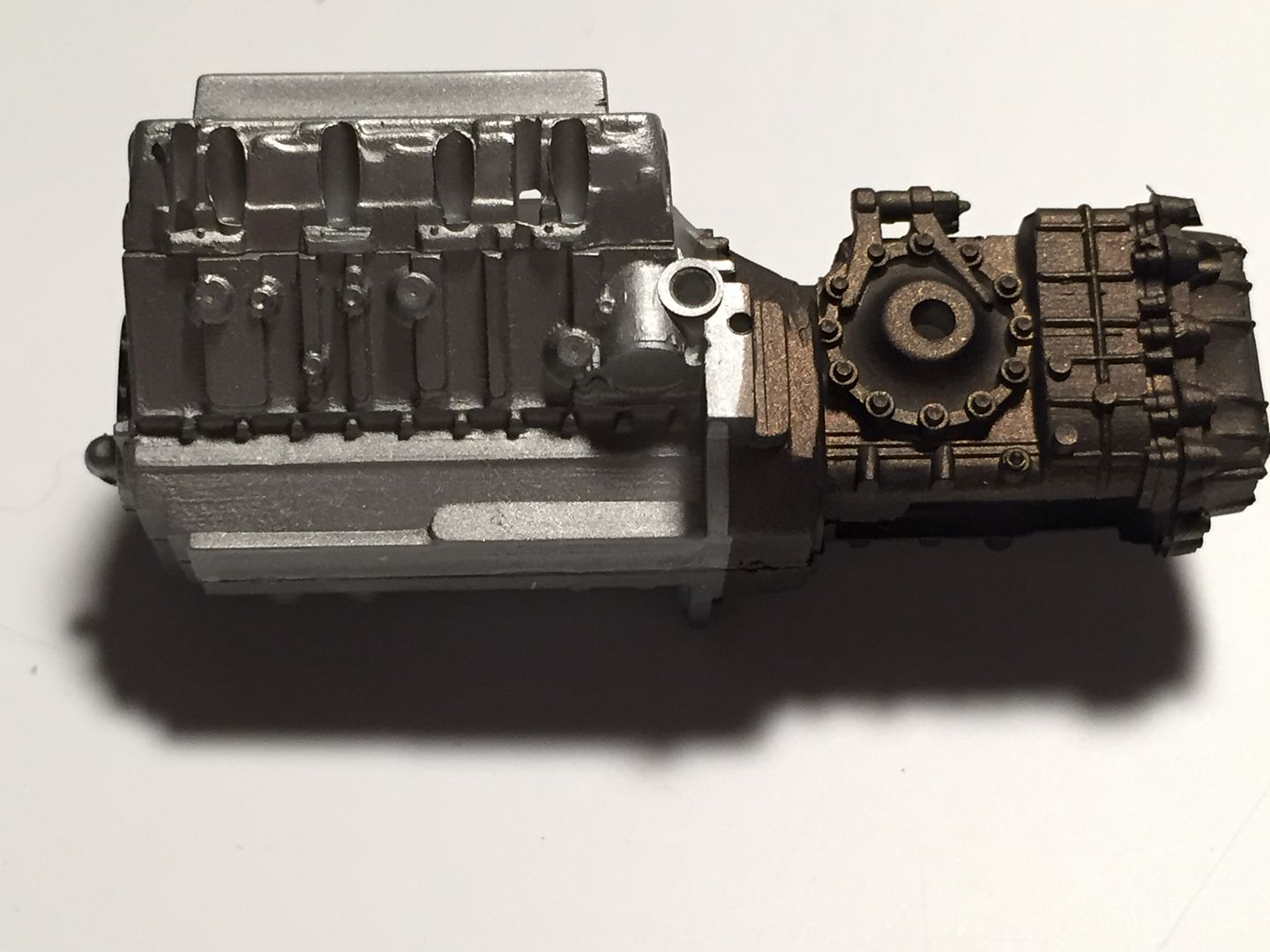

JLewis Posted August 31, 2016 Author Share Posted August 31, 2016 Thanks for the welcome and encouragement. There is no turning back now, paint has been spilled! (Figuratively speaking). Not much to show, I know, but I have been trying to put in some homework before making the big jump into really making a mess of things. I do plan to replace all the vinyl hoses with my own versions, but I guess the frugal Yankee in me is reluctant to spend two or three dollars for each hose assembly. We will see if I can concoct my own suitable replacements for a more modest investment. Some expirementation is necessary. That is what makes this fun, trying to create detail from different sources. Thanks for looking and have a great night! Quote Link to comment Share on other sites More sharing options...

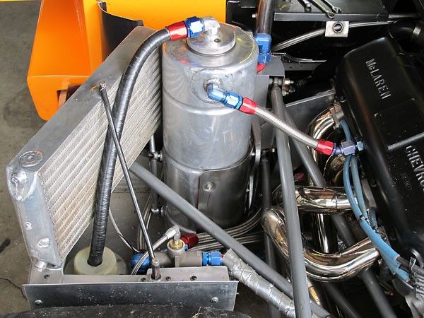

Crazy Ed Posted August 31, 2016 Share Posted August 31, 2016 Being a CanAm Fan from back when, I'll be following this. A little suggestion James, take black wire who's insulation fits the size of the Oil Lines and gently pull it through 600 or so sandpaper it'll break the gloss so it looks like period Oil Lines with the plus that it'll stay where you want it. Quote Link to comment Share on other sites More sharing options...
JLewis Posted August 31, 2016 Author Share Posted August 31, 2016 Thanks CrazyEd for the tip. Were the period oil line styles braided hose? All the pictures I have found use braided: I like your idea. I will have to try it when I get home. There are a lot of hoses on this beast. I want to find a way to make a good facsimile without spending hours on each one. It is interesting how hard it is to adopt a different approach and slow down, treat each piece as a jewel in itself. I find I enjoy the research and testing of different scratch-building ideas much more when I give myself permission to take the time to experiment with different materials. I hope that tonight I can get some more picture-worthy work done. Quote Link to comment Share on other sites More sharing options...

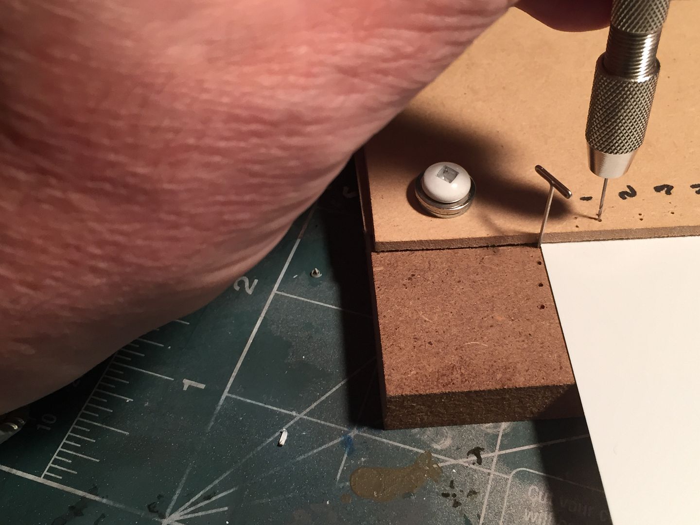

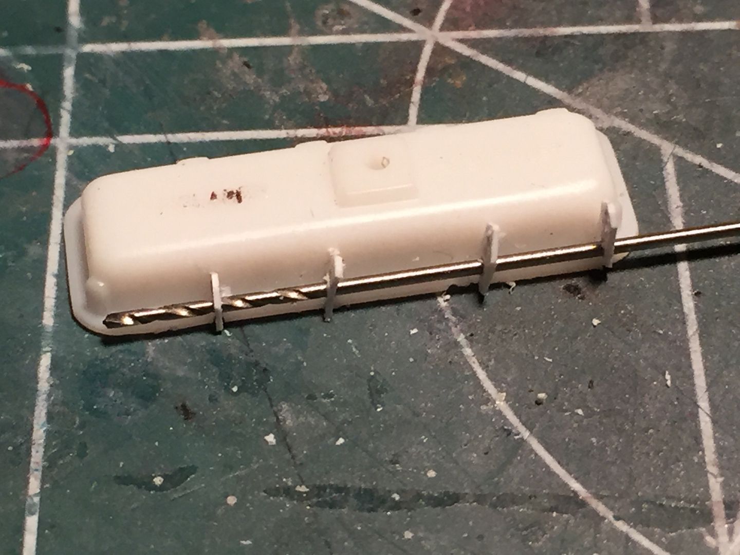

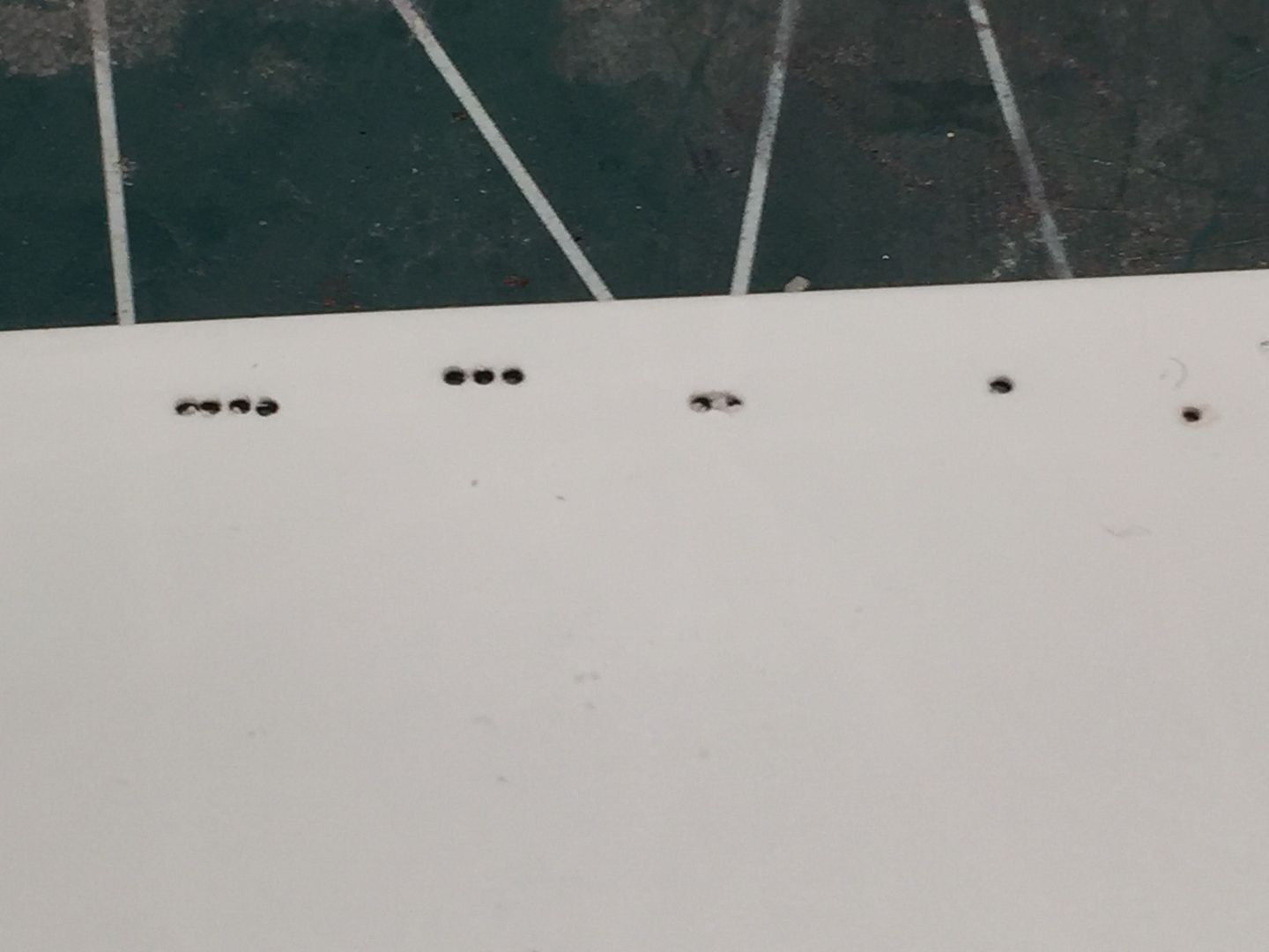

JLewis Posted September 1, 2016 Author Share Posted September 1, 2016 So, tonight some fun. All of the images I see of the real thing have plug wire looms and long protective boots where the plug wires go down between the exhaust pipes. First I built a jig to enable me to make evenly spaced holes for wire looms. The jig lets you move a stop pin through each of four holes and you can drill sets of holes. When you get done you have a four, three, two and one hole set in .010 styrene. I then cut out each one leaving a little tail on each one, like an L shape.Now I measured the spacing on the valve covers and cut little slots at each loom spot. Quote Link to comment Share on other sites More sharing options...

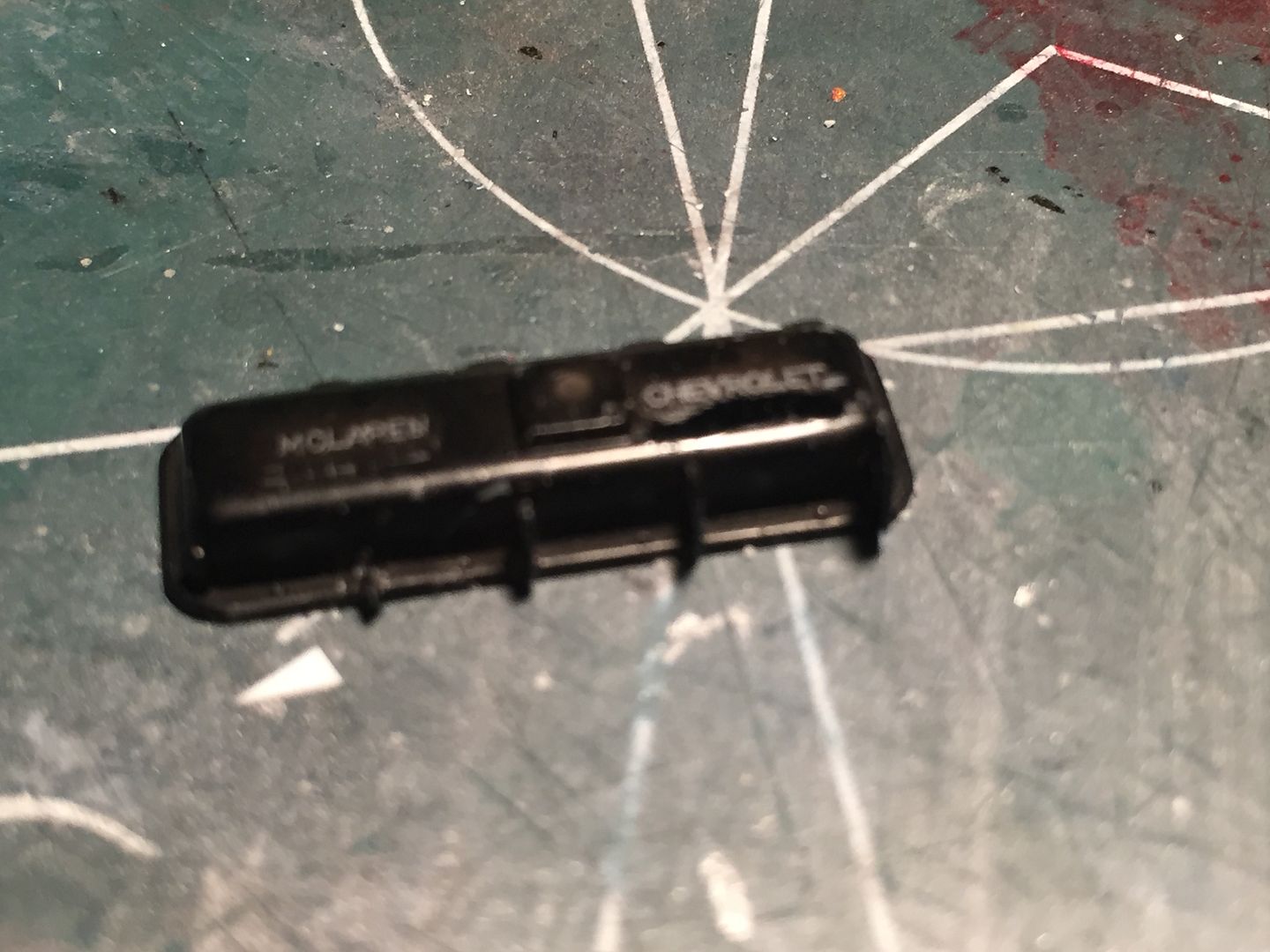

JLewis Posted September 1, 2016 Author Share Posted September 1, 2016 I use a jeweler so saw to cut a thin slot to position the loom pieces in next I put the loom pieces into the slots in the valve cover and use a drill bit to line them up glue them up and send them to paint Quote Link to comment Share on other sites More sharing options...

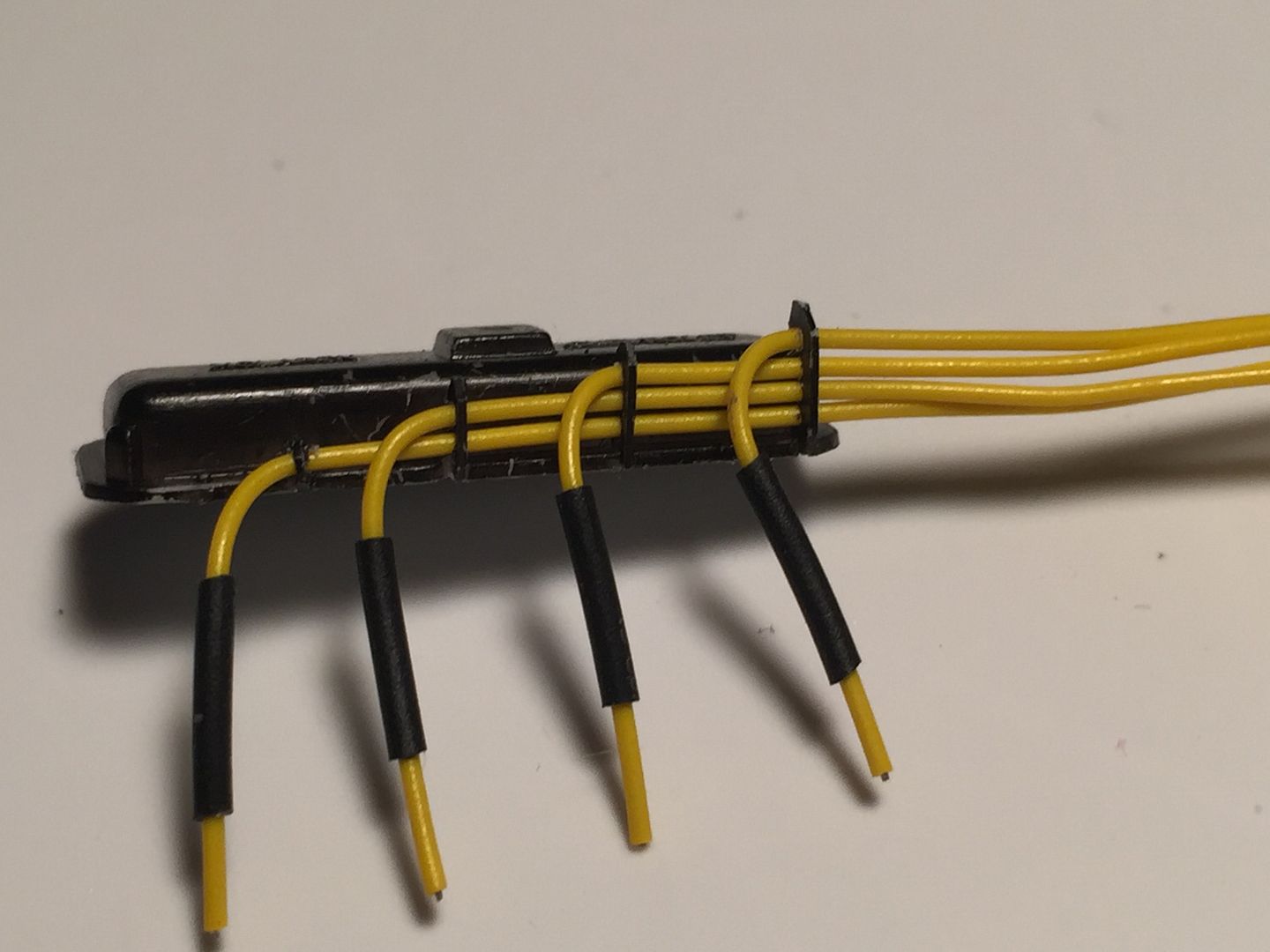

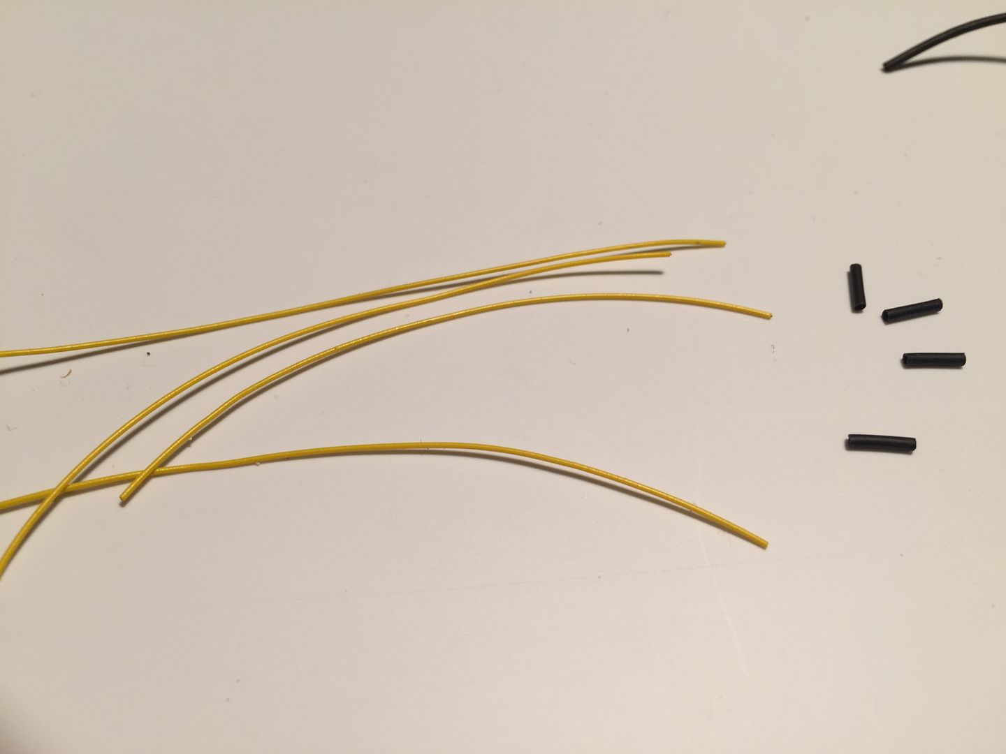

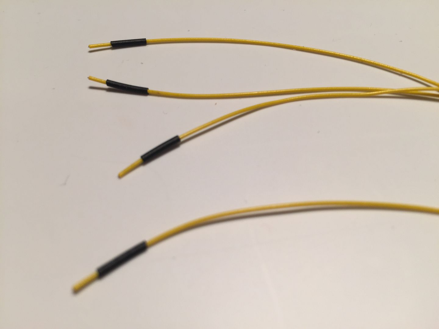

JLewis Posted September 1, 2016 Author Share Posted September 1, 2016 Now for plug wires. I found an electronic distributor that sells the exact wire that the aftermarket charges about two dollars a foot. I got ten pieces, each ten feet long in ten different colors. That's 100 feet for $5.65 including shipping. Probably enough to last the rest of my life. I also have been playing around with heat shrink tubing. I found some that was .61 mm with a two to one shrink ratio. That means it will shrink to about .30 mm which is just about 3/8 inch in scale. I cut four pieces and shrunk them in the plug wires. Quote Link to comment Share on other sites More sharing options...

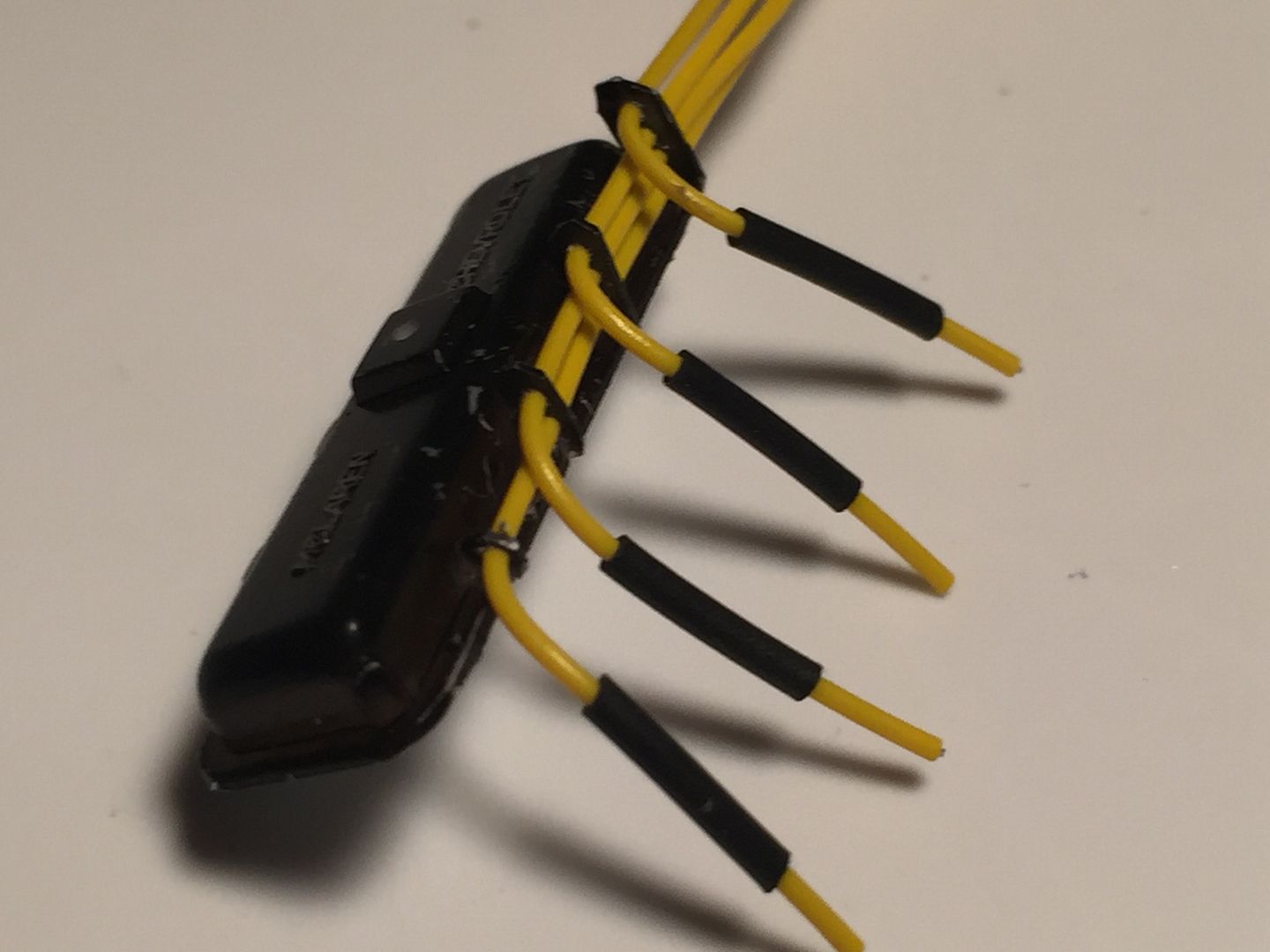

JLewis Posted September 1, 2016 Author Share Posted September 1, 2016 Last, I threaded th wires through the looms and all I have to do is drill plug holes for the yellow ends to go in and we have some pretty neat plug wires. i used this this method on a Corvette engine to do both the plug ends and distributor cap. I had always disliked distributors with the wires all just shooting out the top in a big bundle. I wanted a cap with proper boots. Here is the result of that Quote Link to comment Share on other sites More sharing options...

Crazy Ed Posted September 1, 2016 Share Posted September 1, 2016 Thanks CrazyEd for the tip. Were the period oil line styles braided hose? All the pictures I have found use braided: Hope sometime you'll find it useful. Depended on the Team. McLaren, Chaparral, Gurney etc yep A&N Fittings with Braided lines. But if you were one of the Many low bucks folks, barbed fittings, Rubber tubing and Hose Clamps were not a rare sight. That's a really slick wiring method you have there! Did you work in Electronics? Your setup reminds me of a Wiring Harness Board, just LOTS Smaller. Quote Link to comment Share on other sites More sharing options...

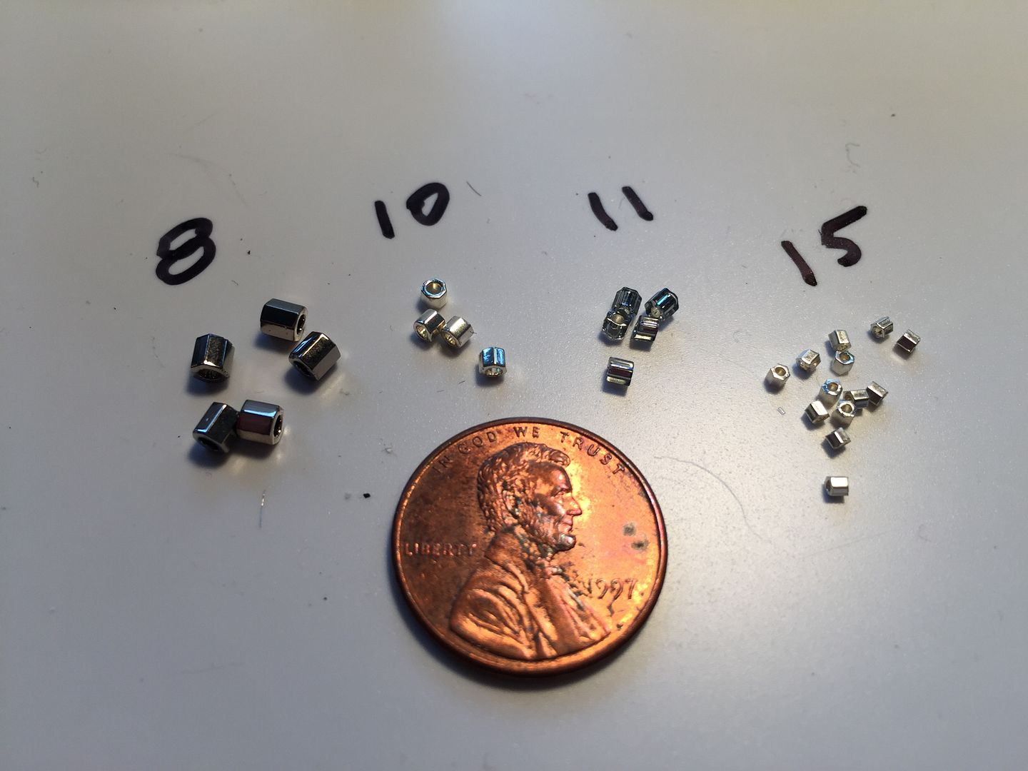

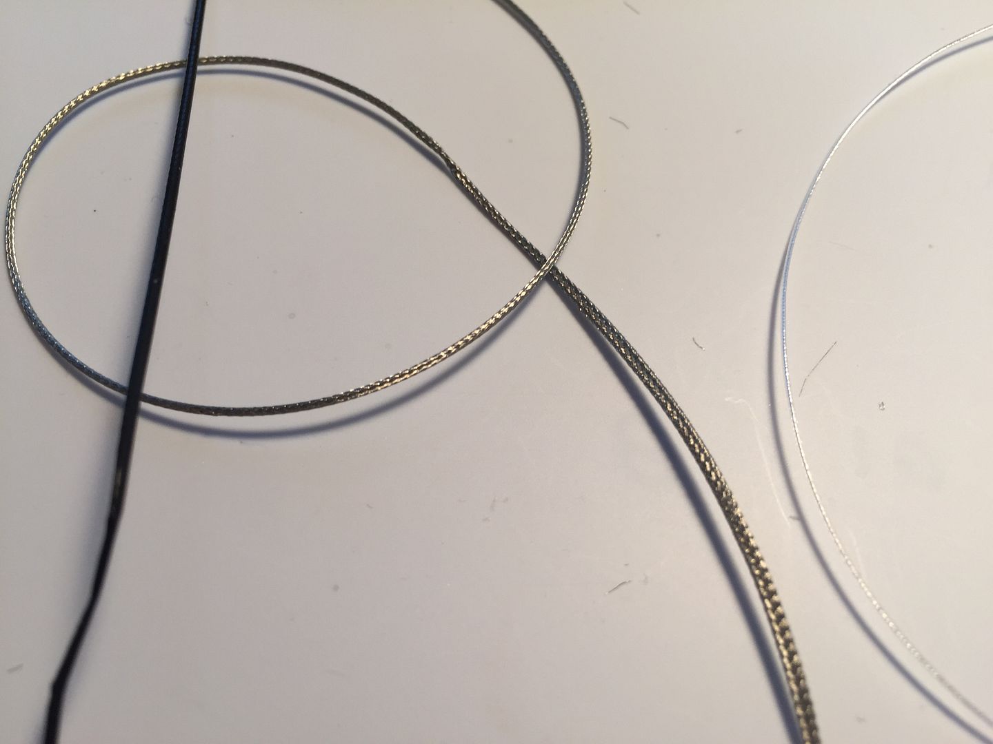

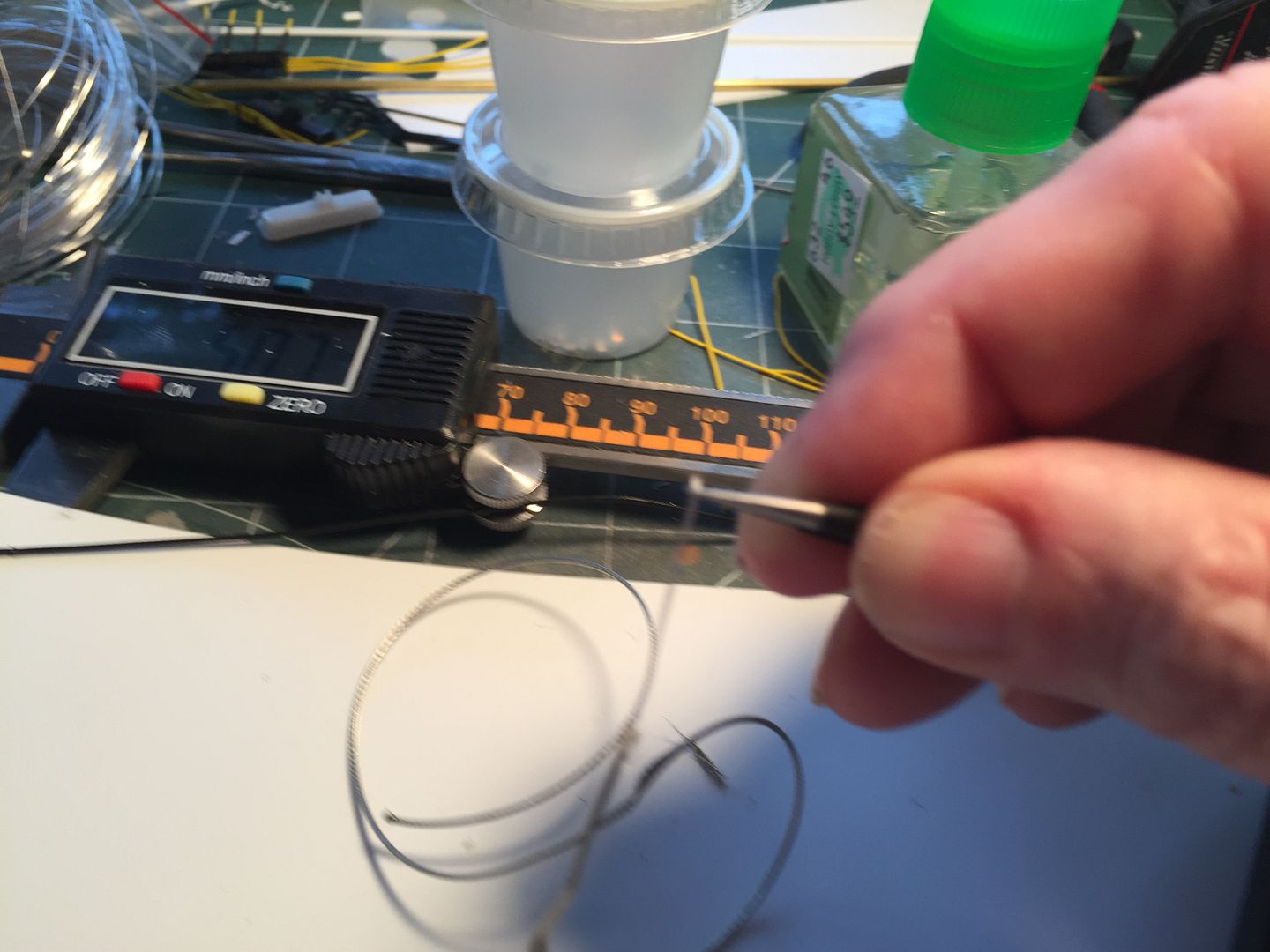

JLewis Posted September 1, 2016 Author Share Posted September 1, 2016 I am going to take a stab at creating my version of a braided hose. I have been playing around with this idea which is a mixture of other ideas and some fresh ingredients. So here is what I am going to use. First is an assortment of hex beads. I have four sizes that scal from 2.5 inches down to 1.25 inches. I got them in a metallic finish, but there are scads of different colors. Today I am using the number 15, which scales out at 1.25 in real life. This size costs $5.00 for about 1300 beads (they are sold by weight). next I have some coaxial cable. I found some coaxial cable with an outside scale dimension of 3/4 inch. I also have some .4 mm wire and some .60 mm shrink tube. The coaxial cable is currently $.77 for 5 meters or less than a penny an inch. here are the different bead sizes in comparison i take the coaxial cable and slice off a little insulation so I can grab hold of the inner sheath with some pliers. By pulling like you are milking a cow eventually the outer cover will slide off leaving the braid. Quote Link to comment Share on other sites More sharing options...

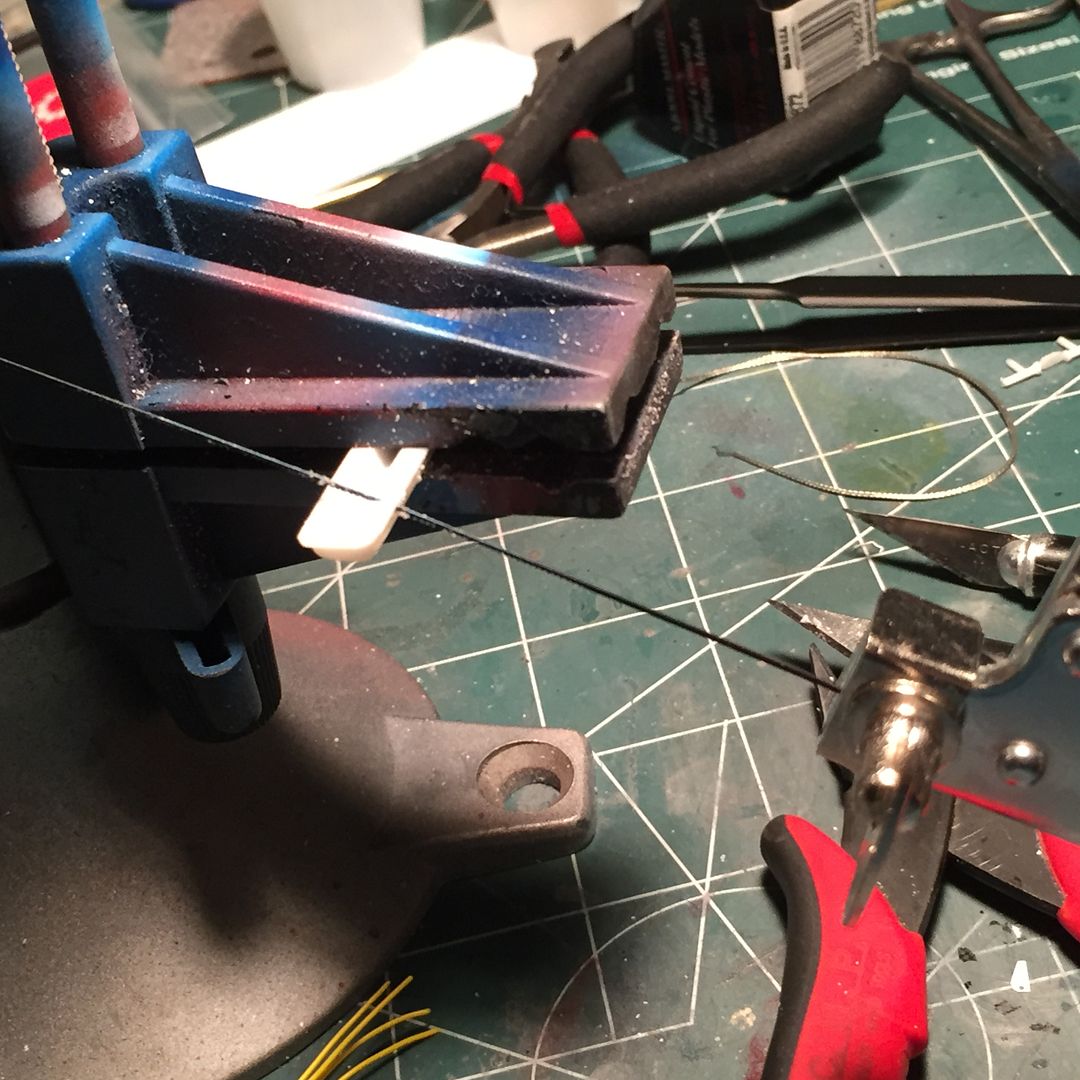

JLewis Posted September 1, 2016 Author Share Posted September 1, 2016 The final thing is to use some tweezers to find the inner core wire and pull it out. Now you have three things. The outer case, the braid, and the inner core. Quote Link to comment Share on other sites More sharing options...
Crazy Ed Posted September 1, 2016 Share Posted September 1, 2016 Hi Jim, is that either RG 178 or 179? Wondering because the OD for them is ~.06" or .07" not 3/4" Quote Link to comment Share on other sites More sharing options...
