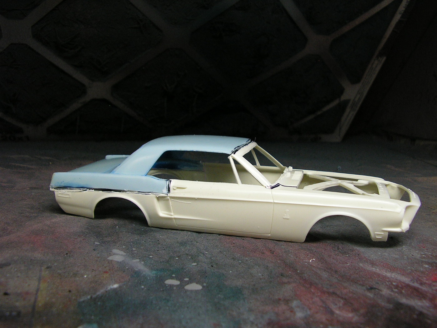

This is the area where builders in the past including myself have made a big error in trying to make a '67-'68 two door hardtop. On the '68 body (white) there's a much taller "hip" area just behind the doors. Correct for a fastback which also had "swoopier" rear fenders to my view and were a bit lower at the very end. One can't just cut off the top on the '66 and plop it on top of the fastback's body. So some slicing and dicing were done on my part..............
 Using my Trumpeter's scribing tool I began to slice along where I made the original line with the magic marker.
It took a bit, but I got the roof, top of the quarters, and rear deck free.
I did the same to the '68's body............
OK! Here's a very preliminary mock-up of what I have so far! Looks MUCH better already then simply sticking the roof on the '68's rear "hips" unchanged.
When it's all said and done, I want my model to look like this one..........
Still MUCH more work to do to fill in the gaps and get everything looking the way it should. This went much easier than I thought as this section is nearly a drop-in to what I cut off. I'll tweak the A pillars somewhat as they're a bit too thick per the 1:1, and of course match up the front header of the '66 roof to better suit the '68 body's windshield frame.

What's nice Mike is that I'm finding out that there aren't any huge differences in the widths of the bodies. Not always the case even with the same manufacturer of what's supposed to be "1/25th" scale. ;)
EDIT: BTW, I originally was going to use the cowl off the '66 and graft it onto the '68's body as the A pillars look better to me on the '66. However, the two aren't quite the same between the model years, so that's why I went with what I did. I'll just refashion the '68's A pillars a bit to look more in scale. I'll also make new vent windows/posts as the ones molded on the '68's body aren't quite right either.

A small tip for you, when I cut seams for joining large parts of a car body I use a Dremel diamond wheel, then I file the joint with a bevel so when you put the two together they fit without hardly a seam. Not criticizing (at all) just trying to help make your life a little easier on the bodywork end.
Ken, I have a Dremel Moto-Tool with the diamond wheel, but I was reluctant to use it due to the width of the wheel itself. I wanted a thinner slice to cut through the plastic as there's those scoop contours behind the trailing edge of the doors. The wheel may have ground into that, and then there's the hassle of trying to get the original contours again. On cars that have flatter panels (and larger scales) yeah, that's a good idea to use it.
The way I did it takes longer, but in the long run I avoid grinding into an unwanted area and of course, I try to use as much plastic as possible to fill in any gaps. I don't want a repeat of what happened to my '55 Ford Victoria using just pure putty. :o
I did use the Dremel to grind away at the inside to separate the body section where I was making the cuts as the plastic is somewhat thick in spots.
Today I managed to get the driver's door cut out, and the Dremel came in handy for that as you can grind away at the shut lines where you're cutting-----makes things go a little faster in popping those panels out. As of now, I'll be building up the door jamb for the door, make a support structure for the door hinges, clean up that side of the bodywork a bit more, and then follow up with the other side.
As I get a sufficient number of pics to post, I'll show more of what's going on. ;)
