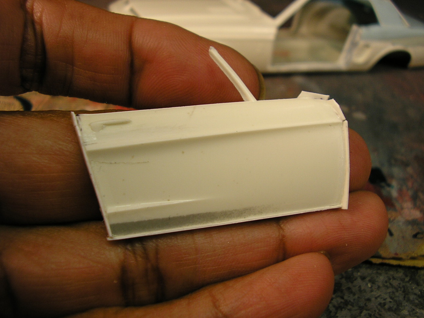

Alright! The door is lookin' pretty good for my satisfaction............
Much better! The shut lines are definitely tighter, and once everything's painted and polished, there should be no scraping of the paint as the doors are opening and closing.
I didn't take a pic of it here, but one method to check for proper shut line thickness is to slip a 3x5 card in and out of the gap. If the card moves in and out without catching/snagging, then you should be good to go as far as paint.

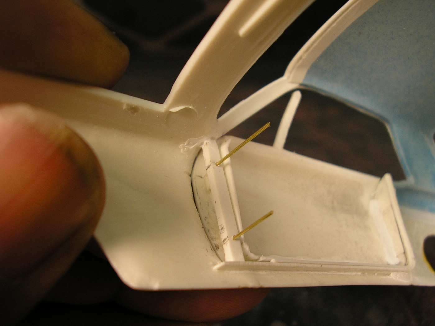

I'm not going to go for super scale accuracy as far as the door hinges. I want something that's going to be sturdy as the door will be opening and closing many, many times once the model is complete, and I take it to shows and whatnot.
I have here some 1/16" plastic rod and some .020 brass rod which will serve as the swivel hinges for the door.
Here's a shot of the door as it sits in the body after all the sanding and fitting.
And here's how the hinge looks once it's inside its support. When it comes to final assembly, I'll simply epoxy the brass rod inside the support, and then cut off the excess length flush with the support when the epoxy is fully dry.
Just checking the fit of the door as it turns inside the fender.........
A shot of the plastic rod glued onto the door jamb. I'll add a little bit of super glue around the hinge retainers on the door which will ensure that they stay put for practically..........well forever! :)
