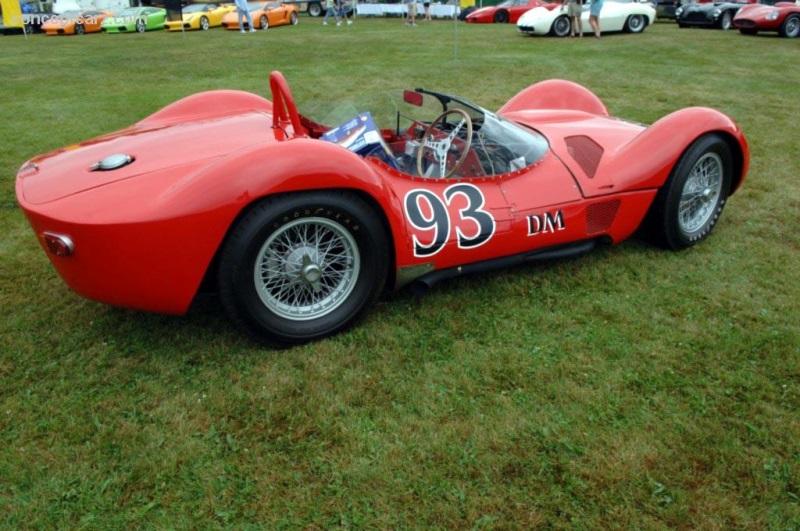

Randy D Posted September 8, 2016 Share Posted September 8, 2016 (edited) Hi Folks, New project, building a 1/24th scale model of what I feel is one of the prettiest cars ever raced. Four cylinder in-line motor rated at 250 h.p. along with an incredibly light chassis topped with ally body work. The famous 'Birdcage' that weighs less than a hundred lbs. A start on the chassis using 'Albion Alloys' nickel silver thin walled tubing. Sizes range from .9mm down to .3mm. I build the base, then using basswood 'scaffolding' erect the rest of it...... I am going to try to build the body from sheet stock that is soldered together. I did some basic metal forming with the wrecker project and enjoyed it and want to see what I can do with this one. I have started some trial runs making fenders, figuring that if I can do those I will move forward with the rest........ Long ways to go but I'm at the bench and having fun! Randy Edited December 18, 2022 by Randy D Quote Link to comment Share on other sites More sharing options...

250 Testa Rossa Posted September 8, 2016 Share Posted September 8, 2016 Which car in particular are you building? Quote Link to comment Share on other sites More sharing options...

Foxer Posted September 8, 2016 Share Posted September 8, 2016 Wow! and a beautiful car to do this on! Quote Link to comment Share on other sites More sharing options...
curt raitz Posted September 8, 2016 Share Posted September 8, 2016 Randy...Birdcage Maserati, you are not afraid of a challenge are you? I'm looking forward to watching you do your wonders Quote Link to comment Share on other sites More sharing options...
