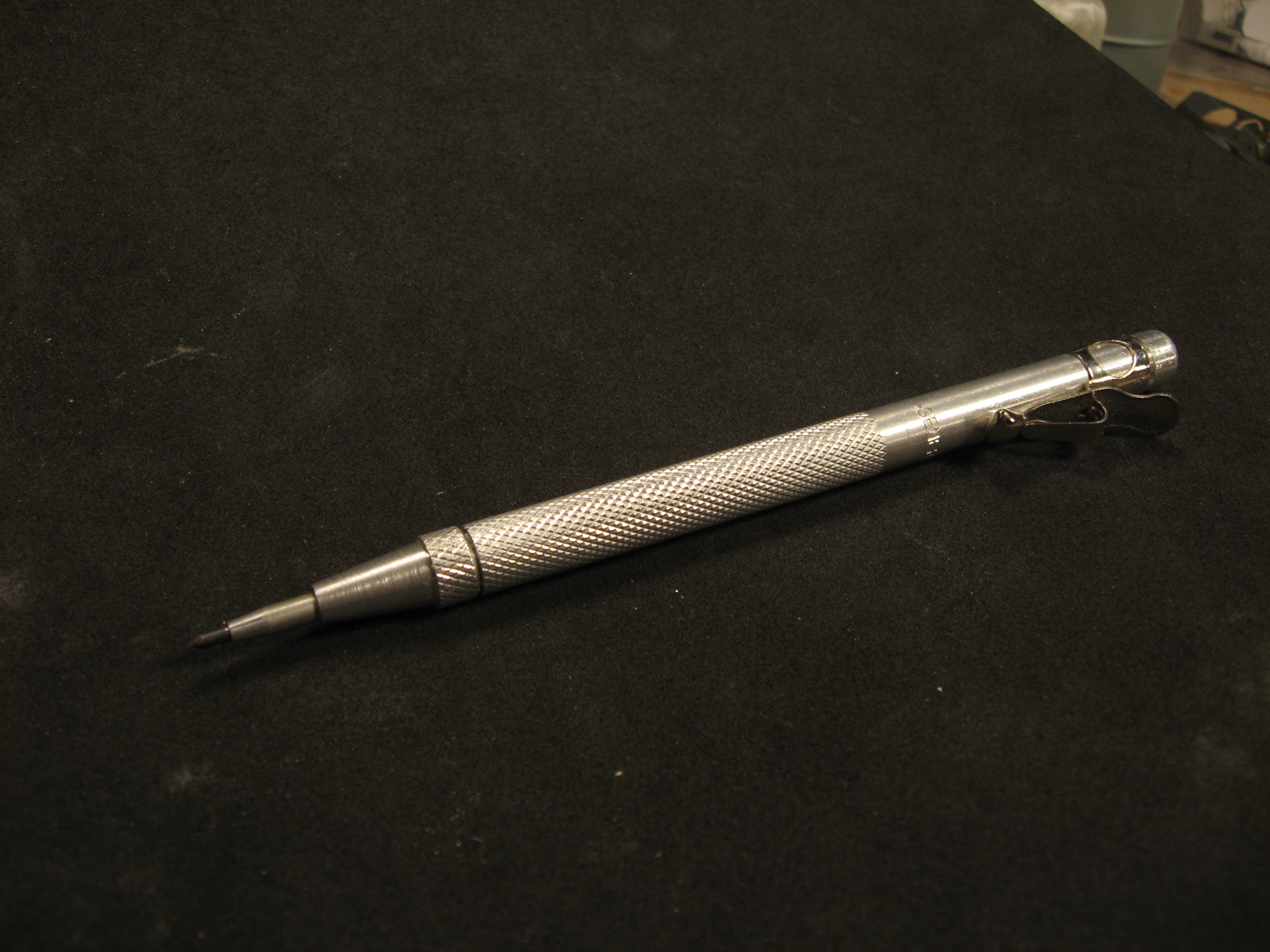

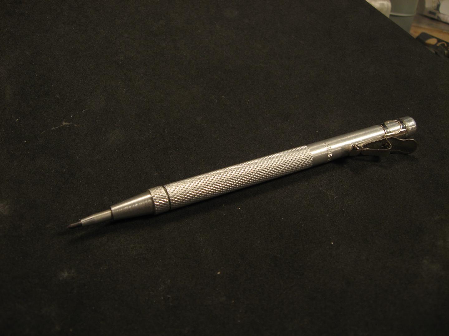

absmiami Posted January 21, 2019 Share Posted January 21, 2019 holy cow .... yeah - I missed this thread too .... questions - the sub-assembly soldering on the de dion tube - are you using different temp solders and/or different settings on your soldering iron ?? did you use the same solder base/platform that you used for frame 1 ?? how are you marking and drilling holes in the brass sheet - as you know - your drill bit will wander every which way unless you've got a sort of divit in the brass sheet to guide the drill bit .... the leaf springs - are they nickel silver or what ?? you still planning to make the bonnet from brass sheet? you're a brave man ... I think you've got this thing figured out - but just in case - I've got the Joel Finn birdcage book if you want to check something ..... Quote Link to comment Share on other sites More sharing options...

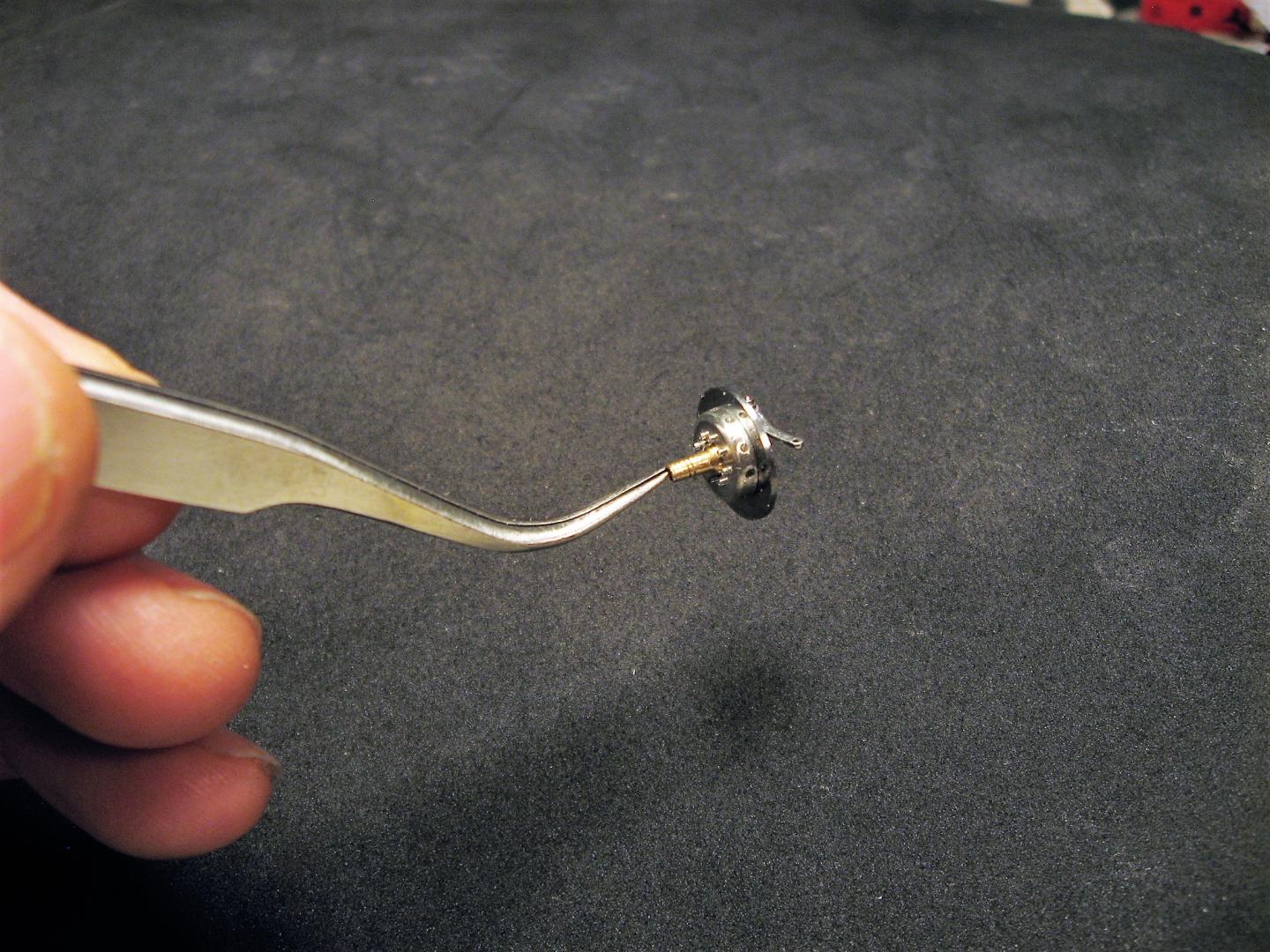

Randy D Posted January 23, 2019 Author Share Posted January 23, 2019 Sonny, Thank you for the kind words. Andy, I did not finish the answer to your question about drilling holes in heavier stock like the four link plates. I use an old glass scriber as a center punch, see attached pic... Randy Quote Link to comment Share on other sites More sharing options...

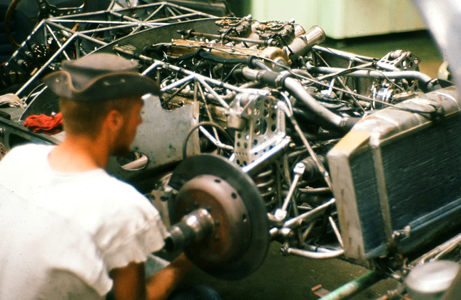

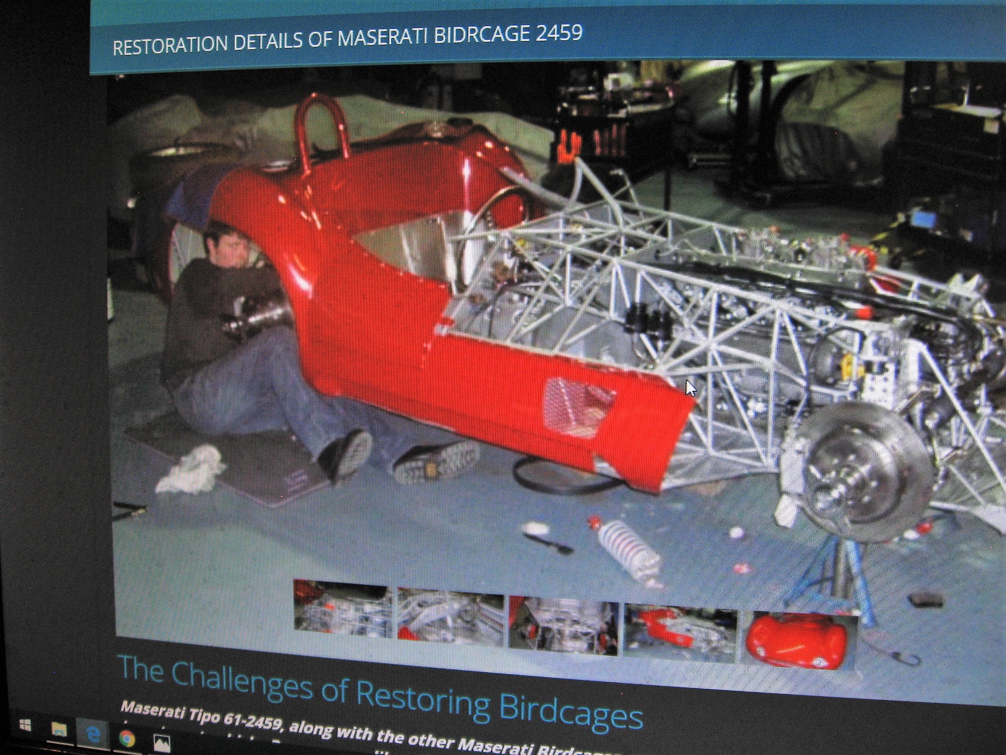

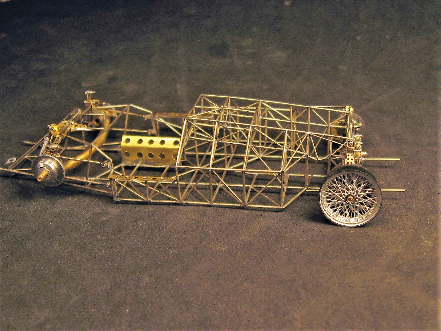

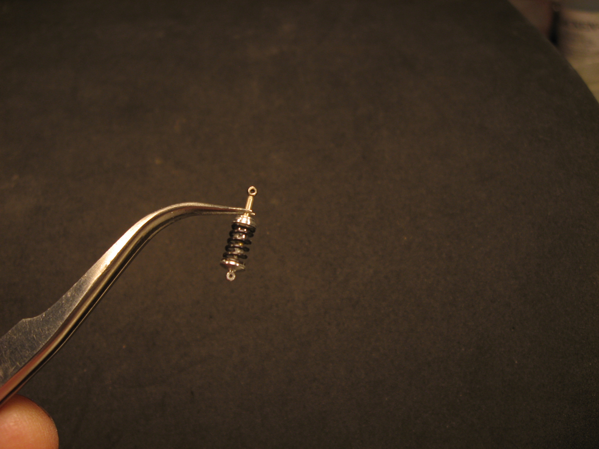

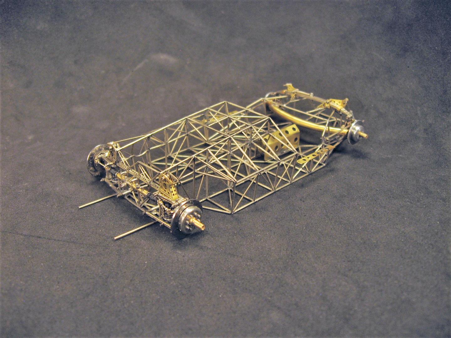

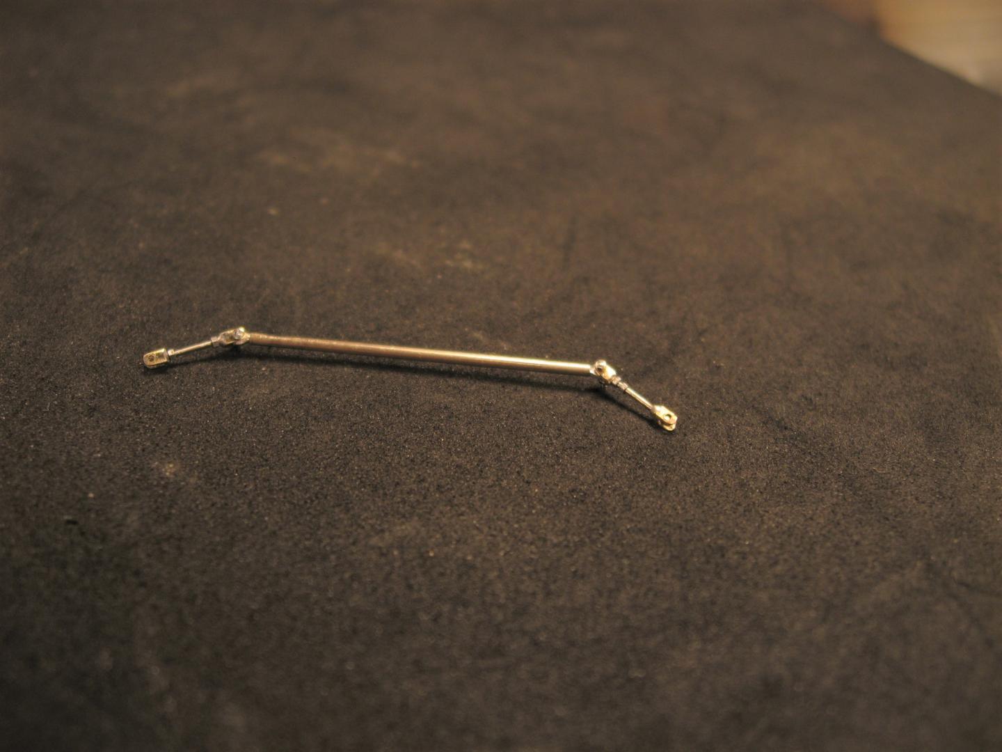

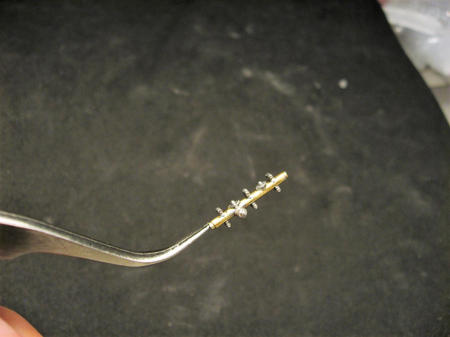

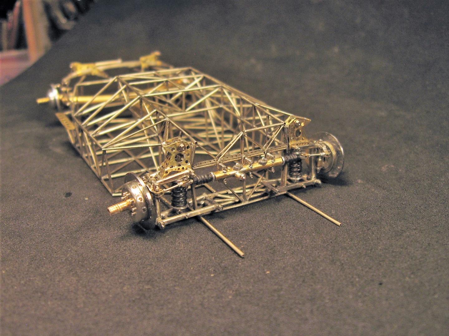

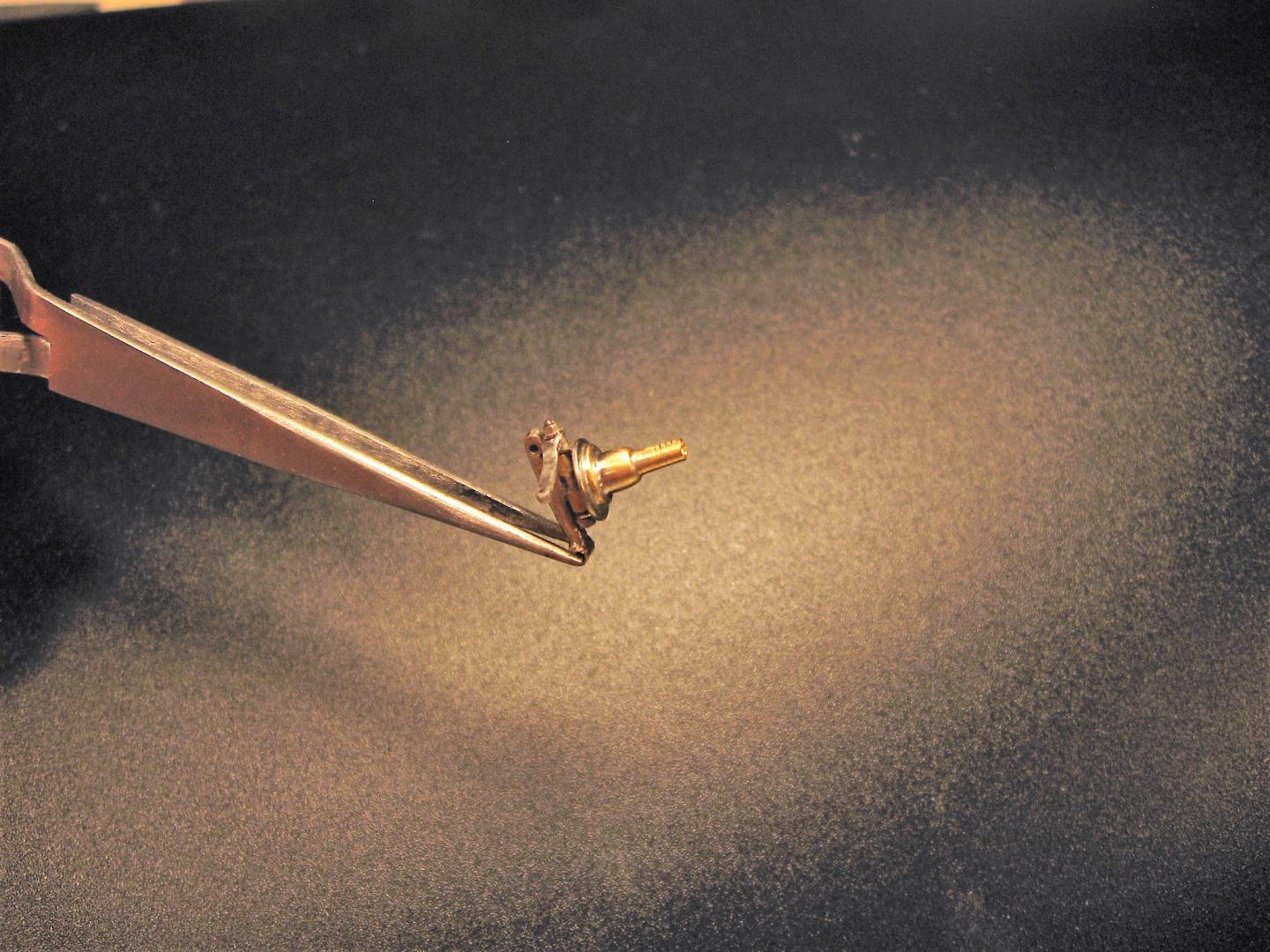

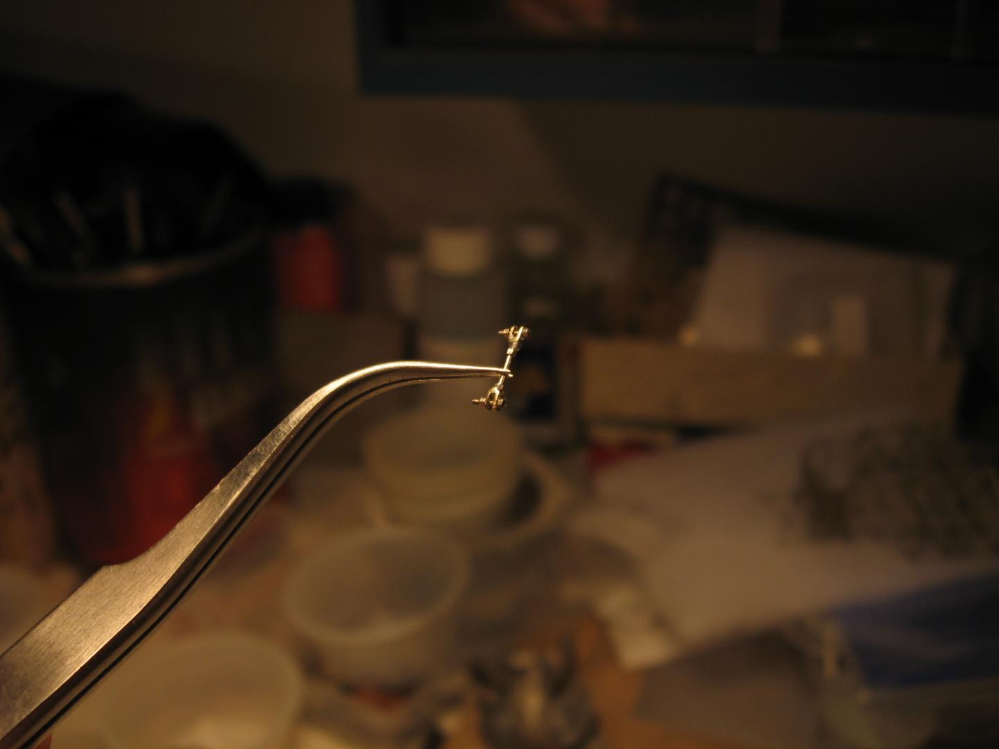

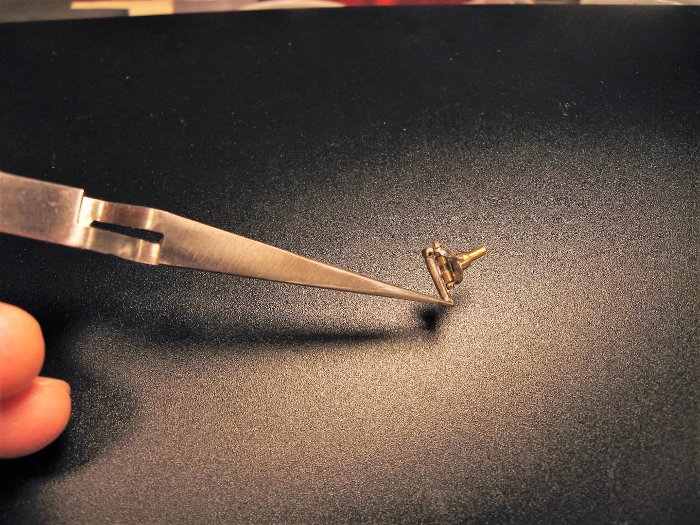

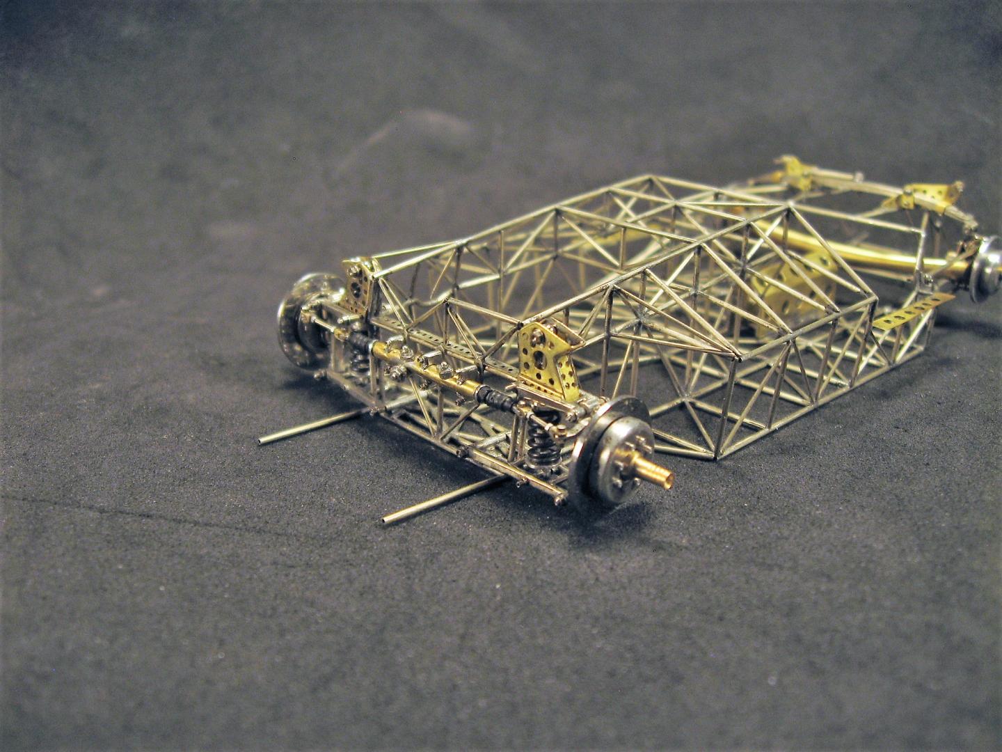

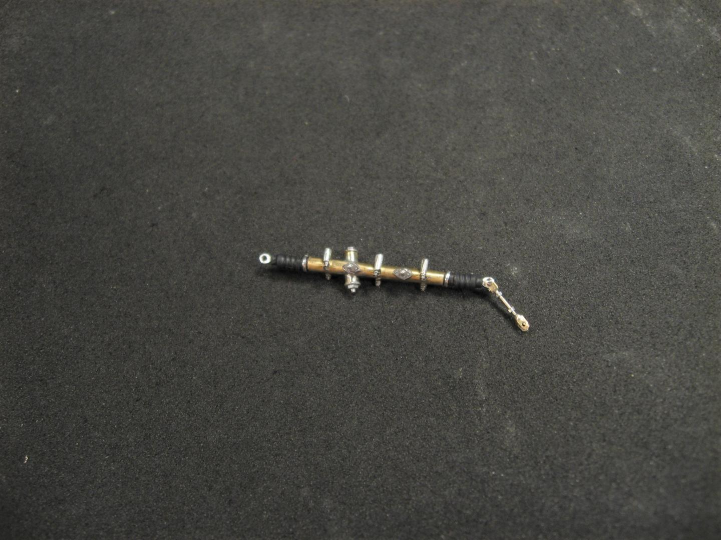

Randy D Posted January 24, 2019 Author Share Posted January 24, 2019 Hi Folks, Hello Dann, Thank you for the compliment but there are several folks on this forum that model in this medium that I look up to. Dave S. and Tim H. (Codi) in the Drag section along with Mark J (Scalemaster) in the Big Boys section and Andy S.(Absmiami) in this section just to name a few:) Hi Bill, Glad you are following along ! Looking forward to talking more with you. A couple of reference pics of the front end. The Tipo 61 used double A arms, Koni shocks with rack & pinion steering.. First is a Ed Matsuishi photo followed by one from a restoration thread, the rack & pinion photo is from Joel Finn's book. Then my attempt.... Was able to reuse the A arms that I had built earlier after shortening them. The shocks are functioning RBMotion items with shorter springs and extended necks. I will split this into 2 posts.. Quote Link to comment Share on other sites More sharing options...
Randy D Posted January 24, 2019 Author Share Posted January 24, 2019 I have working suspension and pose able steering. Could not resist sticking on one of my 3d printed wheels. Thanks for looking in! Randy Quote Link to comment Share on other sites More sharing options...

Codi Posted January 24, 2019 Share Posted January 24, 2019 THIS is simply as good as it can get. STUNNING no matter what the scale but even more so being 1/25th. You really need to post a pic showing a dime next to the suspension/chassis so everyone can appreciate the sheer scale of this. I saw a pic on page 2 of this thread where you're holding the chassis..........gives a great idea of it. I'm convinced that you model with one thought......."see the picture, make the picture". Cheers sir! Quote Link to comment Share on other sites More sharing options...
absmiami Posted January 24, 2019 Share Posted January 24, 2019 thanks for the answers - I don't use my hole punch set often enough .... ..... and I've got the hots for your steering rack insert your Mel Brooks punch line here ... Quote Link to comment Share on other sites More sharing options...

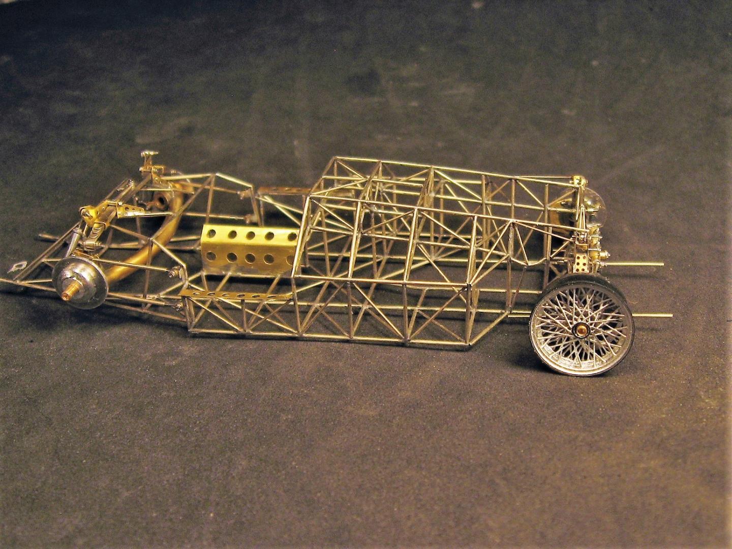

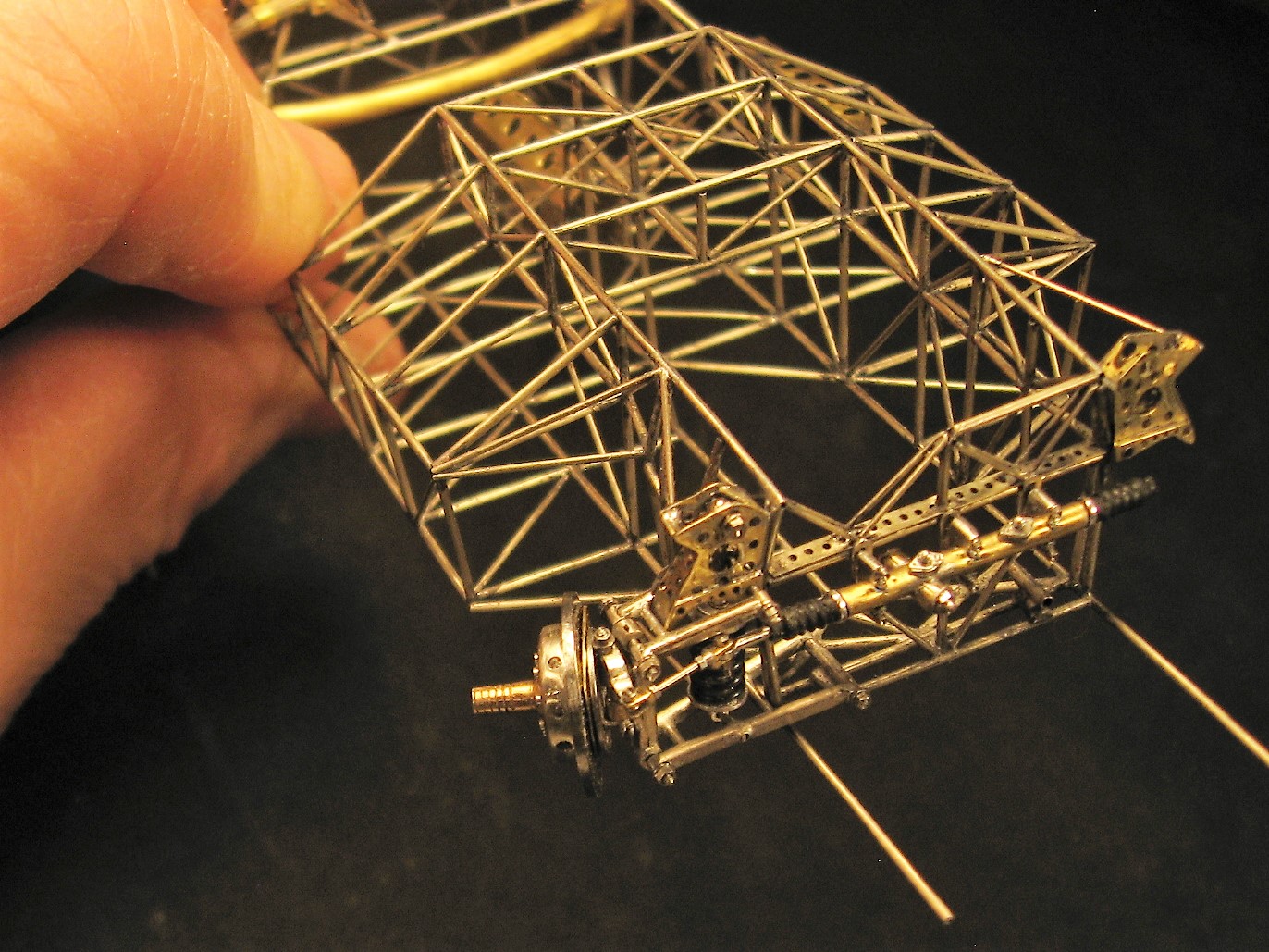

Randy D Posted January 18, 2020 Author Share Posted January 18, 2020 (edited) Hi Folks, Can not believe it has been a year since I last posted progress:( I really am slow !!! Belated thanks to those who commented, Alex, Thank you Sir, now quit messing with those cameras and get back to the models! Tim, As always, thank you for your support! Your new project in the Drag section is shaping up to be another bar raiser!!! Andy, Thanks! love following your progress in your Old Racing Engines thread. Jason, Glad you are still following along my friend:) Bill, Appreciate the kind words! Bernard, looking forward to getting together next week at the NNL West. Daniel, Thank you and we should talk about creating a NNL show here in Denver area. Need to fit in some items before adding more framework. Working on the pedals. The Birdcage used dual master cylinders for the brakes, a rather complex rod & lever system for the throttle and a simple lever layout for the clutch. Reference pics... Found some p.e. pedal faces that looked right and soldered them to some brackets. Made up the rest from nickel silver tubing,brass sheet, rod and goodies from RB Motion. Will post this to see if it works, more to follow... Edited January 18, 2020 by Randy D Quote Link to comment Share on other sites More sharing options...
Randy D Posted January 18, 2020 Author Share Posted January 18, 2020 (edited) My efforts...... more ... Edited January 18, 2020 by Randy D Quote Link to comment Share on other sites More sharing options...
Randy D Posted January 18, 2020 Author Share Posted January 18, 2020 more.... Quote Link to comment Share on other sites More sharing options...
