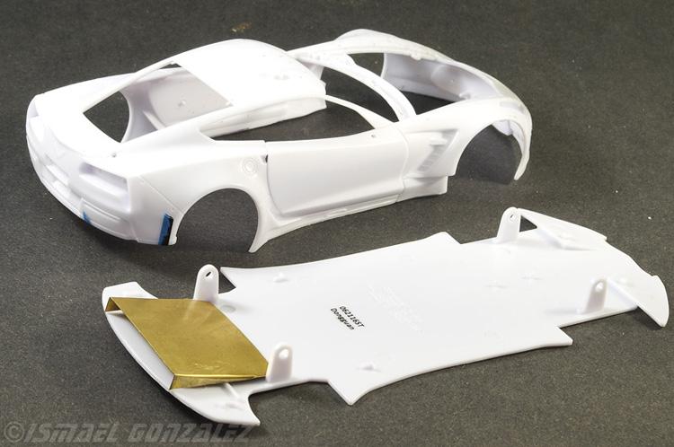

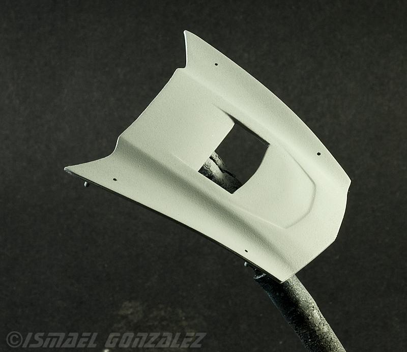

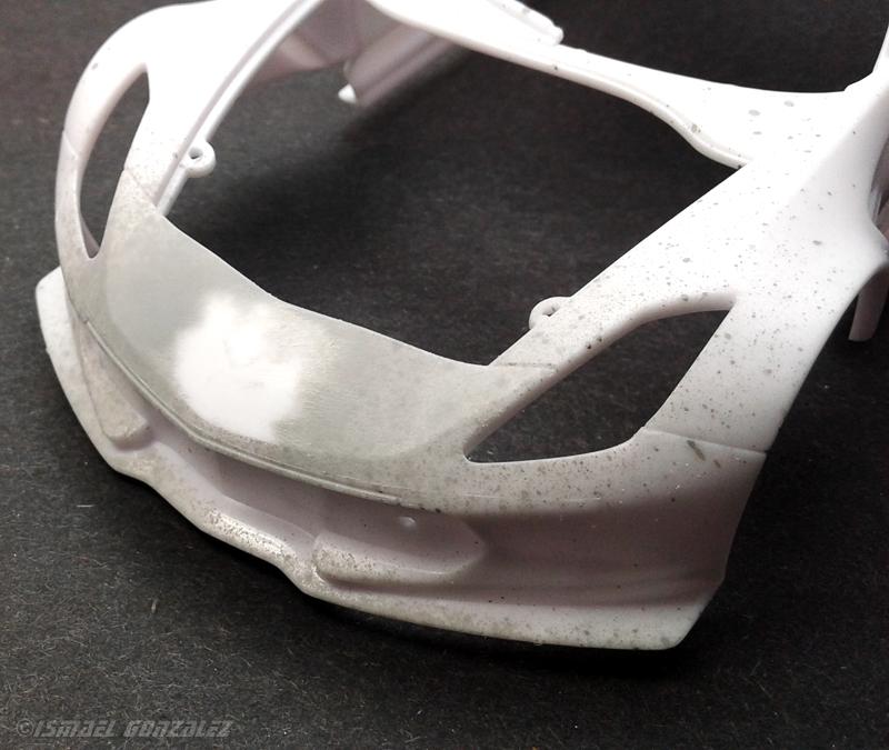

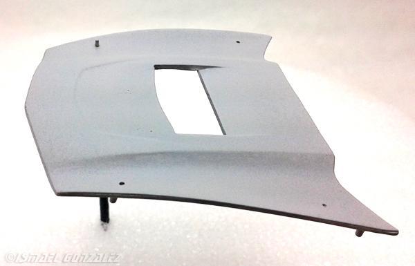

ismaelg Posted October 21, 2016 (edited) Hello, Despite having some restarted projects, the truth is I haven't finished a model car since 2008. It's been years since a model release had me excited. But it finally did! And LIFTOFF! We are officially back! The molded nose emblem was the first casualty. My plan is to do a 2016 Daytona (or maybe, just maybe, a Sebring) car. Several modifications are required to bring the kit to 2016 specs. I started warming up with the hood. Note the hood pins were drilled out. I don't plan to go crazy with this one. Just a curbside build. Times have changed. I no longer have the luxury of lots of spare time so this will be rather slow but I'm happy to be back. I blame Jay Savarese and Jim Drew for this..... Thanks, Edited February 9, 2018 by ismaelg Quote Share this post Link to post Share on other sites

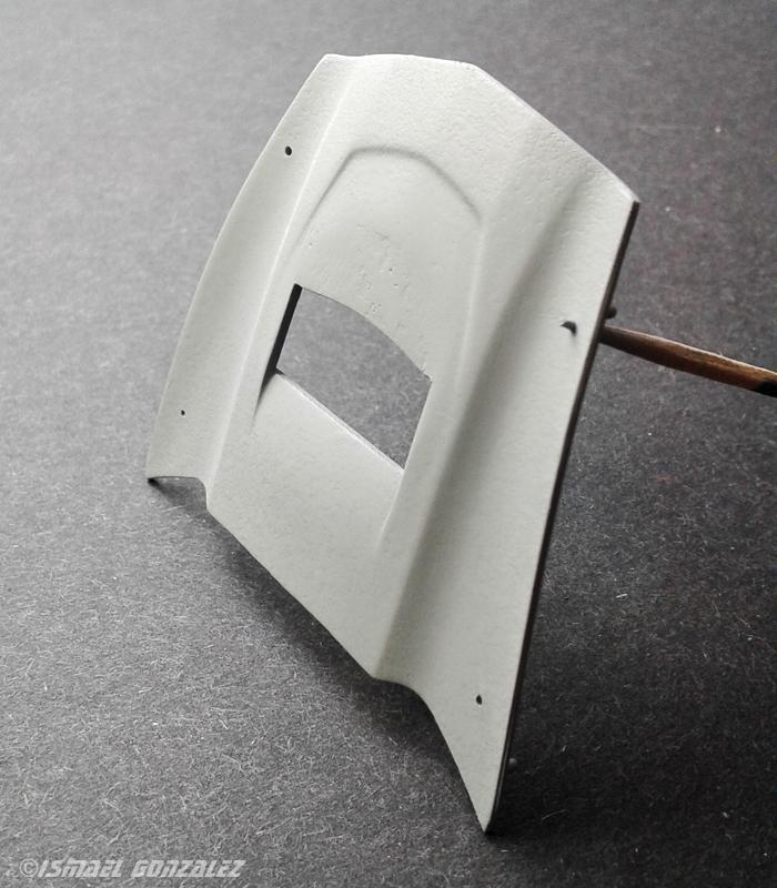

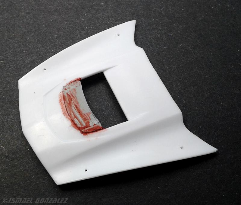

ismaelg Posted October 22, 2016 Hello, The hood is slowly getting there. Some minor tweaking still needed but getting closer. Oh wait! After the hood I still need to work the rest of the car! Thanks, Quote Share this post Link to post Share on other sites

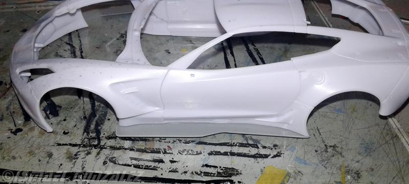

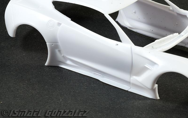

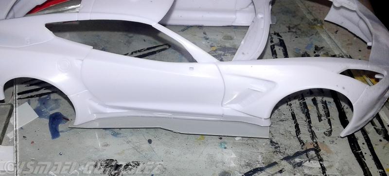

ismaelg Posted October 23, 2016 (edited) Hello, The hood is moving along nicely. Very minor tweaking and it will be ready. Another important modification to bring the kit to 2016 specs is the rocker panels. These were updated for 2016. Here is how the other side looks, but not for long. Thanks, Edited October 23, 2016 by ismaelg Quote Share this post Link to post Share on other sites

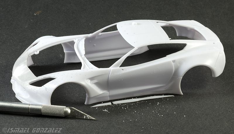

ismaelg Posted October 25, 2016 (edited) Hello, For 2016, rules changes allowed for aero package modifications. The rocker panels are new and bigger as you cans see here: After removing the kit's molded rocker panels, I started working on updated ones. They are still a bit rough but getting there. Thanks, Edited October 25, 2016 by ismaelg Quote Share this post Link to post Share on other sites

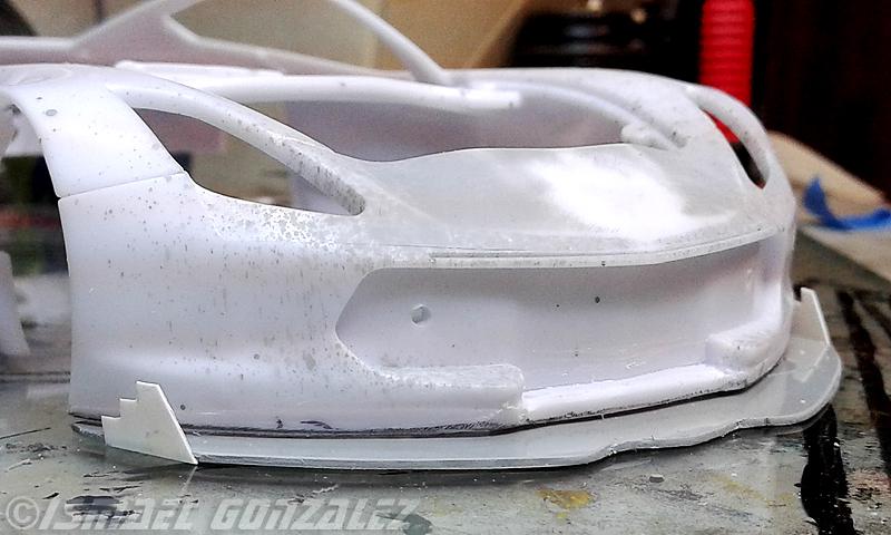

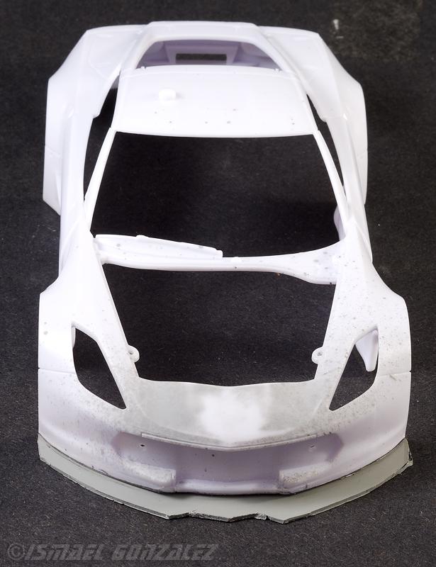

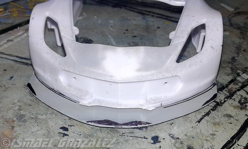

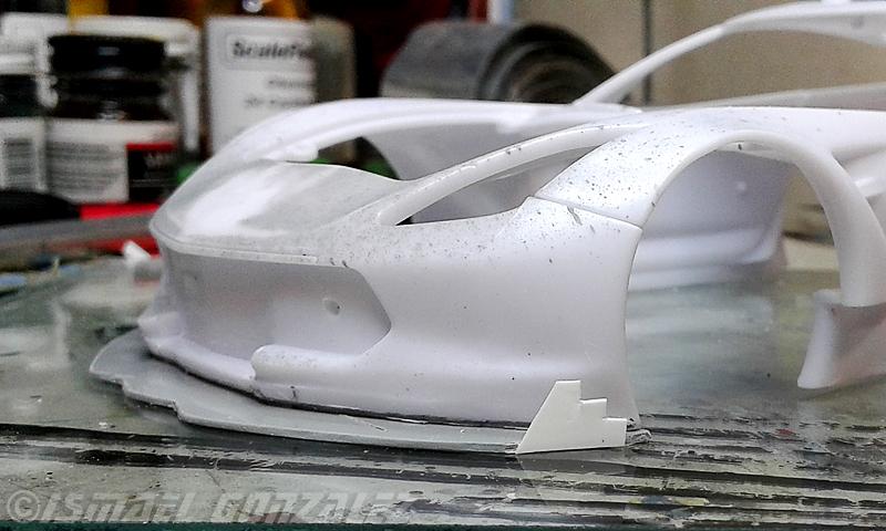

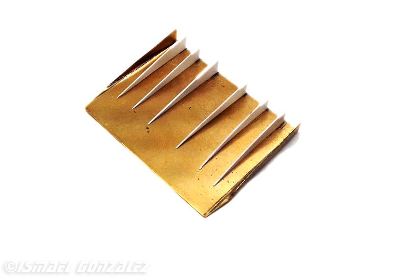

ismaelg Posted October 29, 2016 (edited) Hello, The front splitter was longer for 2016 and had aero fences on the sides. So, after removing the kit's splitter, I started working on my own. Added the aero stepped fences Again, minor tweaking is still needed but getting there. Thanks, Edited October 29, 2016 by ismaelg Quote Share this post Link to post Share on other sites

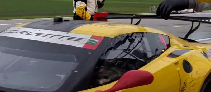

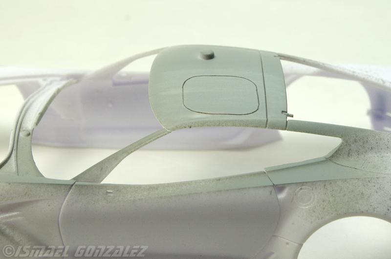

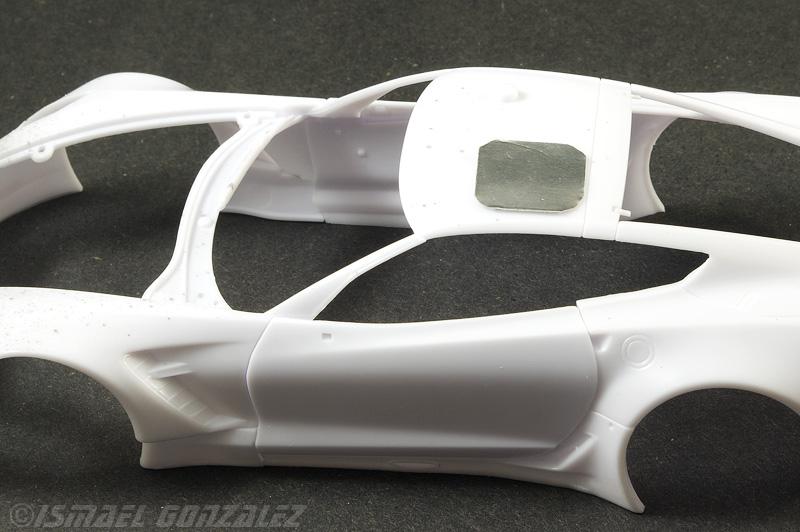

ismaelg Posted November 1, 2016 Hello, Changes in safety regulations for 2016 now mandate a hatch in the roof. This is not an escape hatch like NHRA funny cars. This is for the safety crew to insert a spine brace before extracting the driver in case of an accident. Here is a screen shot of a pit stop video during the 2016 Rolex 24. Not the best picture but you can see the outline of the hatch. And here is mine. This is a template to scribe the outline. For some reason, I made it a hint bigger and it did not look good. This size looks the best but I think it is a tad small. Bu that's OK. My car will not have a driver Thanks, Quote Share this post Link to post Share on other sites

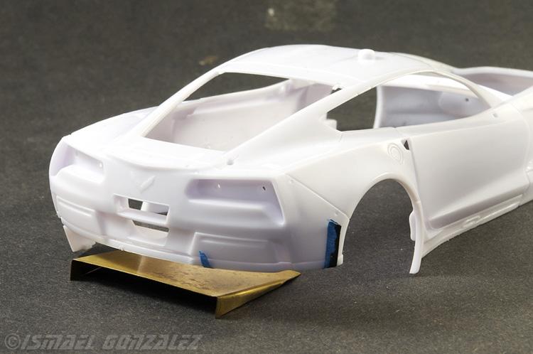

ismaelg Posted November 4, 2016 (edited) Hello, Regulations changes for 2016 allowed for improved aero packages. In the back of the car, the smooth splitter has been replaced with an aero diffuser to optimize airflow and improve downforce. This is a rough mockup but you get the idea where I'm going. OK: Repeat with me: "What part of keep it simple you don't understand?" Thanks, Edited November 4, 2016 by ismaelg Quote Share this post Link to post Share on other sites

ismaelg Posted November 7, 2016 Hello, Roof hatch scribed. I ended up doing another template as the first one was too small. Thanks, Quote Share this post Link to post Share on other sites
