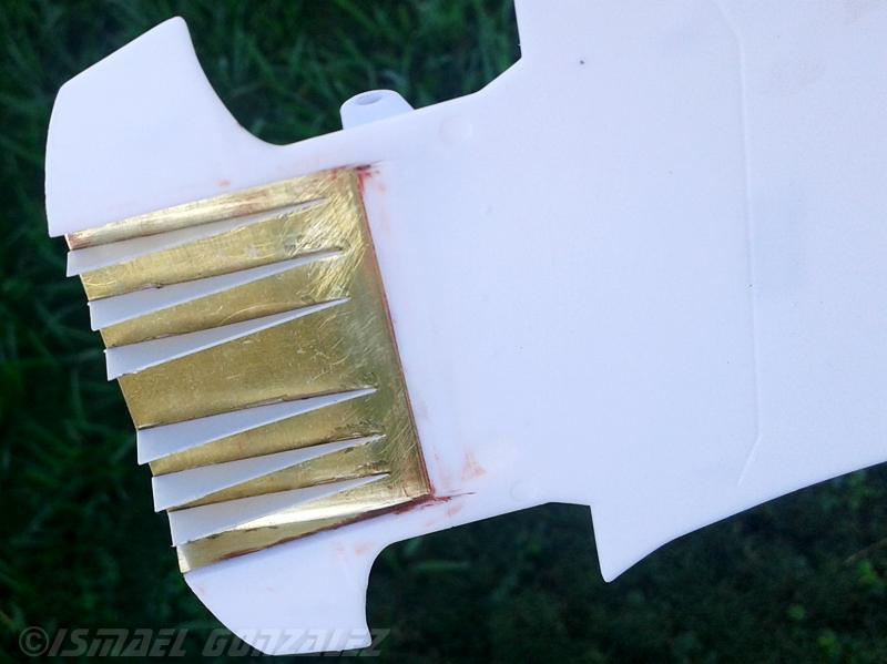

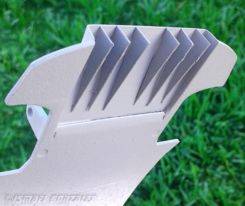

ismaelg Posted November 10, 2016 Hello, Not much visual progress, but it took a significant effort to mate and blend the brass and the plastic to look seamless. Some minor tweaking still needed but getting there. Thanks, Quote Share this post Link to post Share on other sites

Vintagethunder Posted November 16, 2016 (edited) You can fill in and smooth the gaps of the strafes by using a q-tip dipped in finger polish remover (or isopropyl alcohol) and filler.Tom Edited November 16, 2016 by Vintagethunder misspelling Quote Share this post Link to post Share on other sites
ismaelg Posted November 18, 2016 Thanks Tom! I'll try that. Quote Share this post Link to post Share on other sites

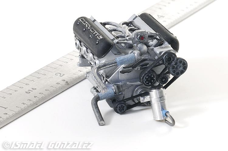

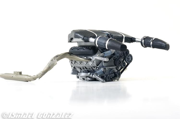

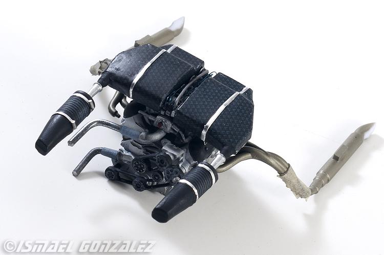

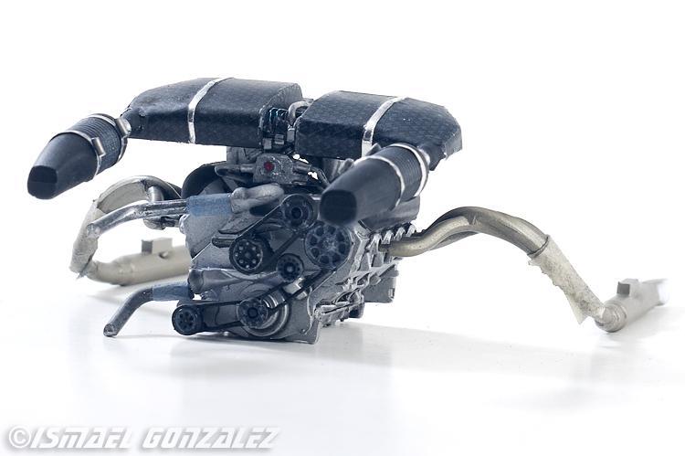

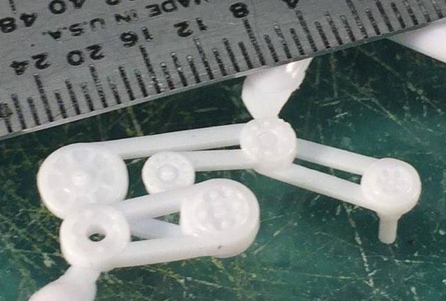

ismaelg Posted November 23, 2016 (edited) Hello, I took a little break from body mods, which are far from over. My original idea was to build it as a curbside. Yeah right.... Then I though, Well, this will be a "Curbside Plus" with just a lump between the fenders. So here is my idea of a lump between the fenders I thought of machining my own pulleys and all that BLAH_BLAH_BLAH_BLAH but I would have never finish it. So I took the kit's belts and sanded them down, plus a few more bits here and there. Still a curbside plus. The headers are loose as they need to be installed after the engine is in place. the heat wraps should go all the way down but that won't be seen anyways.The mold lines in the air box are actually in the real thing. Something I have noticed: In previous cars like C5R and C6R, the engine was a jewel! Glossy carbon fiber with exquisite decals and all. Today's car has more raw carbon parts which is dull and not many decorations. Hope you like it. Thanks, P.S. If you look at it for a while and close your eyes, you can hear it idling... Edited November 28, 2016 by ismaelg Quote Share this post Link to post Share on other sites
superbike-shaun Posted November 23, 2016 IZZY, amazing detail,for sure,I was noticing in the engine,detail also as you point out that every thing is noticibly under finished ,,I can only guess to help offsset the R@D costs! Quote Share this post Link to post Share on other sites
Bennyg Posted November 24, 2016 Looks good.Ben Quote Share this post Link to post Share on other sites
Canso65 Posted November 25, 2016 Impressive work!The engine looks great. Quote Share this post Link to post Share on other sites
Luis Ayala Posted November 25, 2016 Great body work as always Buddy!!!!! Engine looks awesome!!! Quote Share this post Link to post Share on other sites
Custom Hearse Posted November 25, 2016 Repeat after me... AW, FERGIT IT!!! There is no way you can resist the the call of detailing. It's the reason why I have a minimum of 20 still unfinished projects looking at me with sad faces... It's looking awesome Ismael. I'll be watching your builds, I love Vettes!!!!!!! Quote Share this post Link to post Share on other sites

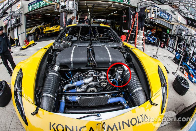

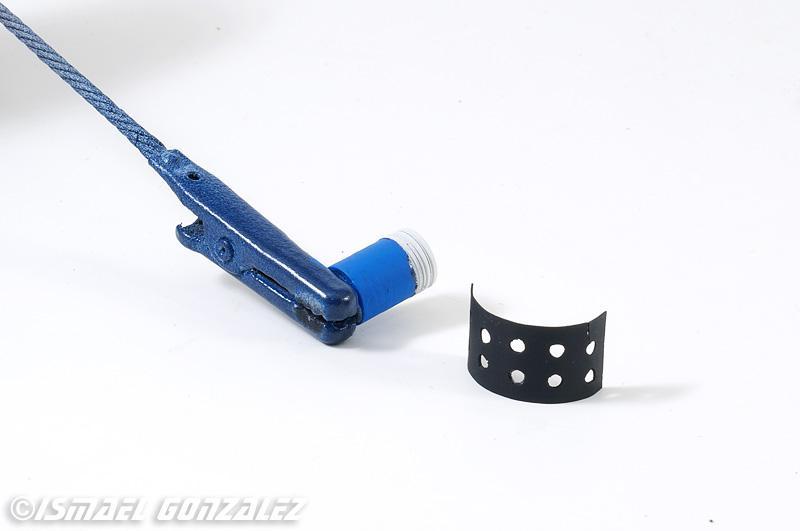

ismaelg Posted November 29, 2016 Hello! Not much bench time but here is a little update. There is a fluid tank in the C7R engine. Not really sure what it is for. Trying to find out. So I machined my own tank. The lid was machined in place. It came out thinner than I wanted but no big deal. Added aluminum strap to eventually attach it to the bracing and added a fluid line that will disappear underneath. Thanks, Quote Share this post Link to post Share on other sites
om617 Posted November 29, 2016 Looks awsome. The tank could maby be for the dry sump lubrication system? Quote Share this post Link to post Share on other sites
superbike-shaun Posted December 5, 2016 Hey ismael,c'mon we need an update!I Quote Share this post Link to post Share on other sites
Jhedir6 Posted December 5, 2016 Nice work Ismael. Liking all the changes and additions you're doing. My guess for that tank would be an overflow/fill for the oil system. With the big airbox over the engine they'd need somewhere to add oil that is easily accessible during a race. Or I could be completely wrong, I figure I got a 50/50 shot at it.Looking forward to more updates.David Quote Share this post Link to post Share on other sites

kitbash1 Posted December 6, 2016 That tank is for the Power Stearing fluid. Quote Share this post Link to post Share on other sites

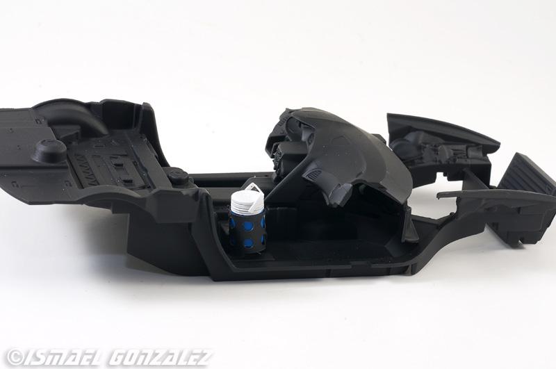

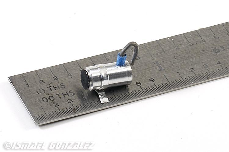

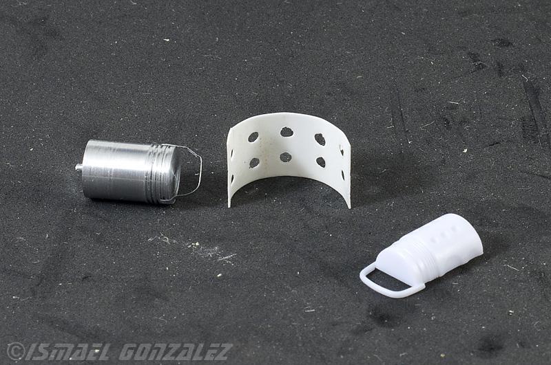

ismaelg Posted December 26, 2016 Hello and Merry Christmas to all! Finally I'm back home! These cars have a drink cooler can so the driver can keep hydrated. Since different drivers like different things, they never run sports drinks. Just pure water (my favorite by the way). This cooler "sits" where the passenger would be. The kit's cooler can is... well..... ehhhh... sub-standard for my liking. So, knowing it will not be seen anyways, I machined my own cooler. Painted it and it is ready to reflresh! I've never claimed to be normal Repeat with me: It will not be seen.... it will not be seen..... Thanks, Quote Share this post Link to post Share on other sites

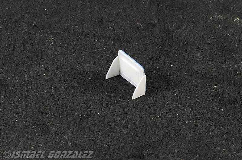

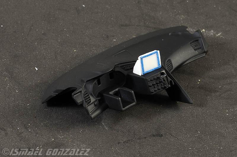

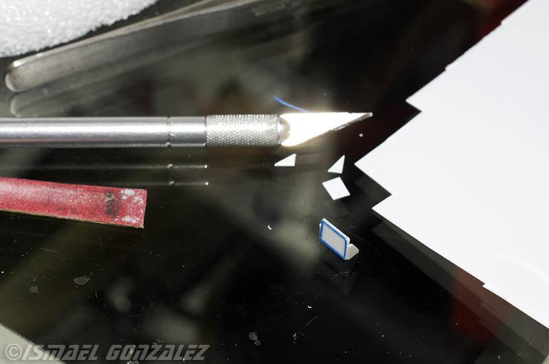

ismaelg Posted December 28, 2016 Hello, One of the most prominent and important features of this car is the rear camera and radar system. It is not just a rear camera, but a complete collision avoidance system developed by Pratt & Miller and Bosch that alerts the driver of cars passing, blind spots, closing in, distance, time etc. This system is a tablet size screen on top of the dash, and of course missing in the kit. I cut some bits of styrene and assembled it from 5 bits of styrene and 4 strips of tape. Of course it will barely be seen once painted black but I had to do it Thanks, Quote Share this post Link to post Share on other sites
afx Posted December 28, 2016 Its coming along nicely Ismael. Quote Share this post Link to post Share on other sites

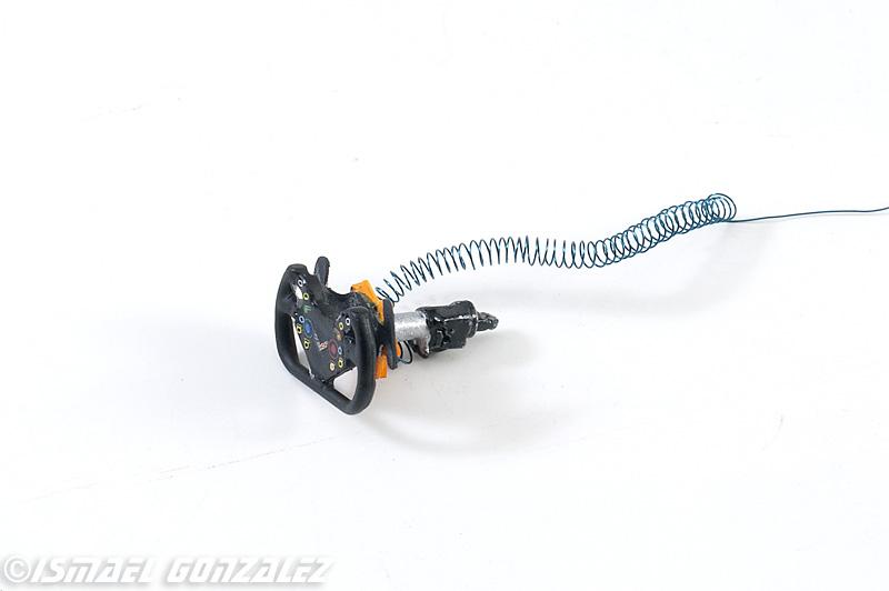

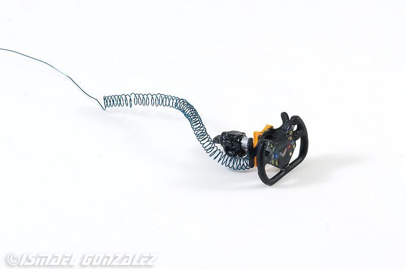

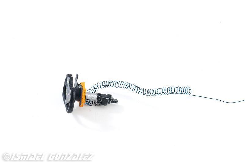

ismaelg Posted December 31, 2016 Hello! Last update of the year! Another "I know it won't be seen but I did it anyways" details Scratchbulit paddle shifters and the anodized star-like piece behind the steering wheel. The spiral cable carries the signals from all the buttons and switches in the steering wheel and goes underneath the dash. Yes it is very long. I'll cut to size once in place. See you in 2017! Thanks, Quote Share this post Link to post Share on other sites
superbike-shaun Posted December 31, 2016 Nice, a little Jewel to finish the year off!!,Ya know,if you leave that Drivers Door off,?????? Not only do you,leave a huge hole to exploit your modeling virtuosity (good word huh?),You also create,more opportunity to exploit your modeling virtuosity lol Quote Share this post Link to post Share on other sites
