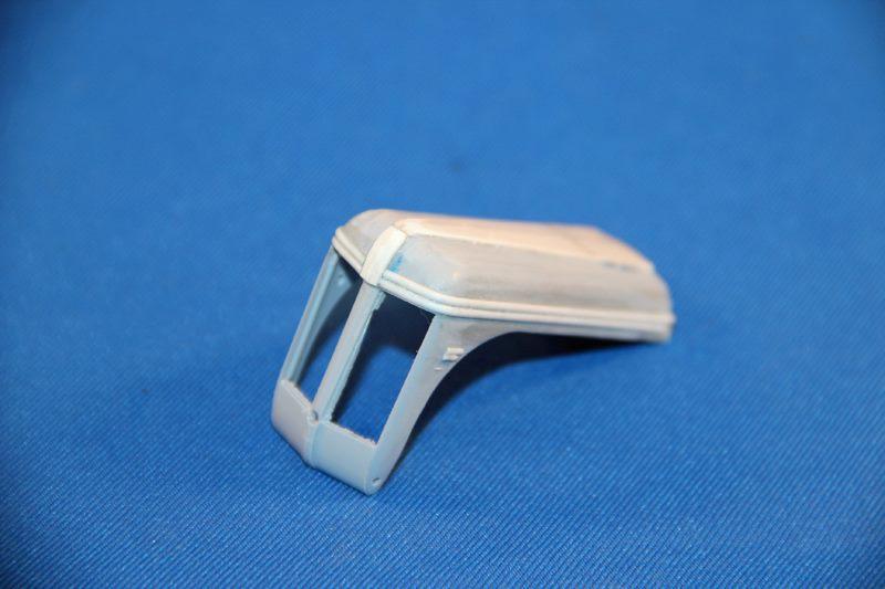

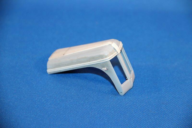

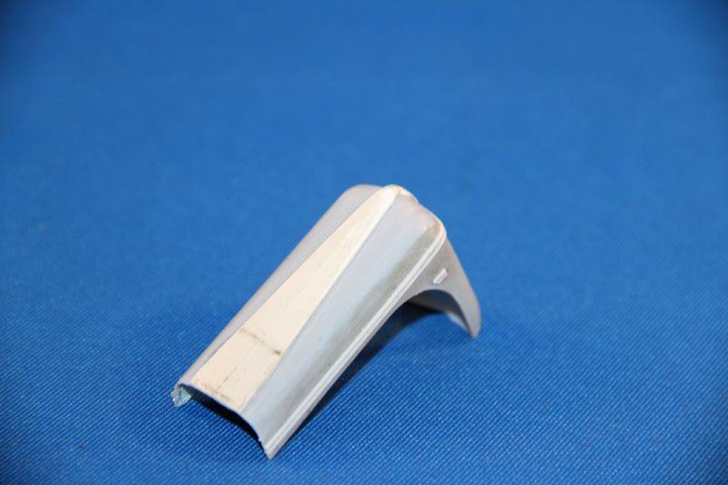

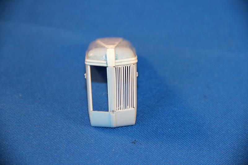

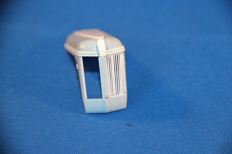

First of all the Hood Needs to be modified like I did it. The grill must be changed as well. Next is the engine . The 8N has a 4 Cylinder Flathead engine. I would recommend one of the Model A engines from Revell, although it they are 1/25. I'll go for a V8 Flathead from a '50 F1 and again it is 1/25. Otherwise I'll see if TDR has a 3D printed Flatty in 1/24. The Transmission can be used because the Fergy has a 4 Speed. I you want to build a 9N or 2N you have modify it because These tractor had a 3 Speed. The Dashboard has to be modified as well. Check out Old Ford Tractors for more Information.

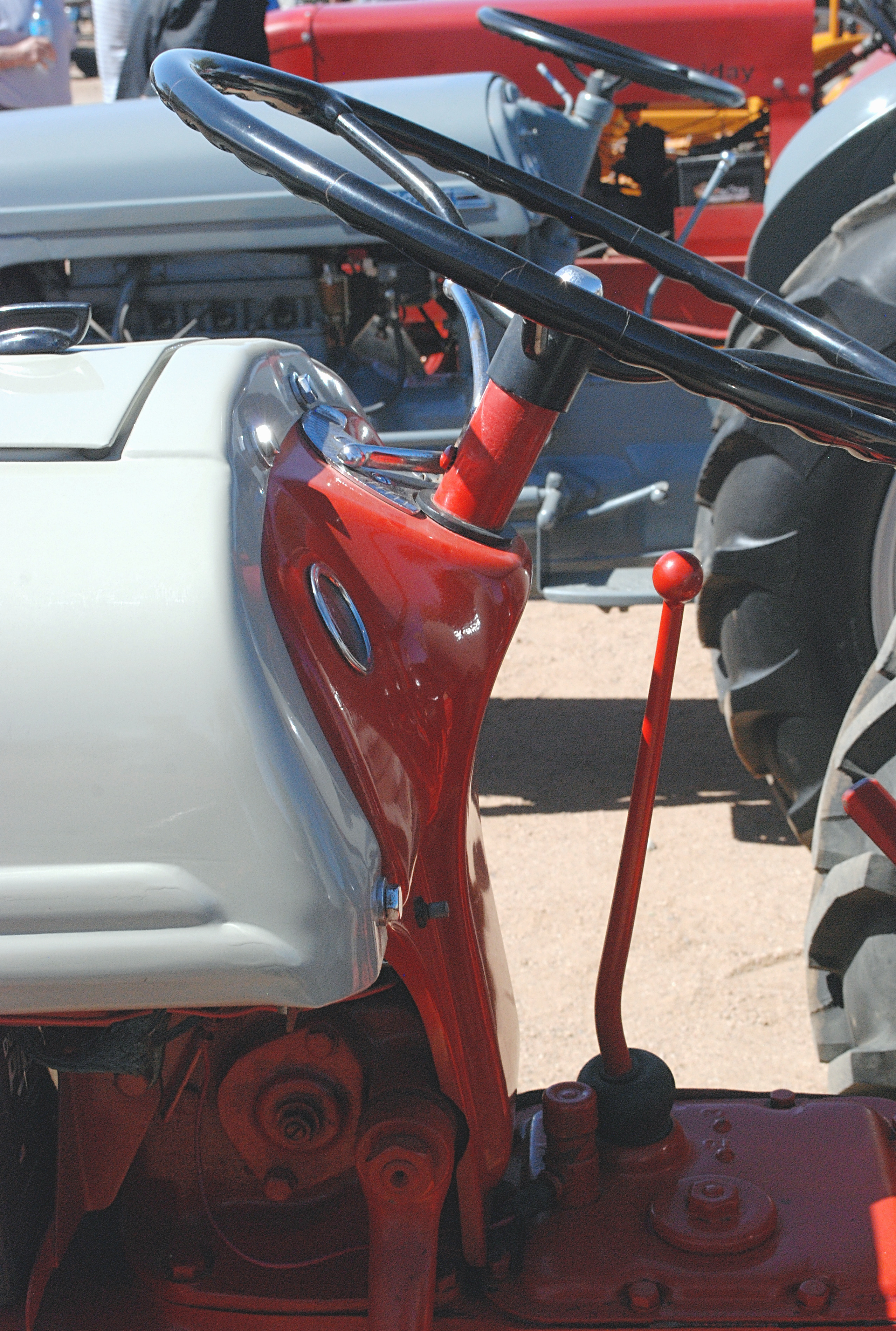

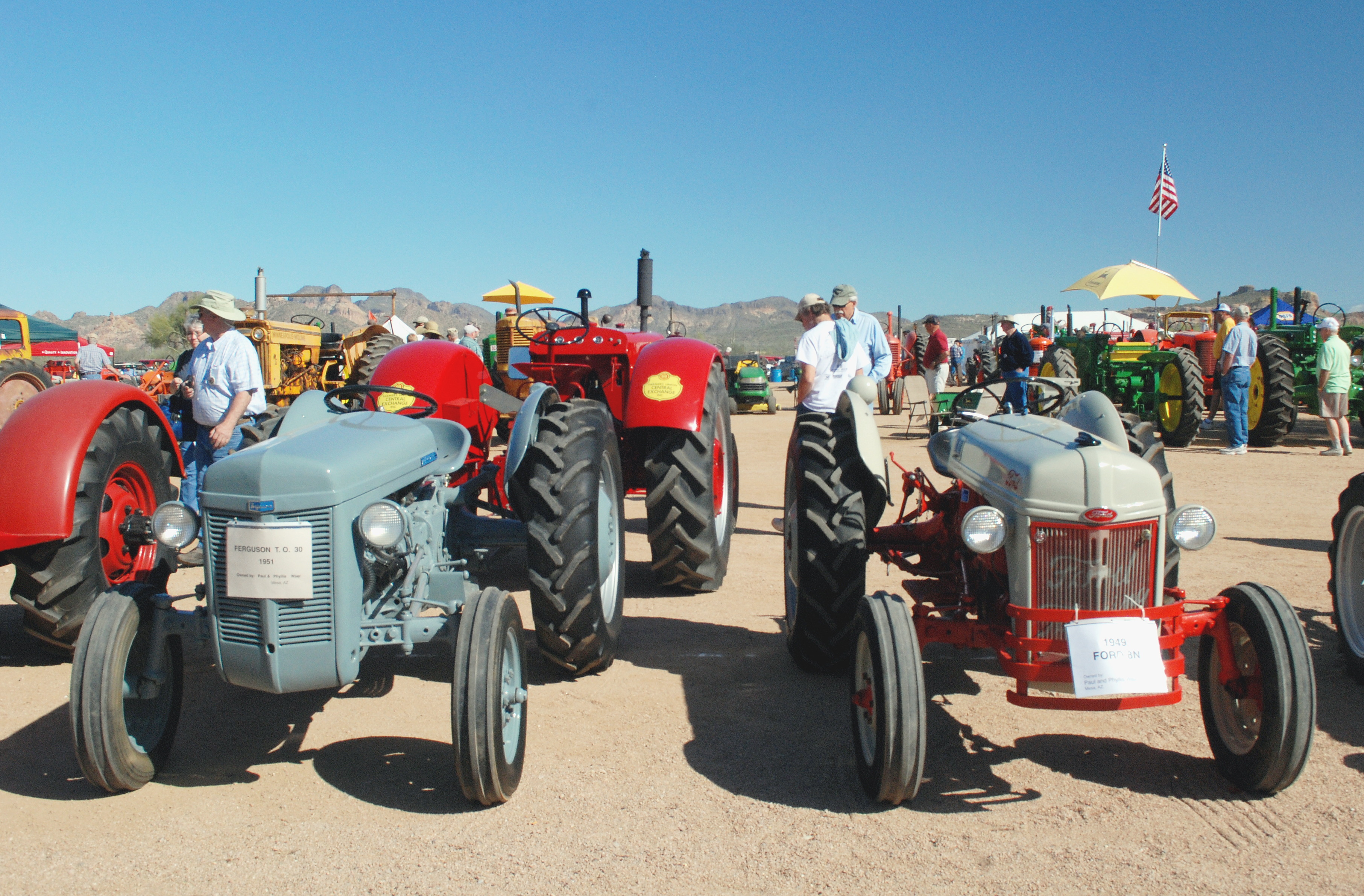

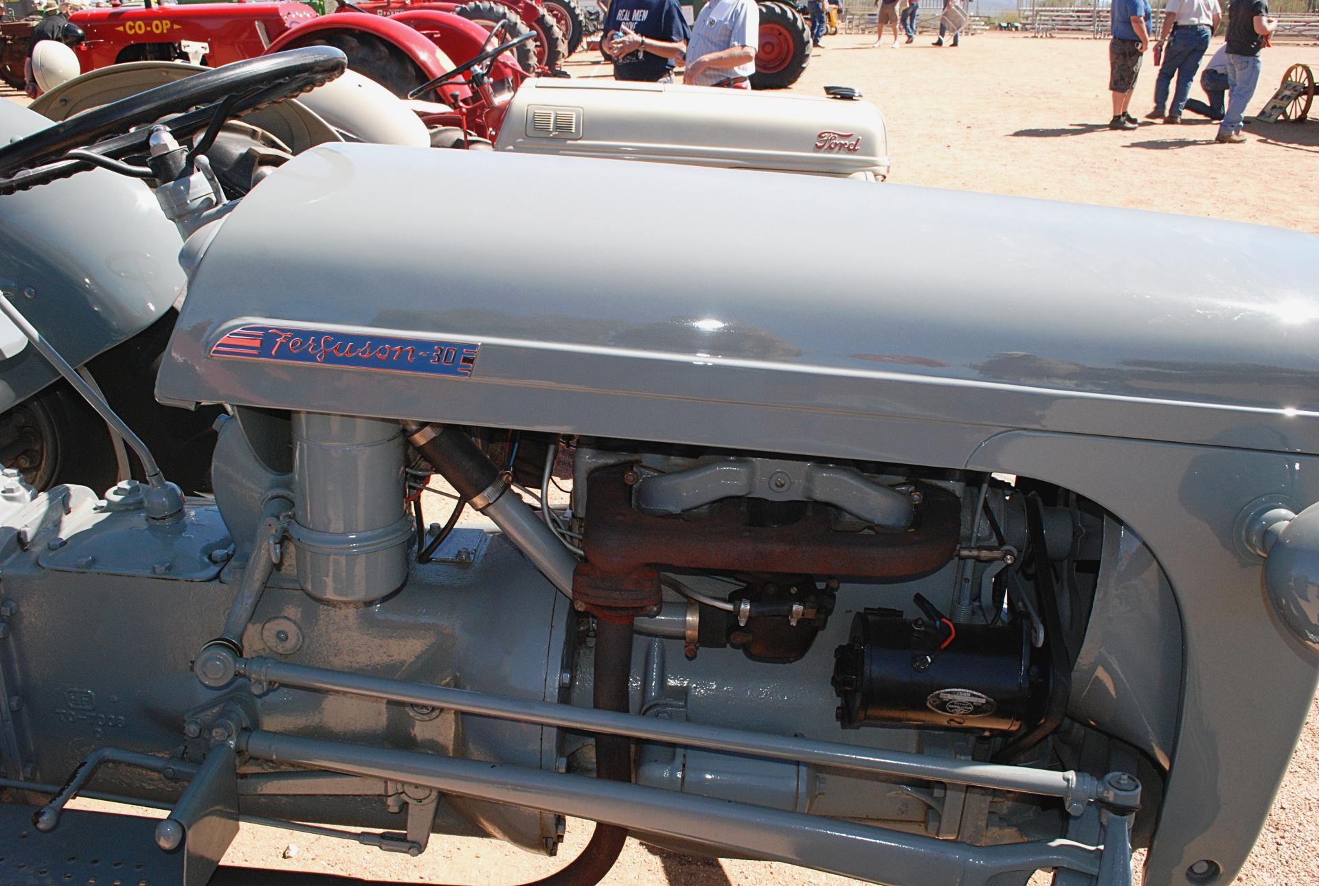

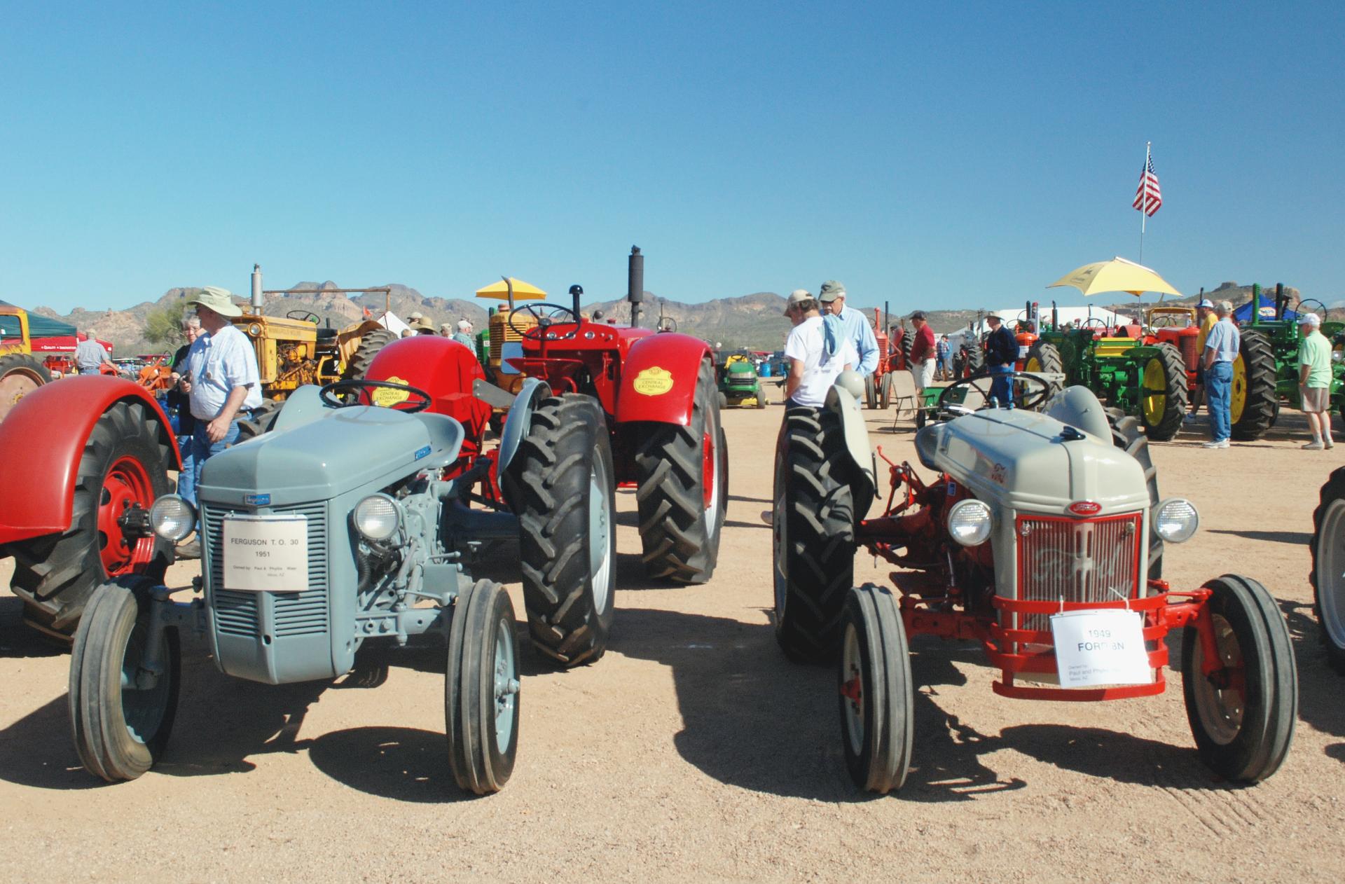

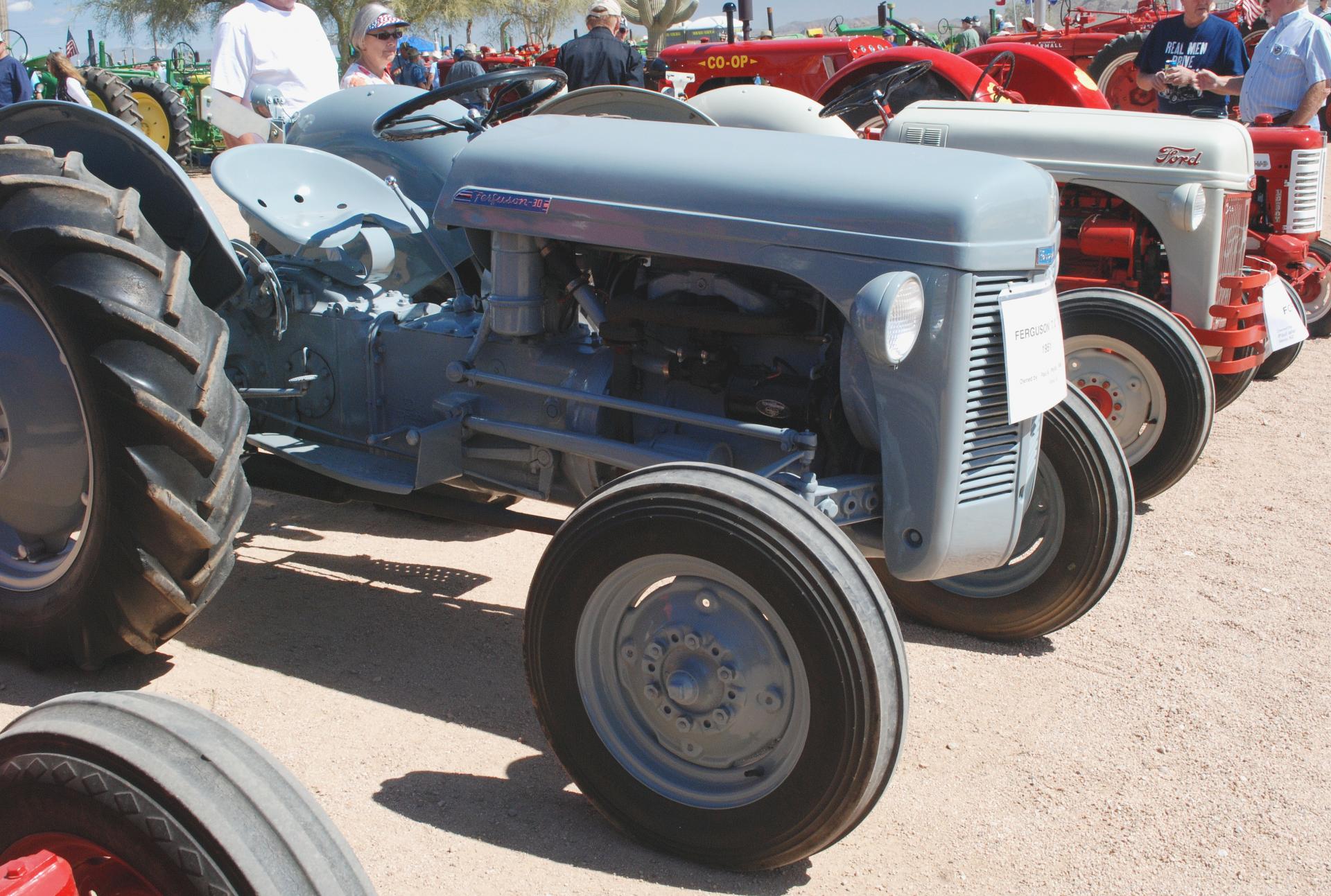

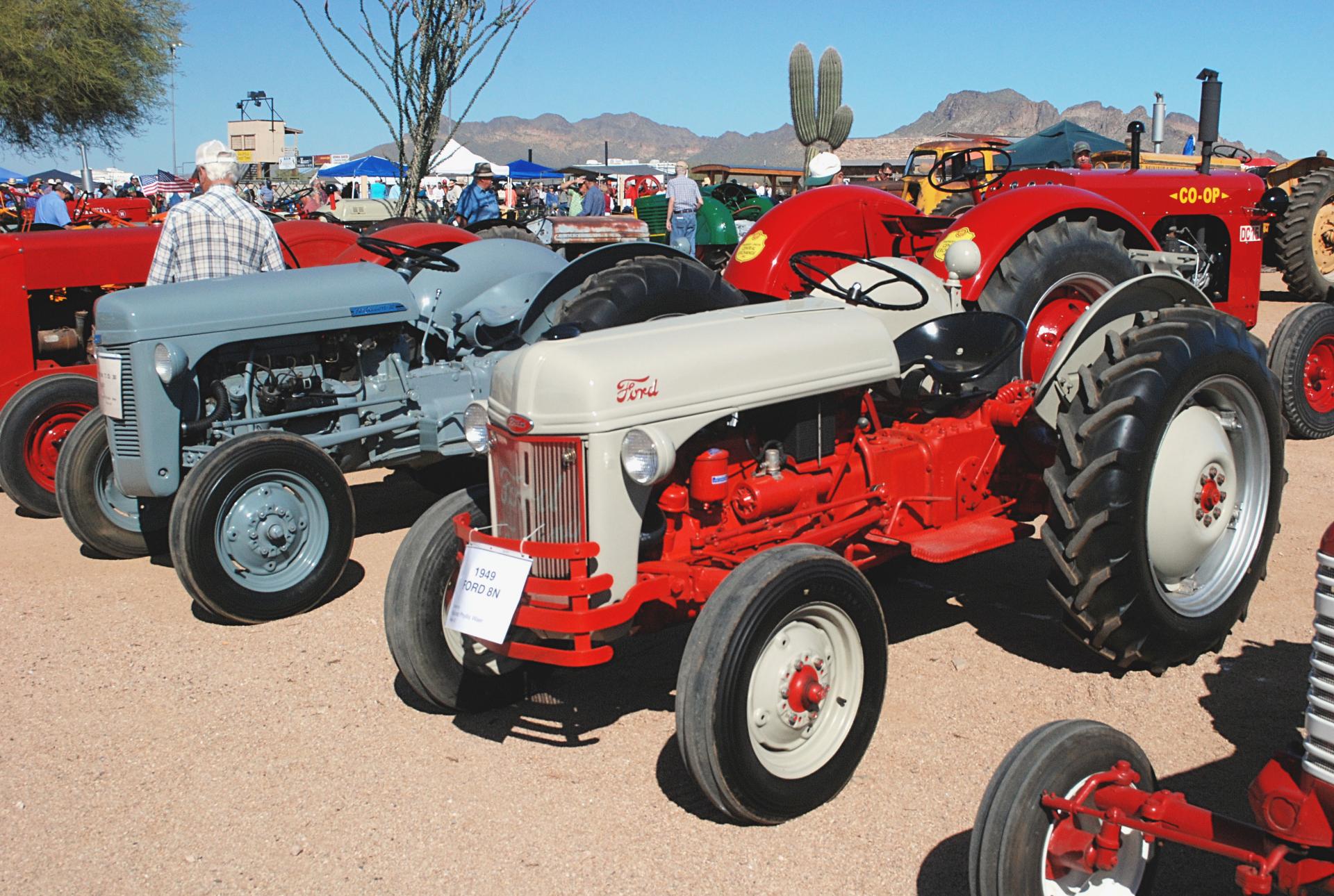

They are about the same size tractors since they came out of the same design philosophy and purpose. As far as I've been able to determine there are no identical parts. One rumor was a couple of defecting Ford engineers brought a set of Ford 2N drawings with them to Ferguson after the Ford and Ferguson split.
