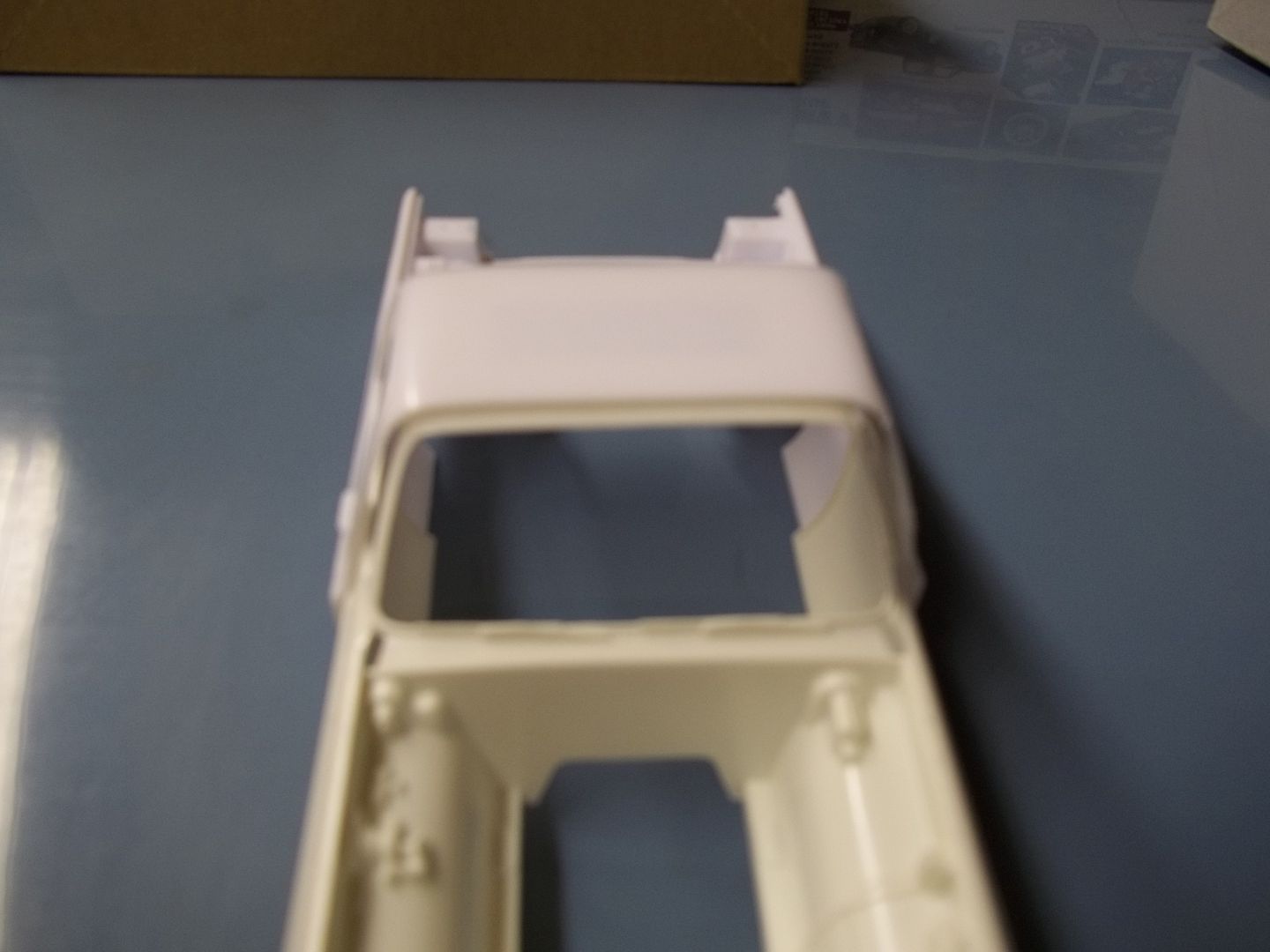

What is the most accurate '73 to '87 kit out there? I just bought a Revell '77 GMC Wrecker Truck and was far less than impressed. The visor, sunroof, mirror holes, and incorrect rear window lower edge make this cab unuseable. Not to mention the cast-in engine block... However it was worth the price of admission for the one ton wheels and tires. Those are particularly difficult to source.
What other pickups are out there which are more correct? I want to stay as stock as possible. I have the most interest in 1973 to '80 model years, prefer a 2WD if there is one, and I am okay with kit bashing.
