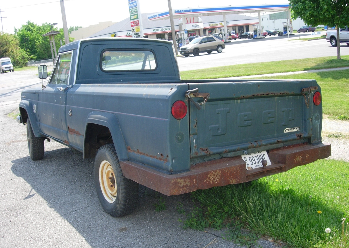

Casey, this is a '65. You'll have to change the fuel filler, and taillights to match your small window early truck like this one. Mine is a '74 and still has the small flush filler, but large window, and large tails...
