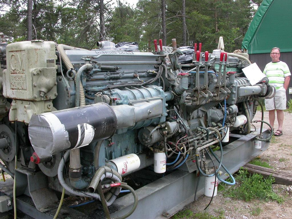

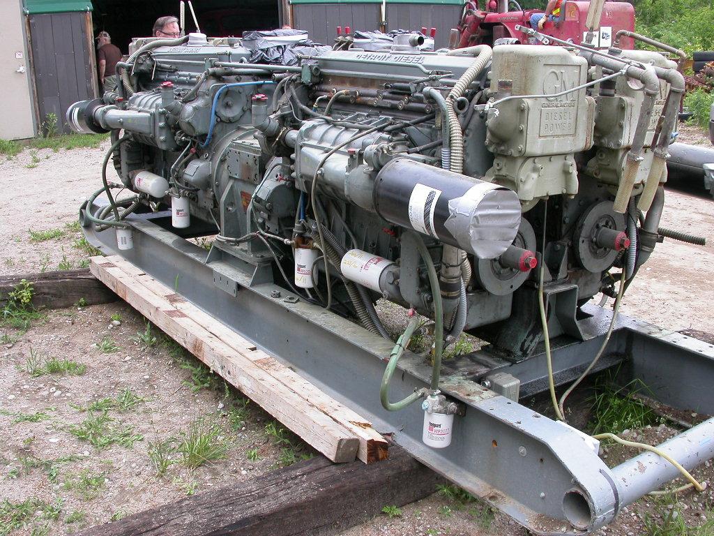

In WW2 GM built twin 6-71s for use in tanks. Technically not V-12s but not I-12s either and they were not independent of each other so not really just two I-6s.
They also built a real monster quad 6-71 with Grey Marine for use in landing craft.

These are pictures of a quad-six that was a standby power unit for the Oshawa water works. It was connected directly to an emergency water pump.
