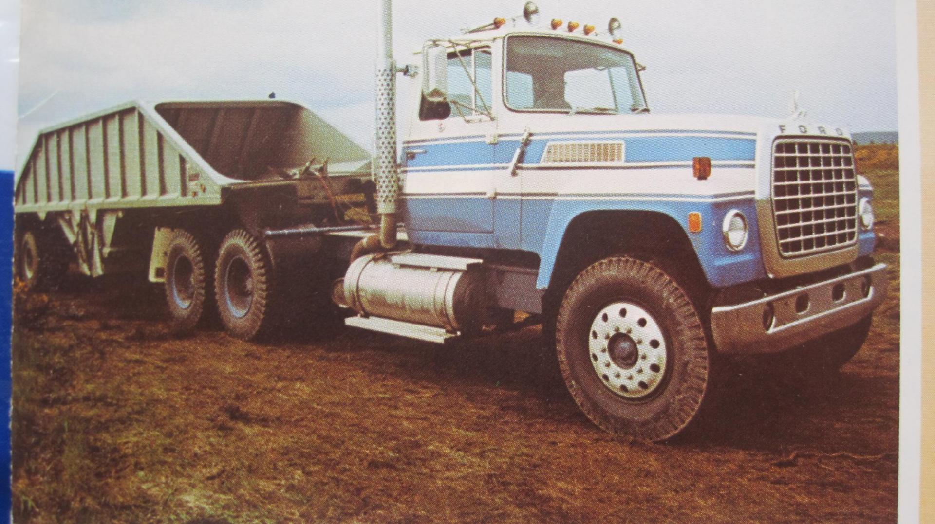

This is the near twin to her truck. It's the gray one on the right of the picture. Crappy picture but maybe some of you experts can help out. Hers had aluminum tanks.

The silver truck looks to be an LT (50") one peice hood and fenders. The LN was the short hood(39"0 with the back half of the fender ext. molded in the cowl panel. In 1986 I put sq. h/l in my 77 LN by cutting & fiberglassing the buckets out of an 86 model F650 (the little white truck beside it) The Italeria fords are LTL's, completely diffent hood/grille & bumper. The plaskit hood is the right lenght, if not a little too long, but to build a correct 95, you'll have to build a new grille & sq. h/lamps. (Ford changed to squares in 1988 & change the egg crate grille in favor of a straight bar grille w/ ford emblem in the center. And my little Ford LN (in an earlier post of mine, big moe &) had a 6v92 silver detroit in it, Complete list of the hoods w/ specs can be found at (dawsontrk.com)
