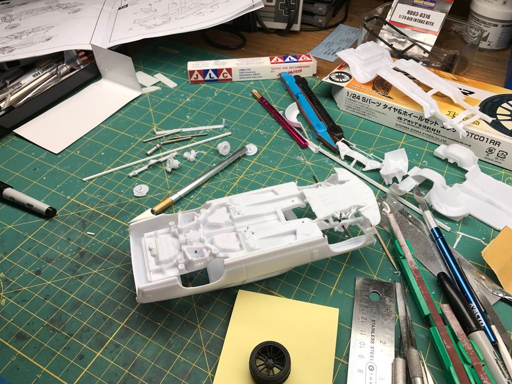

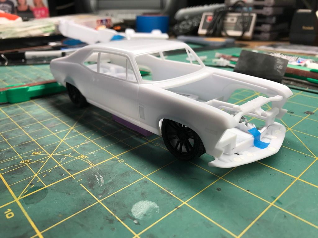

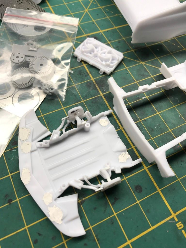

By grinding and sanding out the rear fender wells, I'm just barely going to avoid having to make any fender flares or major suspension changes.  It's a very tight fit with these wide Aoshima wheels, but I'm going with it.

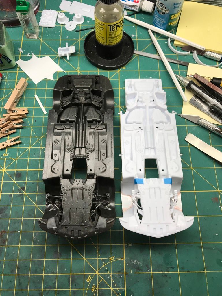

I was surprised that the wheelbases on these two kits are almost identical, but the Camaro ZL has a much wider chassis.  With that said, I just made some cuts to draw in the wheels on the front suspension (still setting and test fitting this), and I trimmed off some chassis length on each side to make it fit to the Nova body.  Fender wells were all removed, and I'll figure out these and maybe some changes to the gas tank later.  I know this may not be realistic, but I'm hoping that the look will be right in the end.  Still a ways to go, but I'll be glad when I can get the suspension, ride height, and chassis set and then get on to the engine and other things.  It doesn't look like a whole lot of work, but here are a few progress pics.  Thanks for looking.

Some progress with filling sink holes and moving the front suspension to account for a slight difference in the front wheelbase.  I reattached some of the front suspension arms after cutting in various spots.  None of this is functionally correct, but I'm just going for something that will complete the look while still giving me the height I'm looking for.  I'm having to take in to consideration where my chassis will attach to the body too - all of this has to line up.  Next will be to open up the front more and mock up the height with how the wheels will attach.

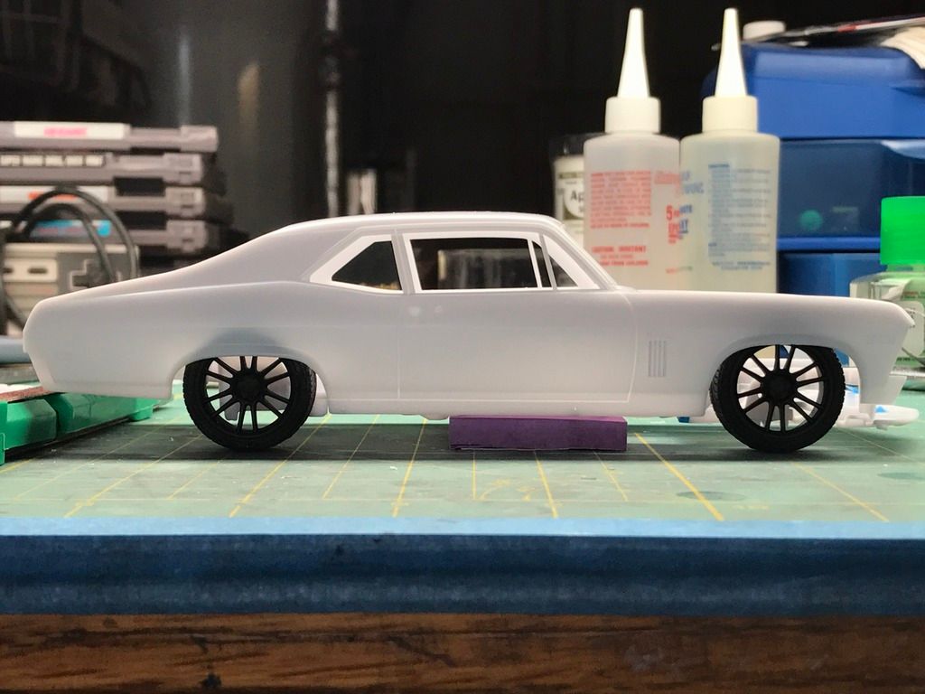

I finished up some locating tabs for setting the chassis in place to the body.  I know there will be a lot more test fitting with interior components, so this should help.  I have some wiggle room with where I place the wheels while it still looking close to where the actual axles would be.
After my son checks this post, he can text me and let me know if this is where he wants it to sit....

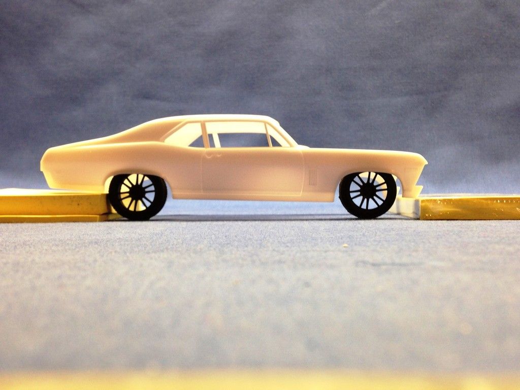

Your build with your son looks like it's going great. From the side view picture it looks like the front wheels might have to go forward about 1 or 2 mm. If need be for narrowing the front track it looks like the Corvette front suspension/chassis components could be narrowed if need be.
Thanks David - Yeah, that front wheel kept rolling away from me - ha.  I do have a Corvette kit that I can check out just to make sure.  Thanks again for the help.

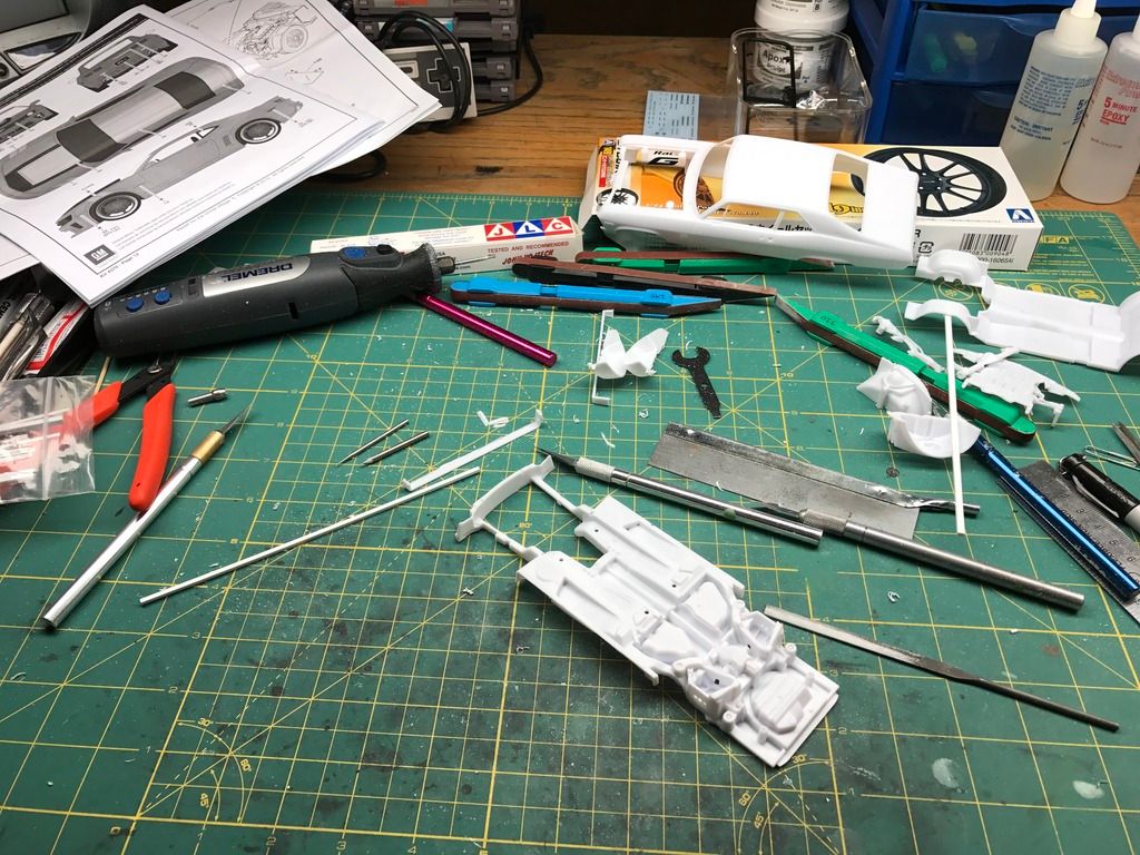

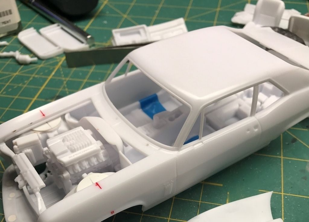

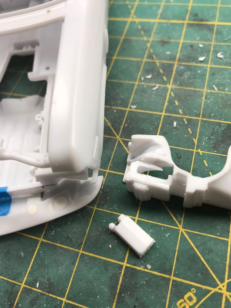

After a needed break, I was able to get back to work on this.  I modified the Camaro front fender wells in order to get them to fit with the Nova body.  Some detail with the struts had to be sacrificed, but there was no way around it.  They have been repositioned slightly too in order to give the illusion of where they will be in relation to the wheels and modified front suspension.  I'll add a little bit more scratch-built detail later.  For now, the fit seems good, and I'm moving forward.  The firewall, interior (ugh), and engine fit/hood mod will be up next.  A lot of work for a simple detail chassis, but I'm hoping this will all contribute to the final product in a good way.  My son has given me his approval, but comments/advice still welcome.  Thanks for looking.

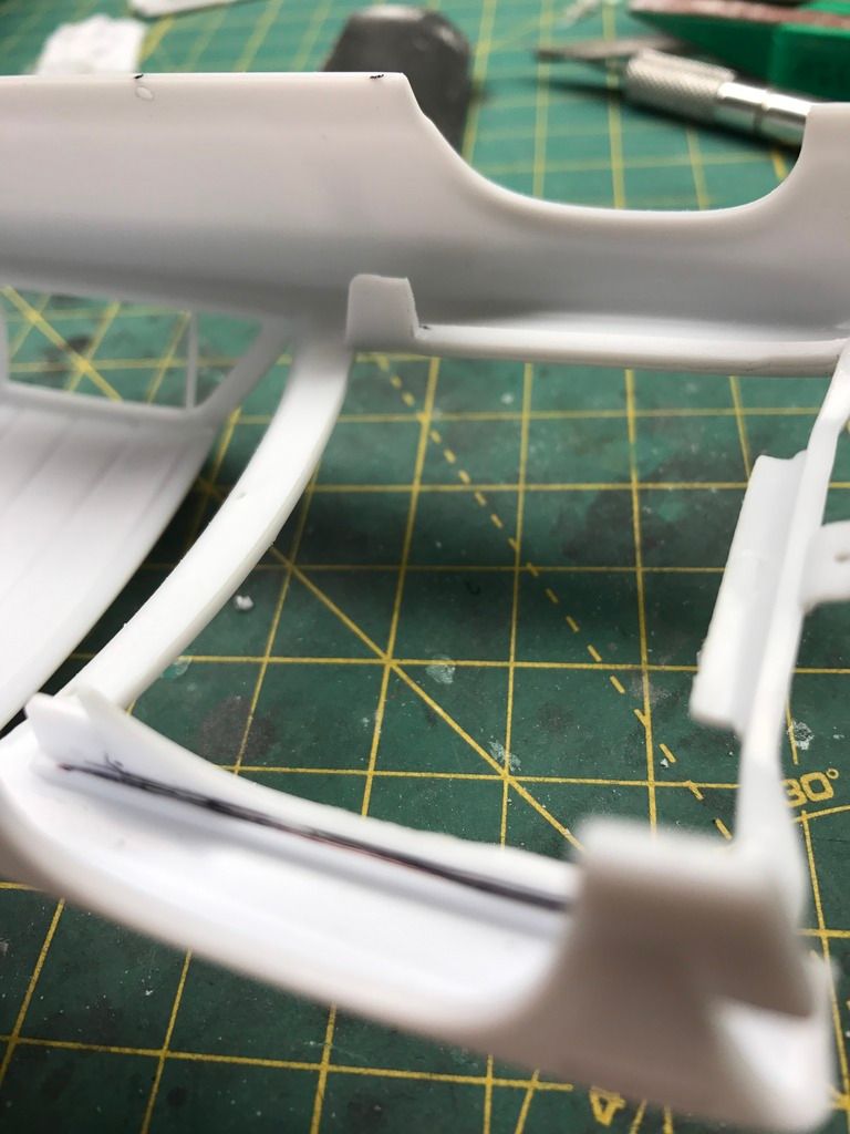

Shaved off the underside flaring of the Nova body...a very hard to reach area with just about any kind of tool.  I ended up using a bare blade in my hands and then a rough sanding stick.IMG_3697_zpsgbqb2pnc.jpg
Shaving off and refitting some of the stock detail so that it will clear the hood later.  I debated on creating plain fender wells (taken from the Nova chassis), but I want to recreate as much of the Camaro ZL1 inside (stock or not) as much as possible.

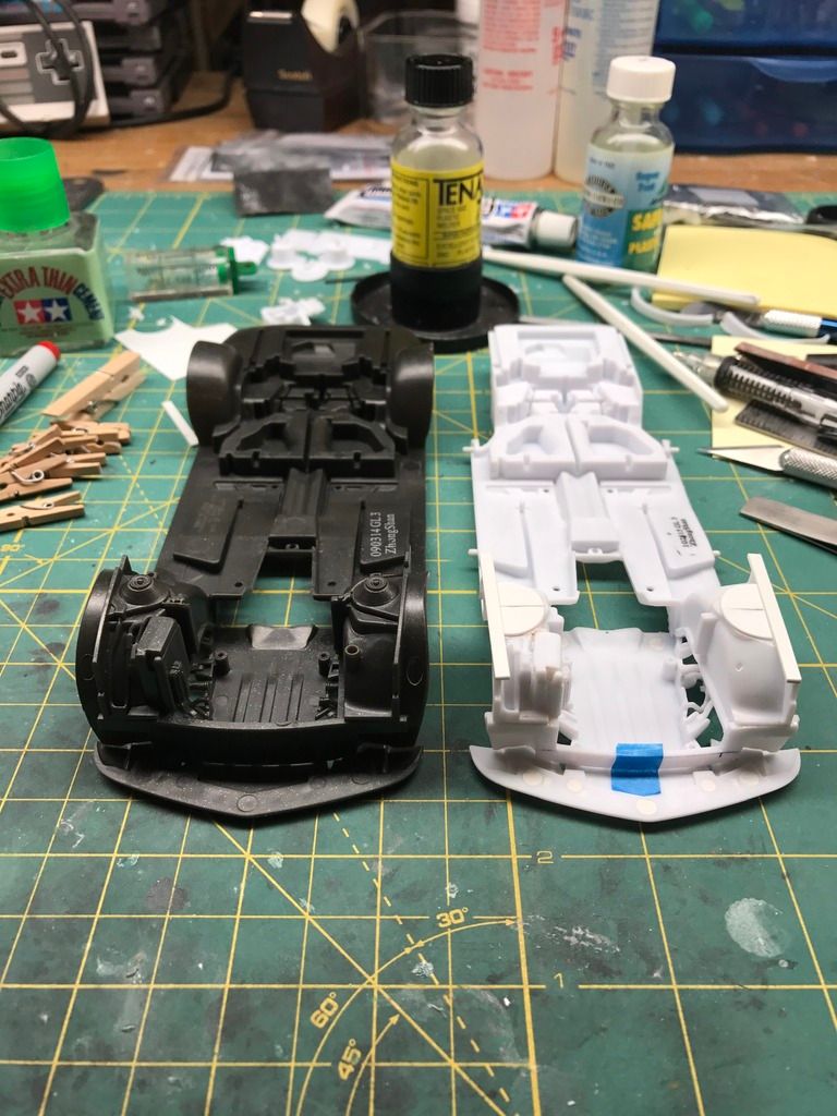

Some comparison pics (unmodified on left).  I also made some locating tabs for constantly test fitting the chassis to the body.

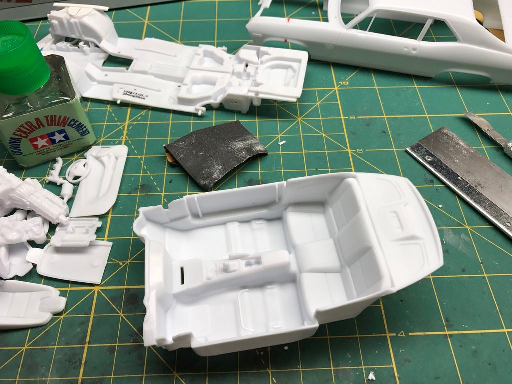

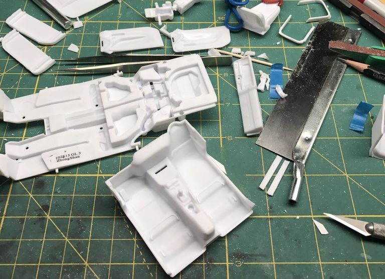

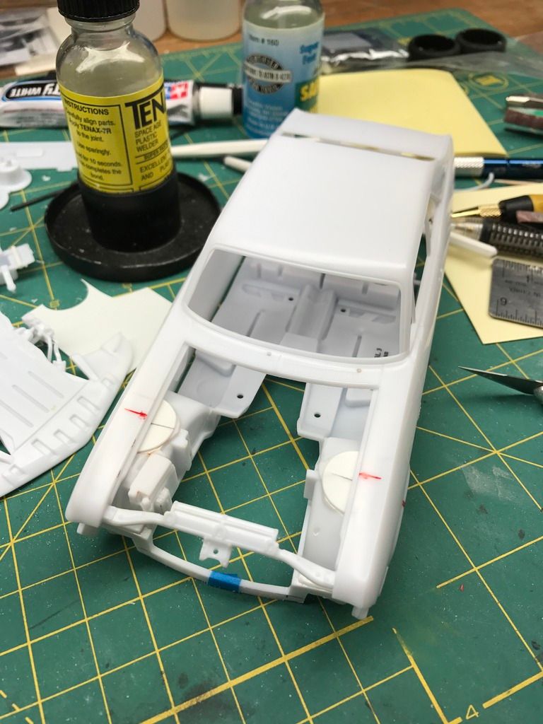

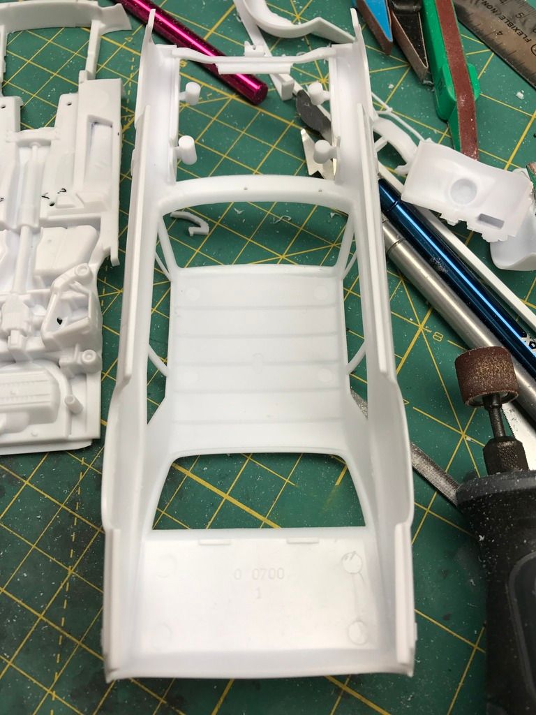

Just a few more progress pics with the interior which will have the Camaro interior except for the Nova dash.  Everything had to be settled down a bit including lowering all the seats and notching out a spot for the dash in to the Camaro console.  The door panels and portion under the rear window have yet to be trimmed out yet, and I'm still deciding exactly how I want the upper part of the engine firewall / cover look - either keep as is and fill in the gaps or do something different.
Staring point with interior:
A lot of cutting:
ff95564d-786a-4da6-95ff-ecd252966b98_zps
A quick mock up:
Edited by drsnapper55
