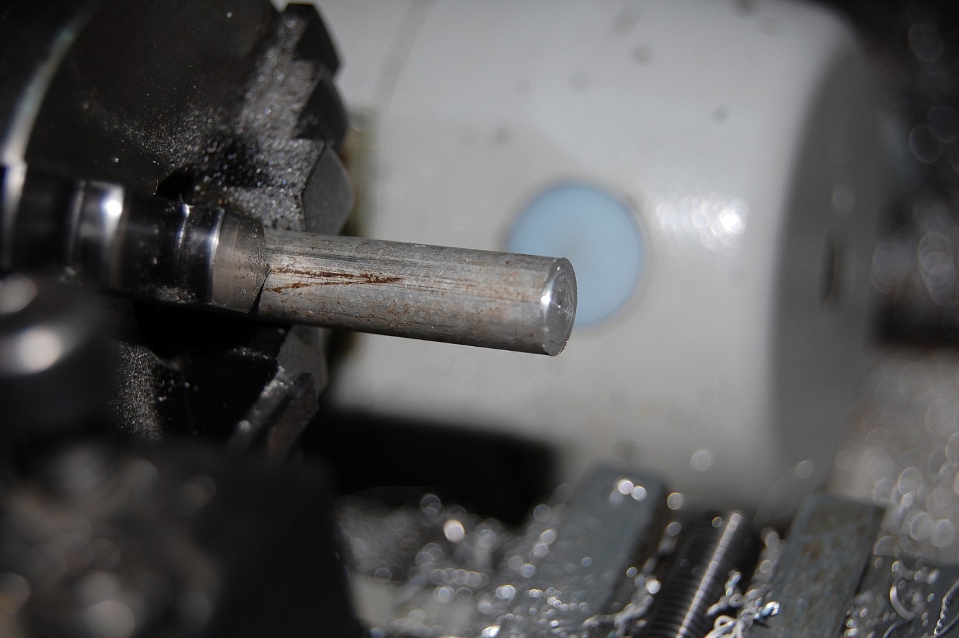

mr68gts Posted January 29, 2017 Author Share Posted January 29, 2017 (edited) Got the lathe out and got to making chips! This is one of the rear end spindles. The first one was a failure. There was an issue with a dimension in the printed parts. They are close but there wasn't enough of a lip to retain the 4 link bracket without sliding over the spindle so I made a new one with a bigger step in it. I may need to go in an change the dimensions a bit on the pattern for the spindle boss that will be printed so that it fits correctly without interfering with the tube since there are bolts that hold the caliper bracket on. What to do when you need a carriage stop and don't have one? You think outside the box and get ingenious lol! Using the tail stock as a back stop so I can machine the out half. Finished part. I though up another idea on how to do this but I will just make the 2nd one and carry on. The idea would require having new parts printed and there really is nothing wrong with these. Just a different way to do it. Edited January 29, 2017 by mr68gts Quote Link to comment Share on other sites More sharing options...

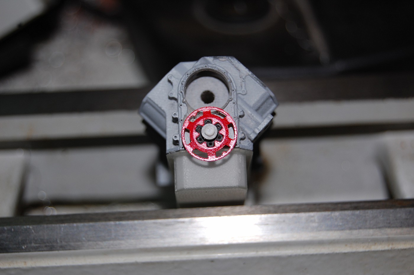

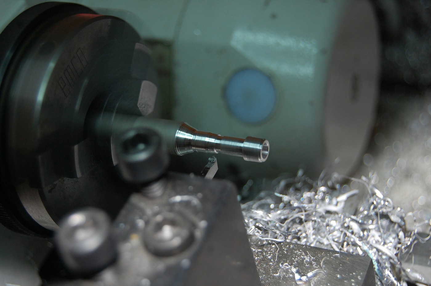

mr68gts Posted February 10, 2017 Author Share Posted February 10, 2017 Thank you guys! I can't believe it's finally here. I now need to scale it to other scales. Some of it will have to be combined to if I want it available in 1/25 scale. Most of the timing cover and such will probably be all one piece. Nice thing about larger scales is the detail you can add as it goes up in scale. In 25th scale I will probably have to add the hardware into the solid model to make it work and not have to worry about the bolts in that scale. Just have to see. Not too sure if the degree wheel will be printable or not though and that may be something that might have to be photo etched to still be there. So I machined the crankshaft stub this afternoon. Wasn't too hard to do. I really need to look into some tooling for this lathe. Have the tooling will help greatly in machining the parts I require but I make do with what I have. Still looking into mills at the moment though. Probably have to wait on the rotary table for a bit however. Various stages of machining the crank stub. Front half. Now keep in mind I took a print from a Chrysler Hemi crank and used that and modified the back of it obviously to work with my engine. I still need to machine the seal retainer but that's a project for tomorrow. The back half of the crank stub which registers with the hole in the block. In the block it sits! And the stack up of parts to make the assembly within the block. Quote Link to comment Share on other sites More sharing options...
