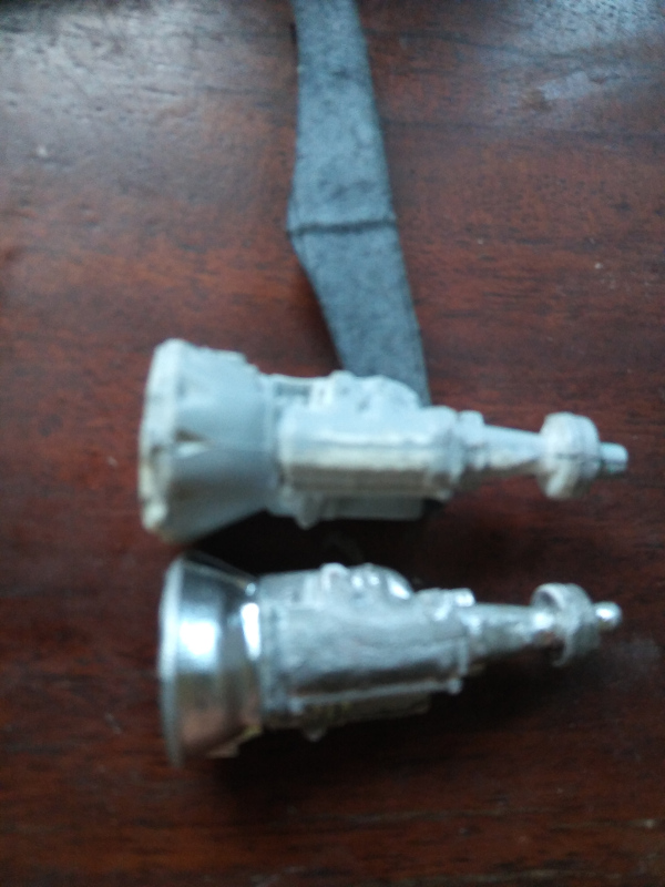

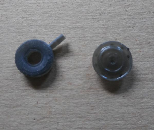

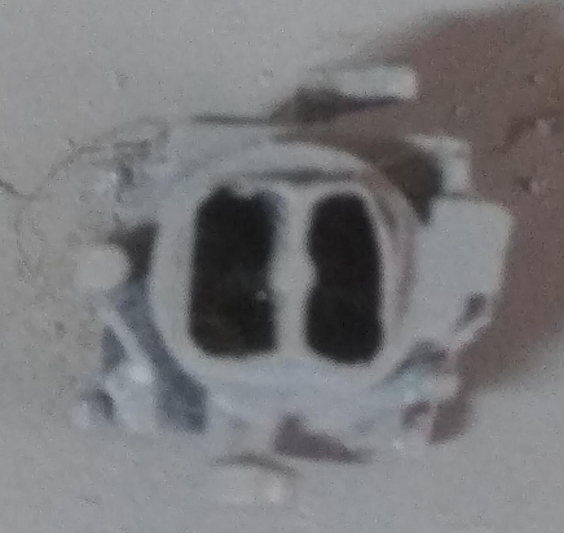

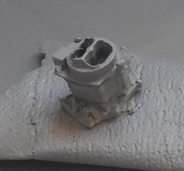

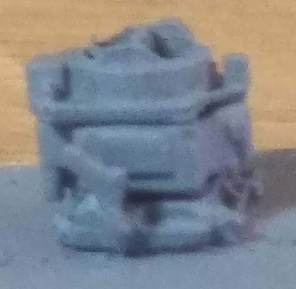

My time has freed up and I'm back to work on this project. Here are some pic's of the Carter wcfb carbs that Chrysler us on the 56, 57 and 58 cars.

Good looking carb. Remarkable resolution. I'm certainly interested in seeing how this progresses.

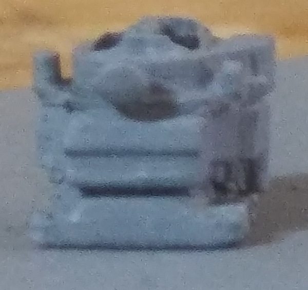

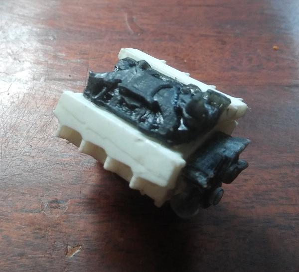

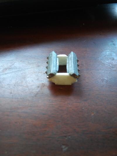

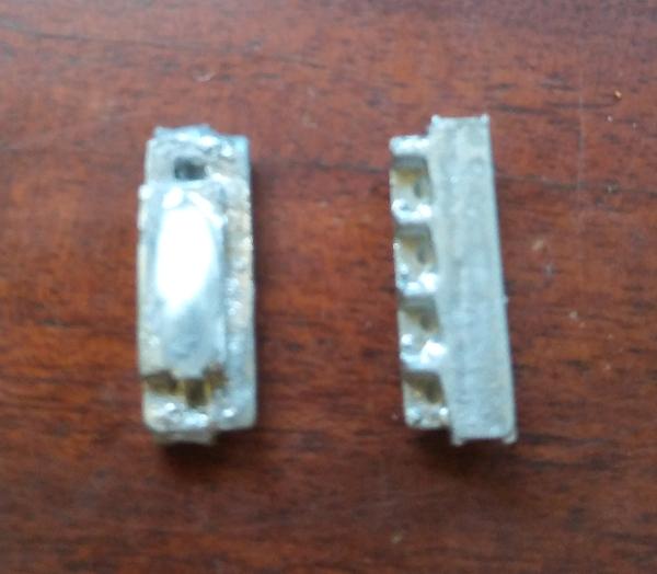

I'm moving right along on this project and plan on completion the end of May. I have successfully resin cast the block and heads. The heads have a location piece to help with getting them in the correct position. Once on the block, the intake manifold fits perfectly. The 4bbl manifold is about 2/3rds drawn.Selection_160.thumb.jpeg.b36890d8a1b3001

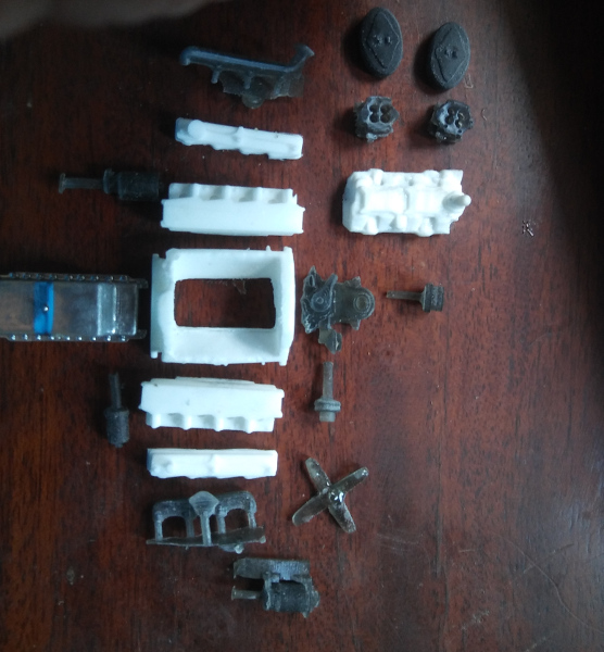

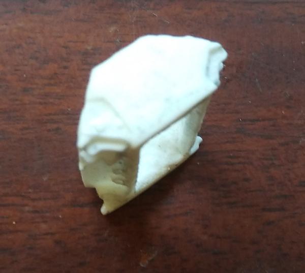

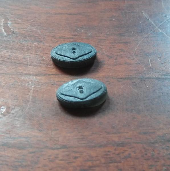

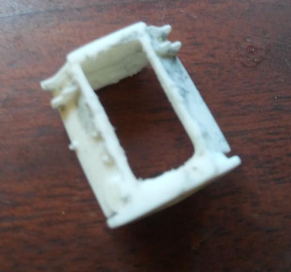

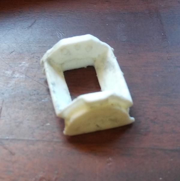

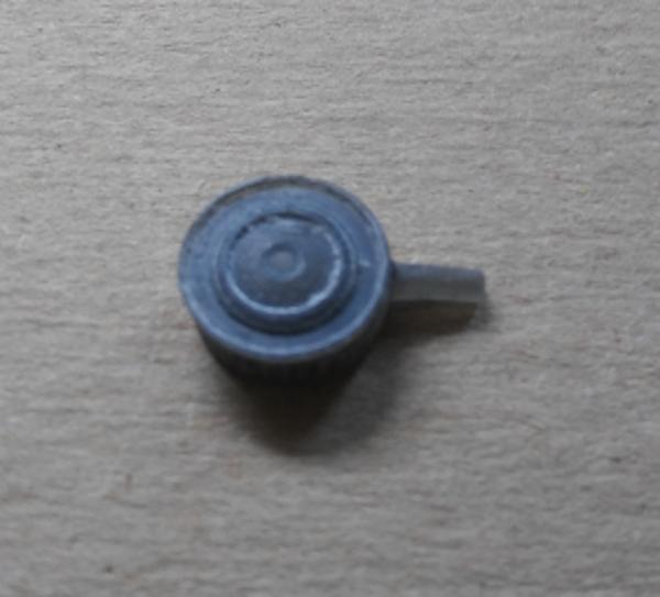

Some more parts ready. The block, heads, oil pan, timing chain cover w/fuel pump and water pump and single 4 bbl manifold.
20170610_165943.thumb.jpg.20b9783c0f8587
Duel quad air cleaners
20170610_170227.thumb.jpg.a93a66fd5b5a99
4 bbl air cleaner as it comes off the printer
20170611_140655.thumb.jpg.e7190596844592
4 bbl air cleaner sanding and glued together
20170611_140759.thumb.jpg.892bcb258a4d38

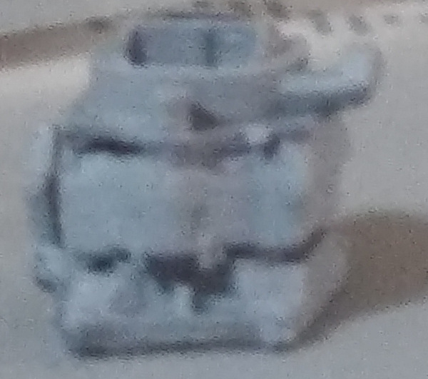

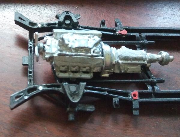

 Some new changes as I am using a single 4 bbl engine in my 59 Plymouth convertible project. The engine that comes in the 58 Plymouth is terrible beyond belief. AMT cut out details and fudged part sizes so that they could fit it into the engine bay. I'm using the 58 frame for the 59.     The bell housing on the 58 is the same size as the 57 Chrysler. I knew that the 318 poly engine had it's own bell housing for the A488 trans. and had drawn up a mostly complete file. As a result, I printed out a proper bell housing, cast the 57 trans. and bell housing and cut off the trans to attach to that bell housing. Here's the result.

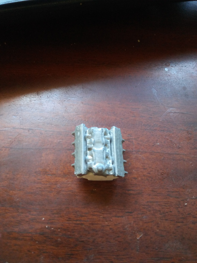

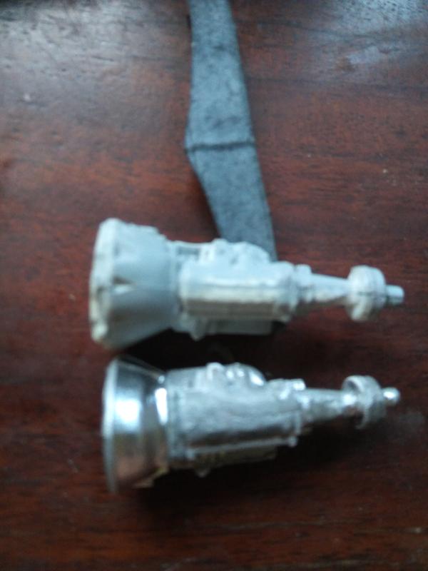

I am about done with this project. I created this engine for my personal use and one other person. Others have expressed an a desire to get one for themselves. There currently isn't a 2bbl option as it's not something I need. If I receive interest for some, I'll finish the intake manifold and create a Carter DDB carb for it. I have made a Face Book page with info on how to obtain the current versions. It's on the bottom of my posts below my name. If you aren't a Face Book person, text me.    Thanks to Bill Geary, aka  MrObsessive for his incredible build of the 58 engine. This is what I supplied him.

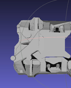

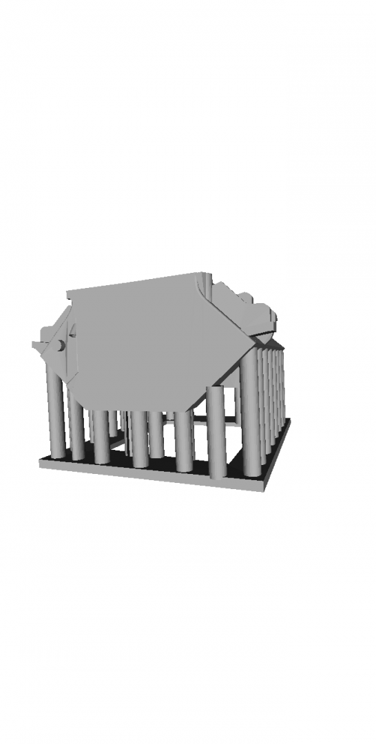

The 3d prints on a resin cured printer need supports in order for them to come out right. They have to be removed by clipping them close to the part and then sanding. Here is an example of the engine block stl. file used to print them. The prints do not come out flat on the bottom. You can see by the amount of supports on the block that there is a bit of sanding to do after the supports are removed.

I have made some changes after building the single 4bbl version and fitting it to the 58 frame that I am using on my 59 build. The fan pulley was shortened. The front of the oil pan was changed for better fit. The proper bell housing was drawn up and printed and had the trans from the 57 Chrysler A488 adapted. The carb is one of Joseph's AFB's.

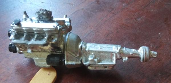

Doug, you are quite welcome! It was neat building the engine as it was a definite first for me, and I can honestly say when I get around to building and finishing the complete car, I can boast that it has a correct 3D printed engine! :D
