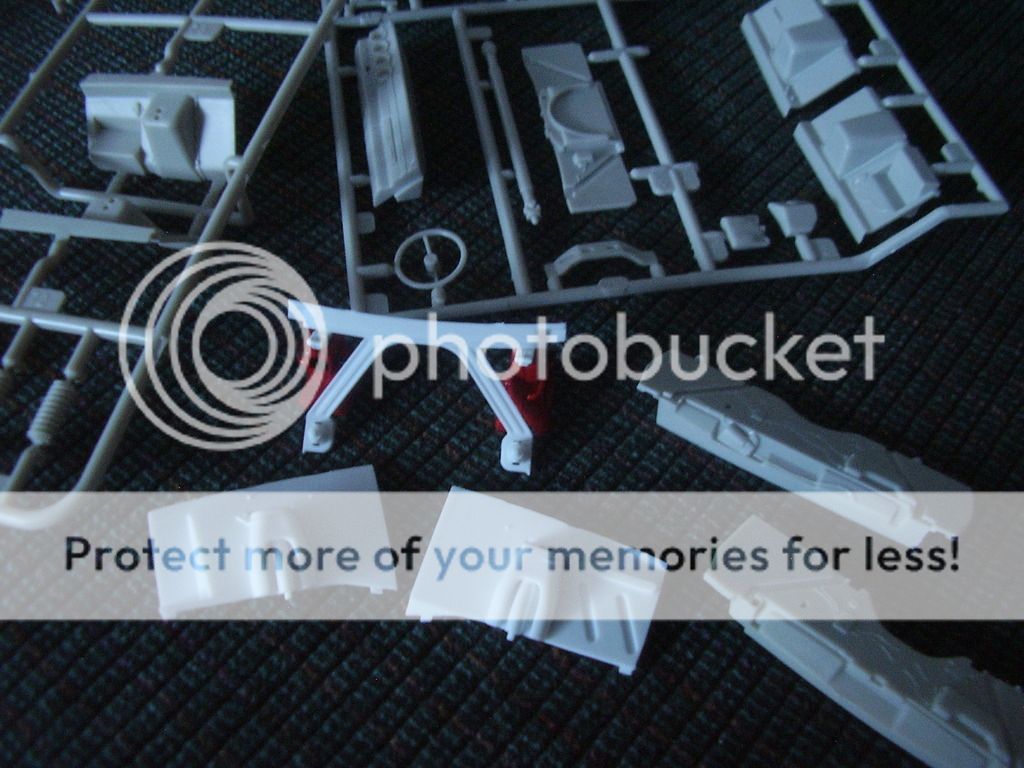

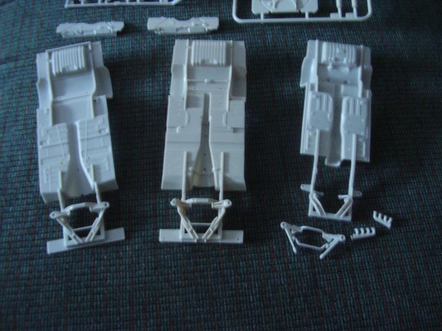

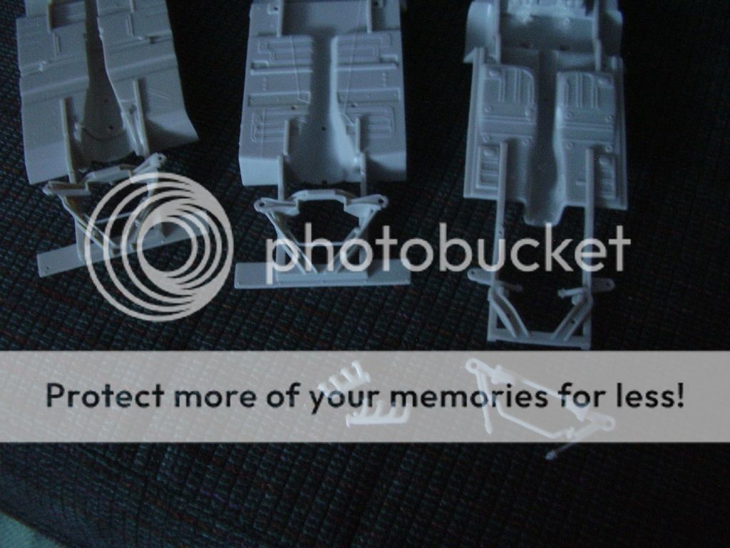

mk11 Posted January 6, 2017 Share Posted January 6, 2017 (edited) This sure is one mean little coupe Looks more aggressive and crisp with that sedan roof. The decision to 'adopt' the '66/67 fairlane/comet chassis and eng compartment style may have cut development time and probably won't matter to the majority of builders but it kind of throws a curveball at projects like this when you want to build it right. Just got back from a 'dig' to find some parts... '66 Comet chassis in middle, '67 Mustang parts on the right...good for a more detailed front end and various drivetrain stuff. <edit>Credit where credit is due dept...With some further research, it looks like the sweat invested by moebius on updates/backdates to the '66 chassis bring it closer to accurate than the mustang floorpan would be, but efforts to further detail front suspension will not be wasted The inner fenders and brace shown here are actually from the trumpeter falcon (credit the eagle eye of Chuck K for noticing this ) and are probably as close as you'll get in scale, other than the ones you're using. Who'd a thunk it? mike Edited January 13, 2017 by mk11 Quote Link to comment Share on other sites More sharing options...
Reeves Racing Posted January 6, 2017 Author Share Posted January 6, 2017 (edited) This sure is one mean little coupe Looks more aggressive and crisp with that sedan roof. The decision to 'adopt' the '66/67 fairlane/comet chassis and eng compartment style may have cut development time and probably won't matter to the majority of builders but it kind of throws a curveball at projects like this when you want to build it right. Just got back from a 'dig' to find some parts... Here's a comparison with a '67 mustang chassis on the right; probably the one to go with for basic accuracy and more detailed front end. The inner fenders and brace shown here are actually from the trumpeter falcon (credit the eagle eye of Chuck K for noticing this ) and are probably as close as you'll get in scale, other than the ones you're using. Who'd a thunk it? mike Thanks, I like the hardtops but I always liked the coupes too. Great reference material. I have one of the Trumpeter Falcons, I am going to open it up and look at what I might be able to use or copy for this build. Thanks for posting the comparisons. This will help a lot of guys wanting to use the chassis on other builds. The Moebius kit is a great kit (I think the AMT 66 Fairlane is a great kit too) and it will build a great shelf model of a 65 Cyclone. Edited January 6, 2017 by Reeves Racing Quote Link to comment Share on other sites More sharing options...

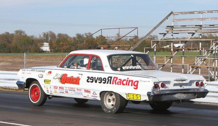

10thumbs Posted January 6, 2017 Share Posted January 6, 2017 Thanks Mitch for the info, greatly appreciated. I always liked built small blocks in small cars. Seems like the motor you guys built made to spin and the numbers from a small block and a probably fairly heavy car could still whoop on anything Detroit made from the muscle car days. I'll bet it sounded pretty healthy too. I remember in '66 or so a local Ford dealership sponsored a couple of cars, notably a Falcon with a really loud, snappy 289 block. The car was immaculate and ran well too and I enjoyed having a peek at the car on the property of the dealership, a notable Ford performance dealer. a Thunderbolt was also there. Very cool cars.Thanks. Quote Link to comment Share on other sites More sharing options...
Reeves Racing Posted January 6, 2017 Author Share Posted January 6, 2017 Thanks Mitch for the info, greatly appreciated. I always liked built small blocks in small cars. Seems like the motor you guys built made to spin and the numbers from a small block and a probably fairly heavy car could still whoop on anything Detroit made from the muscle car days. I'll bet it sounded pretty healthy too. I remember in '66 or so a local Ford dealership sponsored a couple of cars, notably a Falcon with a really loud, snappy 289 block. The car was immaculate and ran well too and I enjoyed having a peek at the car on the property of the dealership, a notable Ford performance dealer. a Thunderbolt was also there. Very cool cars. Thanks. Thanks, It wasn't a world beater but it was dependable and a super fun hobby racer. My dad has a 63 Biscayne called Bis-Quick and we both used to race together a lot when I lived in Kansas. Quote Link to comment Share on other sites More sharing options...

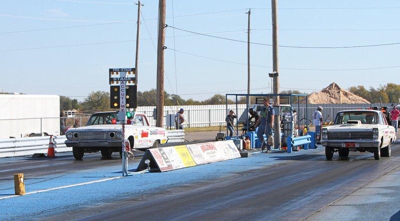

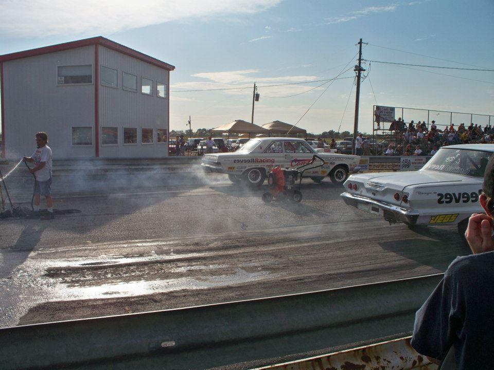

W-409 Posted January 6, 2017 Share Posted January 6, 2017 (edited) I really like the look of both cars. What ETs does that Biscayne run and what engine it has? That's not the lightest car, but it has lots of cool factor!Spending some great time with dad at the Drags is a lot of fun! I drive a '74 Malibu in Stock Eliminator and we built the car together with my dad and now we're racing together too, daddy-o being the second and only team member. Edited January 6, 2017 by W-409 Quote Link to comment Share on other sites More sharing options...

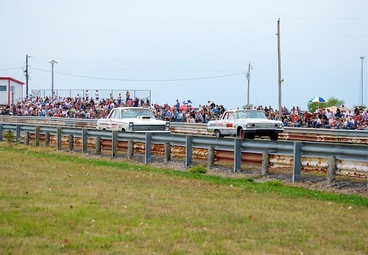

10thumbs Posted January 8, 2017 Share Posted January 8, 2017 (edited) Looks like your Dad has a 283, correct? I'd put my money on your car. Really great stuff that you two can be together like this, what a wonderful deal. I like both cars. Just one thing of interest now, this pic; The tilt of the front wheels when leaving, this was a definite Ford thing. GM and Mopars did not show this, if I remember correctly. The Thunderbolts were extreme, there were two in my area and they ran well. I'll never forget the way they looked when launched. I don't have a clue to the terminology. Just it seems only Fords showed this, bottom of tire way out when the body lifted. Edited January 8, 2017 by 10thumbs Quote Link to comment Share on other sites More sharing options...

Reeves Racing Posted January 9, 2017 Author Share Posted January 9, 2017 I really like the look of both cars. What ETs does that Biscayne run and what engine it has? That's not the lightest car, but it has lots of cool factor!Spending some great time with dad at the Drags is a lot of fun! I drive a '74 Malibu in Stock Eliminator and we built the car together with my dad and now we're racing together too, daddy-o being the second and only team member.Thats cool Niko, I think its great when you can spend good times with family.The Biscayne was running similar times as the Comet but in all the time we raced (a couple of dozen) Dad never beat me. His car has a 350. Its faster now it runs 12.50s, Quote Link to comment Share on other sites More sharing options...
Reeves Racing Posted January 9, 2017 Author Share Posted January 9, 2017 Looks like your Dad has a 283, correct? I'd put my money on your car. Really great stuff that you two can be together like this, what a wonderful deal. I like both cars. Just one thing of interest now, this pic; The tilt of the front wheels when leaving, this was a definite Ford thing. GM and Mopars did not show this, if I remember correctly. The Thunderbolts were extreme, there were two in my area and they ran well. I'll never forget the way they looked when launched. I don't have a clue to the terminology. Just it seems only Fords showed this, bottom of tire way out when the body lifted. Dads car has a 350. When we raced head to head he never beat me. He has since done some more work to his car and it runs 12.50s so as of the last time I was able run the Comet before I sold it he's faster now. The GM cars can have a lot of negative camber on launch too. You probably just saw more Fords with the front ends up than you did Chevys... Quote Link to comment Share on other sites More sharing options...

RancheroSteve Posted January 9, 2017 Share Posted January 9, 2017 The tilt of the front wheels when leaving, this was a definite Ford thing. GM and Mopars did not show this, if I remember correctly. The Thunderbolts were extreme, there were two in my area and they ran well. I'll never forget the way they looked when launched.I don't have a clue to the terminology. Just it seems only Fords showed this, bottom of tire way out when the body lifted.On the Thunderbolts at least, they had to make some modifications to the front suspension in order to make room for the big block - moving the shock towers and mounting points outward and re-engineering (likely shortening) the upper arms - so anything close to factory geometry went out the window. I'm guessing those modifications produced some unusual camber curves when the car launched and the front lifted. Quote Link to comment Share on other sites More sharing options...
