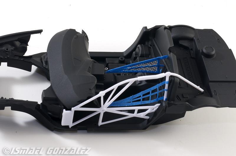

thank you very much I'm very interested in how you did the inner window net , I don't plan to make my own water jug but I did find some clear wire cover small enough that I'm going to run rpm it to make the drink tube , also plan on making some of the electronic boxes
Share this post
Link to post
Hello,
   There are 2 main nets inside: One in the door and the one inside at the driver's right.  For the one inside, I used a metal mesh material from an old kitchen strainer and did the basic triangle shape. You can use the kit's part as a template for size.  The blue you see is blue painter's masking tape.  Upper, lower and back are strips that just wrap both sides.  The center is a very thin strip.  The outer net on the door is quite different. It is not a mesh material but rather a more traditional woven net.  That one is easier as it was done with strips of the same masking tape and even thinner strips for the verticals and the middle one.  I added a round bolt to attach the front of the inside net. The drinking tube runs from underneath the cooler up to the net and into the front of the net.  Before painting, the nets are slightly bent to force a little sag and prevent them from looking like a solid chunk.
Word of caution: We love to add all those little details but these are not visible once the model is done.  That's why I didn't bothered with my original idea of doing a real tubing soldered roll cage like I did in the Camaro.

totally helped thanks alot !!!
