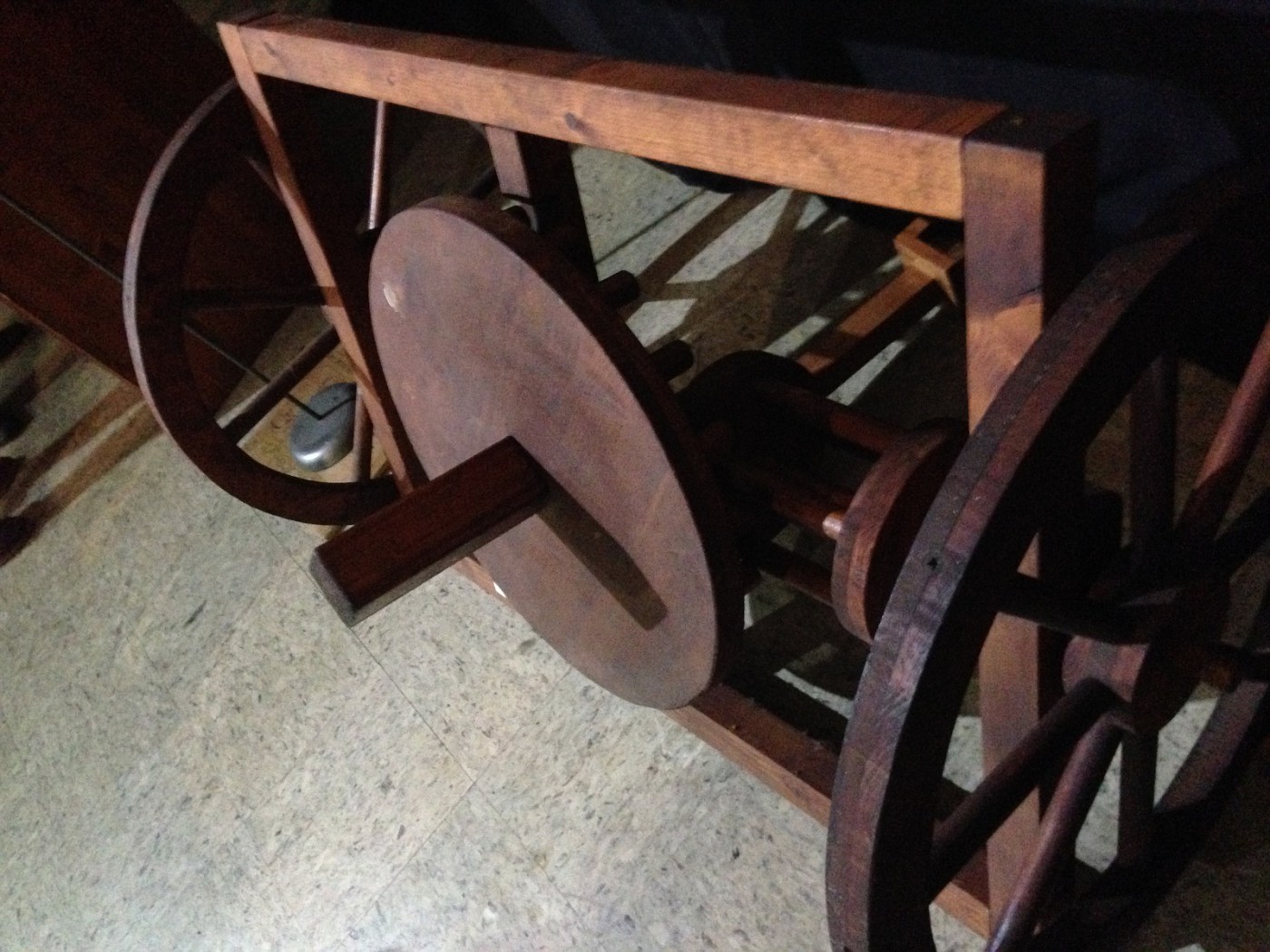

Scott Colmer Posted January 28, 2017 Share Posted January 28, 2017 Went to the San Diego Museum of Natural History's Leonardo D Vincci exhibit and found this example of a rear differential designed to let cart wheels rotate a different speeds during turns. L.D. has always been one of my heroes. Hosted on Fotki Quote Link to comment Share on other sites More sharing options...

Ace-Garageguy Posted January 29, 2017 Share Posted January 29, 2017 While I've been a lifelong fan of Leo D., the explanation of a "rear differential designed to let cart wheels rotate a different speeds during turns" kinda begs the question of why the cart wheels weren't simply placed on bearings so that they could rotate separately?...which just about ANY cart or wagon wheels were. The need for a differential is non-existent unless the "cart wheels" are mounted rigidly to the ends of an axle powered by something...not dragged down the road by a horse, ox, donkey, etc. Quote Link to comment Share on other sites More sharing options...

JollySipper Posted January 29, 2017 Share Posted January 29, 2017 He came up with an unnecessarily complicated solution to a problem that wasn't really that big a deal to start with? Could Leonardo have been part German? Nah, ol' Leo presented to the World a complicated "bad" idea so that future generations could look at his designs and say 'there's a better way to do that'.......A man ahead of his time! Look at some of his flying machines and you'll see what I mean....... Quote Link to comment Share on other sites More sharing options...

Ace-Garageguy Posted January 29, 2017 Share Posted January 29, 2017 Could be that he was so taken by the idea of creating a cart differential that he never really stopped to ponder if such a thing was needed in the first place. Or just mounting the wheels independently was too simple of a solution. Maybe he had some use in mind for the resulting "flywheel" on the back... kind of makes you wonder. Indeed. Sure would be interesting to know what he was really thinking of. The differential effect as applied to a "cart designed to measure distances" wouldn't be necessary if one simply used a single wheel in the center of the whole affair connected to whatever the measuring apparatus was to have been. Probably somewhere in his lost papers there was a drawing of a diesel-electric power unit too. Quote Link to comment Share on other sites More sharing options...
Dodge Driver Posted January 29, 2017 Share Posted January 29, 2017 Indeed. Sure would be interesting to know what he was really thinking of. The differential effect as applied to a "cart designed to measure distances" wouldn't be necessary if one simply used a single wheel in the center of the whole affair connected to whatever the measuring apparatus was to have been. Probably somewhere in his lost papers there was a drawing of a diesel-electric power unit too. I found a different photo of the cart and it's a stand alone creation, not a derivative of the odometer. I was wrong about that. Quote Link to comment Share on other sites More sharing options...

Lunajammer Posted January 30, 2017 Share Posted January 30, 2017 While I've been a lifelong fan of Leo D., the explanation of a "rear differential designed to let cart wheels rotate a different speeds during turns" kinda begs the question of why the cart wheels weren't simply placed on bearings so that they could rotate separately?...which just about ANY cart or wagon wheels were.I wonder if it had to do with lateral stability over rough roads so your, um, donkey is getting less jostled. Italy was probably kind of rocky. Yes, it would be interesting to know what problem of the day he was trying to solve. Quote Link to comment Share on other sites More sharing options...
Scott Colmer Posted January 31, 2017 Author Share Posted January 31, 2017 Hmm. I'm trying to think. Did they have berings then? I saw some at the exhibit too, but they were very large. Here is a link to the differential. I'm not sure if it answers the question as to "Why?" http://www.abc.net.au/news/2016-04-19/a-model-of-da-vincis-design-of-a-cart-with-a-differential./7336748 Quote Link to comment Share on other sites More sharing options...

Ace-Garageguy Posted February 1, 2017 Share Posted February 1, 2017 (edited) Hmm. I'm trying to think. Did they have berings then? I saw some at the exhibit too, but they were very large. A "bearing" is just about anything where two surfaces slide on each other. Bearings on wooden wheels on carts can be nothing more than a hole in the center of the wheel, with the end of the wooden axle sticking through, lubricated with animal fat or tallow.There'd be no need for any "differential' with the wheels rotating freely on the axle this way.Bearings were also made from other materials to prevent like-materials from being in contact with each other. Strips of lead or leather were common. Strips of leather have been used as emergency "bearing" material for 20th century automobile wheels and even internal engine parts, notably during the Dust Bowl migrations. Edited February 1, 2017 by Ace-Garageguy Quote Link to comment Share on other sites More sharing options...
