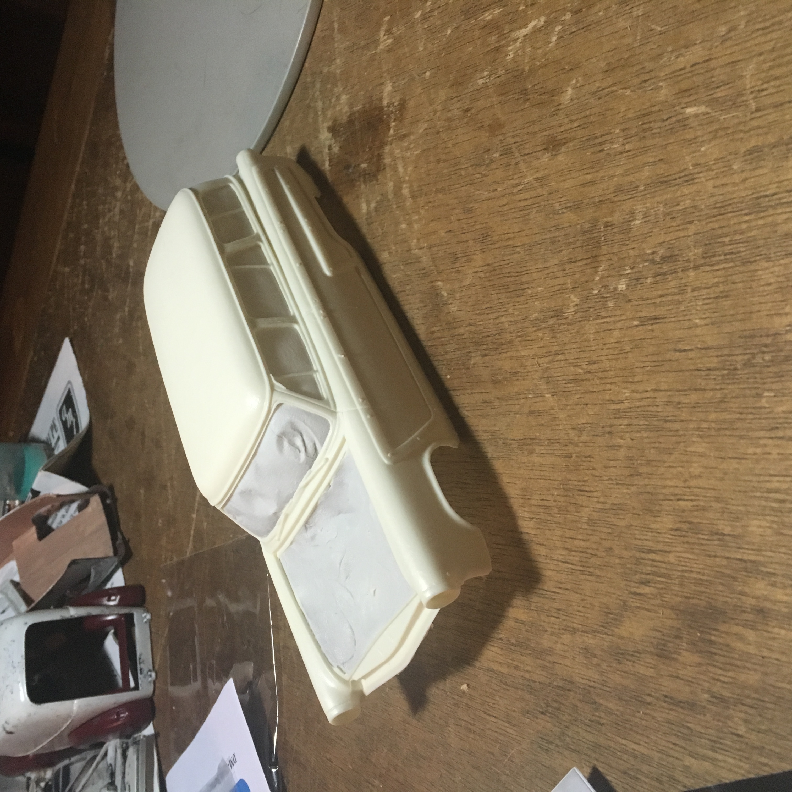

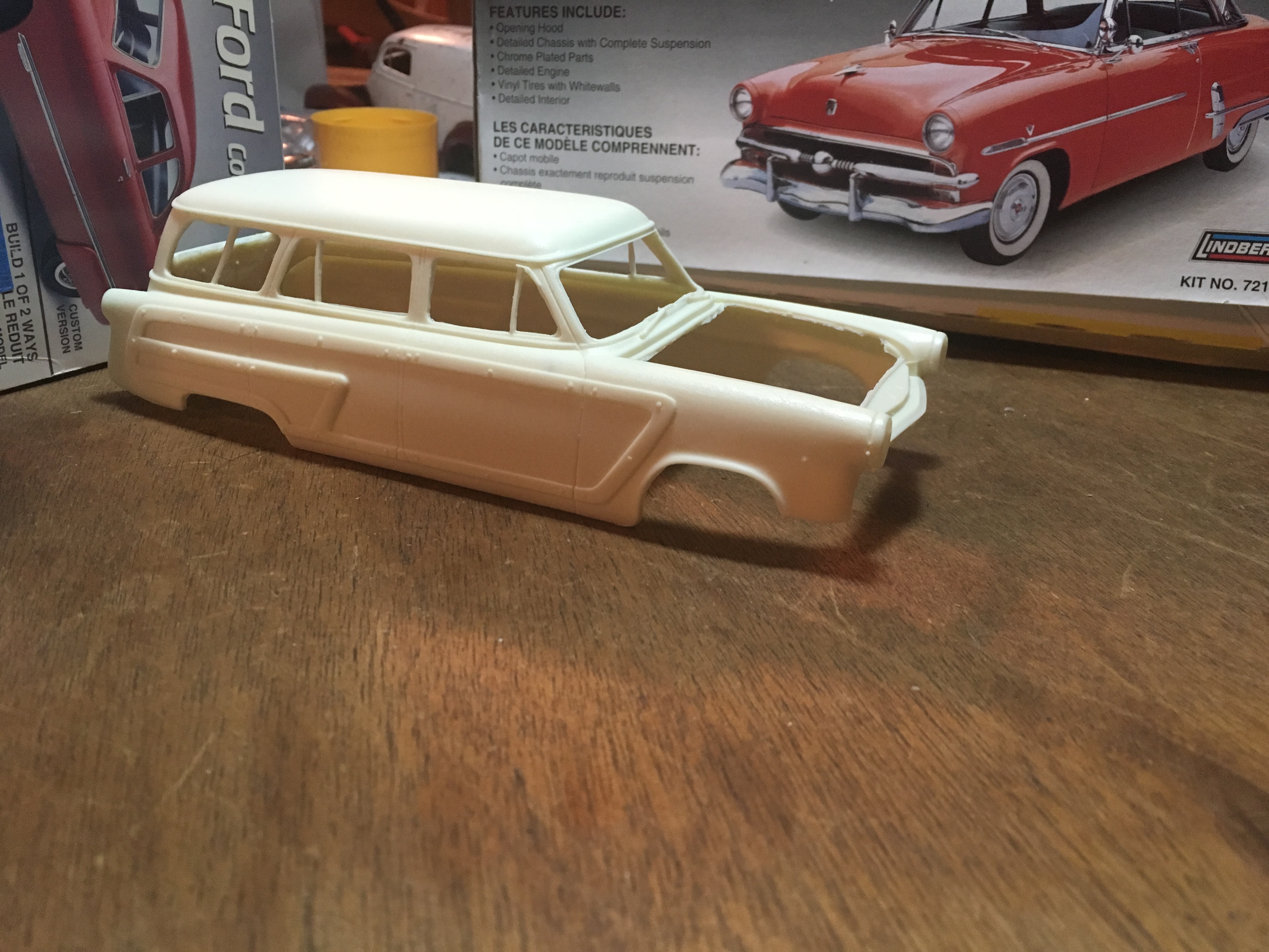

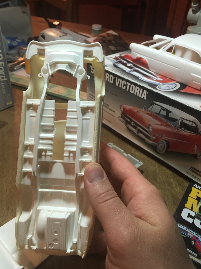

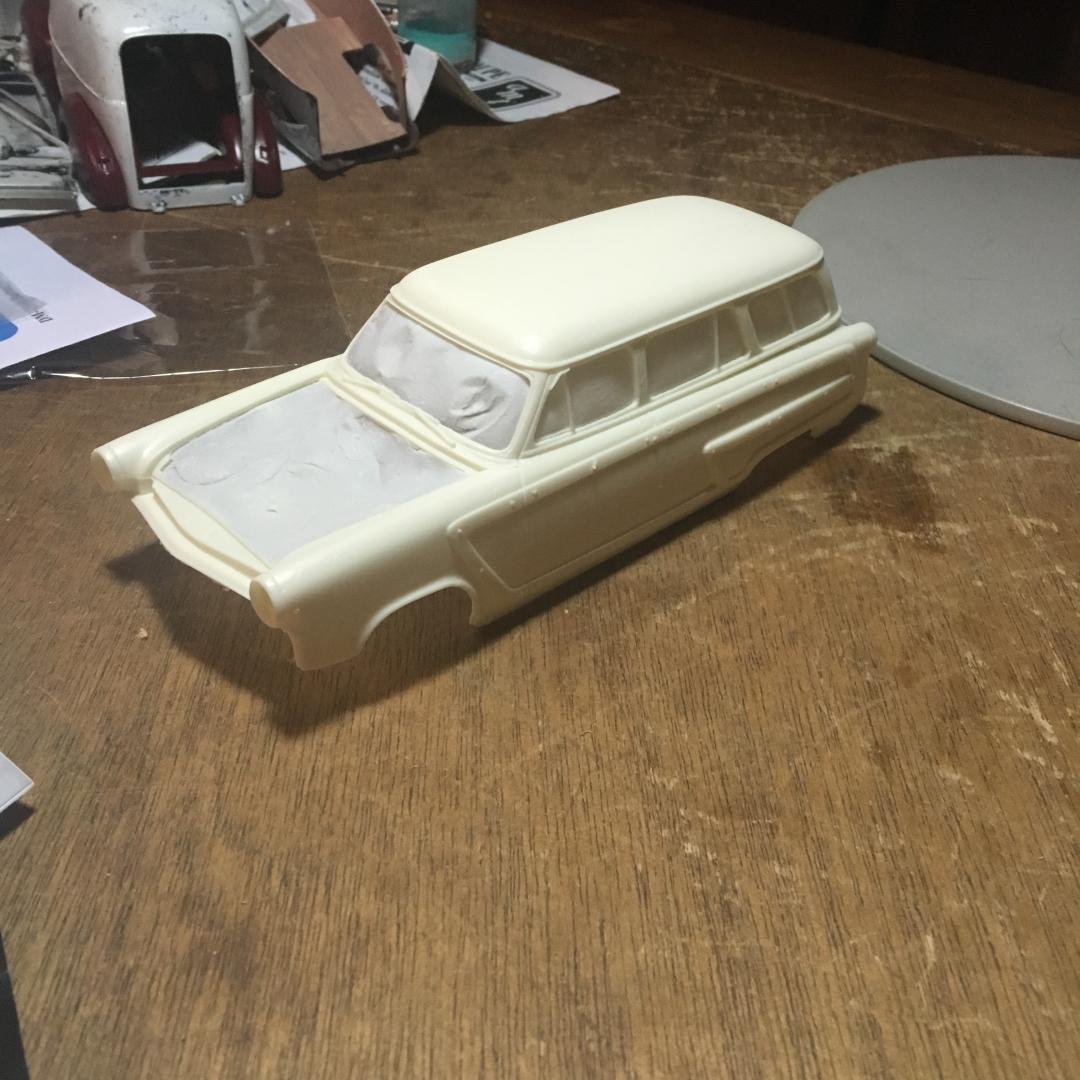

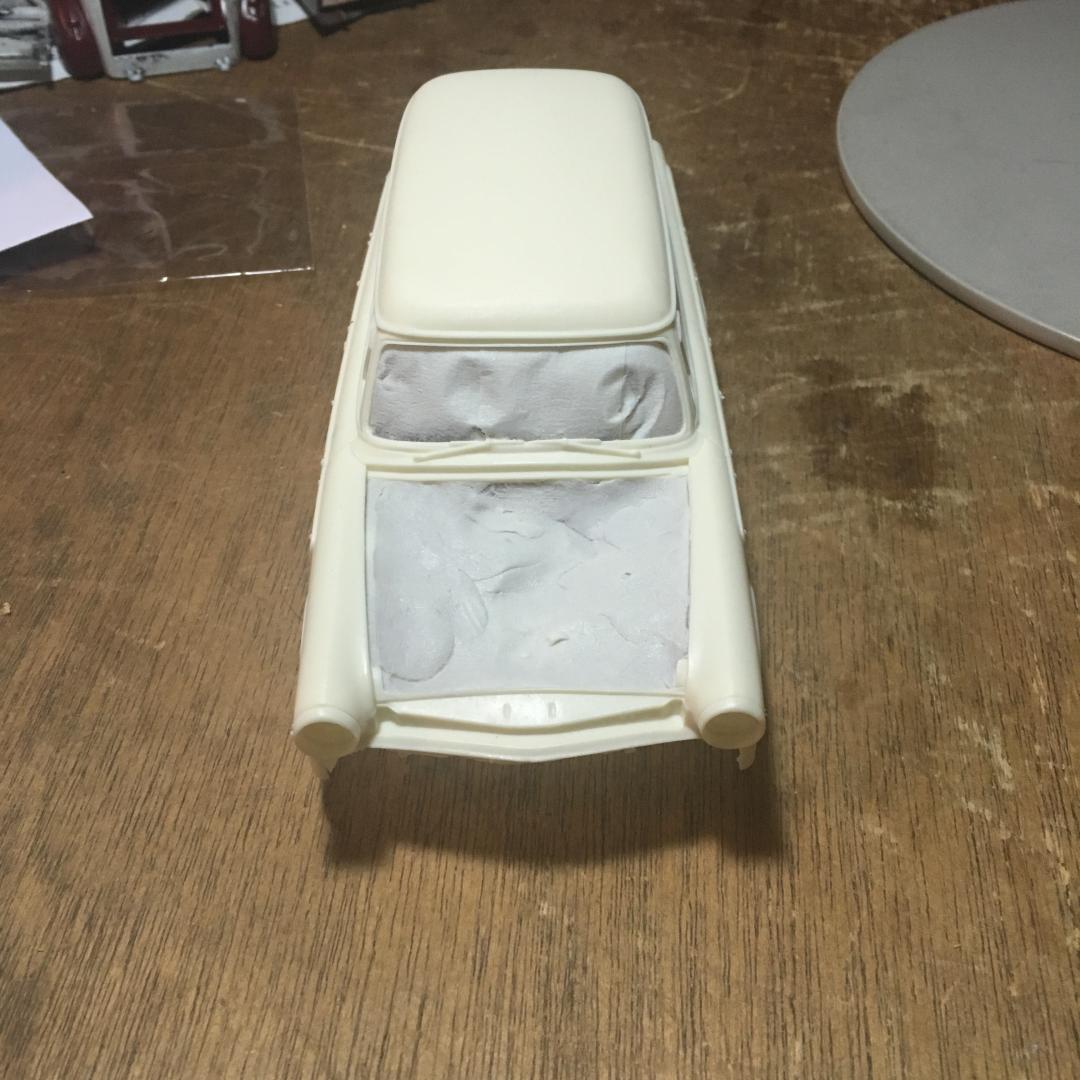

I picked up this Jimmy Flintstone wagon after some helpful tips from members here on the forum.   Scored the donor kit for pretty cheap on eBay, and here we go.  Hood fits perfect, and the chassis will fit after a little sanding.

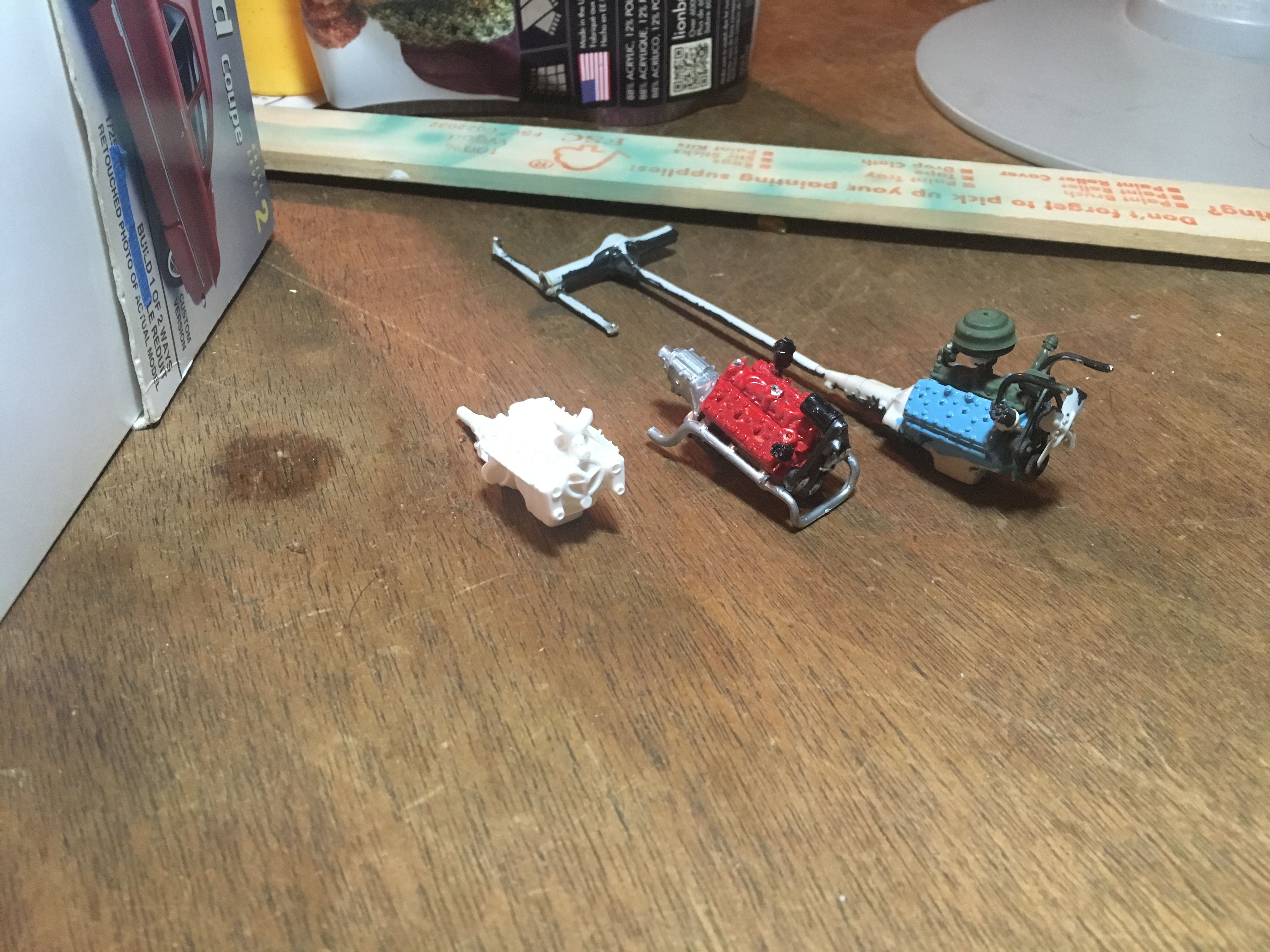

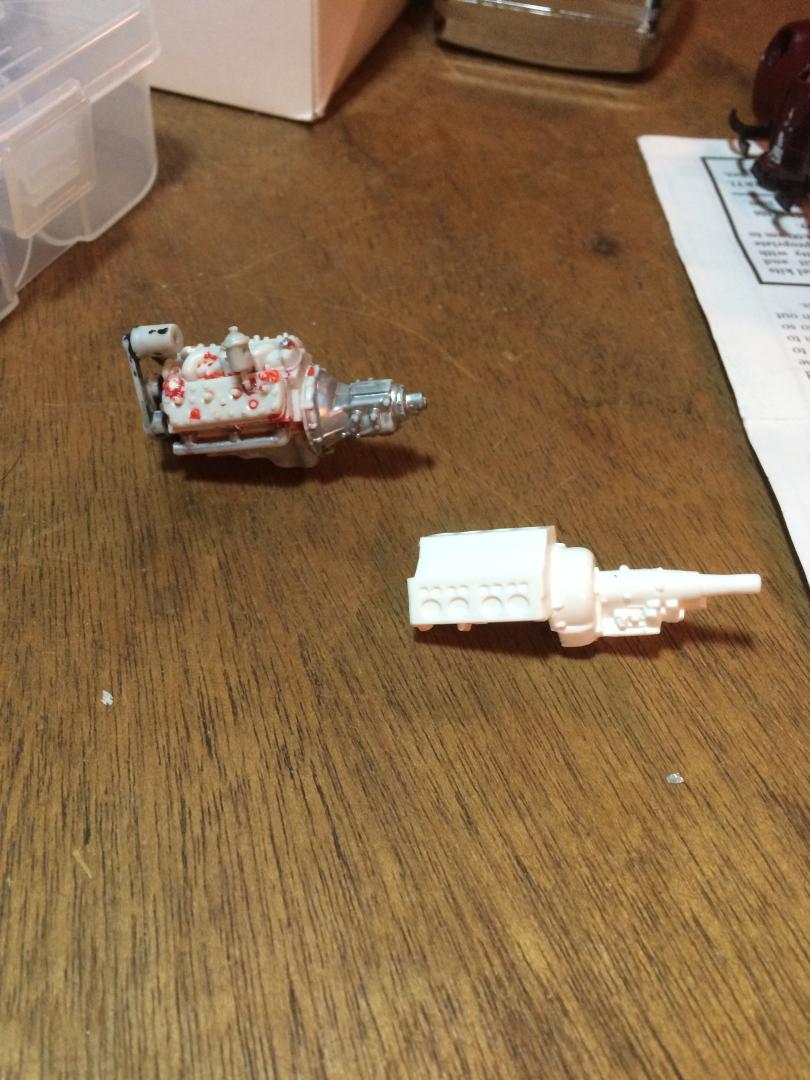

I'm not sure which engine to use.  The Lindberg engine has good detail, but the heads look too square and thin.  I also have a flathead from the AMT 53 pickup, and the 49 Ford coupe.  I may use the heads from the 53.  Not sure yet.

I'll enjoy watching this one. I have threatened to buy one of these in the past but something else always comes up. The bottom edge of the casting looks a little thick and some small bubbles. This seems to be common on most castings I have used, but with a little sanding it would be good. You mentioned the chassis fit and this may help with that. This looks like a very well done body. How is the detail on the "wood" ??

One of our club members started work on one of those, which prompted me to pull the trigger on one of those. I have not started on mine yet, as I have to make up the rear compartment, which does not seem to be too hard to do. I will be following this build very closely.

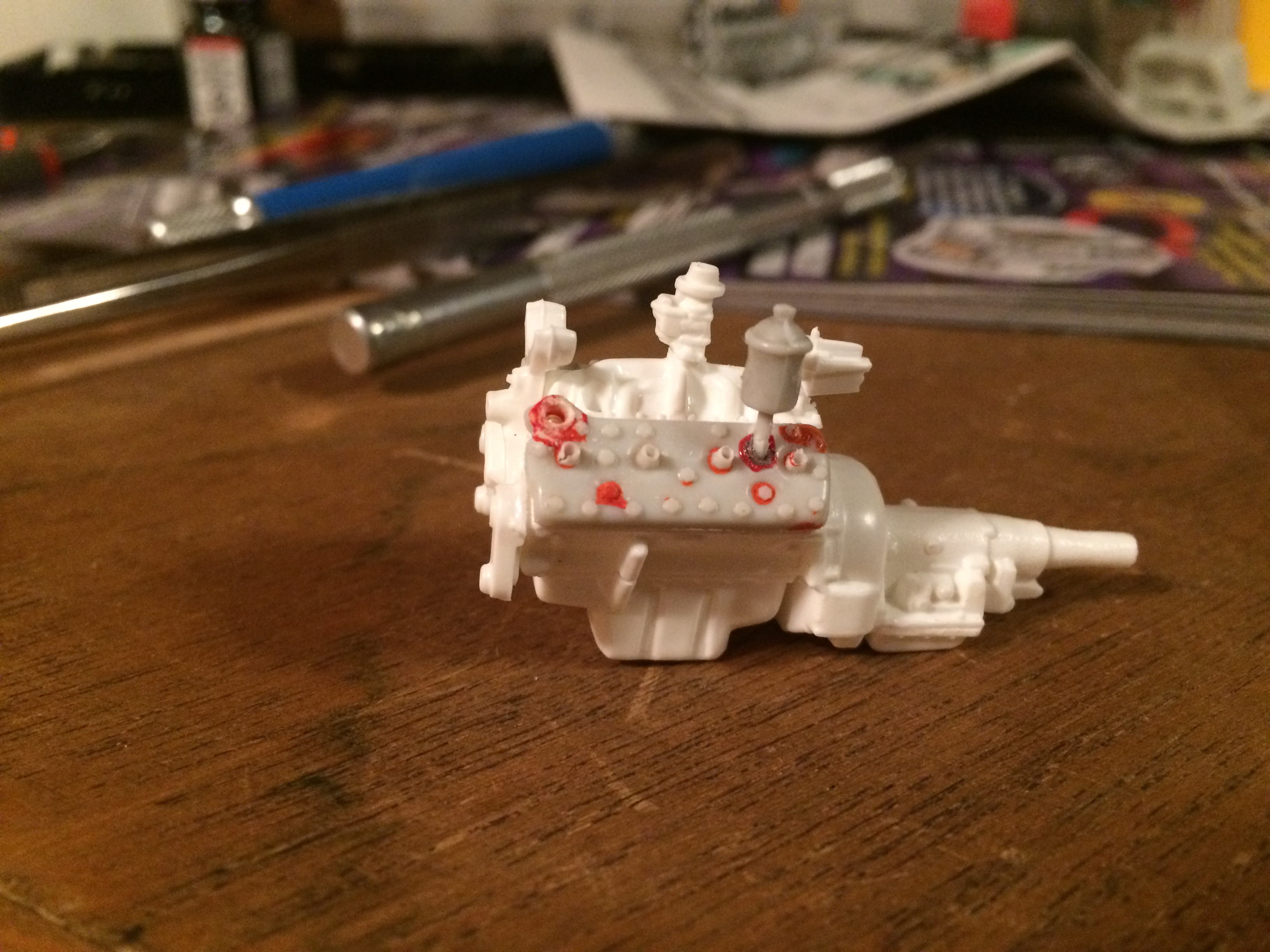

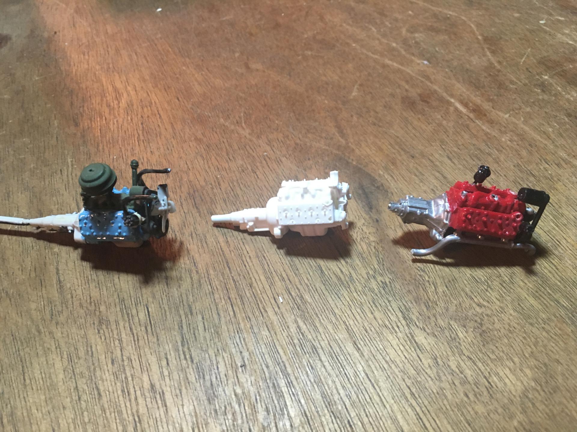

I had a couple flathead options, and I decided to use the Lindberg engine, but use the heads from the 53 ford pickup.  I thought they look a little better.
Share this post
Link to post
Excellent choice. LIndberg just didn't capture the shape of the heads correctly IMHO. They could be true to scale for all I know, they just don't "look" right. AMT seemed to get it "right", especially with the '53 F100 heads. Lindberg's block is excellent, though, especially if you had a plan to show an engine with a head off, and the separate exhaust is killer compared to the molded on blobs on the '49 and '50 Fords. Remember, though; that the '53 Fordomatic did NOT have oil cooler lines running to the radiator; it was air-cooled by fins welded on the torque converter and had air vents on the bellhousing.
Did the 1953 1:1 have real wood on the sides, or were they steel panels painted (or decaled) to resemble wood?  The 1950's were  a long time ago but one of my Mom's brothers had one, and I seem to remember the "wood" panels being held on with coat-hanger wire in places.
Edited by tedd60
Share this post
Link to post
The 1953 Squire were the last to have real wood trim, but just the borders and not structural. The inserts were "DiNoc", or vinyl decals. The next year they had fiberglass borders and the dinoc and became "wallpaper woodies"

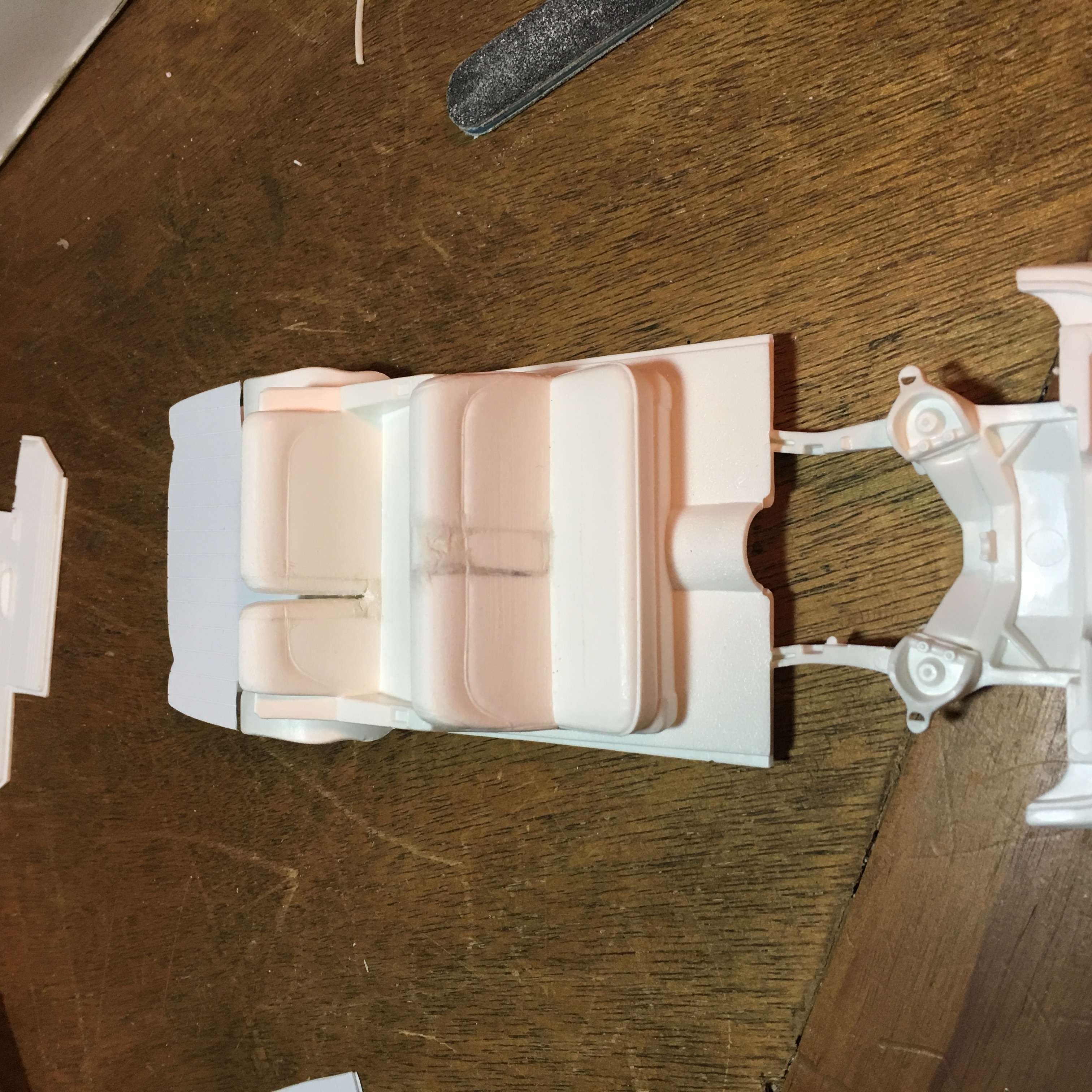

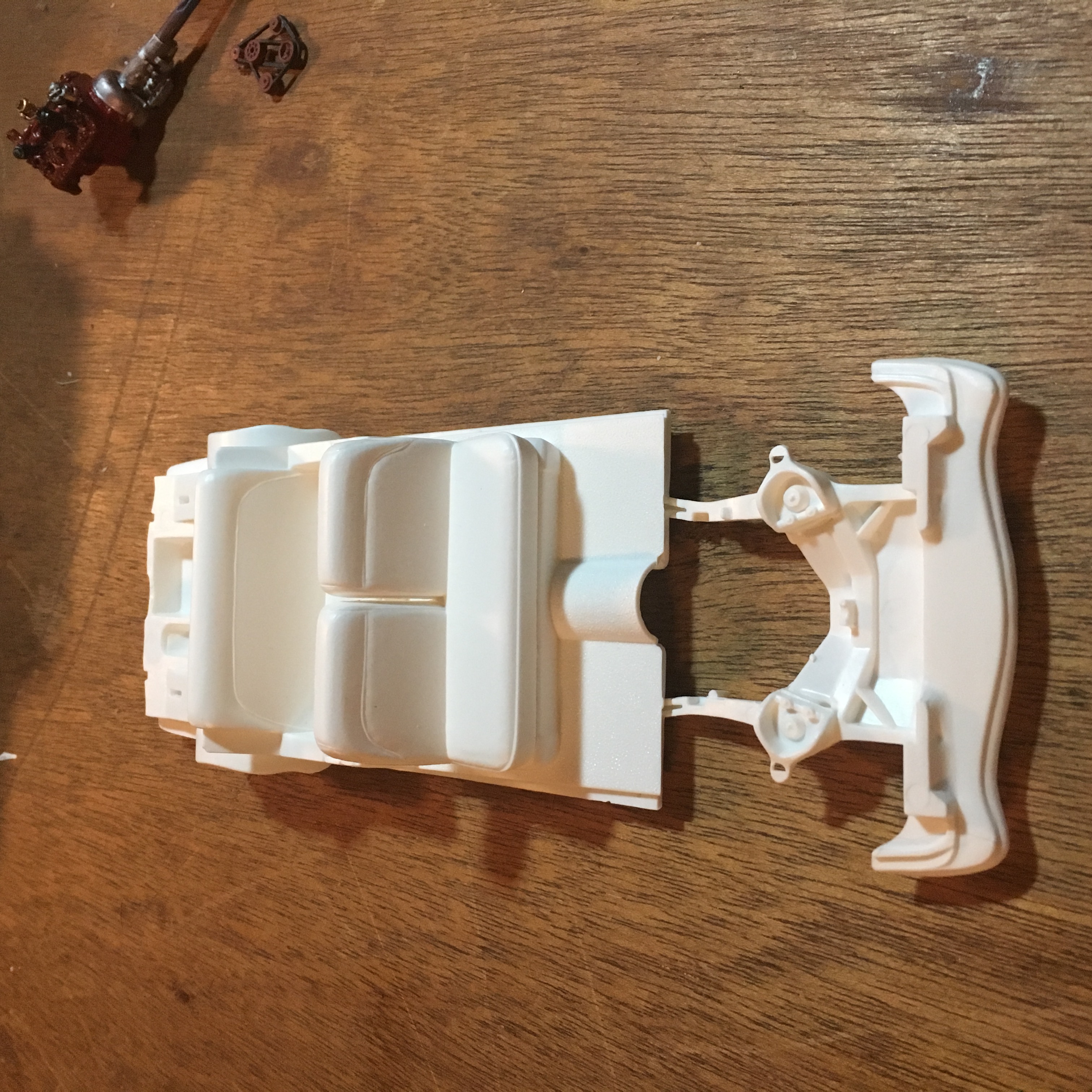

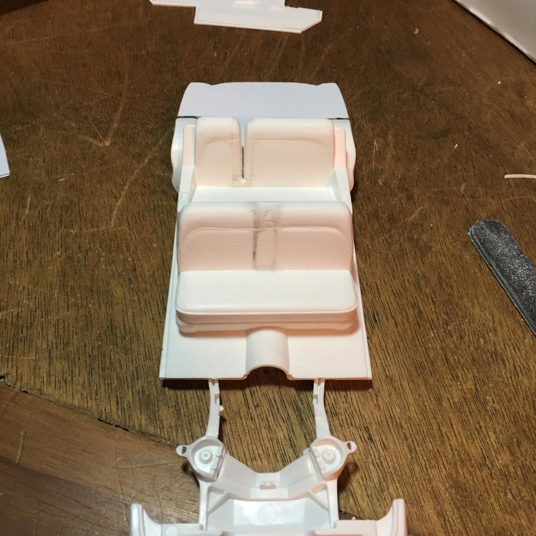

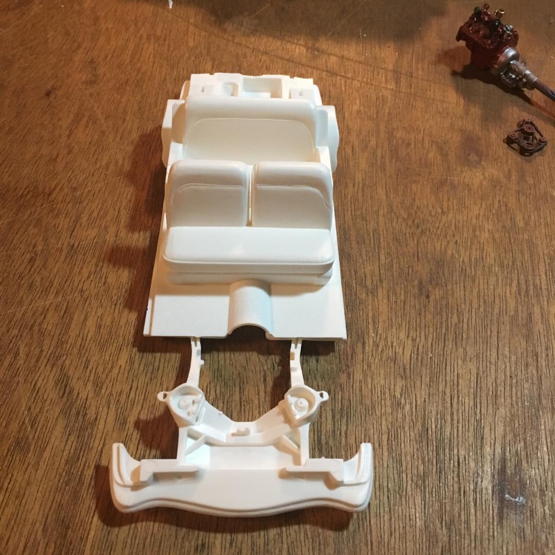

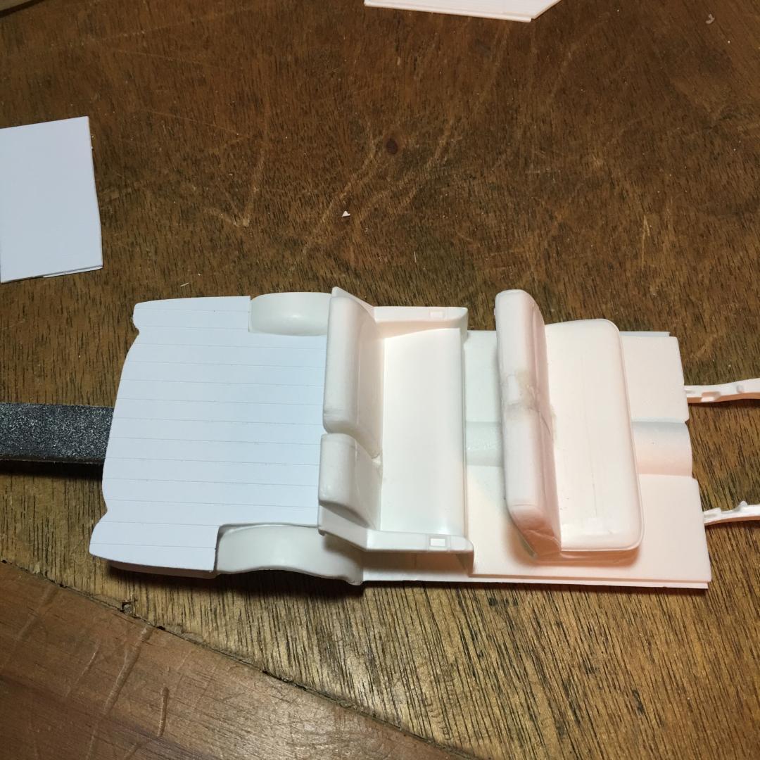

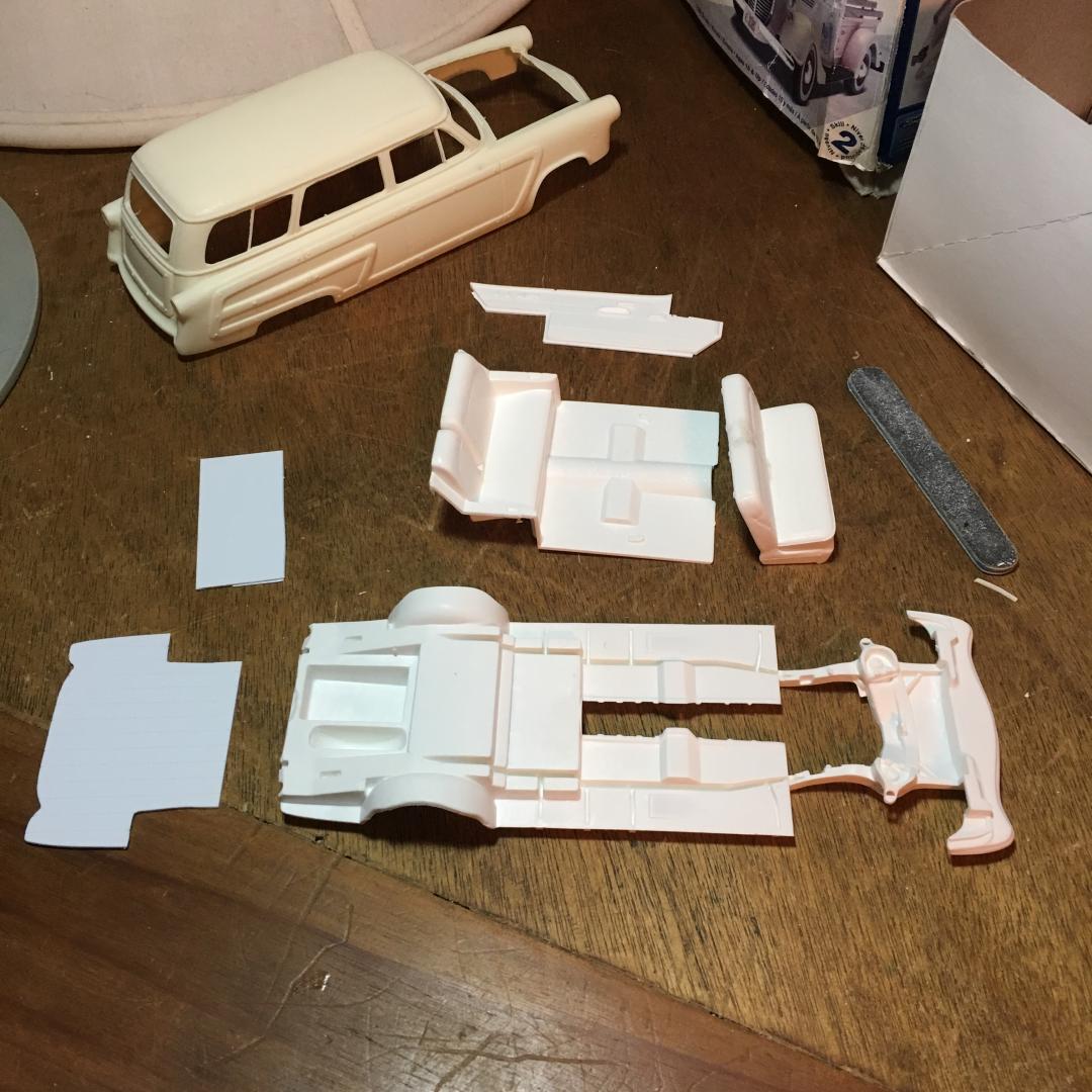

I worked on the seats and cargo area.  Its surprisingly hard to find pictures of the interior of these cars.  The front is a bench, and the middle seat is split.  I cut out the split from the front seat and grafted it into the rear.
