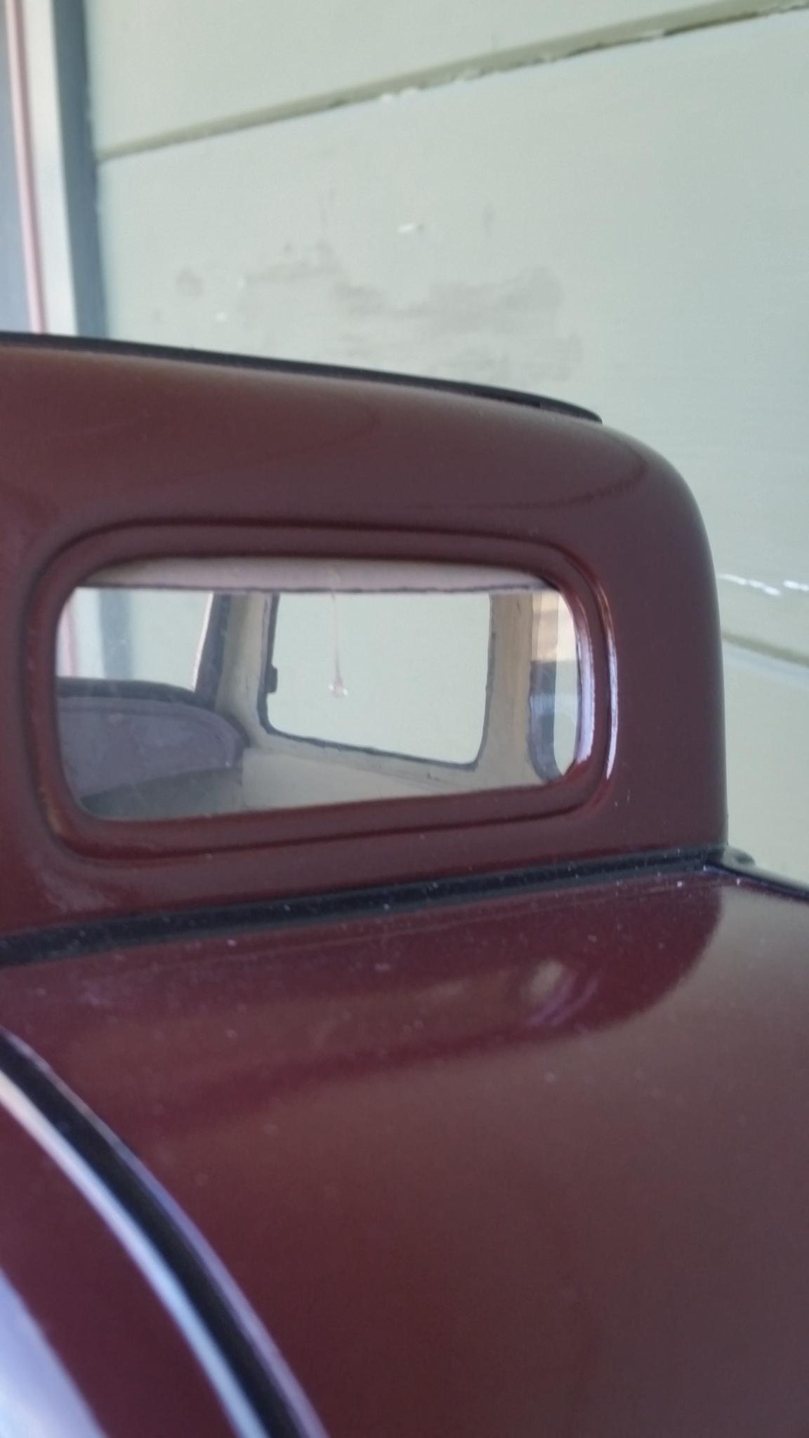

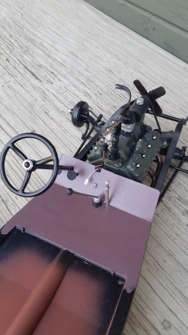

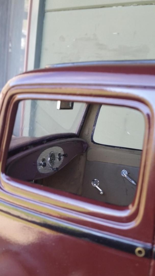

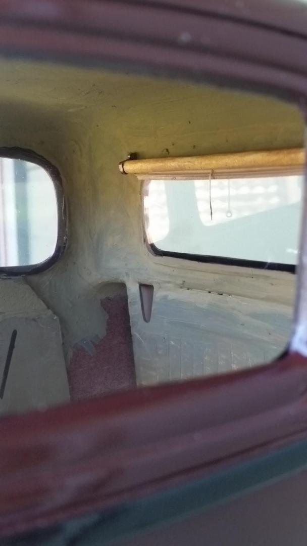

happy new year!  I now have the interior completed-all  scratch built except the seat which i ended up filling with putty to get rid of the contours. the floor mat was painted the correct taupe color. the window shade for the rear window was fun- it is an old paper rolled up with scratch brackets and pull string.. here are some images

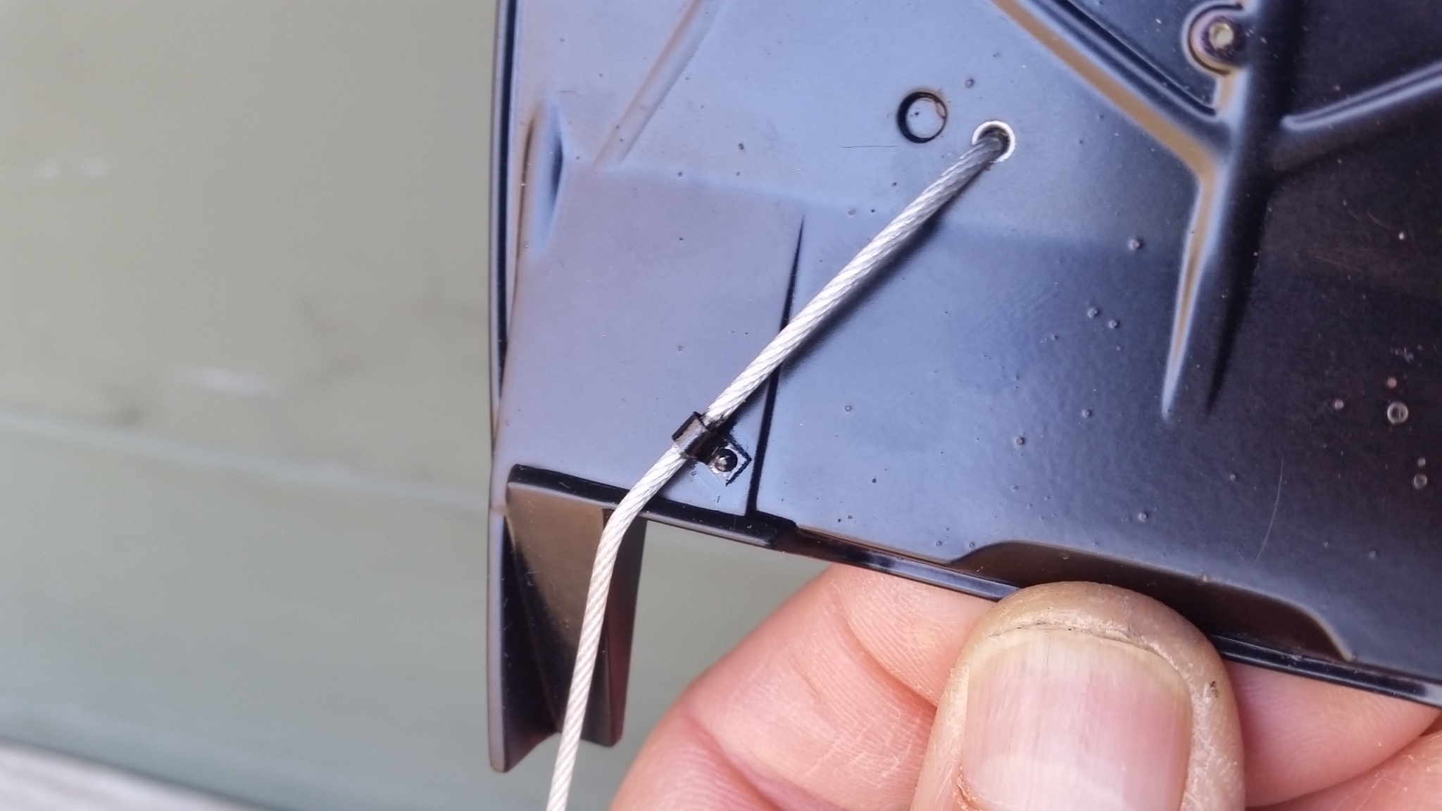

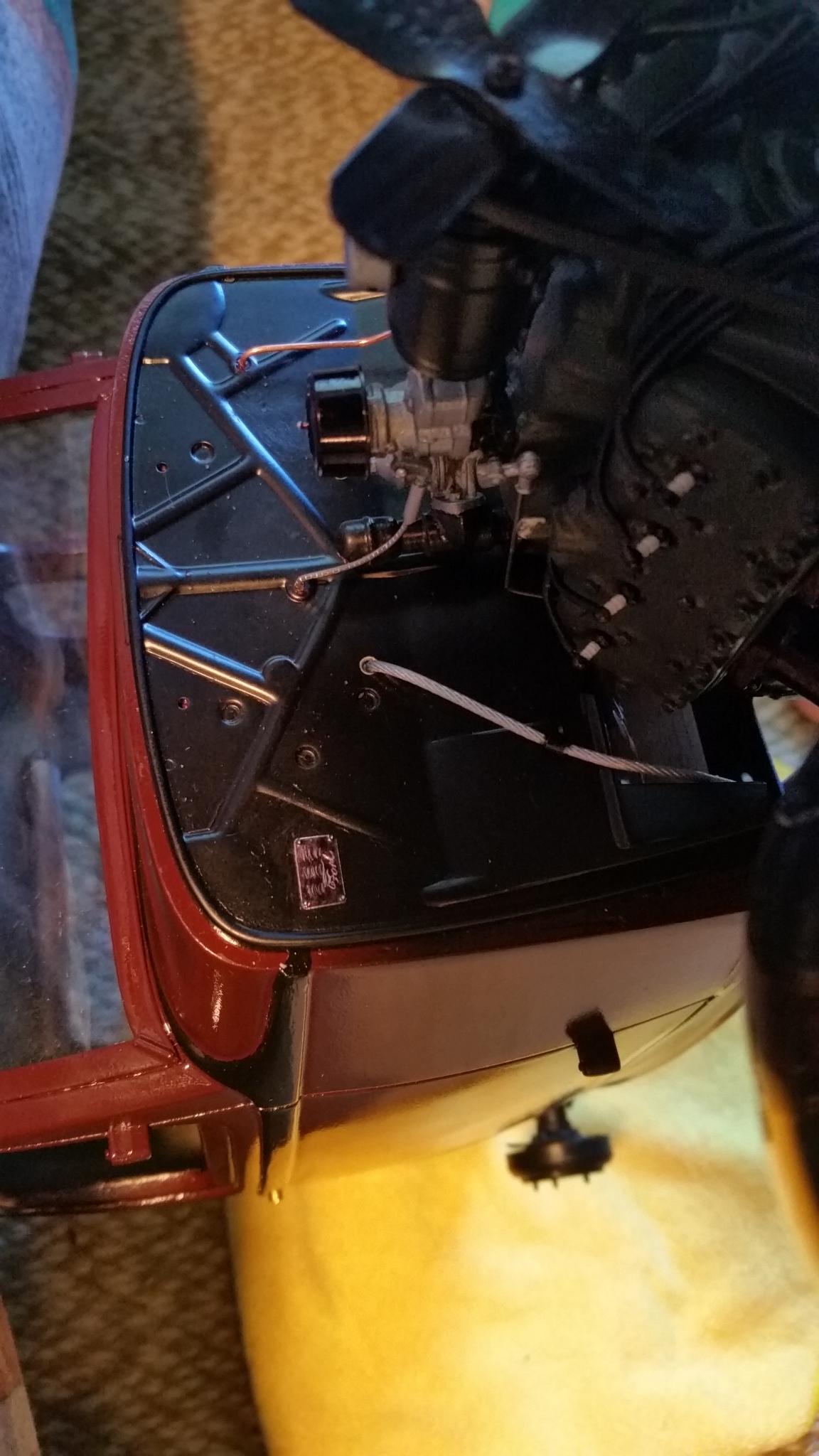

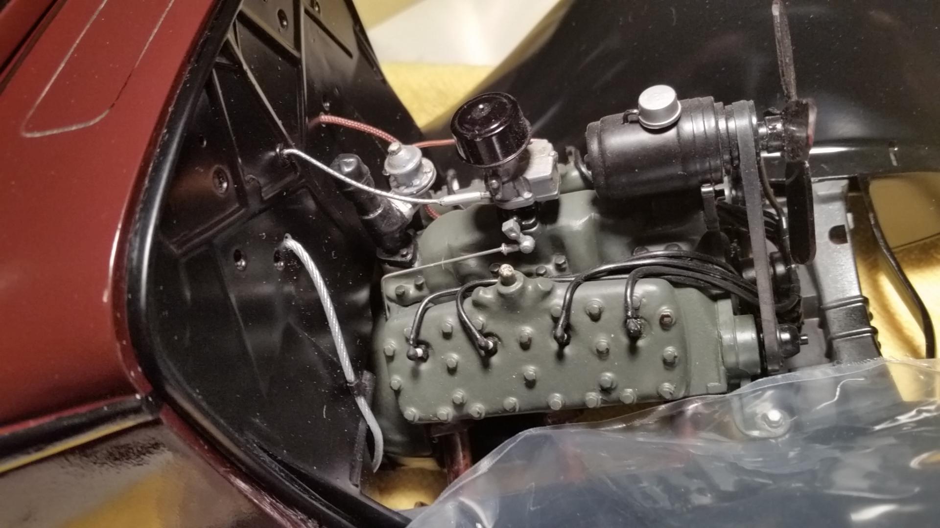

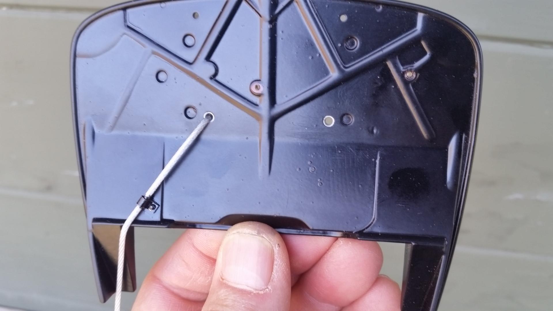

its the small details that make a difference on a model this size- here is the speedometer cable and a scratch built hold down bracket. next was making up the throttle and choke linkages. the fabric conduit behind the fuel pump is the engine wiring from the dash.

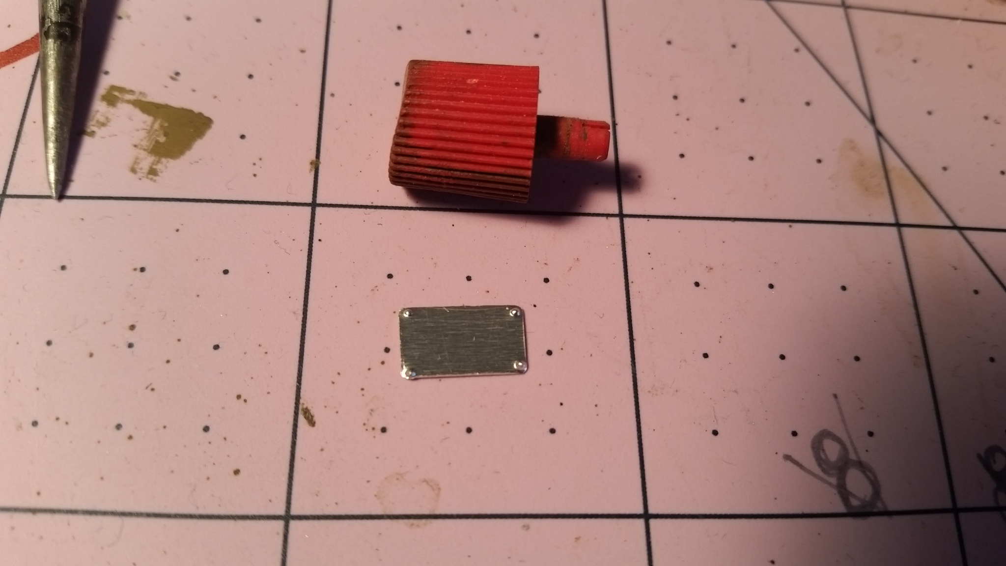

there is a data plate on the firewall that I saw in original photos so I made one up-  cut a small piece of aluminum sheet-used a punch to make ''rivet dimples''  painted with a sharpie and then  inscribed  the patent dates and FORD script- -easy-fast and a nice touch....

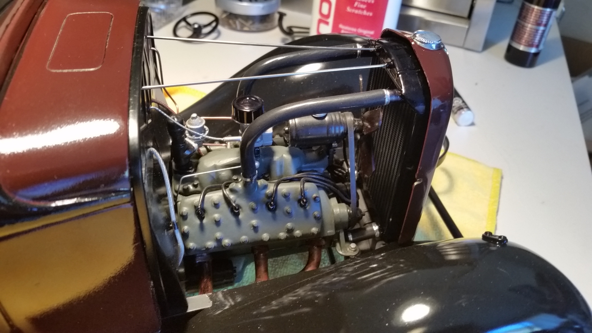

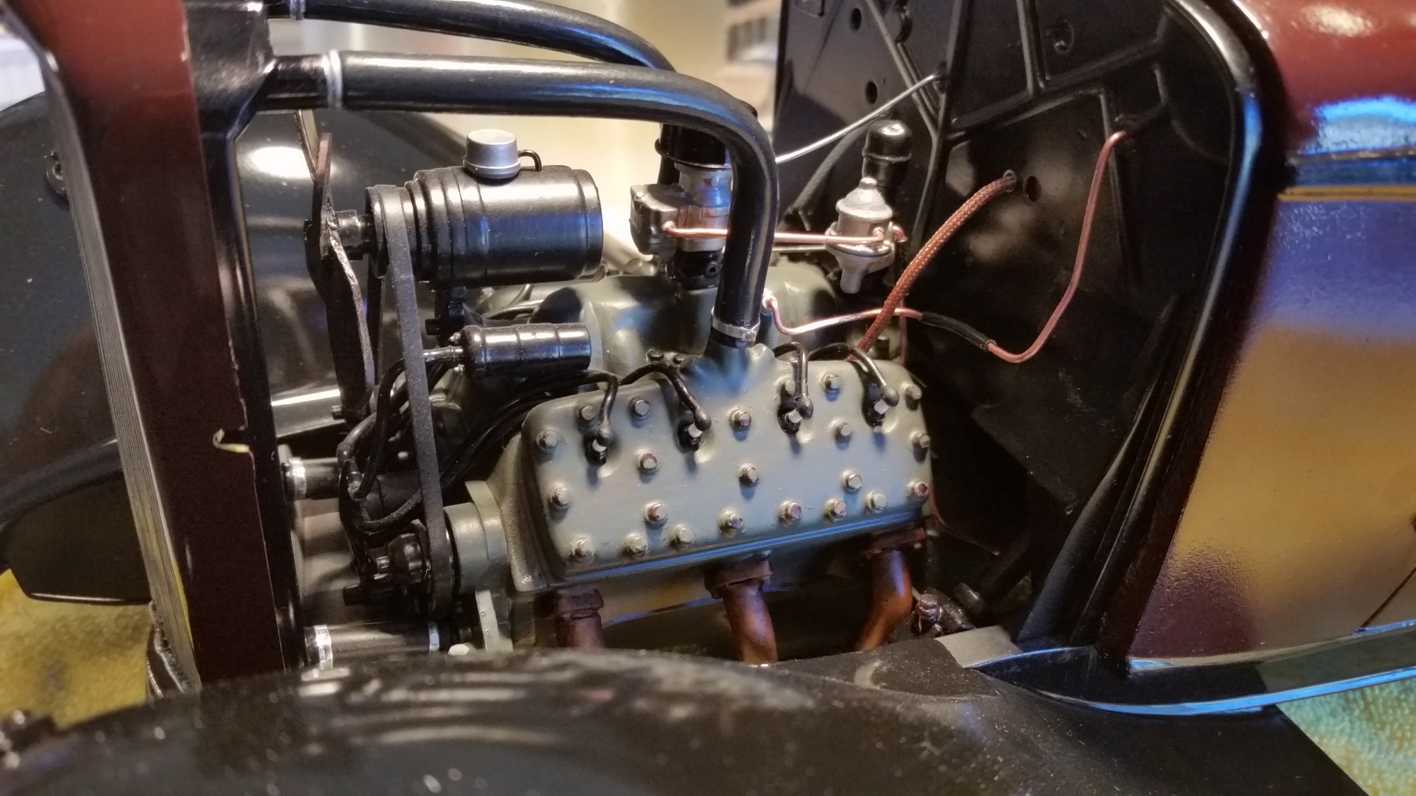

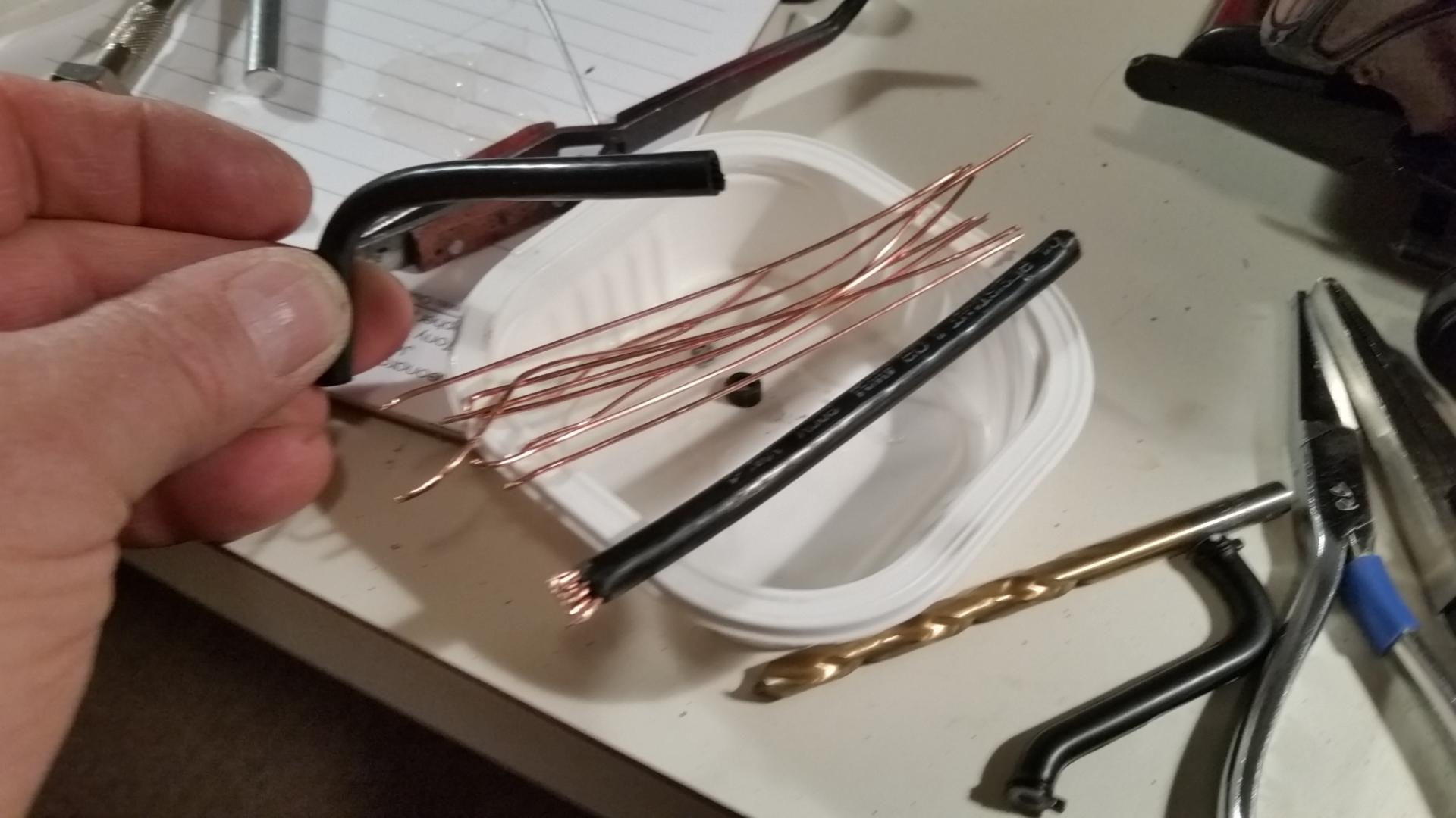

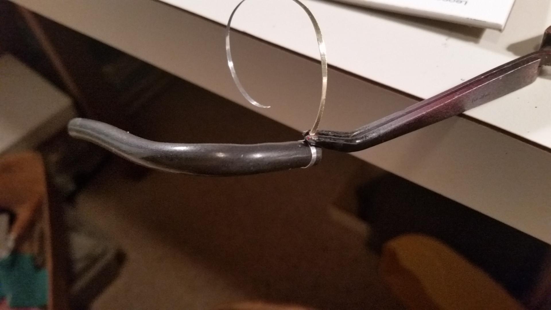

to make the radiator hoses I used BIG gauge wire- pulled out the copper strands and shortened them so the ends would hook up to block and radiator  then inserted the strands again so the hose would hold a curve.  the copper strands come in handy for tubing [fuel and vacuum]       cut some more sheet to make up hose clamps....

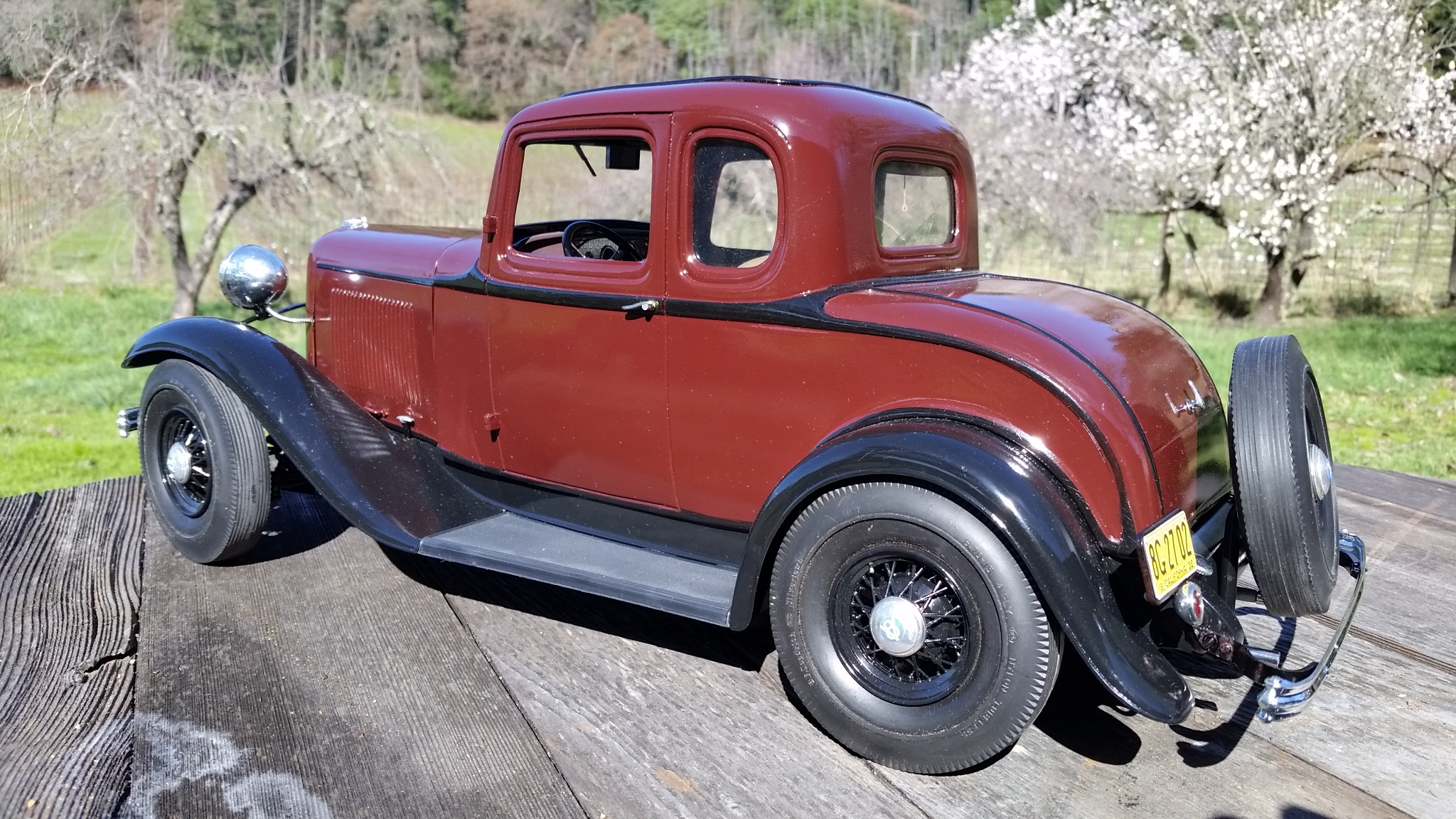

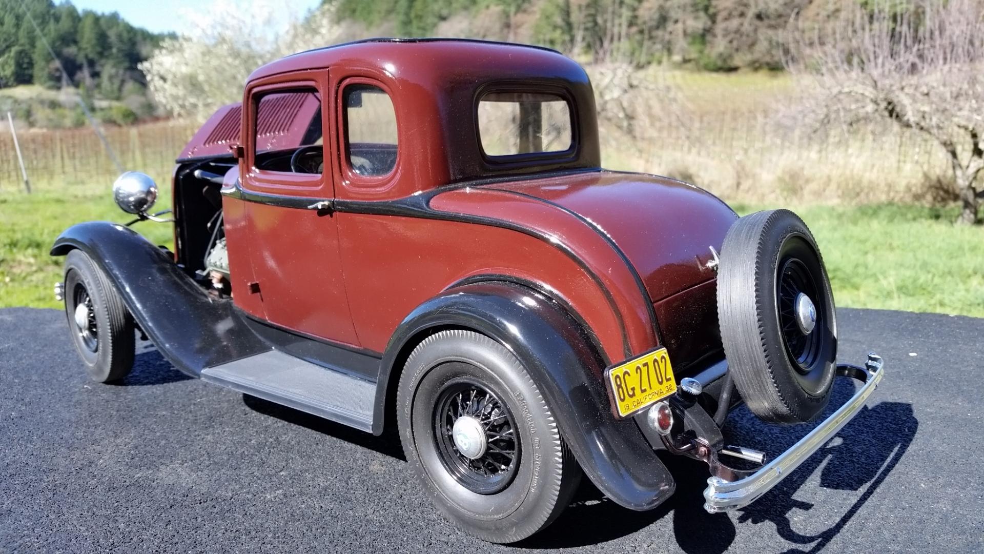

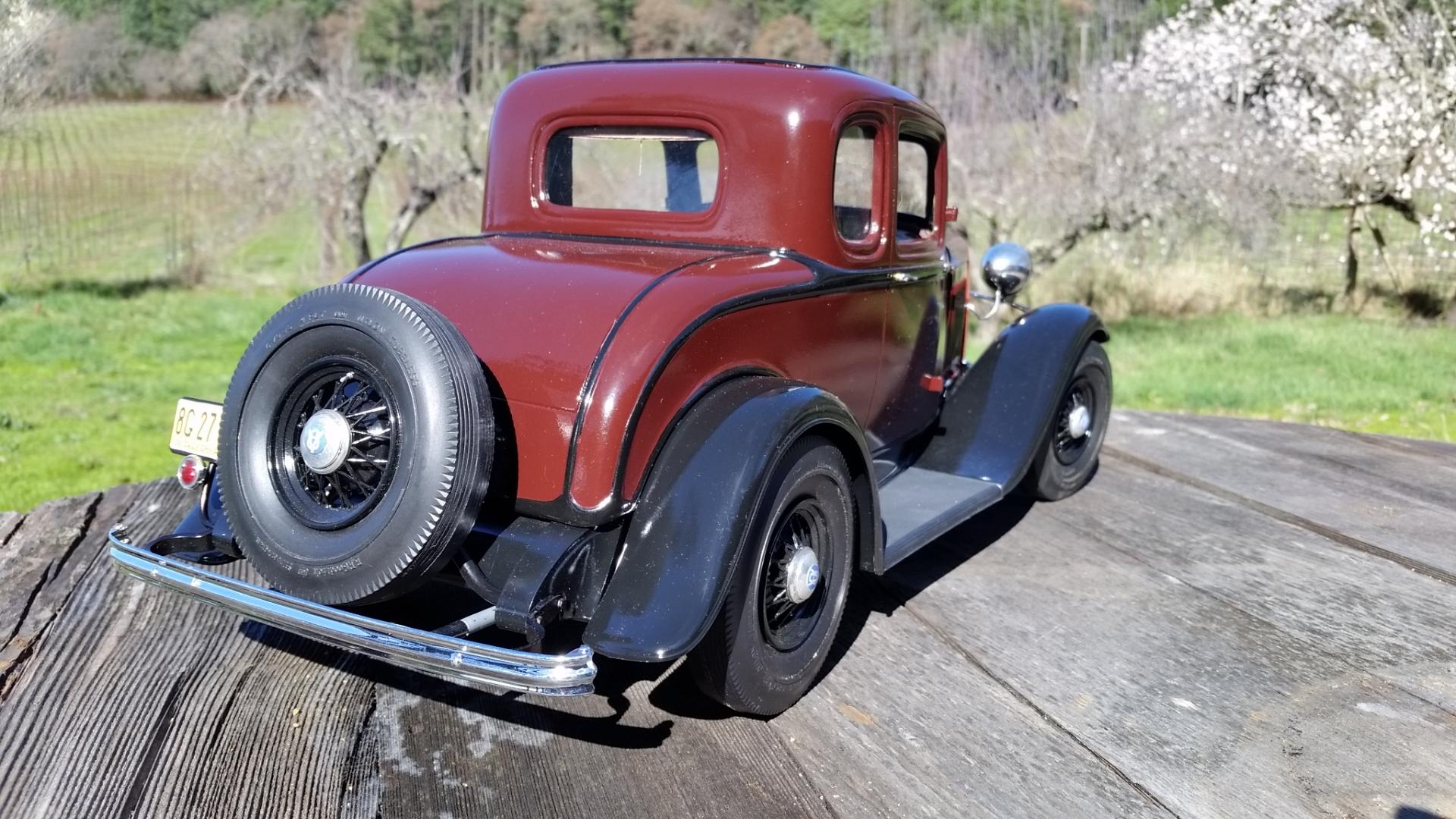

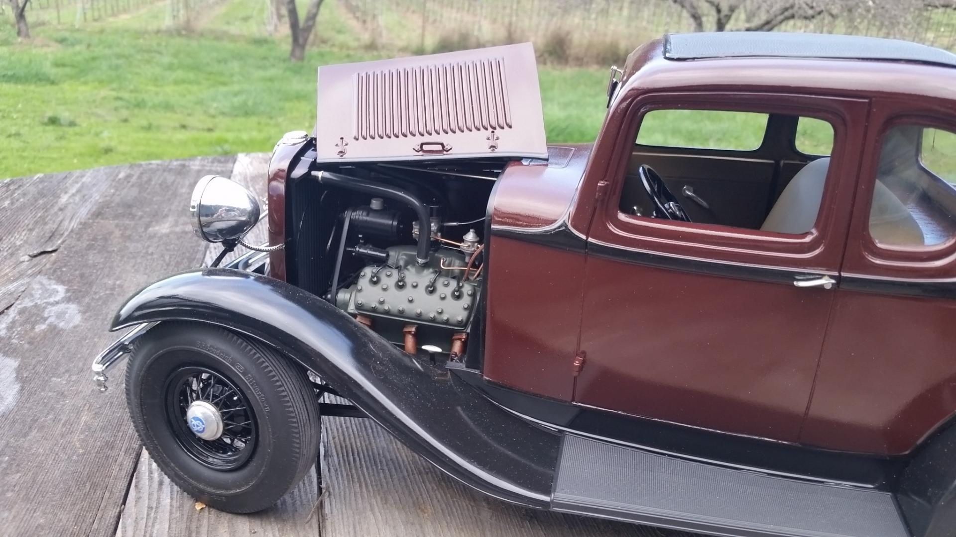

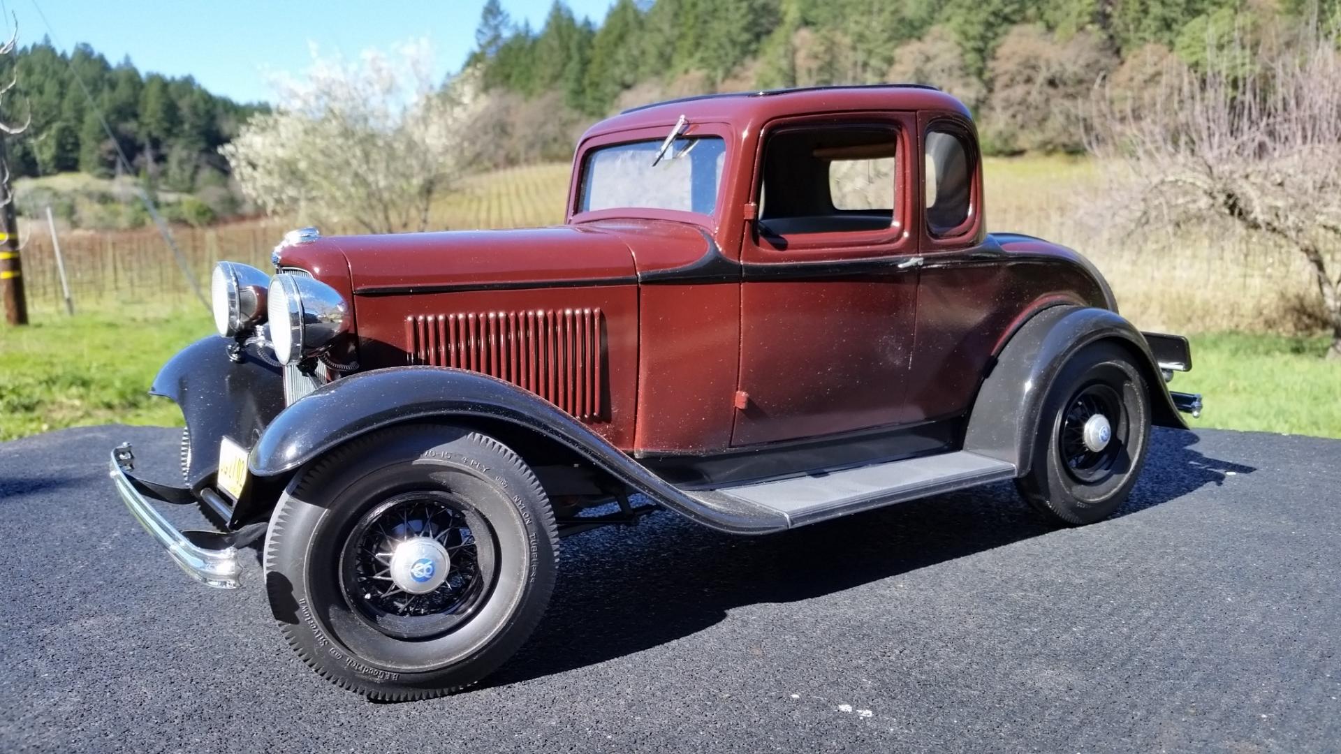

Finally got it done-  I finished at 12 midnight Friday in time  to bring it to the NNL West Saturday.    More pics soon in the under glass section.   I am glad its done- a long project but am satisfied with the results.  thanks to all for the help and hints.   and this one is  for you Harry!
Share this post
Link to post

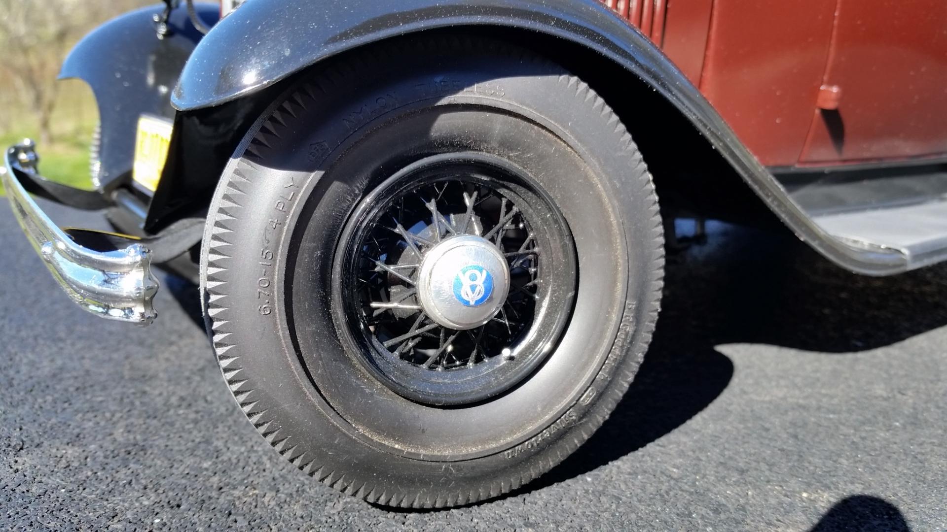

Thanks Fellows.     It was a challenging build- I did it because I really enjoy Original Looking cars.  if any Hot Rod guys out there  have some more Lindberg Canary T  wheels and tires I need them for a new project.  and again Thanks For the advise and comments on this build.

Are those wheels from Lindbergs kit? I just bought a set off the Bay. Haven't rec'd them yet, I hope they are the same as the ones shown here by you?
Share this post
Link to post
yes they are - however in my case I needed same size front and rear so bought 3 kits.  the kit supplies skinny fronts and fatter rear wheels and tires. any one want to trade skinny's for fats -I got em.

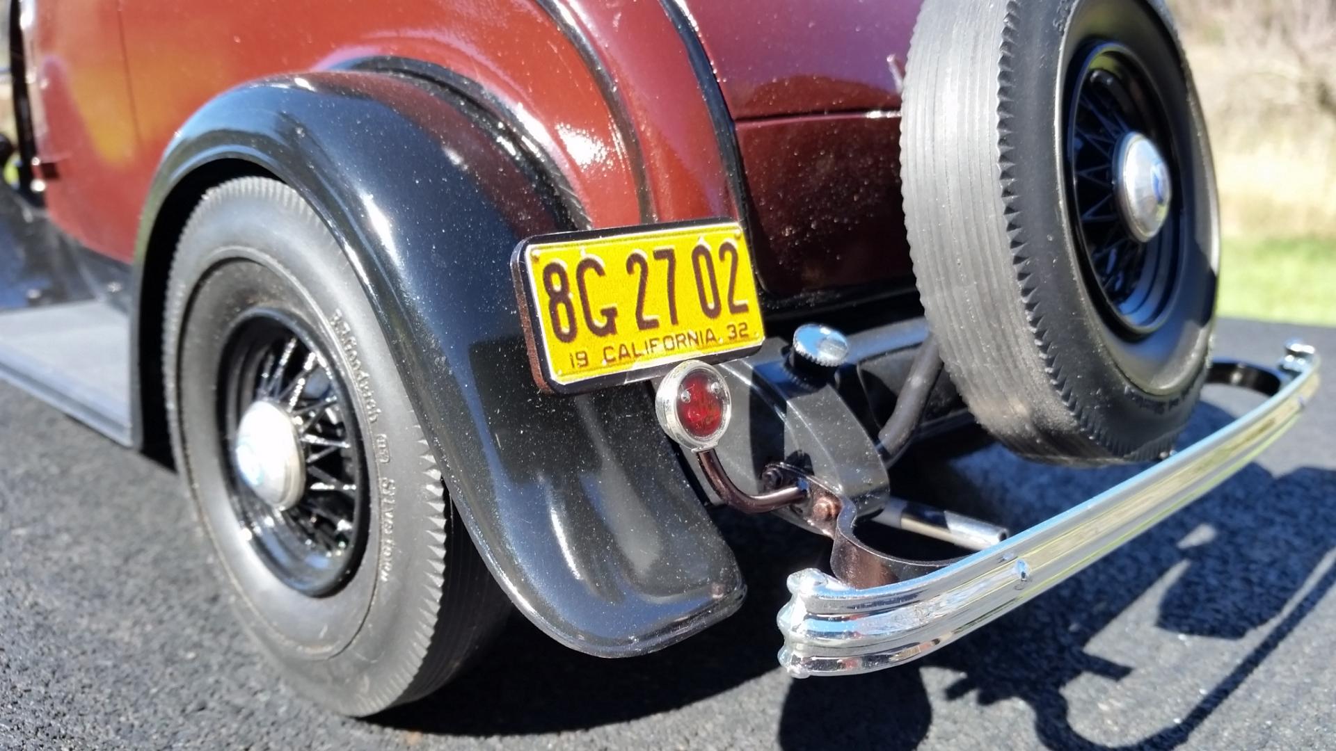

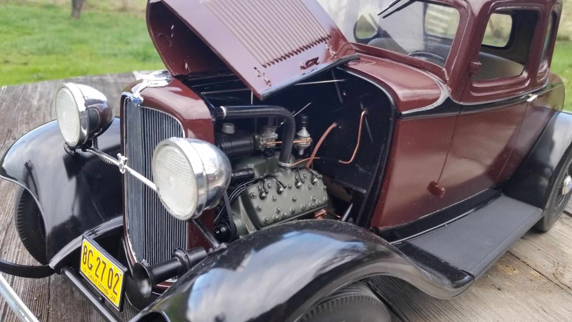

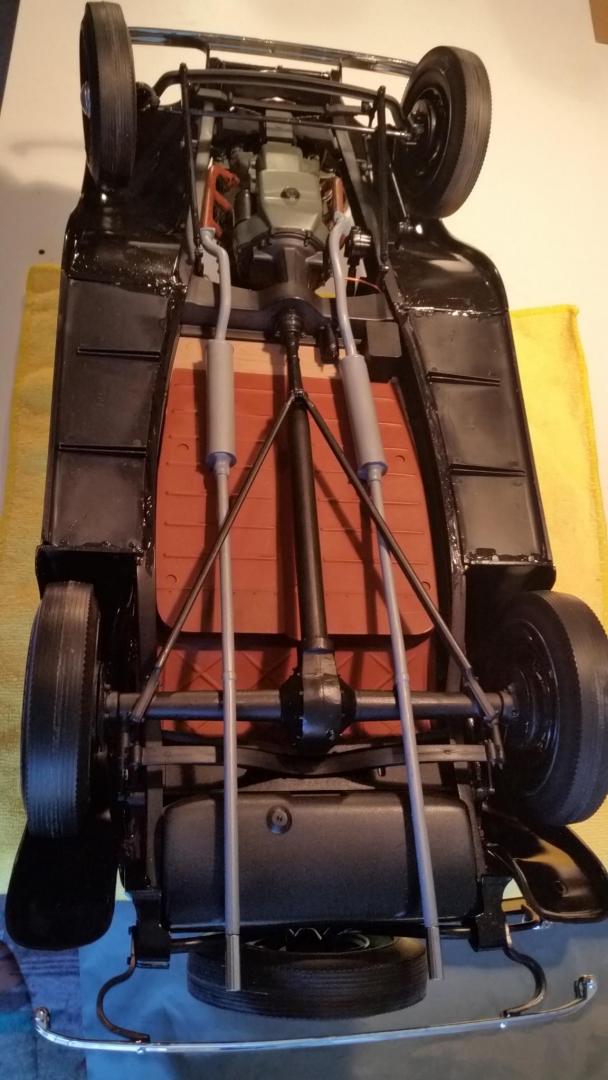

some additional images, excuse the dust-there was a pollen drift going on that day
