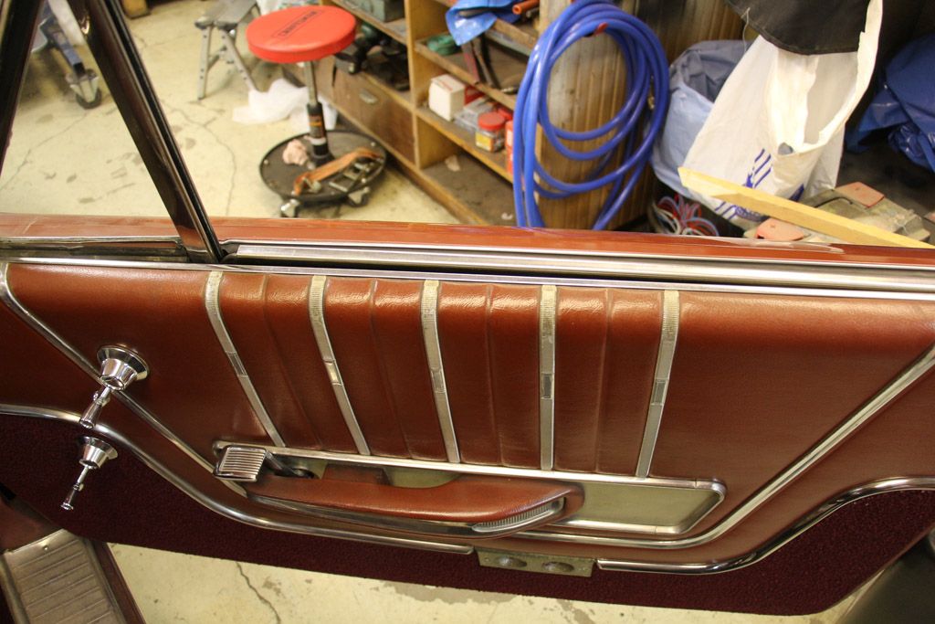

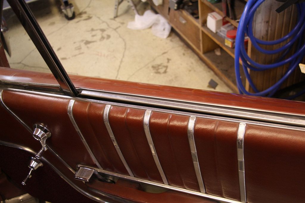

I have used these pens on my real 1963½ Ford Galaxie 500 XL for the plastic interrior trim where the plating had wore off over the years, I even tested to repair just a part of the trim where the original plating was cracked and you almost can't tell where it's done when you look at it now.
I have also tested it on some model stuff and I'm happy with the results so far, it will not replace Bare Metal as you can do that over and over easily without damaging the paint, but it's for sure a complement...and it's easier to use than Alclad II.
The smoother shinier surface you start with the better chrome effect you will get, let the paint flow from the pen to the surface and I found out if you blow on it slightly just after you put it on it clears up instantly and gets very shiny.
This will not work well on primer or any other surface that's flat and absorbs the paint, the finnish will be just plain silver, the surface has to be smooth and shiny from the beginning to get a good result.
Here is a couple of pictures of the plated plastic interior trim on the door panels on my Galaxie.
Before the Molotow treatment:
After a couple of minutes use of the pen:
Looks great, but how does it stand up to regular handling that the door panels see in everyday use?  For example, doe the silver color rub off and get smeared onto the brown vinyl?  How about when you clean those door panels or use some sort for protectant (ArmorAll or whatever you use)? Does it affect the shine or make the solver coating spread to the brown panels?
As far as the reflectivity of this stuff goes, it is just like any other shiny finish (including the real chrome).  It will only be as reflective as the surface it is applied to. Real chrome is usually applied over very smooth layer of copper plating. Alclad chrome needs a glossy undercoat. To maximize the reflectivity of the Molotov stuff, it should be applied over smooth glossy surface.
I don't know how it will hold up yet, I did it just a couple of weeks ago and it hasn't rubbed off yet...and yes I have touched it after it was done...it doesn't seem to smear at all when it's fully dried.
And as for "every day use"...well I don't drive this car every day, I only take it out in the summer when the weather is nice...right now in sits in a warm cosy garage. ;)
But if it rubs off I just do it over again...I have more of these markers.
