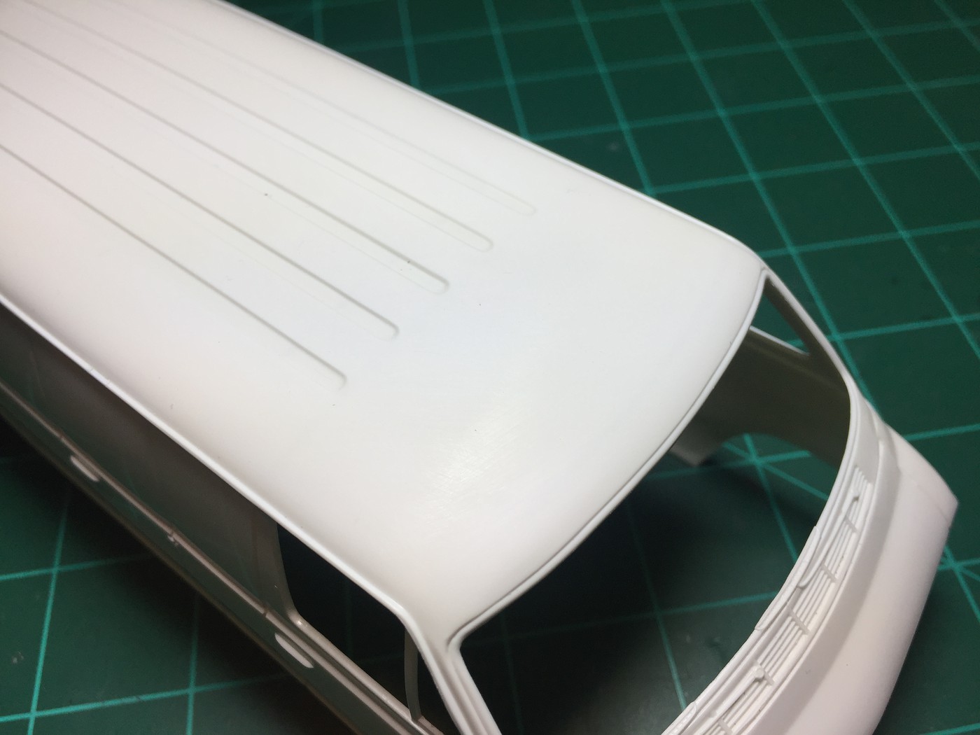

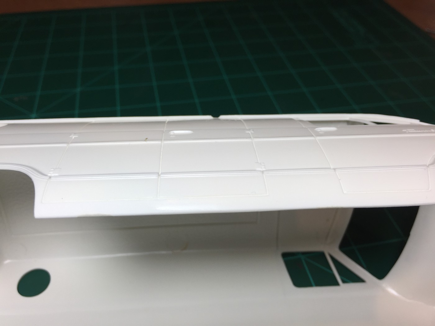

Now to deal with the mess that is the provisions for the sunroof. I've dealt with these in the past and after sanding the exterior surface smooth, it can sometimes become so thin that you will actually sand through these and then you have a real mess on your hands. So I learned from experience to always fill in the channel from the backside with styrene and glue, that way, if you sand through, there's still some material holding everything together and it's much easier to repair. So, I always start by filling them in from the backside first.
IMG 0779
IMG 0780
I glued some .030" styrene square strip into the channel
IMG 0815
Once that was done, then I could flip it back over and sand the roof out smooth. Luckily, I was able to achieve that before sanding through! But...you never know. Lol
IMG 0822

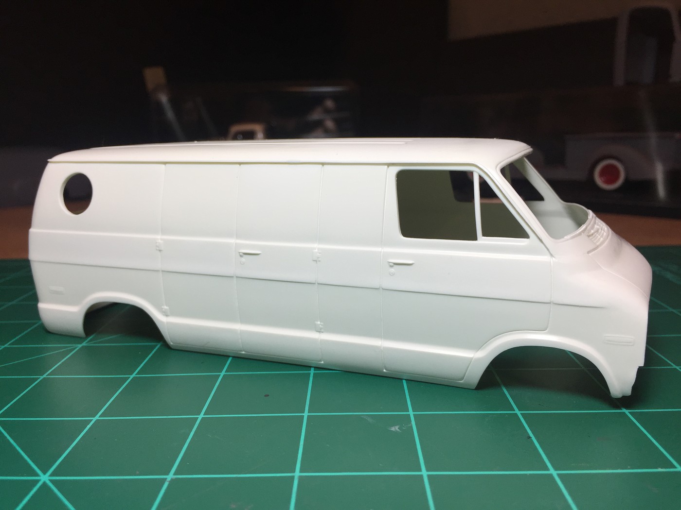

I had some time this afternoon to get back on this. I was able to get the driver's side of the van cleaned up. Sure went a lot quicker than the other side with no door handles or door hinges to contend with!
IMG 0859

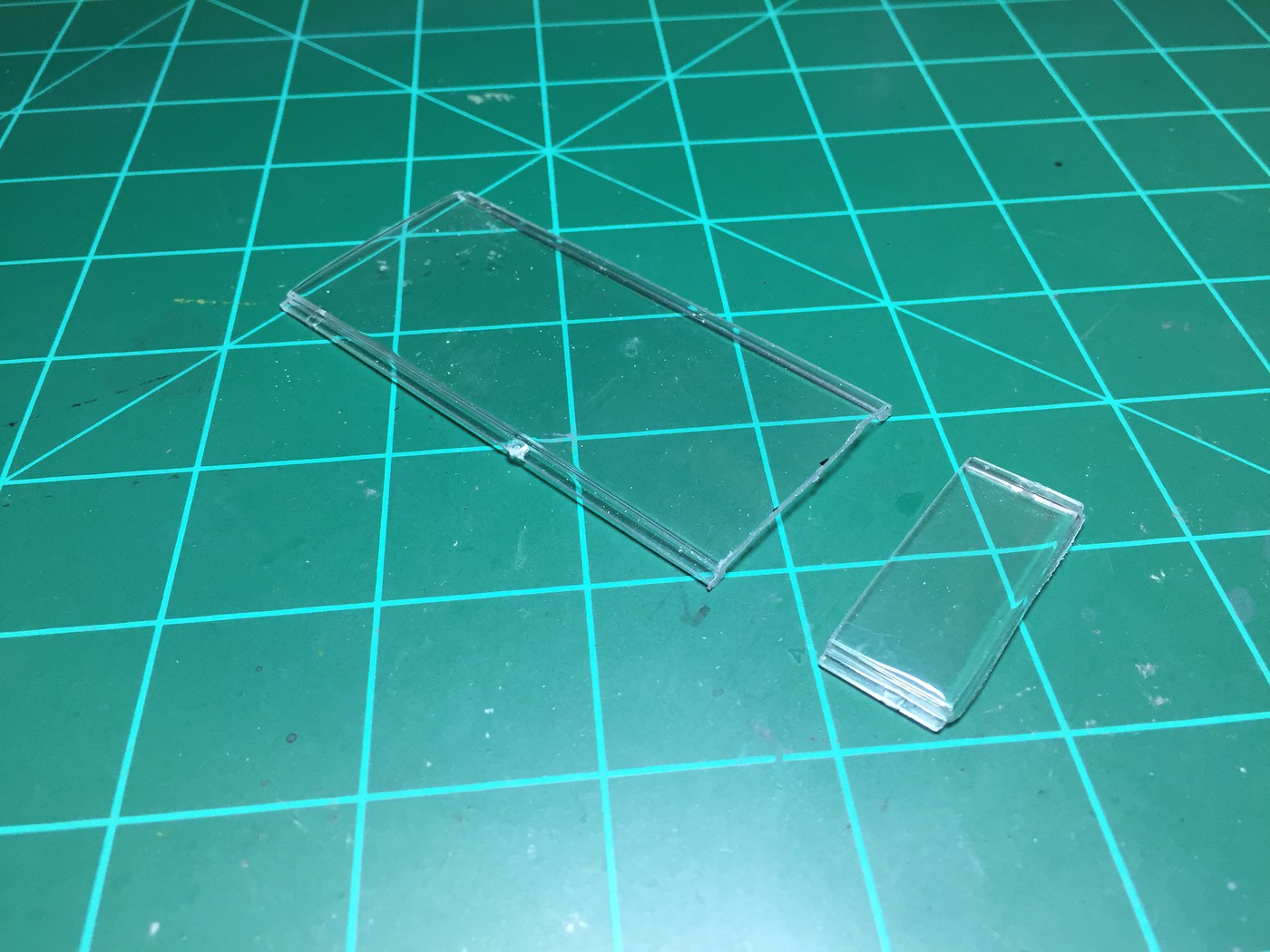

...I took a big deep breath and went to work! Lol. This is what we ended up with!
IMG 0865
Then I cut the glass to fit.
IMG 0866
And voila! Even though I do intend to try and figure out a way to have it in the open position, it was still important to me that I had a nice fit.
IMG 0868
