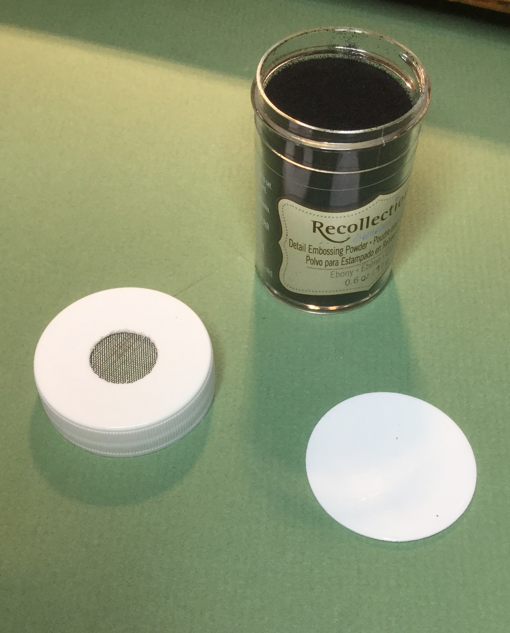

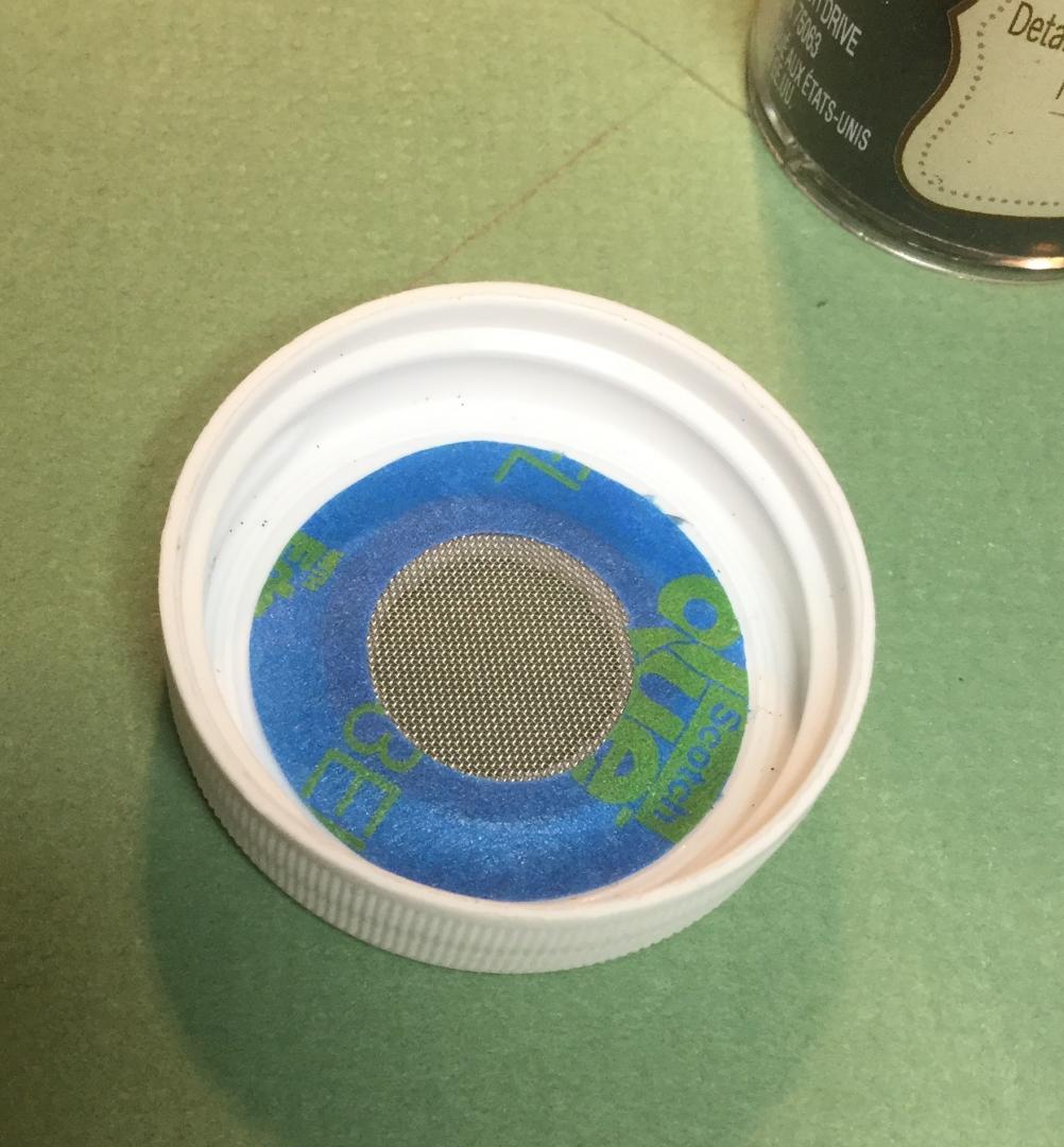

Misha Posted March 20, 2017 Share Posted March 20, 2017 Not sure if anyone has tried this; faced with spreading the embossing powder evenly, I turned the container into a shaker. First step was to remove the liner from underneath the lid. Using an X-Acto circle cutter a centred hole was cut from the plastic lid (requires a certain amount of patience) and a corresponding doughnut was cut from blue making tape. The tape holds the plumber's screen in place under the lid, and is followed by the original plastic/paper liner, also with a hole in the centre. Thinking of running a bead of CA glue around the opening from the top to better secure the screen in place. To seal the shaker after use I cut a new seal, slightly smaller from thin cardboard and place it on the container before screwing the lid on. Hope this is usefull, Cheers Misha Quote Link to comment Share on other sites More sharing options...
