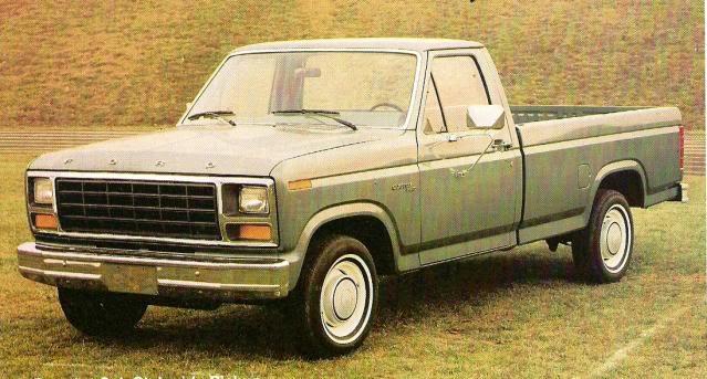

back in the 70's they did, but I'm not doing mine as a ranger, I am doing it as 1981 ford f-100 custom I had with a straight-6.
it was my first truck that I named Charger, it was forest green with the tan interior.

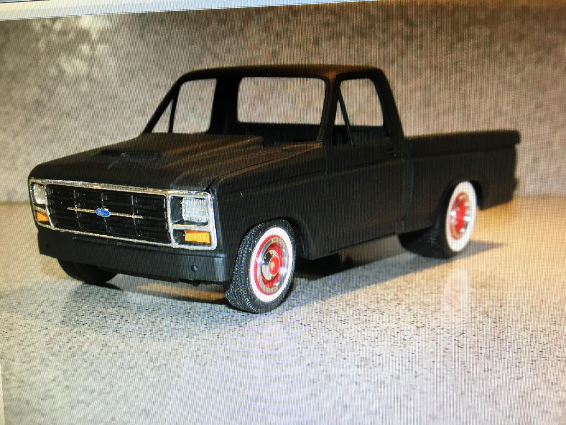

I had the kit but the bed is to tall an it don't match the well well on the cab at all.
The pic is of the same truck I had in everyway but the rip in the panel were it say's custom f-100.
