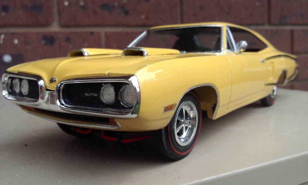

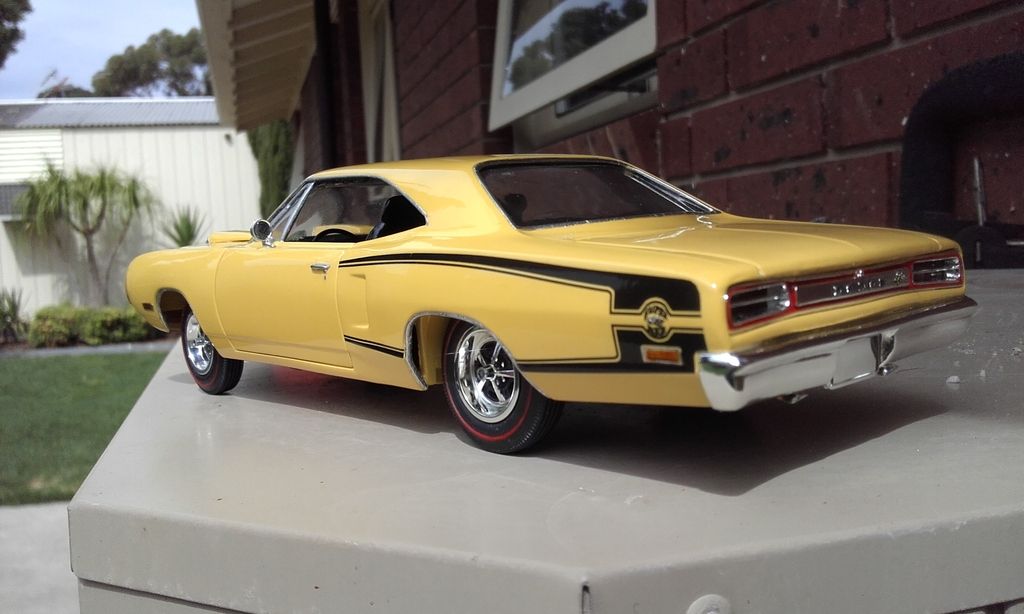

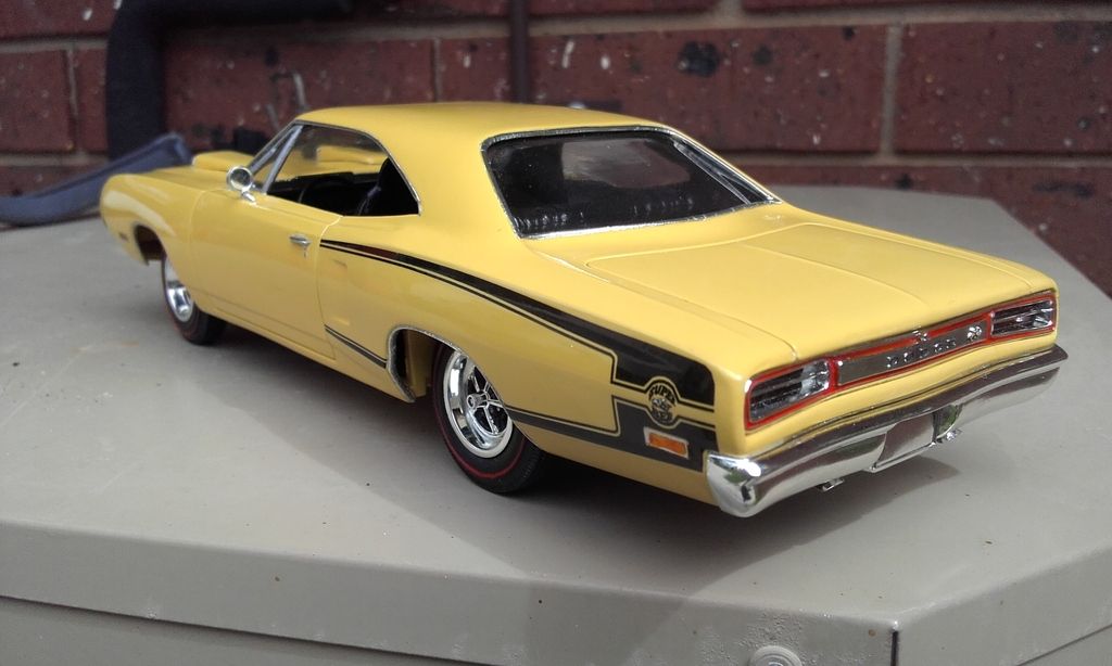

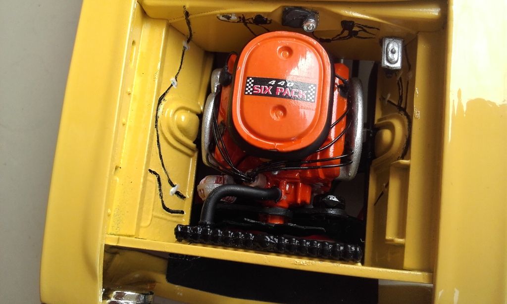

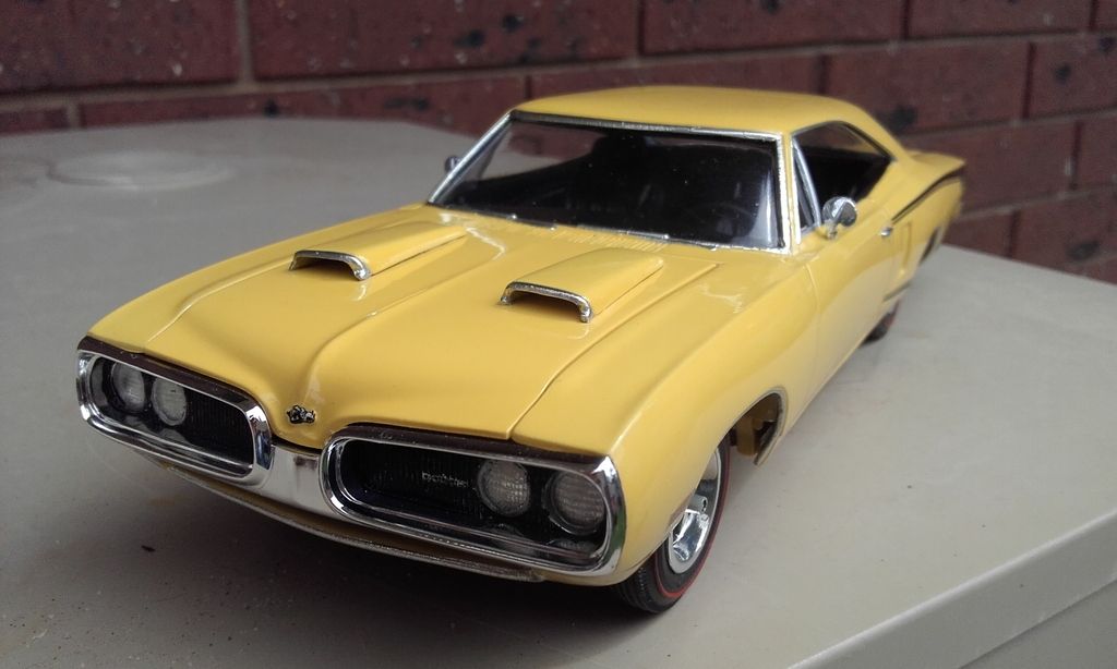

Hi built this one as a motm on another forum and thought I would post the finished build here. Built almost box stock just added a few details such as plug wires and the chrome trim on the front apron. Painted in duplicolor jasmine yellow which is almost a perfect match for the original banana color. Interior painted in a mix of flat, semi-gloss and gloss black and bmf. Cheers and thanks for looking

Super clean build on a classic favorite. I can almost hear that bee rumbling now!

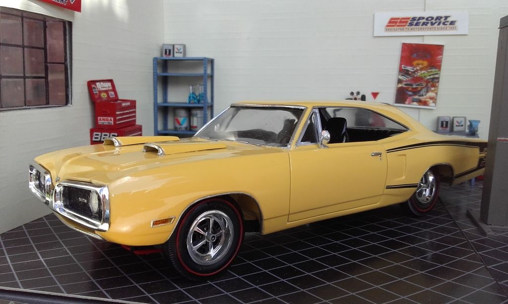

Nice work, paint looks like it's still wet!  Love the garage!

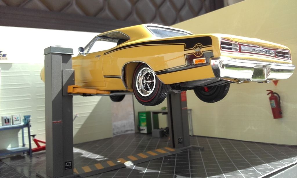

I think it's just fantastic-love the shot of it on the lift-more mopars-yeah !!!

Looks great, to bad it is on the lift so often...........:D

Super looking Bee.  Your photo dio is cool too.

Nice Steve!
The paint is beautiful!
If I could make one suggestion it would be to remove the wheels & add some spacers behind them.
The wheels are far too "inboard".
It would make a huge improvement to the stance if the wheels were out closer to the fender openings.

Nice job! That Super Bee is terrific! Love the red detail paint on the tail light panel.
One thing to point out for future builds. On a 1:1 B engine with factory exhaust manifolds you can not route the plug wires between the exhaust manifold and the cylinder head ( can't be done). They are routed down in front of the cylinder heads and below the manifolds. On most models the #7 and #8 plug wire runs alongside the valve cover and behind the rear of the cylinder head to the spark plug.

Thanks everyone for your comments and your tips. Steve noticed the wheel placement after everything was together and with the time restriction of 4 weeks to do the build, I didn't want to start pulling things apart, as I just met the dead line as it was. Thanks for the tip on the plug wiring Walter will keep that for future reference, will have to get the manifolds closer to the block in future. Cheers Steve

Walter, I have to comment on that, on the B engine OR RB engine with factory exhaust, the right hand (As you SIT in the Drivers seat) side manifold would follow down the inside of the engine on the intake, around the head and behind it to the plug..... THATS correct....
On the left hand side (As you SIT in the Drivers seat) side manifold is made DIFFERENTLY. they ALL route around the FRONT of the head, and back to each plug location.....
As seen in the above 3 pictures, the TOP manifold is the LEFT hand side one, and naturally the bottom one is the RIGHT hand side one! So then the plug wires were done as so:
Right hand side ---^
Notice the wire in the upper left hand corning of the pic, just behind the head?
Left hand side ---^
ALL the wires around the front, and UNDER the exhaust manifold....
In all the pics I just posted, the exhaust ONLY ones will fit both the B and RB block Wedge engines, the pics of the actual engine range from the 383, 400 to the 440......
