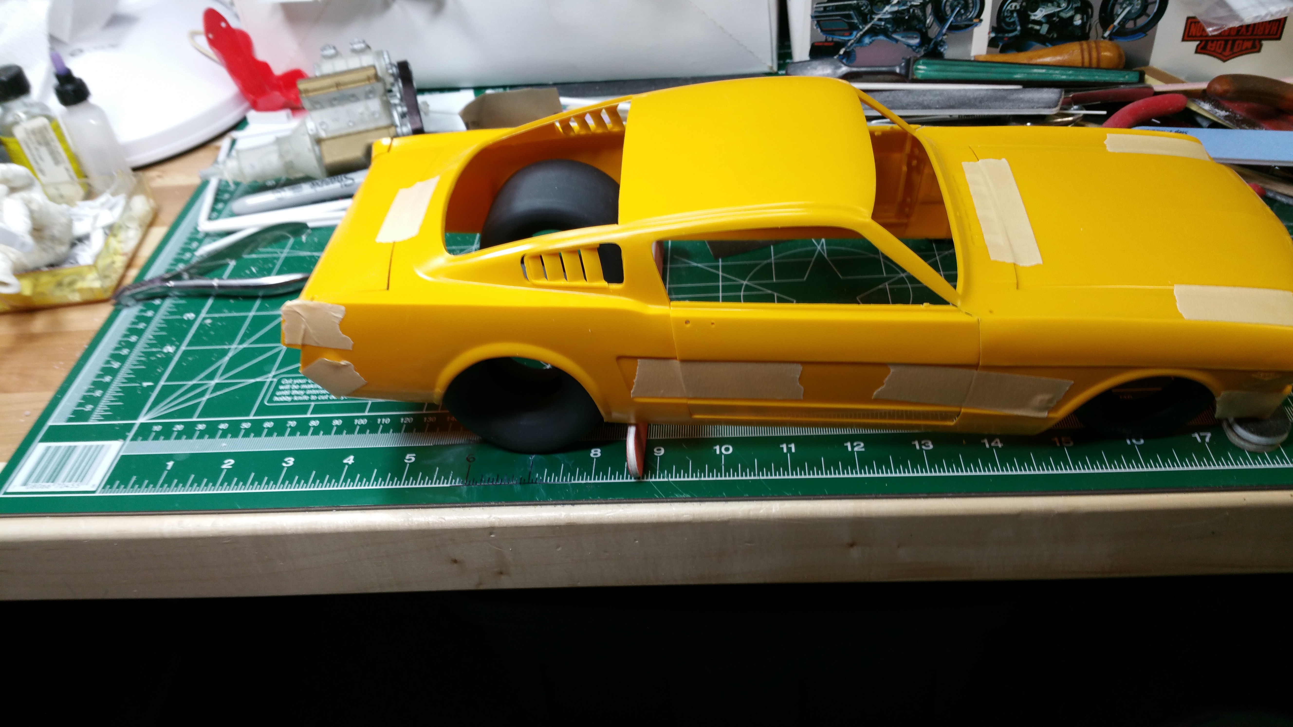

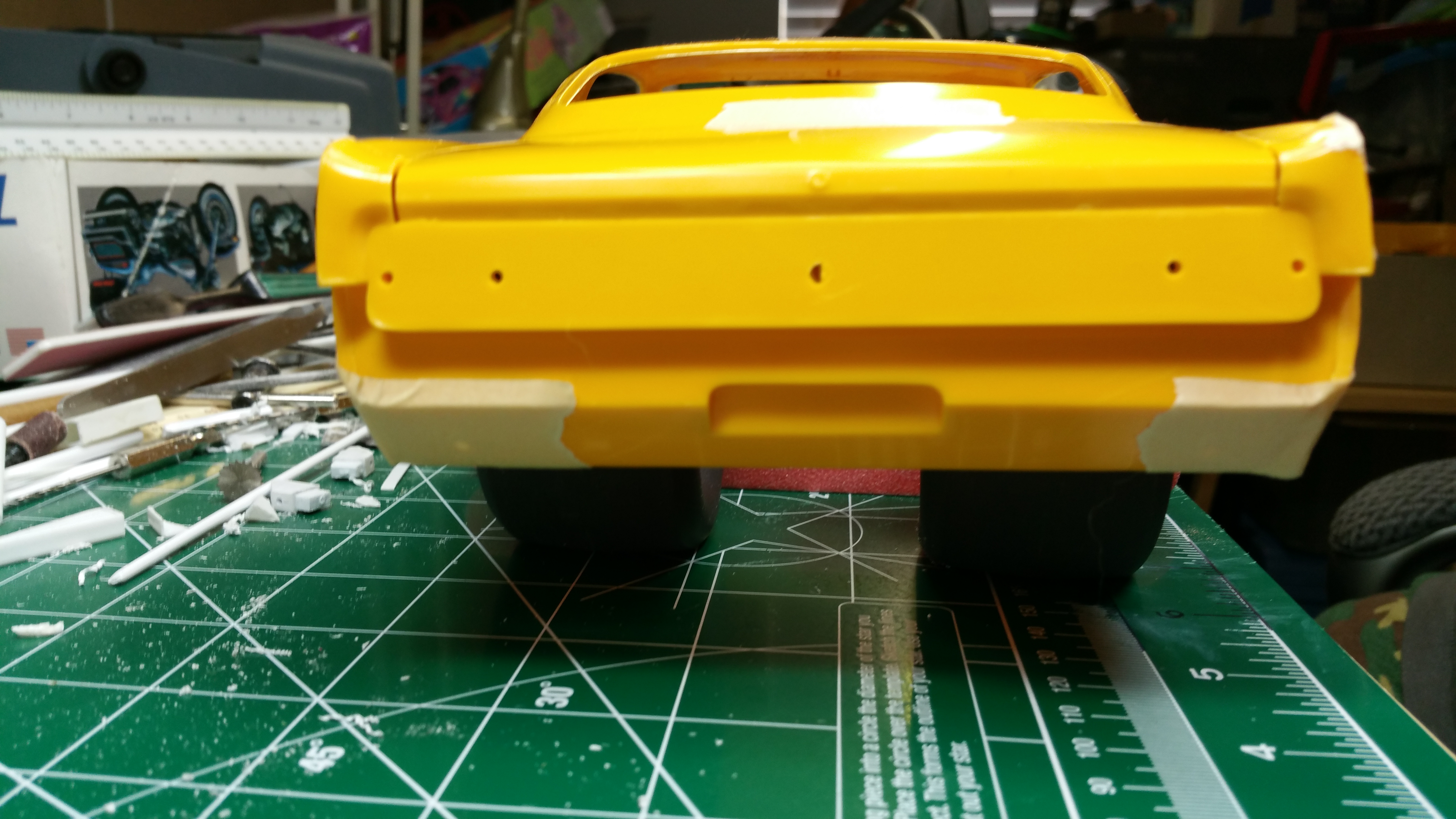

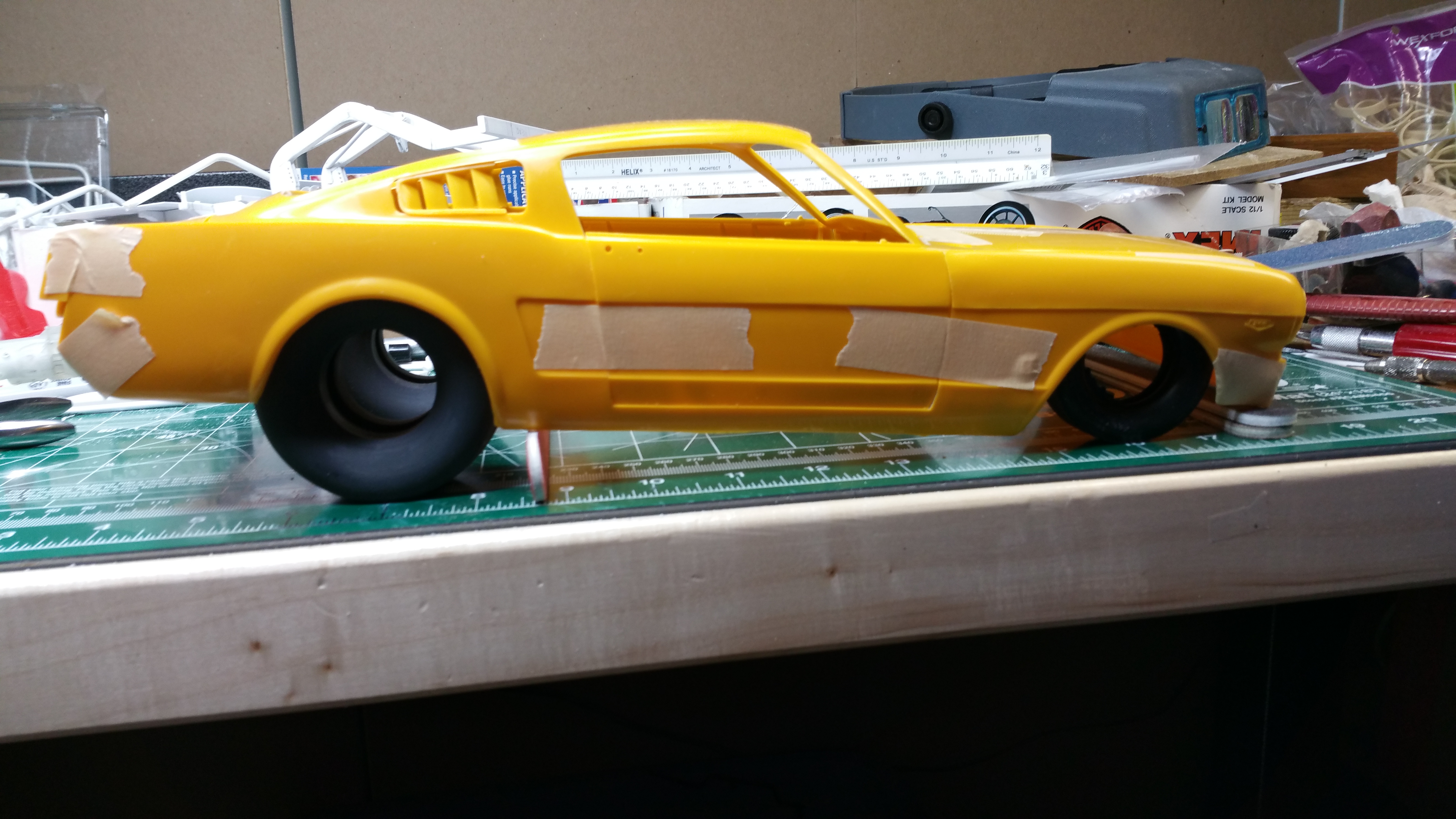

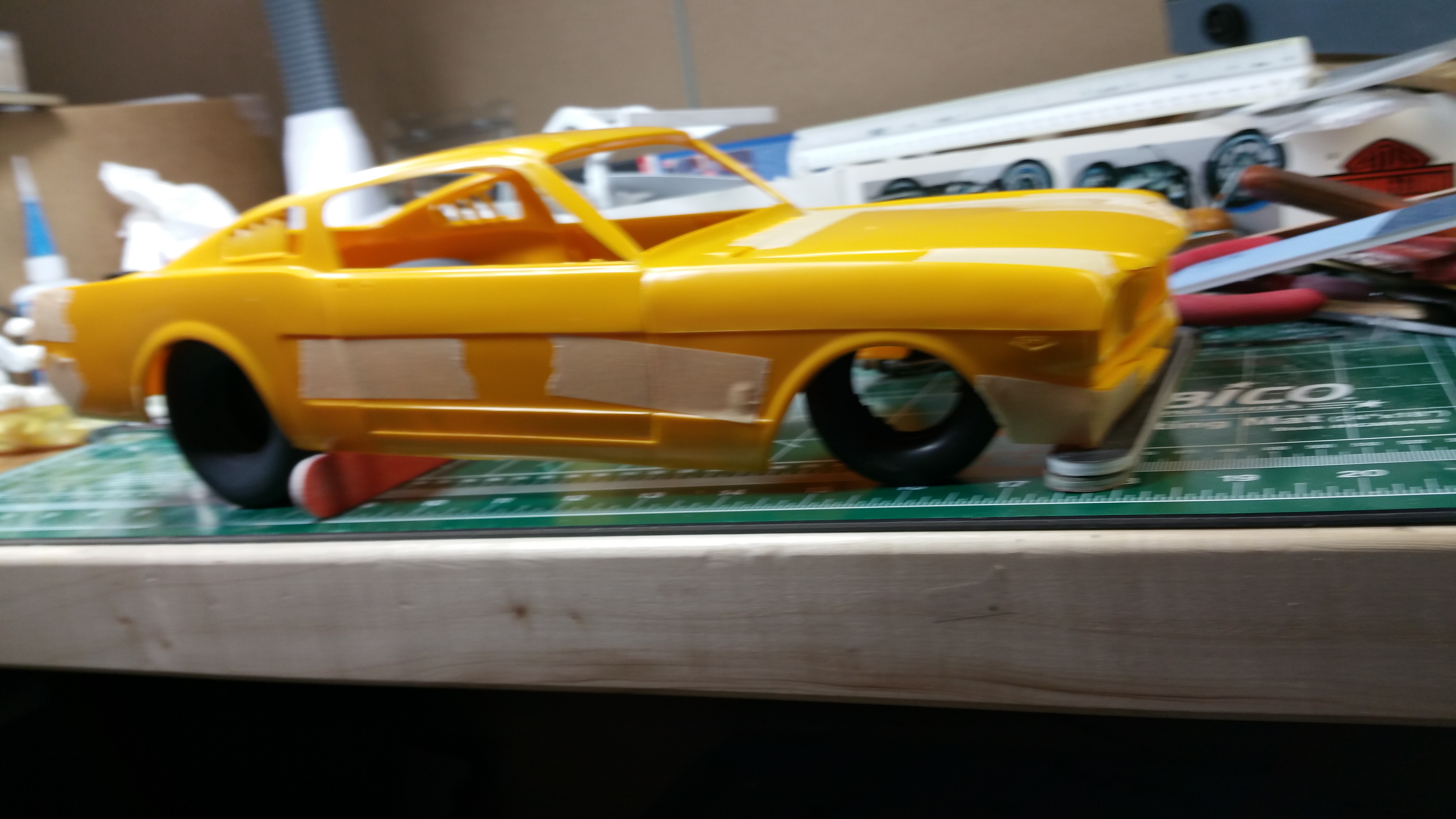

ShakyCraftsman Posted April 21, 2017 Share Posted April 21, 2017 (edited) Hey all Well as you can see by the heading I'm going to be making a 1965 Mustang GT into a Street Outlaws type promod. As soon as I get the 57 Chevy gasser done, which probably will take some more time, I will be starting on this. I'm not sure what I want to use for a motor, it's either going to be a fuel injected Ford SOHC cammer or a 1,000 cu. in. mountain motor with twin 4" turbos. Well what do you think? I'm kinda leaning towards the mountain motor setup. I think It will probably come down to how much each setup costs. Well here's some pics to kinda get things rolling. So look em over and let me know what you think. Thanks RonG PS by the way I need the instructions for this kit it's Revells #H-1286 Thanks again RonG Edited May 4, 2017 by ShakyCraftsman Quote Link to comment Share on other sites More sharing options...

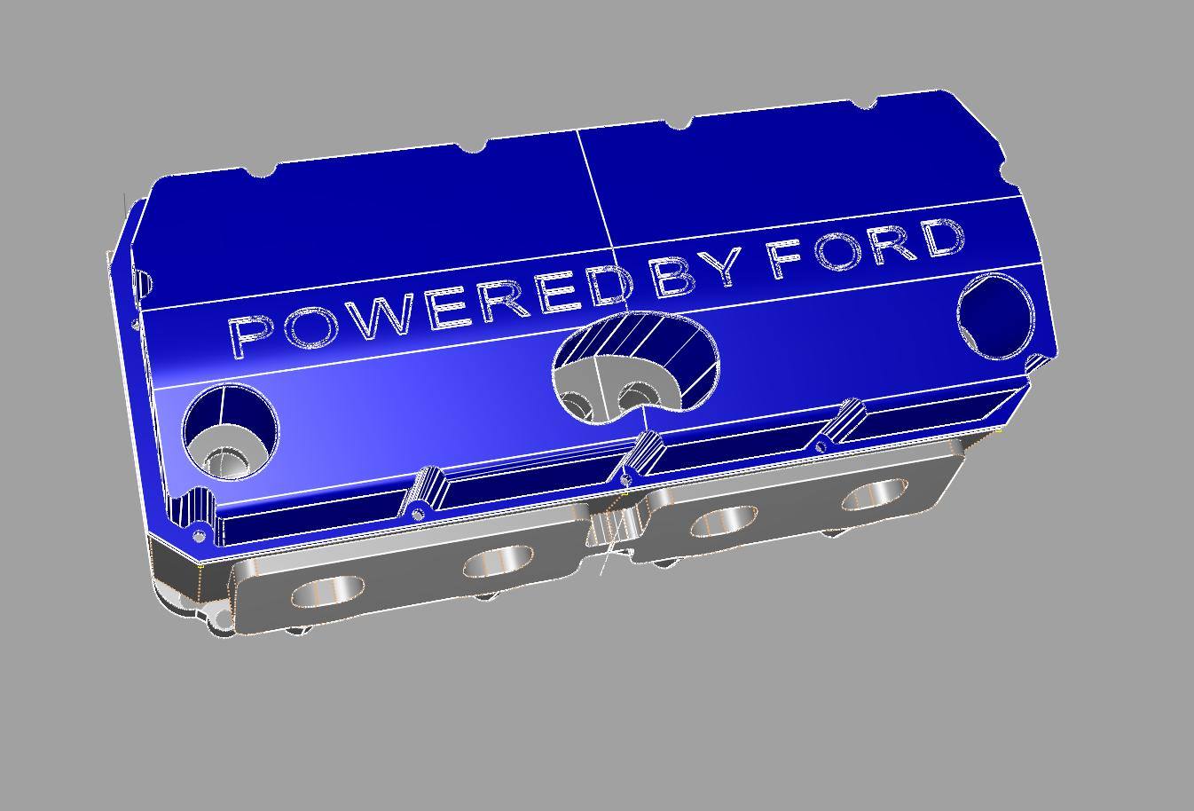

comp1839 Posted April 26, 2017 Share Posted April 26, 2017 ron, if you look closely at the "ford " motor sonny leonard makes. i believe you'll see no difference to the "chevy" version. they just put ford stickers on it. would love to see the 460 block and parts you made. i did a set of boss nine heads and a set of c-460 heads in 1/8. here's a pic. haven't gotten to the block and stuff yet. not sure about how you feel on accuracy. if you're off the deep end like i am (i think paul's in the same pool as i) you'll want to be careful about the parts you buy. many of these guys are are just making things that look close and by close i mean, close until you have to have them interact with other parts. then they're not even in the same ball park. that stuff is a bit of a pet peeve of mine. the engine that paul put up is a ford pro stock motor. good for a little over 500 cubes. bad ass motor....just as a side note on this motor. there is NOTHING about it that is even similar to the 429 shotgun glidden ran. i have over 860 pics of that mustang alone from tubing rack to fire up. when and if you are ready let me know. Quote Link to comment Share on other sites More sharing options...

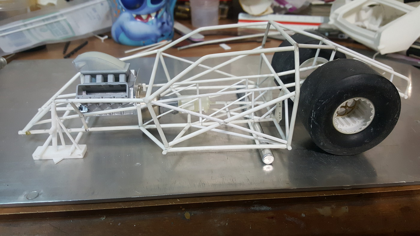

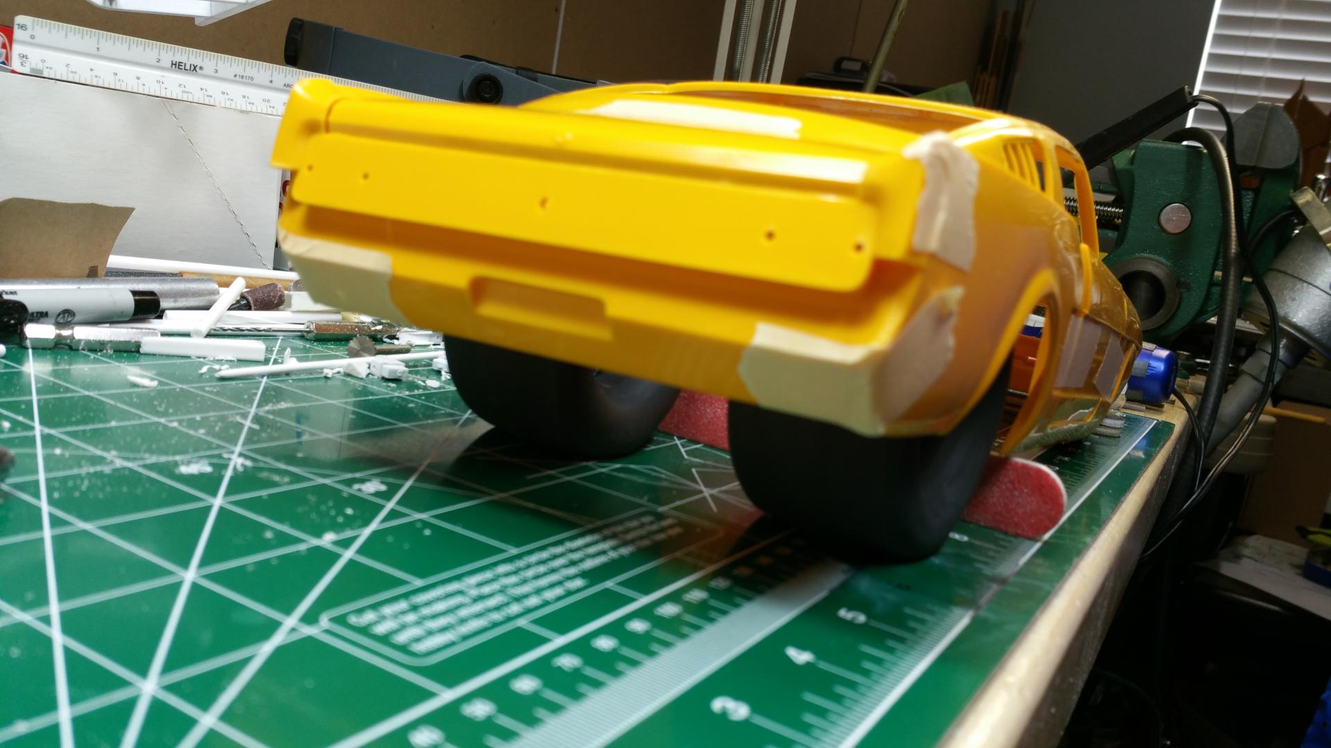

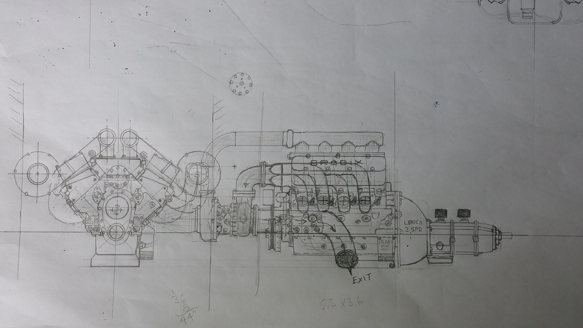

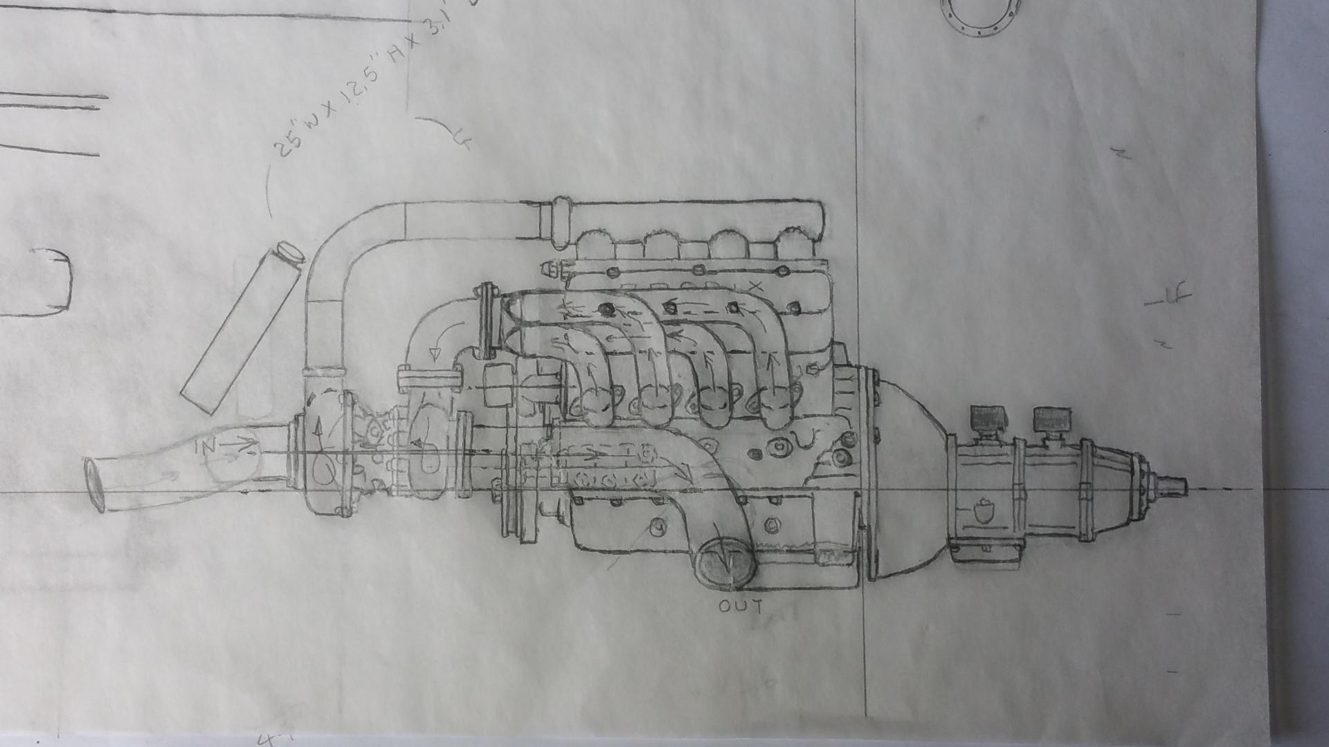

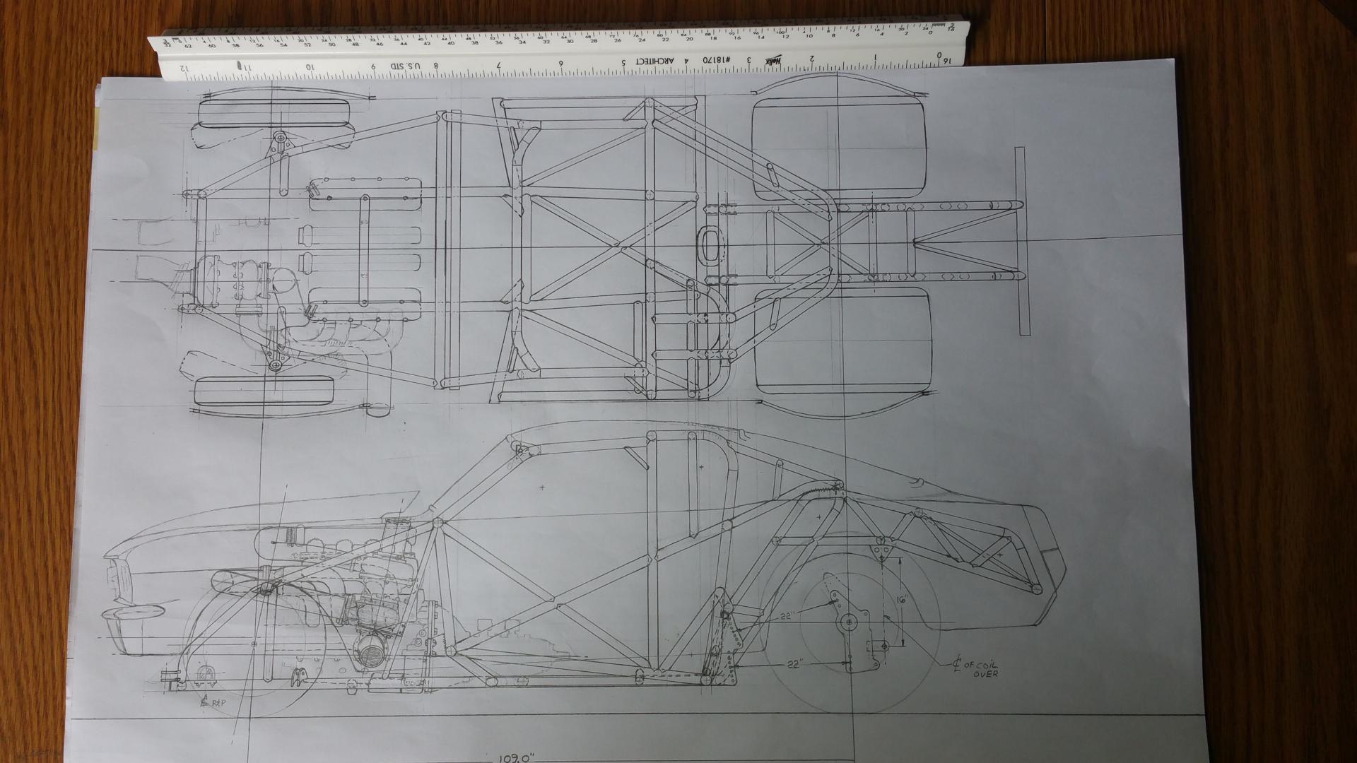

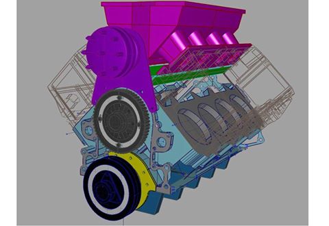

ShakyCraftsman Posted May 4, 2017 Author Share Posted May 4, 2017 Hey all Well I decided to go with a Brodix BBC from 3d specialties, simulating a 750 cu. In. motor. Went with the twin turbos 3", 26" Goodyear front runners, Billet Specialties Win lite rear wheels and Billet Specialties Win lite front wheels. I started on the drawings of the chassis and the fit of the body. I had to do a drawing of the bbc motor and turbo set-up, basically I have to figure out how to plumb this sucker!! BOY o BOY is it tight. The turbos end up right behind the front bumper and the exhaust wants to dump right into the front tires. Have to do some weird plumbing to get all of it to fit. I have a lot of work to get this ready for building. I will try to get some pics of the drawings tomorrow. Have to go wife's calling for dinner. Thanks RonG Quote Link to comment Share on other sites More sharing options...

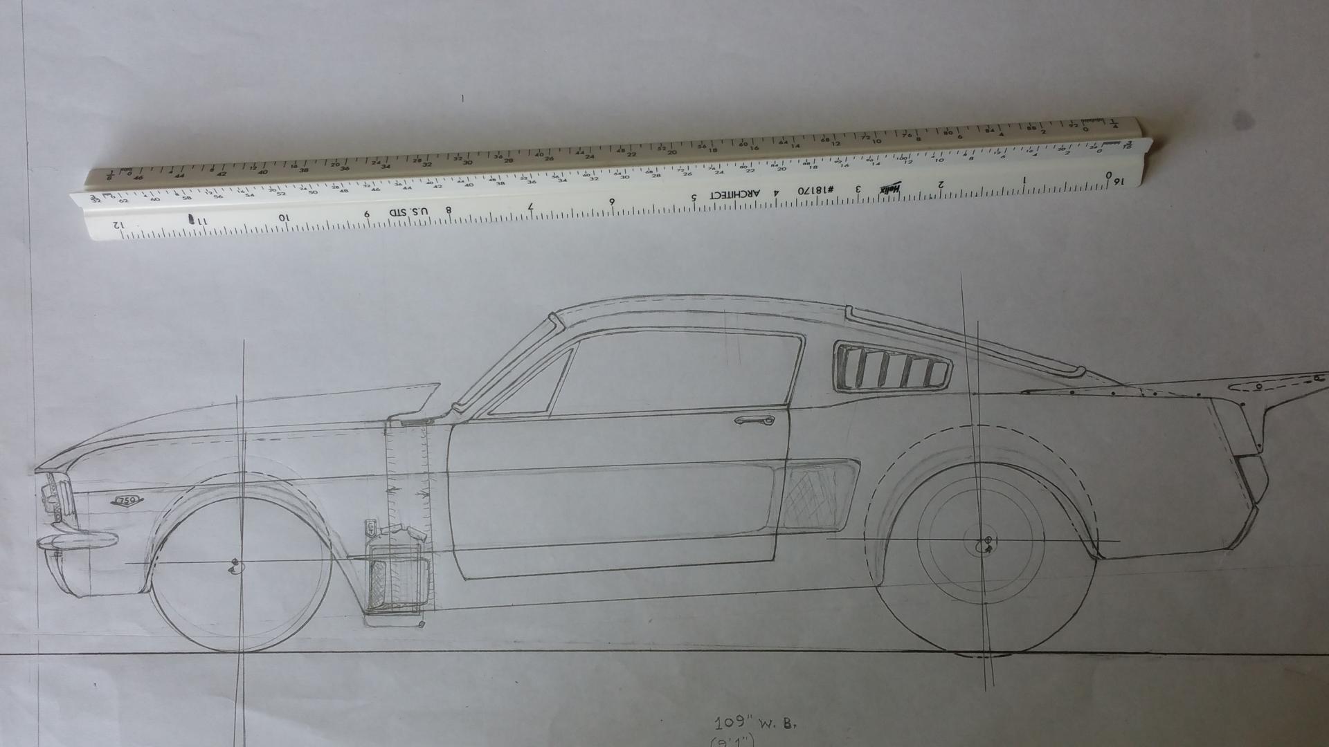

ShakyCraftsman Posted May 6, 2017 Author Share Posted May 6, 2017 Hey all Here's some pics of the drawings. 1st is a Side view of the car. 2nd is side & top view of the chassis and motor. 3rd & 4th are shots of the motor and turbos. So look em over and let me know what you think. I know it's not the mountain motor but this one comes with the twin turbo set-up. Thanks RonG Quote Link to comment Share on other sites More sharing options...
NYLIBUD Posted May 8, 2017 Share Posted May 8, 2017 Wow this car is blowing me away.What perfection,and it just looks great.Cant wait to see this thing built.Your drawings are very interesting,as well. Quote Link to comment Share on other sites More sharing options...
ShakyCraftsman Posted May 8, 2017 Author Share Posted May 8, 2017 Hey NYLIBUD Thanks, those were the first go around. I found out that I needed to stretch the body 9" to accommodate the turbos and the exhaust. So I'm working on a new set of drawings. When I get themdone I'll post some pics.Thanks RonG Quote Link to comment Share on other sites More sharing options...
