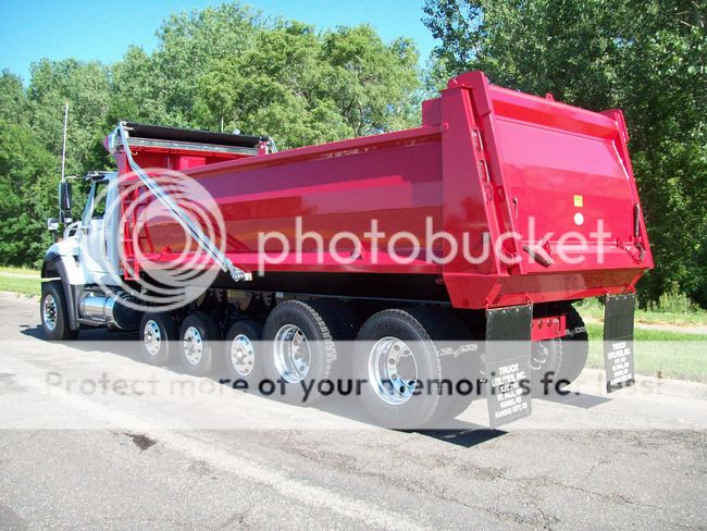

You could still build a dump truck with three axles, but at least most in my area in the WV, OH, and PA region near Pittsburgh hauling coal usually have at least one liftable "tag" axle and more commonly two or three tags, making them 5 or 6 axle trucks.
5 axle
6 axle
The lift axles add 17,000 lbs to the gross weight, so one added to a 3 axle dump truck with a steering axle with the wider float steer tires (like the 5 axle Peterbilt has) would give the truck a 68,000 lb GVWR.
