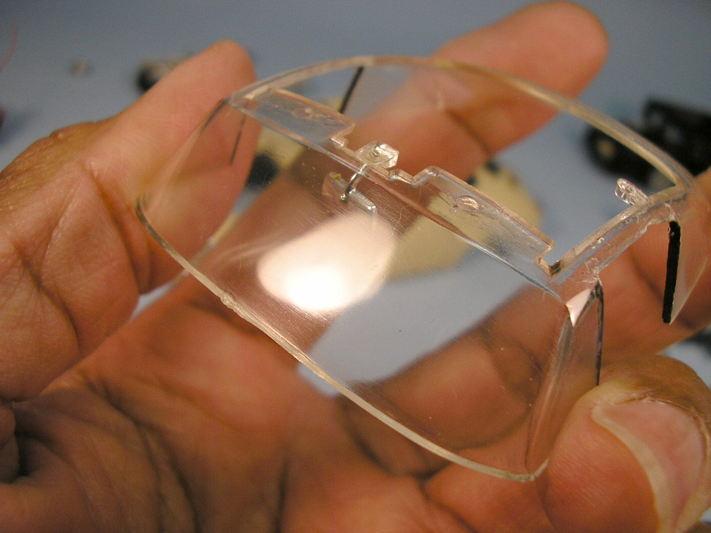

There's some rather deep scratches in the glass, and I'm not sure I'll be able to get rid of those completely. I wanted to take the glass out altogether, but IIRC I used Testors cement (the semi runny kind) on the glass, and it sure set itself in there mighty good over these past 30 years!
The best I can do is to very carefully sand the glass with successive polishing cloth grits, and then try to polish the glass out as much as possible. Of course, if I were doing this as a new build today, ALL the glass would be replaced with clear stencil sheet, as that's MUCH more optically clearer than any kit glass.

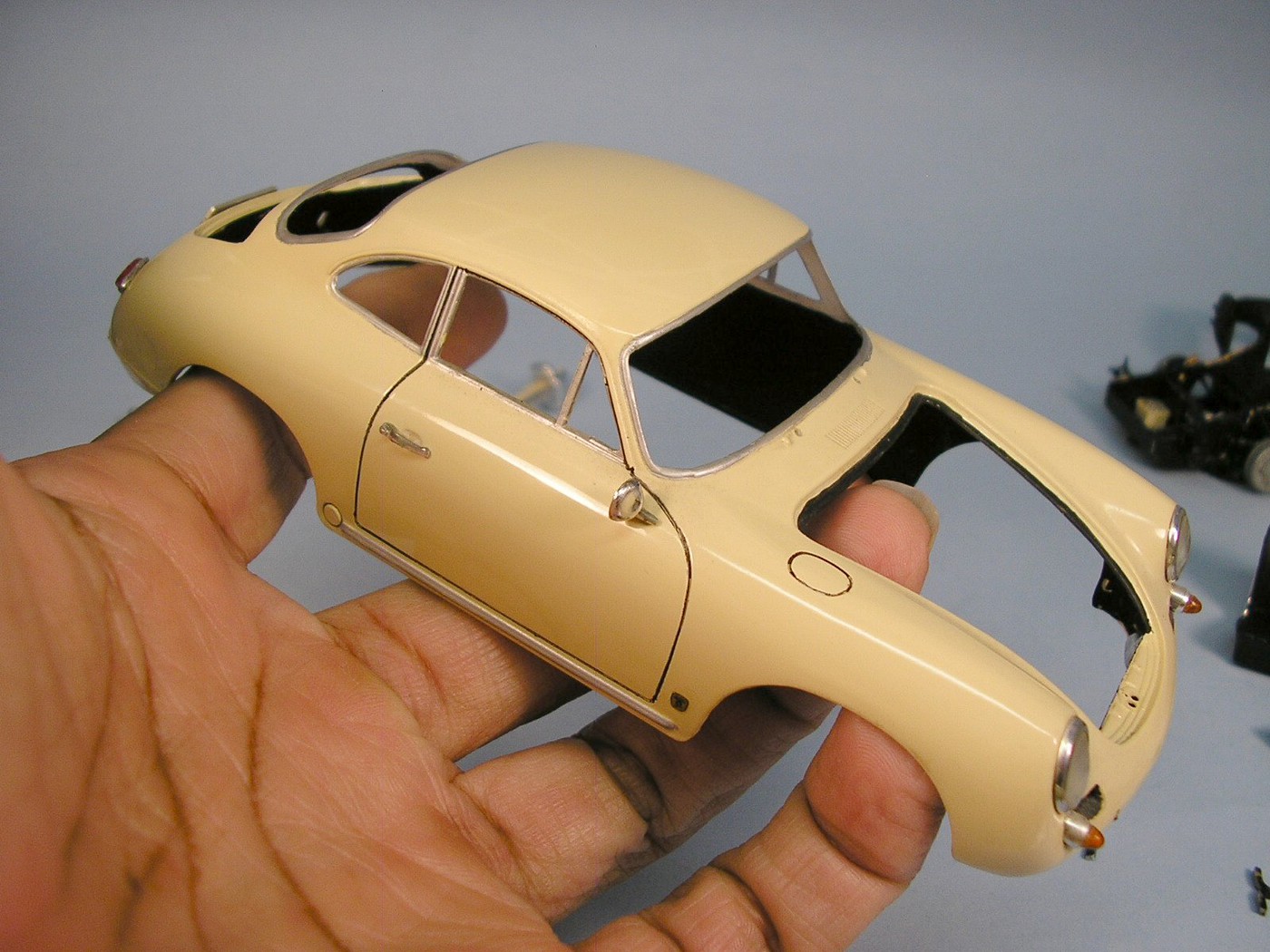

I originally painted the body with Model Master Ivory which I airbrushed on with a Badger 150. I had only been airbrushing a couple years at that point, and I thought the paint was very nice for the time!
Now, I'll simply give the body a good cleaning--------perhaps with some mild soap and water, although there is a small decal on the passenger side front fender. I may just hand wash particularly the top of the car as it's the most grungy/dusty, and then give the body a good wax job with Meguiar's Car Cleaner Wax.
I'll then give the trim a go with BMF as the silver paint I used back then just won't cut it today. The panel lines unfortunately are a little heavy to my view, as I was playing around with using India Ink back then to define them a little more. I wouldn't use that today, but short of stripping the body totally and starting over (not gonna happen) I'll just live with it and look at it as something I learned from 30 years later. ;)

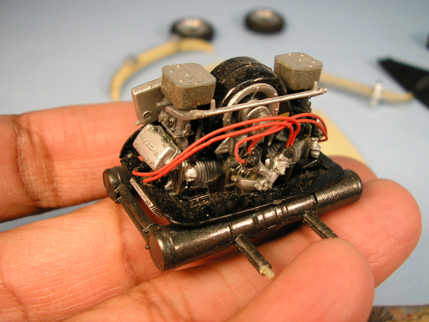

Here's the absolutely beautifully molded Porsche four cam engine! Of all the Porsche engines I've seen done in scale, to me this is the most impressive!
IMO, it's worth it to buy two kits of this car, (if you can swing it) and then build the engine separate to display alongside the built model. Of course, lack of reference on my part (it WAS 1987), and skill, I now know that the engine wiring is woefully wrong for a Porsche twin cam. There should be eight plug wires instead of four as each cylinder used two plugs each.
I'll try as best I can to get it rewired, but I can't promise something won't break along the way. I could always just make a new distributor and of course put new wiring in. Thinner wires I'll use this time around than those thick heavy wires I had back then.

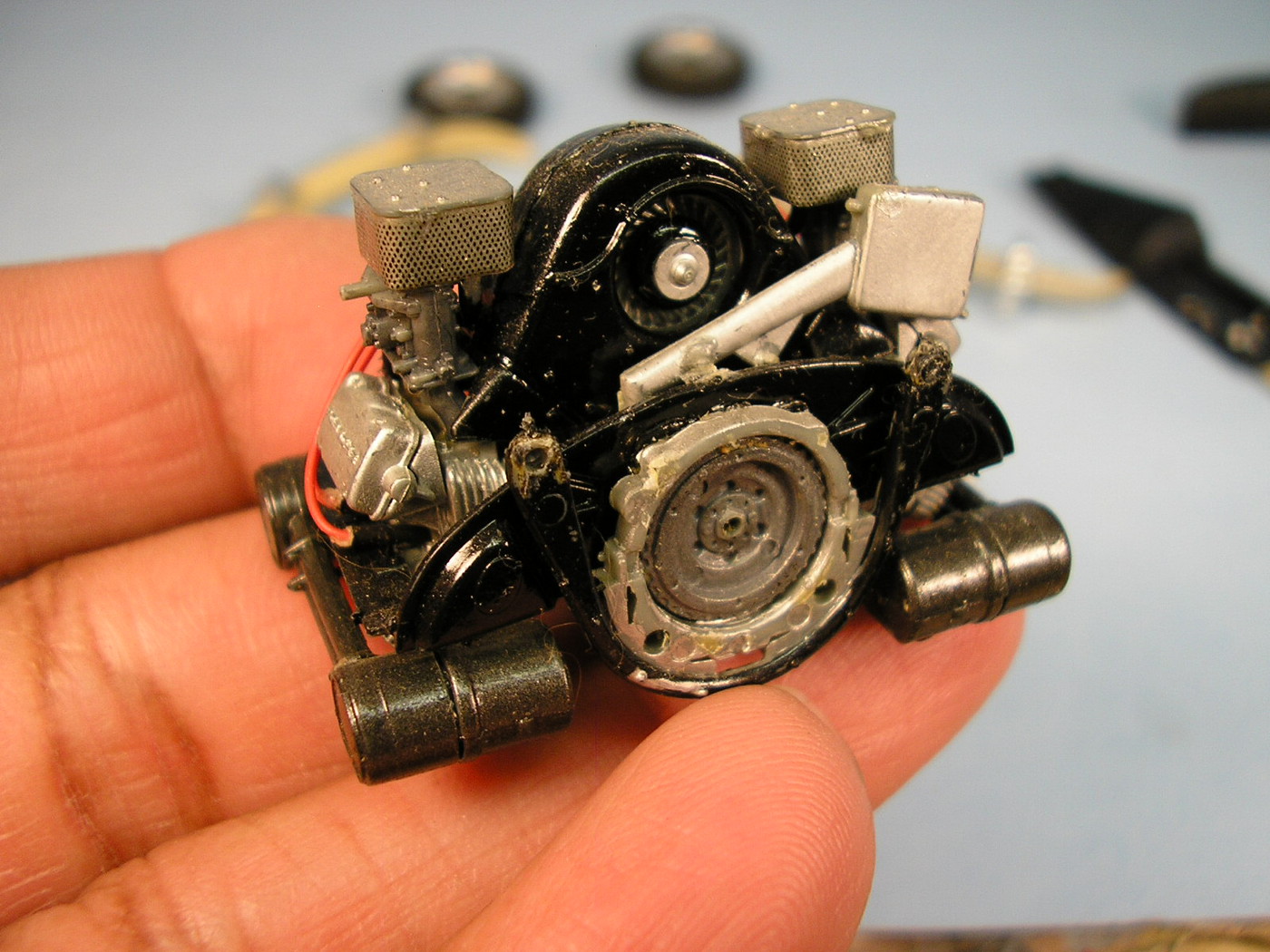

One thing I remember on the instructions which I think is a mistake is how they want you to mount the engine after it's built. You're to put the transaxle in first installed in the chassis, then put the engine in.
While this is all well and good as you might be mimicking the way the actual car was built as it came down the line, this I found leaves an unacceptable gap between the transaxle, and the engine flywheel. Better to build everything together as a single unit, then install it all together.

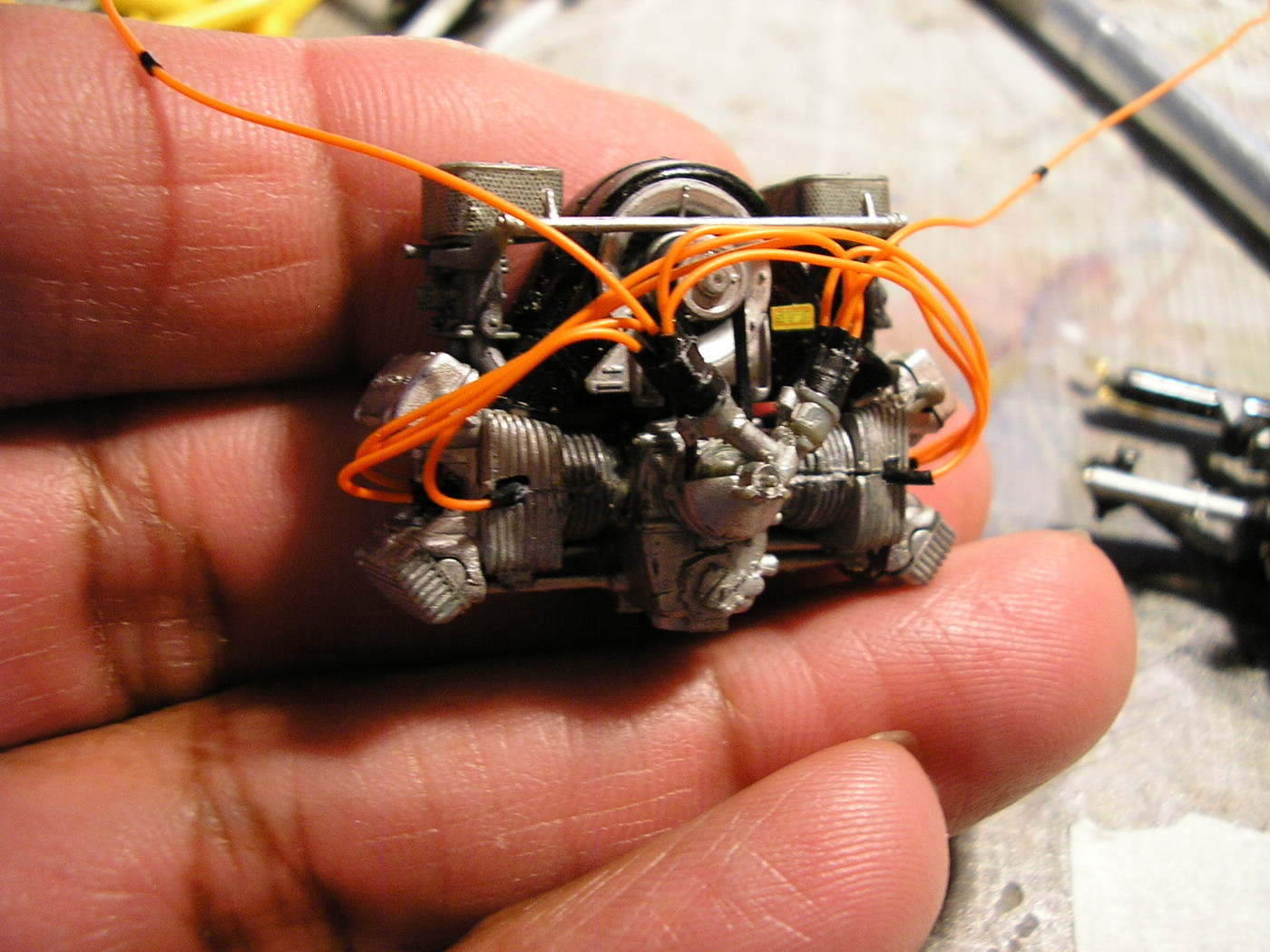

I spent a better part of the day yesterday making the ignition wire arrangement a bit more believable. I got rid of the original distributor caps and made my own out of .100" styrene round rod.
Drilled out the holes for the wires, and using a wiring diagram I found on the 'net, routed the wires as best I could. I also made plug boots from wire insulation and slid these over the ignition wires. BTW, the plug wires are 30 gauge Kynar wire that can easily be found on the 'Bay and comes in all sorts of colors. The only nit I have about this wire is I wish it were just a teeny bit smaller in diameter, but this will suit the engine just fine.
Other engine parts will be added back on as I get the car back together.
I needed a break at some point with the engine wiring, so I decided to give the body a bath, and clean up most of the dust and muck that had accumulated over the years.
I was pleasantly surprised that I was able to get the glass out without much drama. I thought I used regular glue in putting the glass in, when in reality I had used white glue (Crystal Clear) in setting the glass in.
I gotta tell you that was some GOOD STUFF as it was in there mighty tight!
I polished the body up with Meguiar's Car Cleaner Wax and a chamois cloth, and it's interesting how the paint is still nice and brilliant after 30 years! One casualty though of this model being so old, is that there is a tiny paint chip on the roof. Heaven knows how it got there-------my better sense tells me to leave it alone as trying to touch it up would be problematic. More than likely the touch up area won't match the rest of the body paint wise, so I'll just leave it alone.
Another bugaboo is that the windshield wipers are among the missing. I think I have some PE ones around here somewhere, otherwise I may have to rob them off another kit. I do have the driver's side mirror------I thought it was lost, but it was inside the model and fell out just as I was taking it apart.
I'll be BMF'ing the trim just before the whole works gets buttoned up.

I was able to get rid of those deep gouges in the glass by using first an 1800 grit polishing cloth, and working all the way up to 12,000 grit. Then it was polished out with Meguiar's Car Cleaner Wax.
There still are some very fine scratches to banish, but the main thing is those gouges are now history!

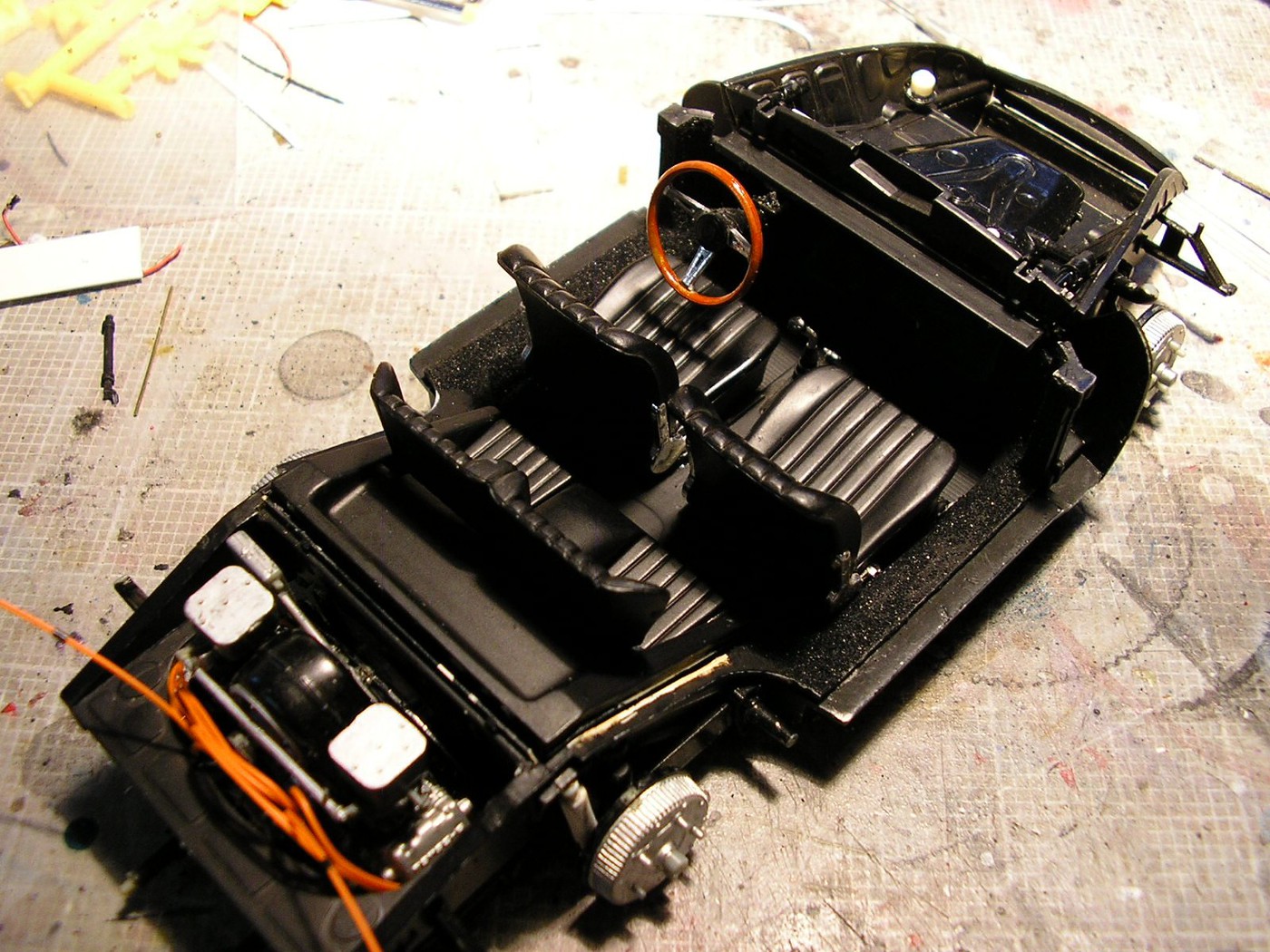

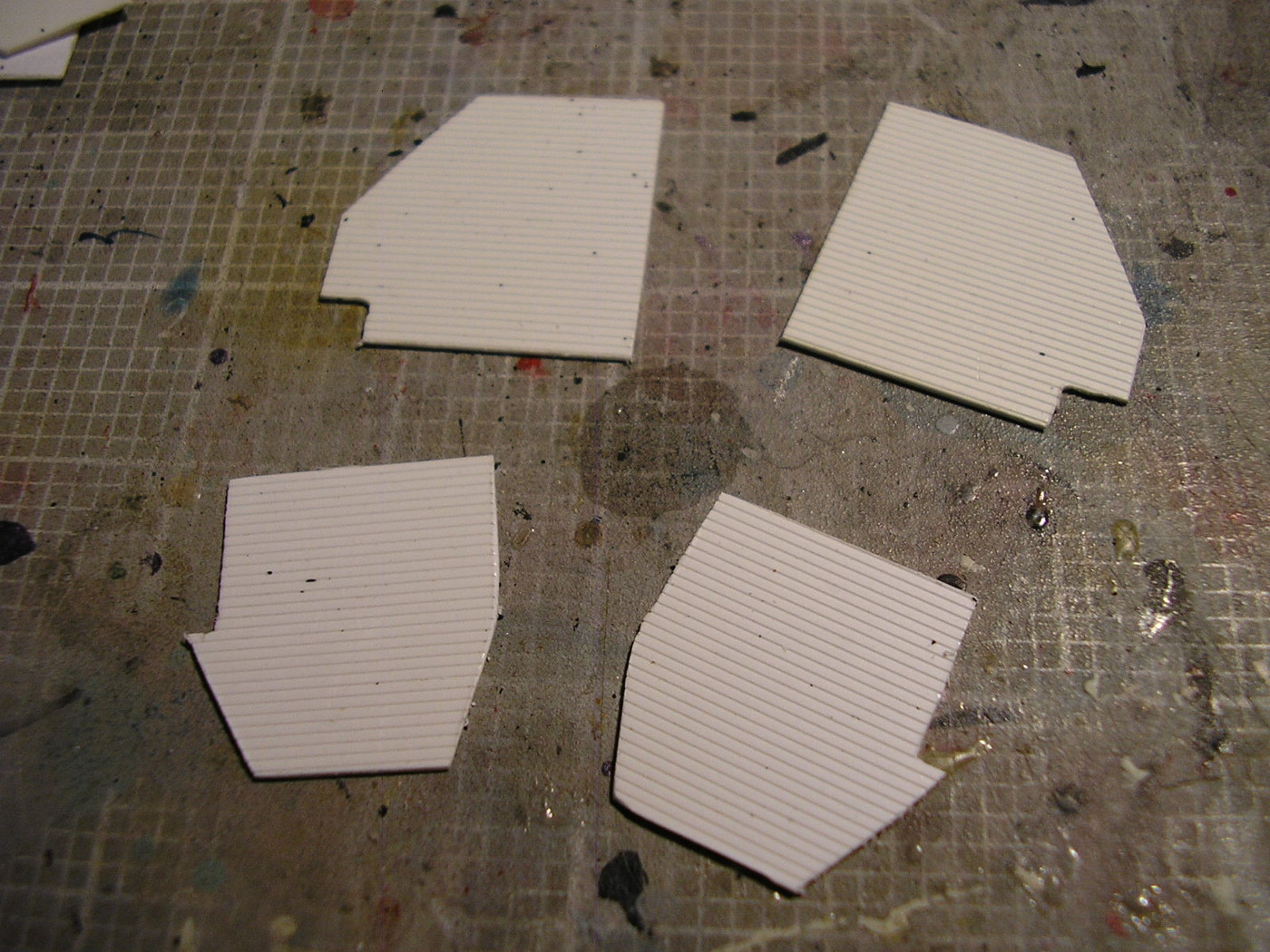

Ripping off an I idea I saw on Jason's build, I made floor mats for the 356.
Interesting that as detailed as this kit was, they didn't give you something to cover up the floor stampings------just bare floor which I'm sure as new, the 356's weren't delivered that way----at least most of them.
I took some Evergreen plastic sheet that had scribed lines in it which are closely spaced (V-Groove .025 spacing, .020" thick). I had to make a pattern to suit the floor shape per side and then used that as a template to cut the shapes.
I painted the mats with Polly S Engine Black paint (now discontinued) which gives a nice rubber like sheen.
Normally, I would double coat the embossing powder, but in this case, since the insides of the car would be hard to see due to it being a coupe, I'm not going to worry about the bare spots. If it were a Cabriolet----oh yeah, I would give the sides more coats as that's definitely seen. ;)
