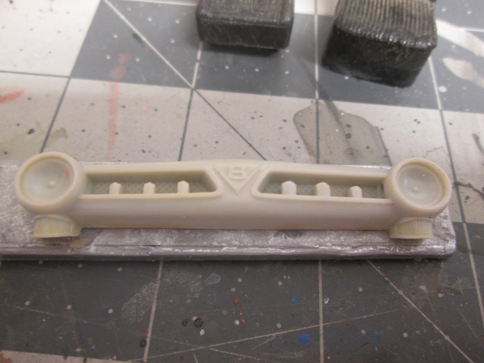

Found a nice '53 grille along with some nicely dirty mismatched seats.

A thought.. the grill in the '53 Ford kit is the one for the high end truck.  Most of them had the lower end grill.  To accomplish that all you have to do is remove the three bumps from either side...
Yeas, I know. It is a truck made from parts. It is actually a '56 with a "found" 53 grille.
