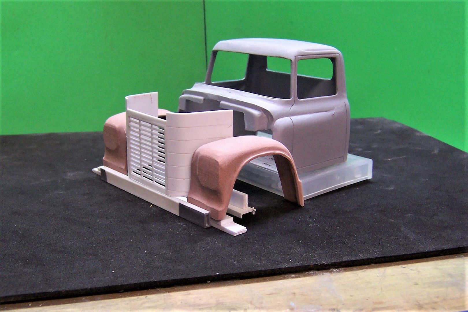

Well here we are.  I primed the cab to check for flaws and found a few.  It needed some corrections to the rescribed door lines and around the top.  Still some tinkering left.
In the photo is a first attempt at a fender made of porch railing stock.  The two reddish pieces are Renshape, a great material for carving and shaping.  It is also quite strong even when carved to a thin surface.  Plenty of work to do to form the headlight areas and grind away the underside of each fender.  In front is the grill that I initially made from plastic strip stock.  It is glued to a piece of sheet stock where it was used a master for making the two part resin grill that is standing between the fenders.  That way I can make additional ones if  necessary.  The pieces between the grill and fenders is sheet stock that was first scribed with those horizontal lines found on the real truck.  Then they were clamped to a wood buck and dropped into some boiling water for a few minutes.  That softened the plastic enough that it would curve without stress.  The exact amount of curvature is still not known but with a few critical measurements we can lay it out so that the hood, fenders and grill all come together against the cab.
Now to get those Renshape fenders to look a little like the mock up at the left!!B)B)

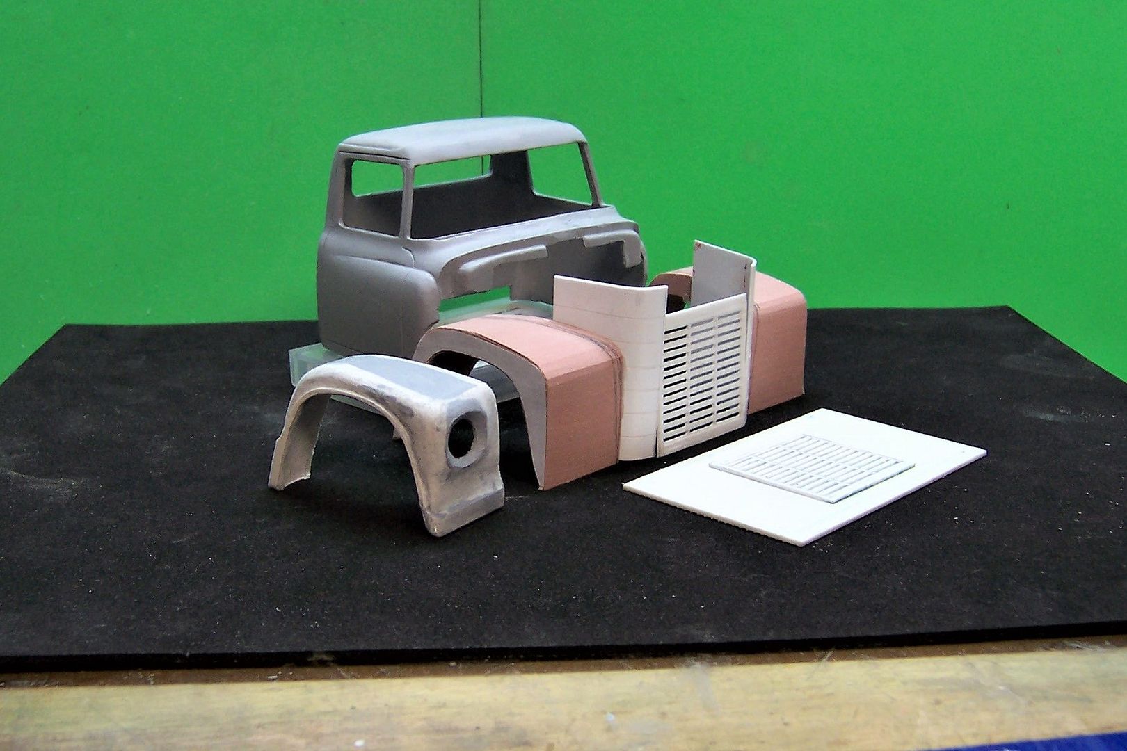

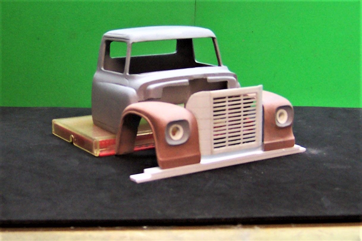

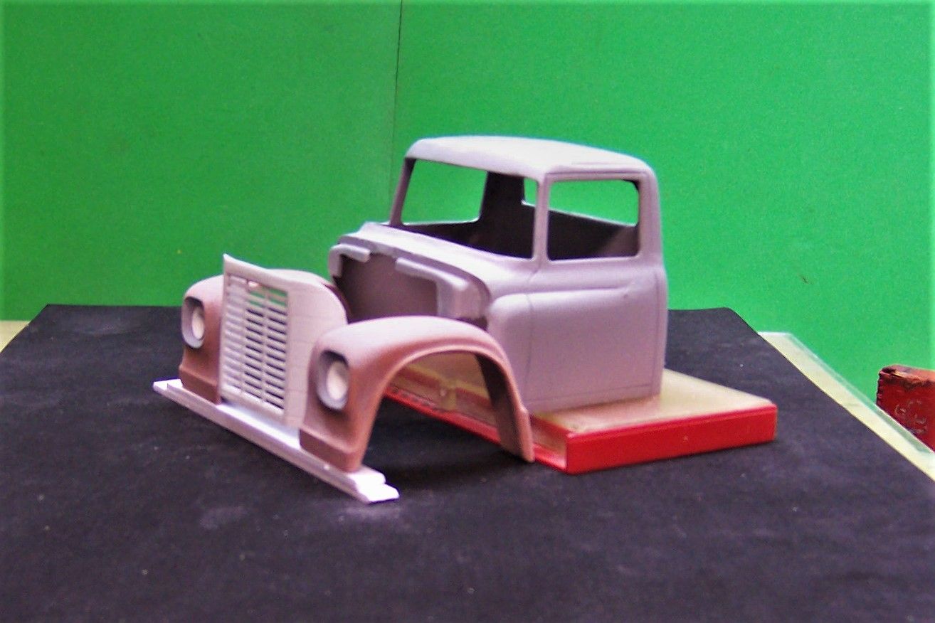

Photos of the carved Renshape fenders.  Now the job is to get the right width from side to side and to get the proper slant on the radiator grill.  It also has to sit at the correct height in order to match the height of the cab where the hood will go.

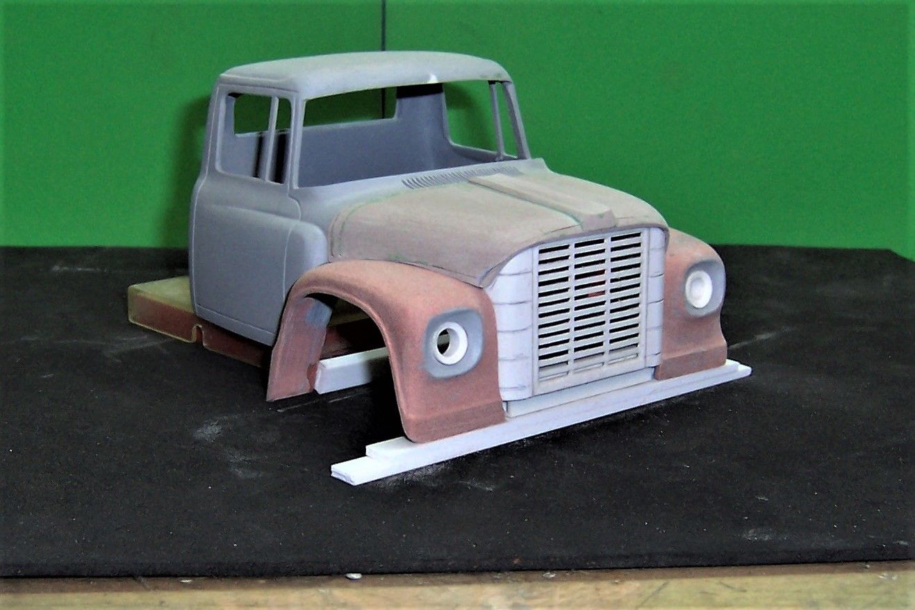

Got the two headlight areas carved out and headlight surrounds inserted.  They both need a bit of final cleanup.  Did some trimming of the grill area and find that the sides aren't quite right.  So two new ones will be done and then will get reattached to the grill.  Anyway here is what has been done so far.

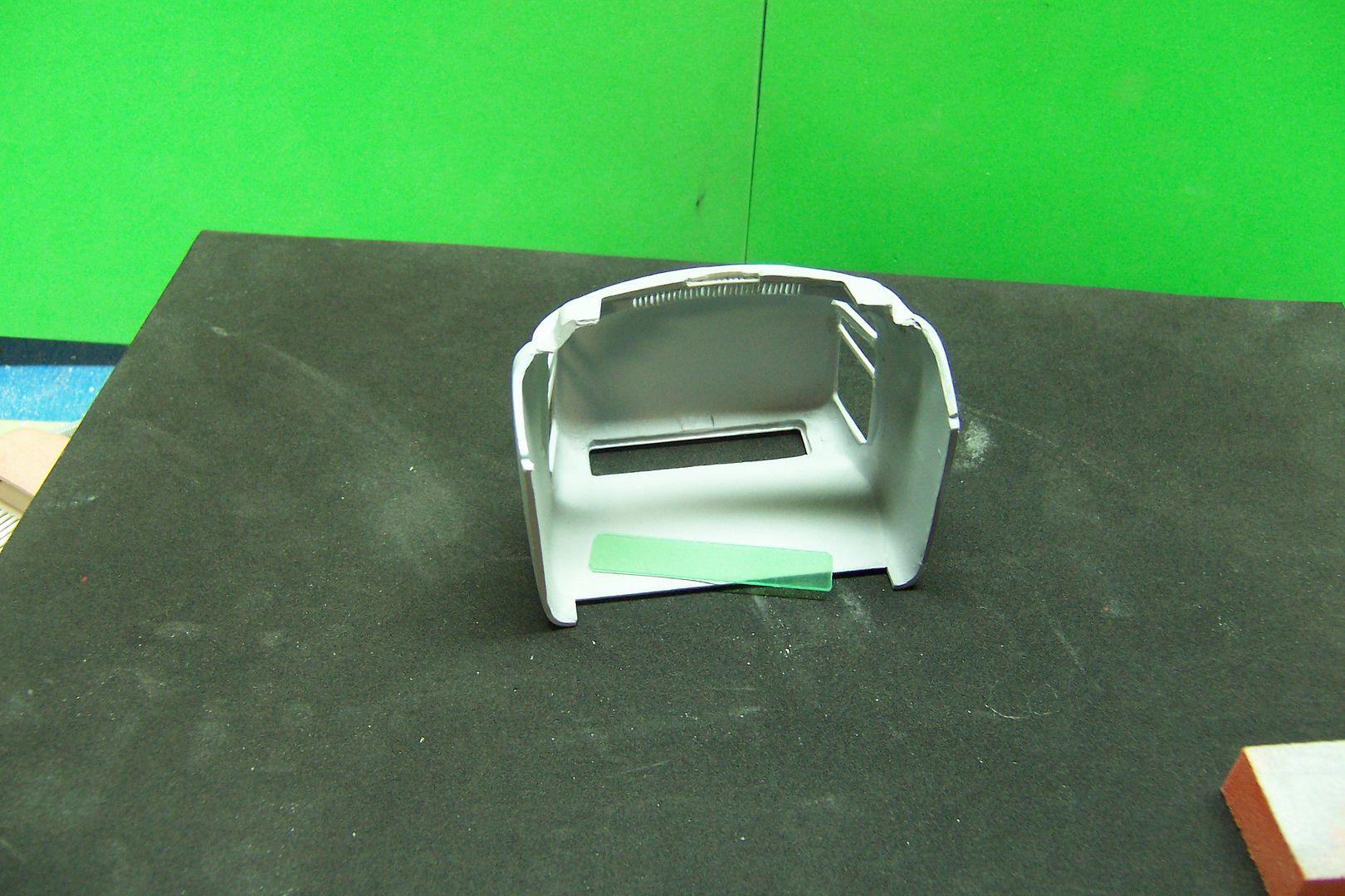

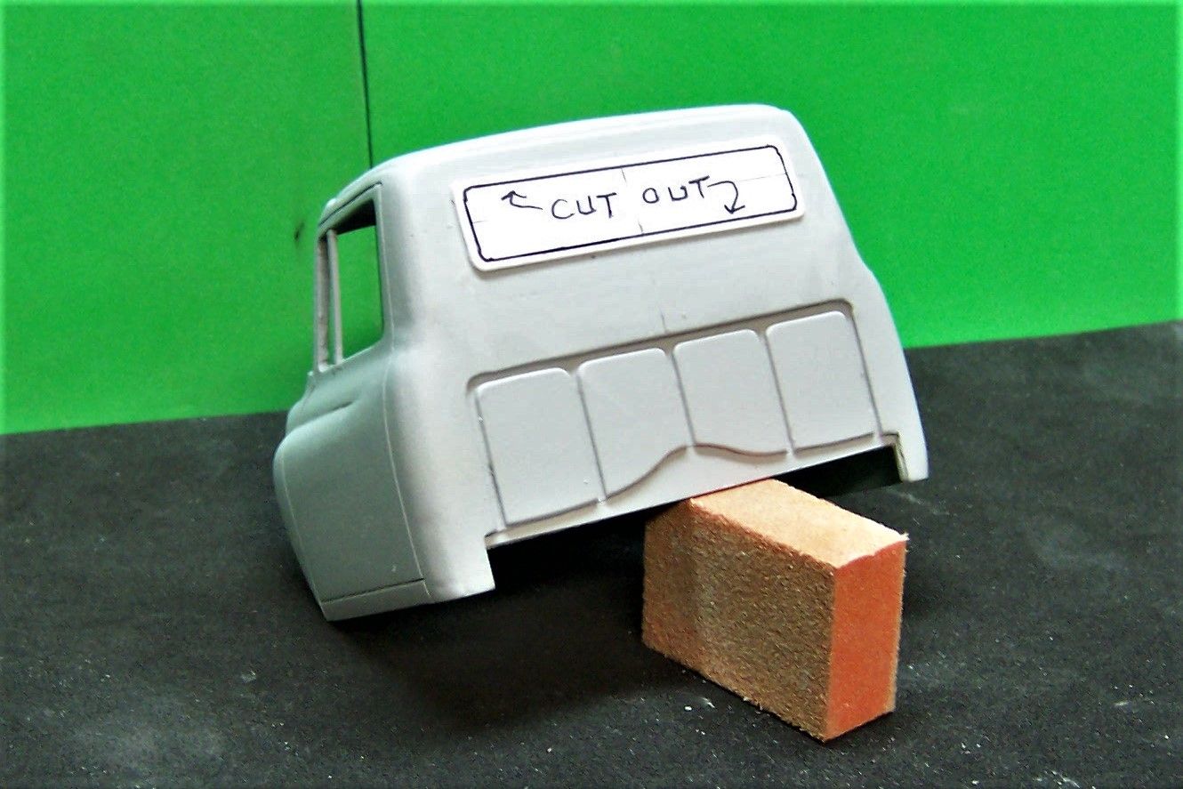

A little something more on the cab.  The rear window needed a rubber gasket to surround the glass.  So some 0.020 sheet stock was used to create one first by making a solid piece and gluing it in place and then by cutting out the interior leaving just enough of a lip inside the opening of the window for the glass to sit against.  A small amount of white glue will hold it in place without the danger of smearing the clear plastic sheet.

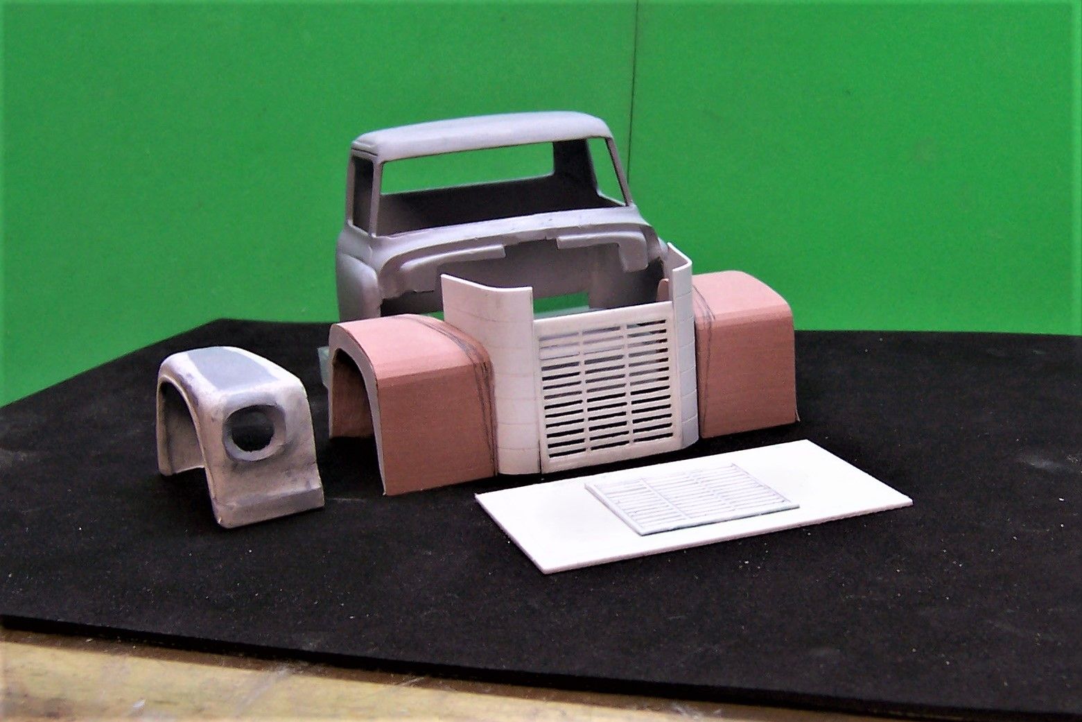

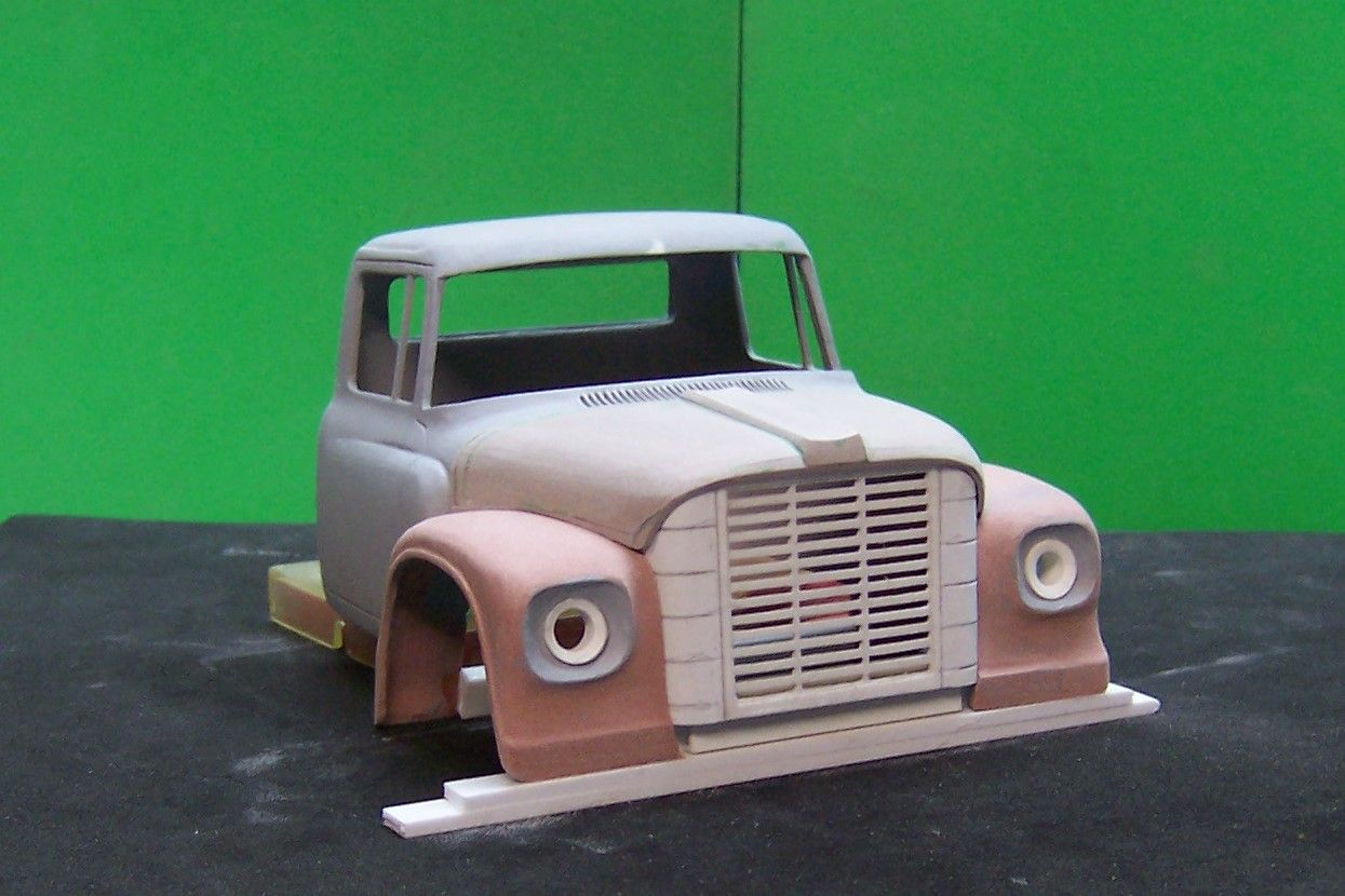

This has to have been one of the more time consuming and somewhat frustrating parts of the build so far.  The hood is a complex piece with curves everywhere!  Not a straight piece to be had except for the sculpture piece in the center.  A lot of time sanding, testing, sanding testing just to get it this far.  Still some tweaking to go along with some detail fitting along the cowl where the hood meets it.  But we are getting there slow but sure.
