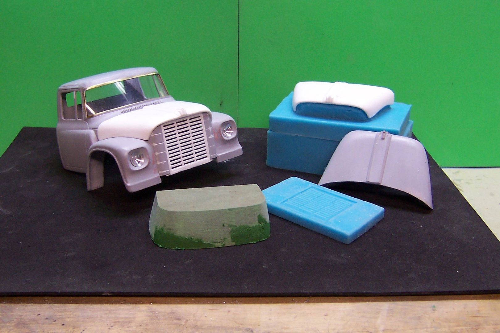

Chariots of Fire Posted June 24, 2017 Author Share Posted June 24, 2017 Take two steps forward and one back! That seems to be what's happening with this project. The windshield area has been giving me fits. That and the part of the cab that is just above it. Studying the photos showed that the shape was wrong so little by little I've been adding filler putty to above the windshield to build it up.. I also had to redo the brass trim to bring the top out more. In the process of doing all that I wrecked the grill with so much handling. Good thing I had a mold of it so I could cast a replacement! This time I backed it up with some stiffeners that should keep it from getting damaged again. I did the same for the hood. With a separate mold, If the truck gets cast with the hood in place I can cut it away to make the hood open butterfly style. Now I'm working on a buck for doing the windshield by vacuum forming one. That's the buck in the foreground of the picture. Quote Link to comment Share on other sites More sharing options...

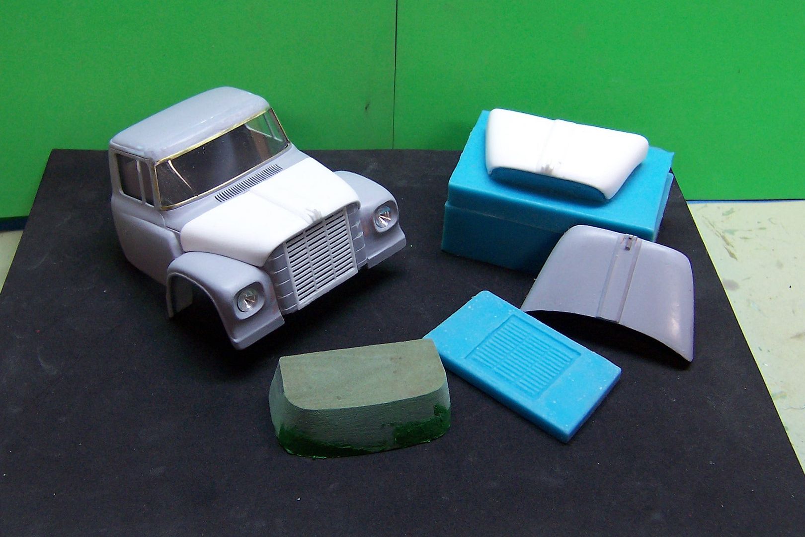

Chariots of Fire Posted June 25, 2017 Author Share Posted June 25, 2017 Tried my first vacuum formed windshield tonite. The machine is very quick and easy to use. However it became quite obvious right away that the buck has to be perfectly smooth in order for the plastic to retain its nice clean surface. The material I used is quite porous and although I sealed and sanded it, the texture still showed through and the plastic that came out was not smooth either. Next time a little less heat and a nice smooth polished surface on the buck will give me a better result. Making the formed plastic fit was real easy after it was trimmed away from the buck. It popped right into position in the windshield frame which is what I was looking for. More to come! Quote Link to comment Share on other sites More sharing options...

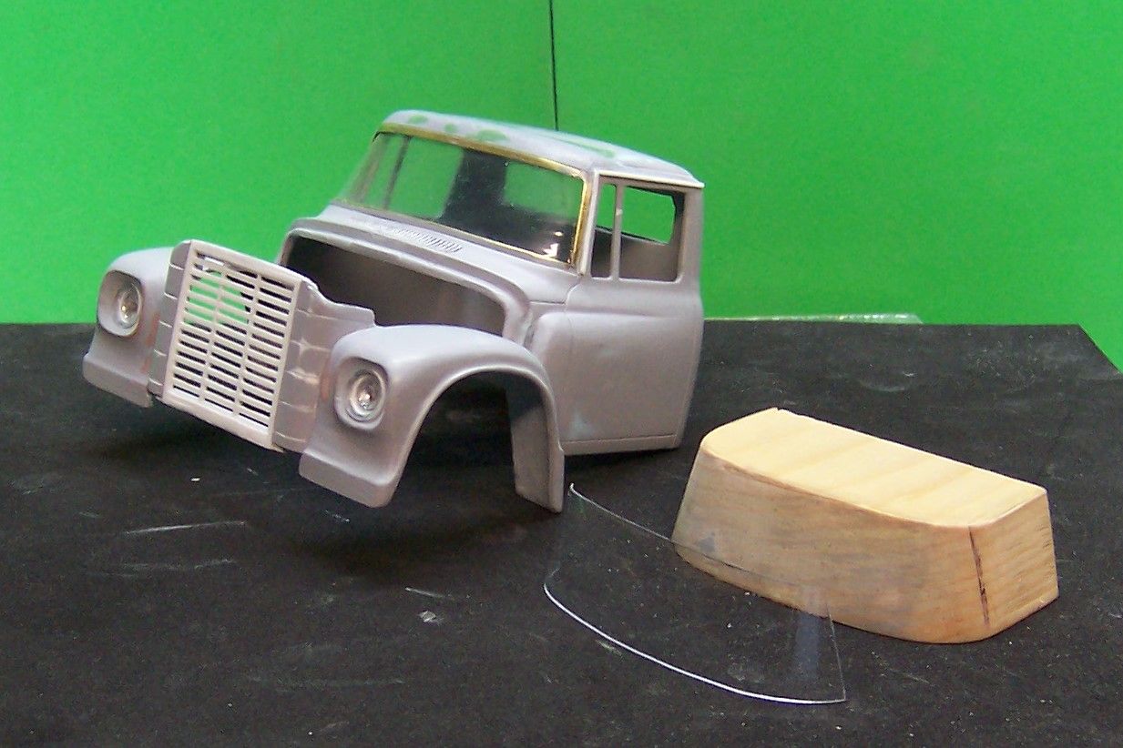

Chariots of Fire Posted June 27, 2017 Author Share Posted June 27, 2017 Tried a wood buck to redo the windshield. Even after several coats of dope the wood grain still came out in the final piece. So will have to do the buck over again, this time using some Renshape that has no grain. It will be well sealed before trying to pull another one. Here's the results so far using the wood. I did polish out the clear plastic and it looks ok but the new one should be even better. Quote Link to comment Share on other sites More sharing options...
Fordboy1975 Posted June 27, 2017 Share Posted June 27, 2017 Why not just coat the wood in filler primer? Quote Link to comment Share on other sites More sharing options...
DrKerry Posted June 27, 2017 Share Posted June 27, 2017 What if you sprayed the wood buck with a sealer? Not sure if it'll work as the hot plastic hits it??! Never did vacumforming so I don't know... Quote Link to comment Share on other sites More sharing options...
Chariots of Fire Posted June 27, 2017 Author Share Posted June 27, 2017 Why not just coat the wood in filler primer?Unless the filler primer is heat resistent it would have a tendancy to soften and adhere to the clear plastic. I think my best bet is the Renshape. The Aero Gloss is a sealer of sorts and it felt really smooth but the alternating soft and hard growth rings in the wood still showed through. Quote Link to comment Share on other sites More sharing options...

GLMFAA1 Posted June 27, 2017 Share Posted June 27, 2017 Charlie : Vacuum form the first windshield, cut to size, place on mold w/double side tape and shot another windshield, this will give you a smooth surface on the windshield as the grain is on inside of the windshield. When I saw the putty on the first on I was going to tell you that would show greg Quote Link to comment Share on other sites More sharing options...

Chariots of Fire Posted June 27, 2017 Author Share Posted June 27, 2017 Charlie : Vacuum form the first windshield, cut to size, place on mold w/double side tape and shot another windshield, this will give you a smooth surface on the windshield as the grain is on inside of the windshield. When I saw the putty on the first on I was going to tell you that would show gregYou don't think the second pull with adhere to the first one? Quote Link to comment Share on other sites More sharing options...
