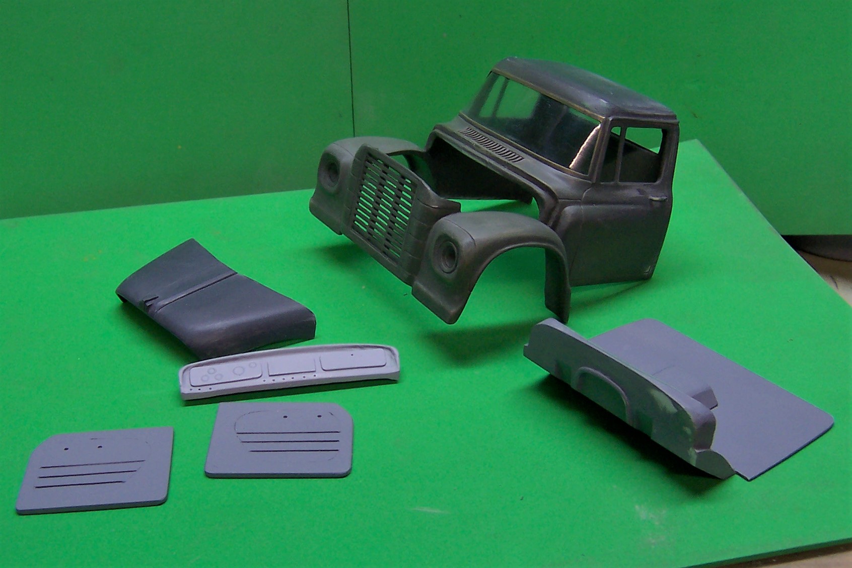

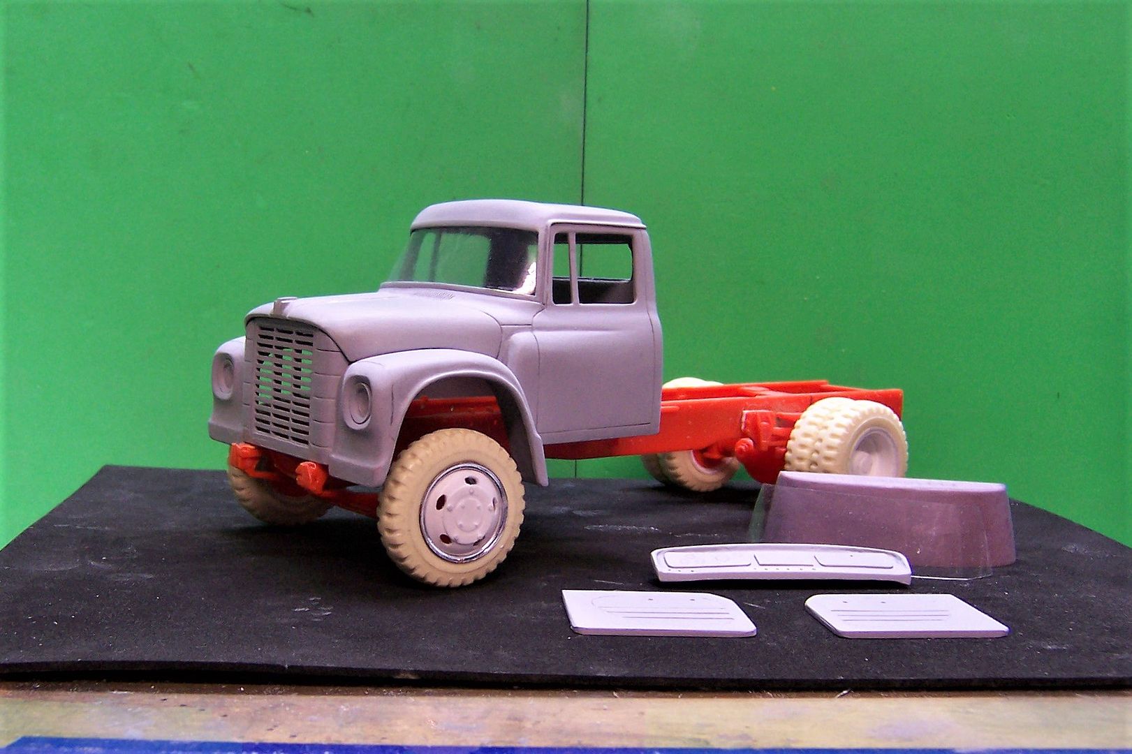

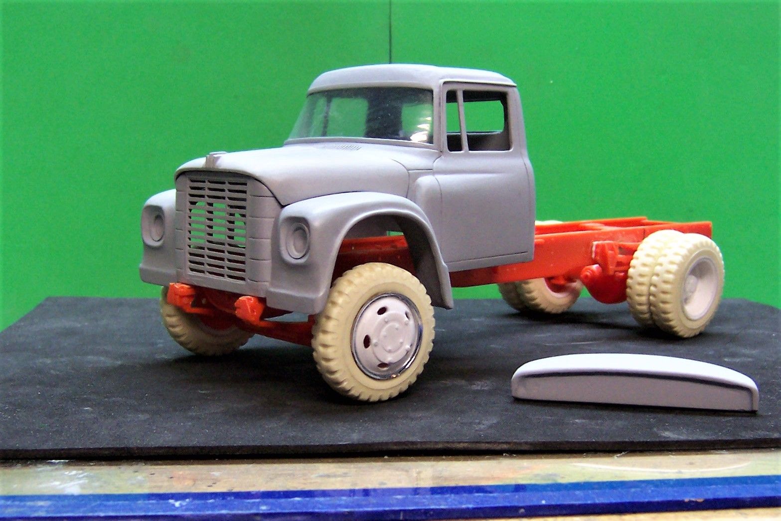

Chariots of Fire Posted July 8, 2017 Author Share Posted July 8, 2017 I'm still working on how to perfect the top of the cab. It has been a project to fill, sand, fill some more and work at the shape. I think it is almost there. Any advice you can give to improve it would be appreciated. I have the cab sitting on a 4x4 chassis just to see how it looks. The front springs are too long and the tires are only temporary but the height above the ground is as it should be, or at least that is how one truck sits that I was able to measure. Tires on it were 7:50 x 20's and the top of the fenders was 53" above the ground. Both are just about right in scale. Quote Link to comment Share on other sites More sharing options...
Wagoneer81 Posted July 8, 2017 Share Posted July 8, 2017 I'm comparing your work to pictures of the real thing ... You're getting very close! It's looking really good. The brow looks right. Quote Link to comment Share on other sites More sharing options...

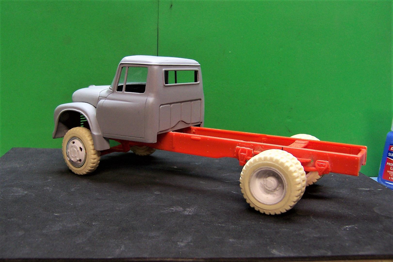

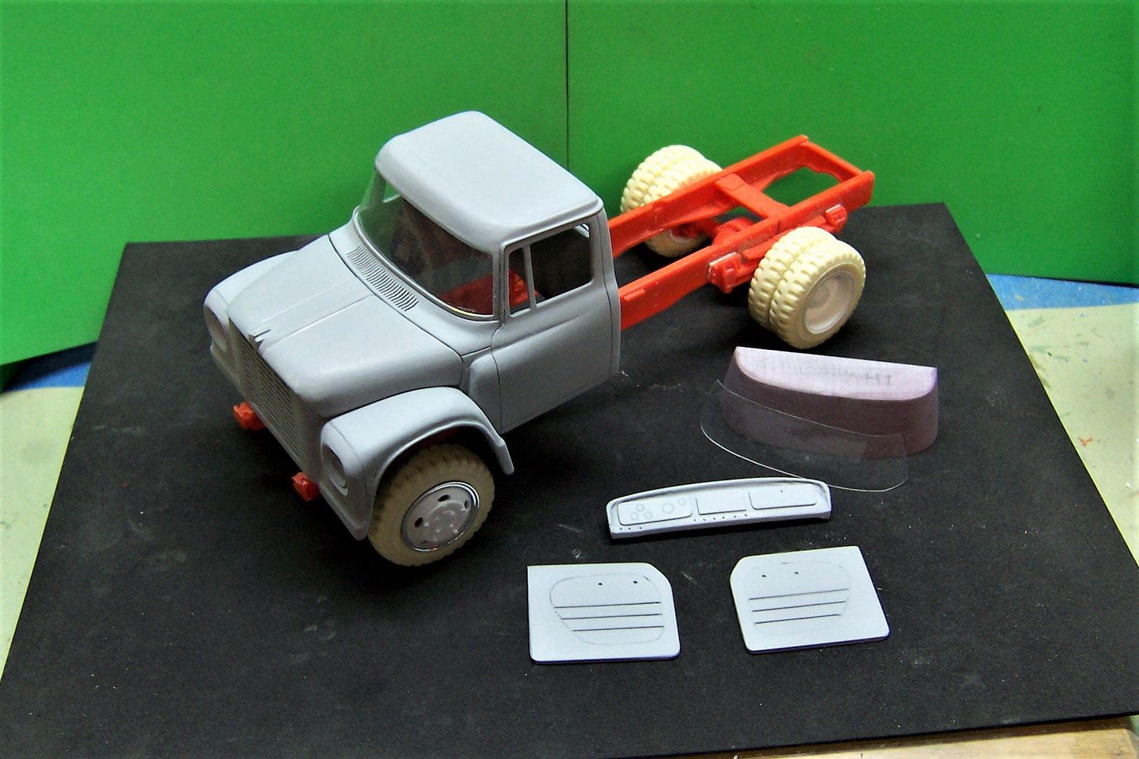

Chariots of Fire Posted July 13, 2017 Author Share Posted July 13, 2017 (edited) Been making some minor adjustments to the top of the cab and I think now it is there! Study of the photos of the real thing from various points of view gave me a better feel for what it should look like. The hood also has been shortened a bit to draw it back. The separation line between the center piece of the hood and the butterfly sections has been cut in. A third try at a buck for vacu-forming the windshield finally gave satisfactory results. It was carved from Renshape and coated with Aero-Glos dope to really smooth it out. The windshield fits nicely behind the brass molding without any glue. And finally some interior door panels have been made and the dashboard basics are done. The dash will fit inside up against the bottom of the brass molding. Next are some interior fender pieces. Edited July 13, 2017 by Chariots of Fire photo location Quote Link to comment Share on other sites More sharing options...

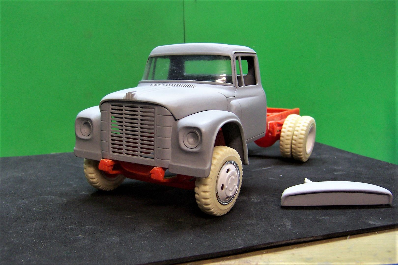

Chariots of Fire Posted July 17, 2017 Author Share Posted July 17, 2017 (edited) Still working on the windshield. I raised the top portion 1/16" and it looks a bit taller which I think is more correct. Going to let it sit for a while and see if I feel the same about it in a couple of days. Still some cleanup to do. It's amazing what shows up when you take photos! Hosted on Fotki Hosted on Fotki Edited July 17, 2017 by Chariots of Fire Quote Link to comment Share on other sites More sharing options...

dodgefever Posted July 17, 2017 Share Posted July 17, 2017 That looks closer. Comparing with your reference photo in the first post, it appears that the windshield curves up as it wraps around, following the crown of the roof, so the top rubber lies above the upper door line. It could stand to be raised a little more? You've done an outstanding job here. Quote Link to comment Share on other sites More sharing options...

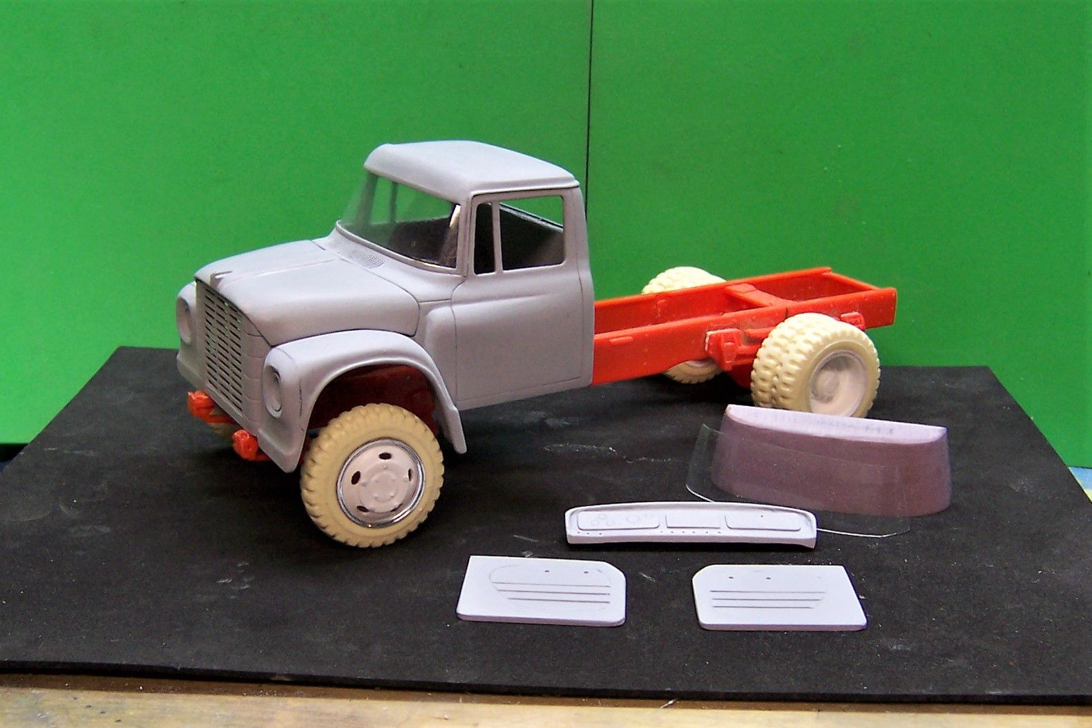

Chariots of Fire Posted July 17, 2017 Author Share Posted July 17, 2017 I think I'm done with the adjustments. It does need some cleaning up around the edges though. Getting closer to the possibility of having it cast. Quote Link to comment Share on other sites More sharing options...

Chariots of Fire Posted July 27, 2017 Author Share Posted July 27, 2017 Well, I think we are there. The Loadstar cab is finished, the door panels, dash and floorboard are done. I've been talking with Dave Natal of AITM and he has agreed to look it over for casting. I will keep you posted on progress. Quote Link to comment Share on other sites More sharing options...
