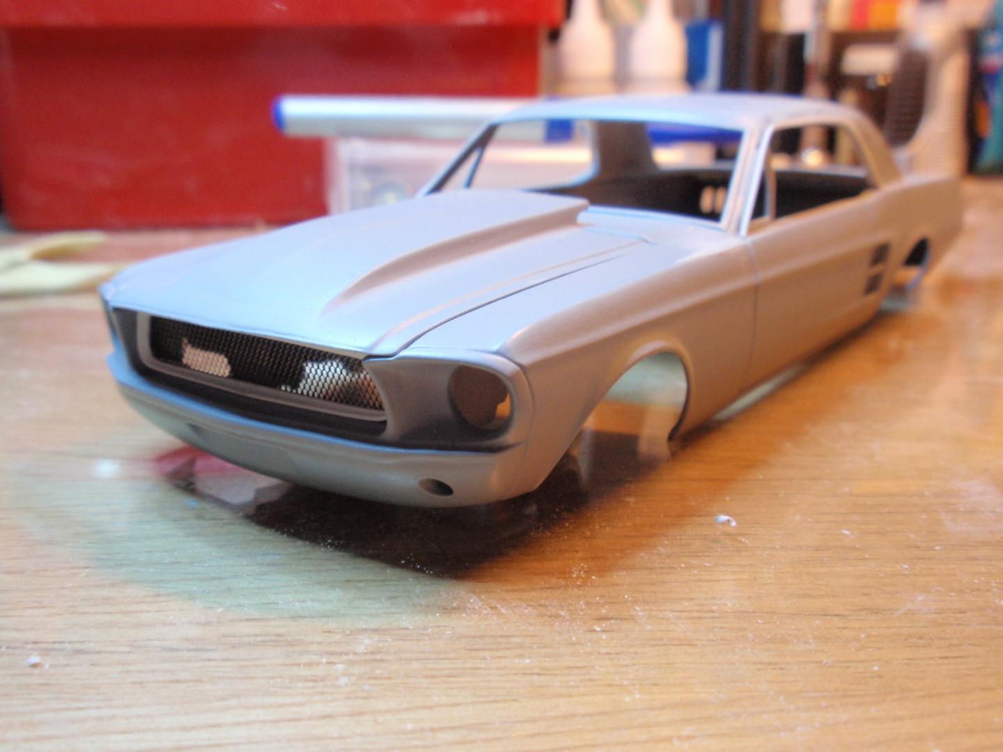

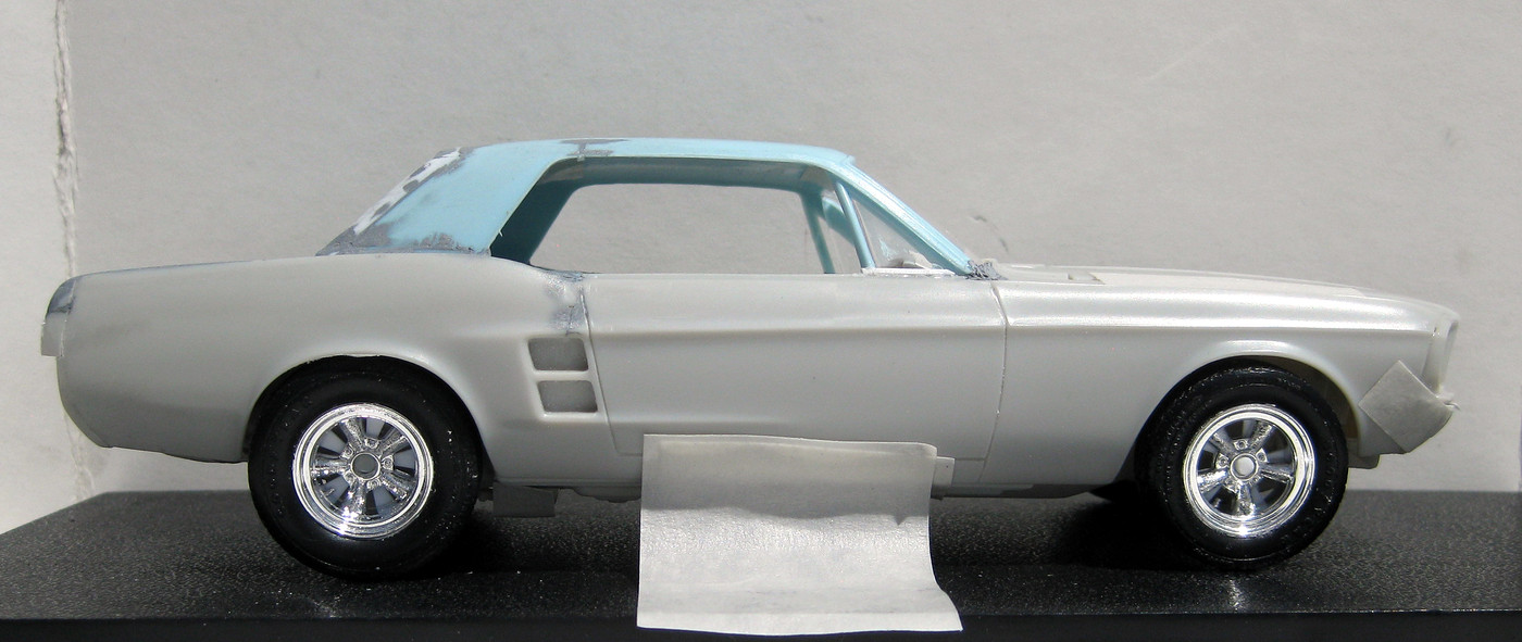

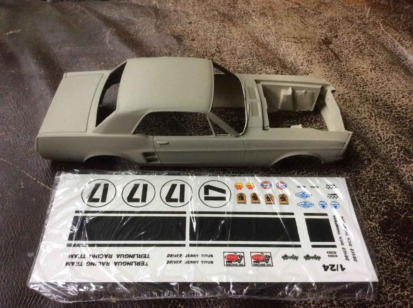

THE MODEL - I taped together my progress so far to take to a model club meeting so I could not resist posting. My camera got ripped off recently so please excuse the quality of the attached photos.

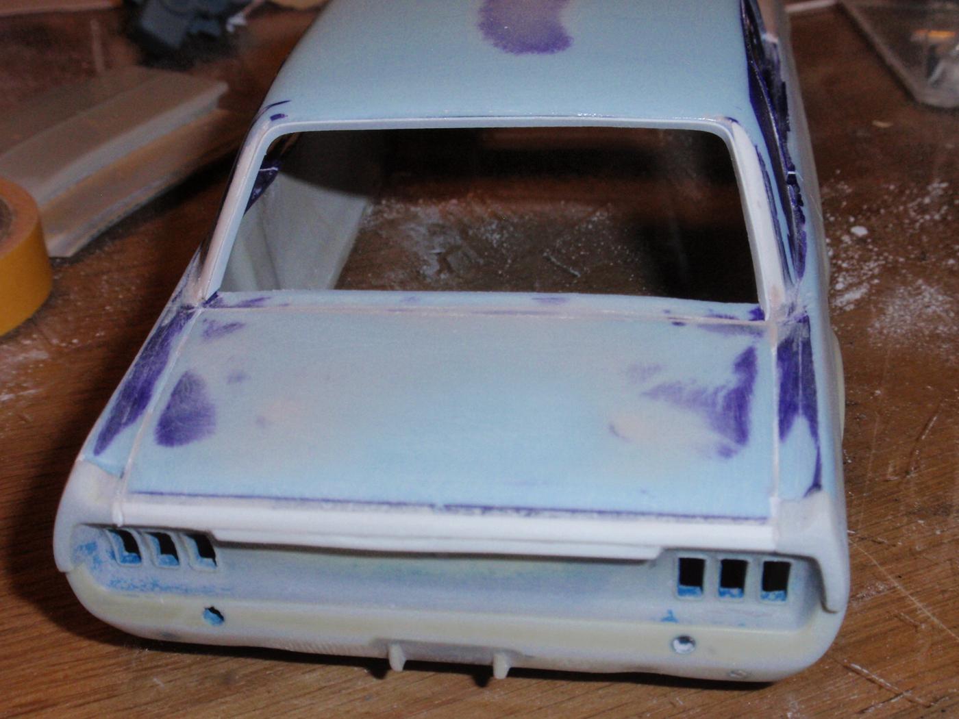

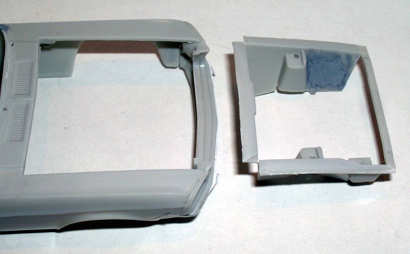

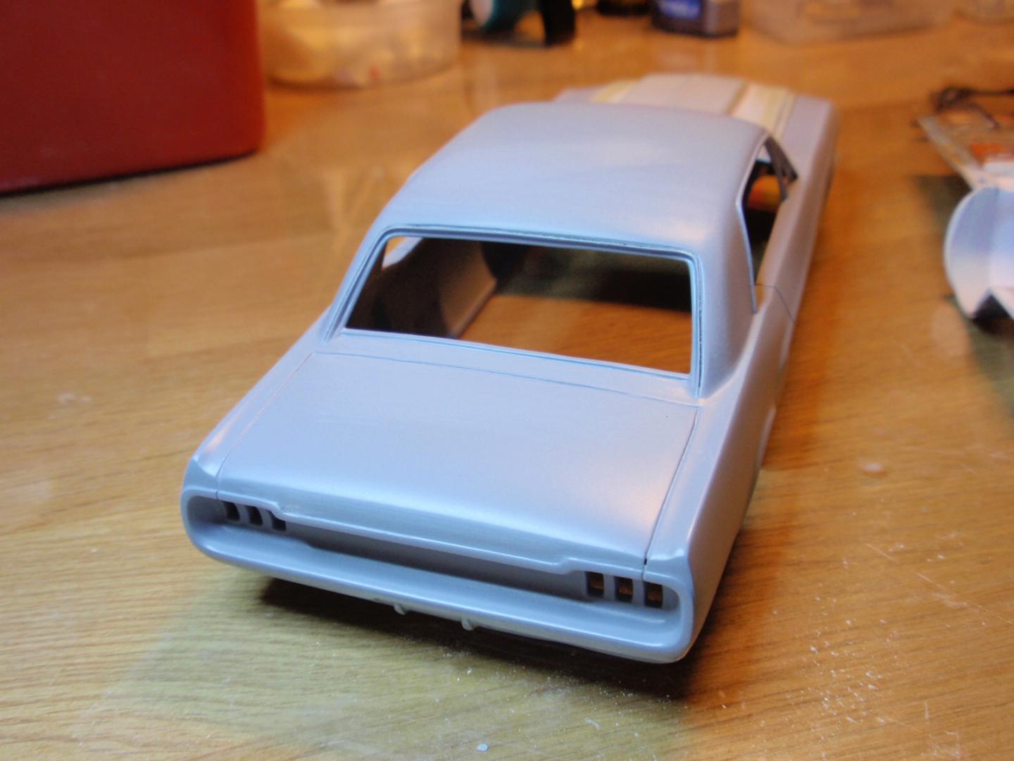

BODY - I started with the very good AMT ’67 Mustang GT Fastback kit. I converted the body to a notchback a number of years ago. It was my second notchback conversion. I previously built a replica of my nephew’s ’68 over twenty years ago. The conversion entails grafting on the roof and trunk from the AMT ’66 Mustang Coupe. Some additional plastic and putty is required around the rear window and at the trailing edge of the trunk to approximate the ’67 Mustang characteristics.
In front I removed the grill to be replaced with mesh. The license plate area was opened up and the bumper mount arrangement was added.

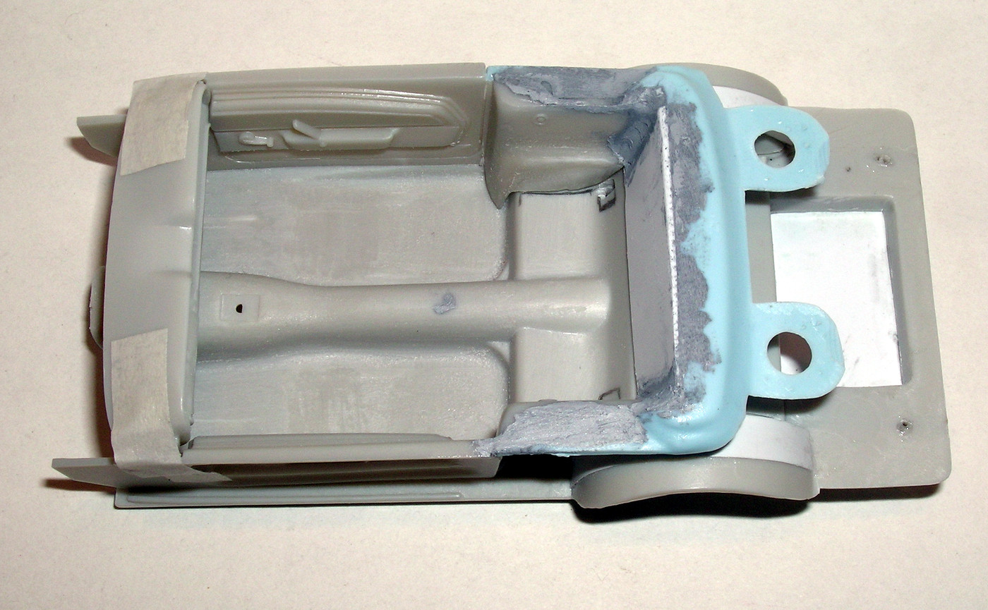

INTERIOR – The rear seat was removed and filled. The floor was smoothed.

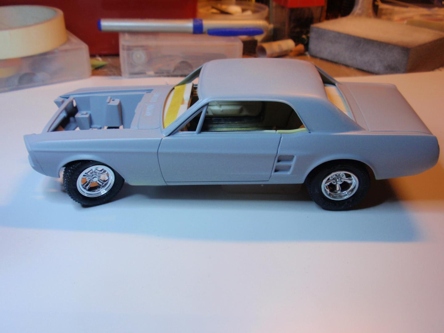

ENGINE – The rules allowed two 4-barrel carbs. I fabricated the manifold and used carbs from  Revell ’32 Ford kits which also provided the exhaust manifolds.
CHASSIS – The front spindles were raised. The inner sides of the wheel tubs were cut, bent inwards and filled for the wider tires. The rear spring mounts were cut down and the forward end of the springs now attach to the “frame rails” to provide clearance for wider tires.
WHEELS & TIRES – The American Racing wheel came from the Revell C3 Corvette racecar kits as are the Goodyear Bluestreak Sportscar Special tires. The wheel backs are from the Revell ’32 3-W with hubs ground off. Wheels were drilled to fit directly on axles/spindles.
PAINT – Shelby referred to the body color as “Gawd awful yellow”. I will use Testor’s light yellow enamel and semi-gloss black
DECALS – Will be those produced years ago by Fred Cady
IMG 1452IMG 1450IMG 1451

Good to see you recessing the rear window....a mod most miss. Owning a 68 notch Mustang.....it stands out to me.

Seems to be a trend going on here.  I need to do the rear window modification.

You did a fantastic job replicating the back window area and trim above taillight panel. It also looks like you enlarged the headlight openings. The mesh you have in the grill is very realistic.

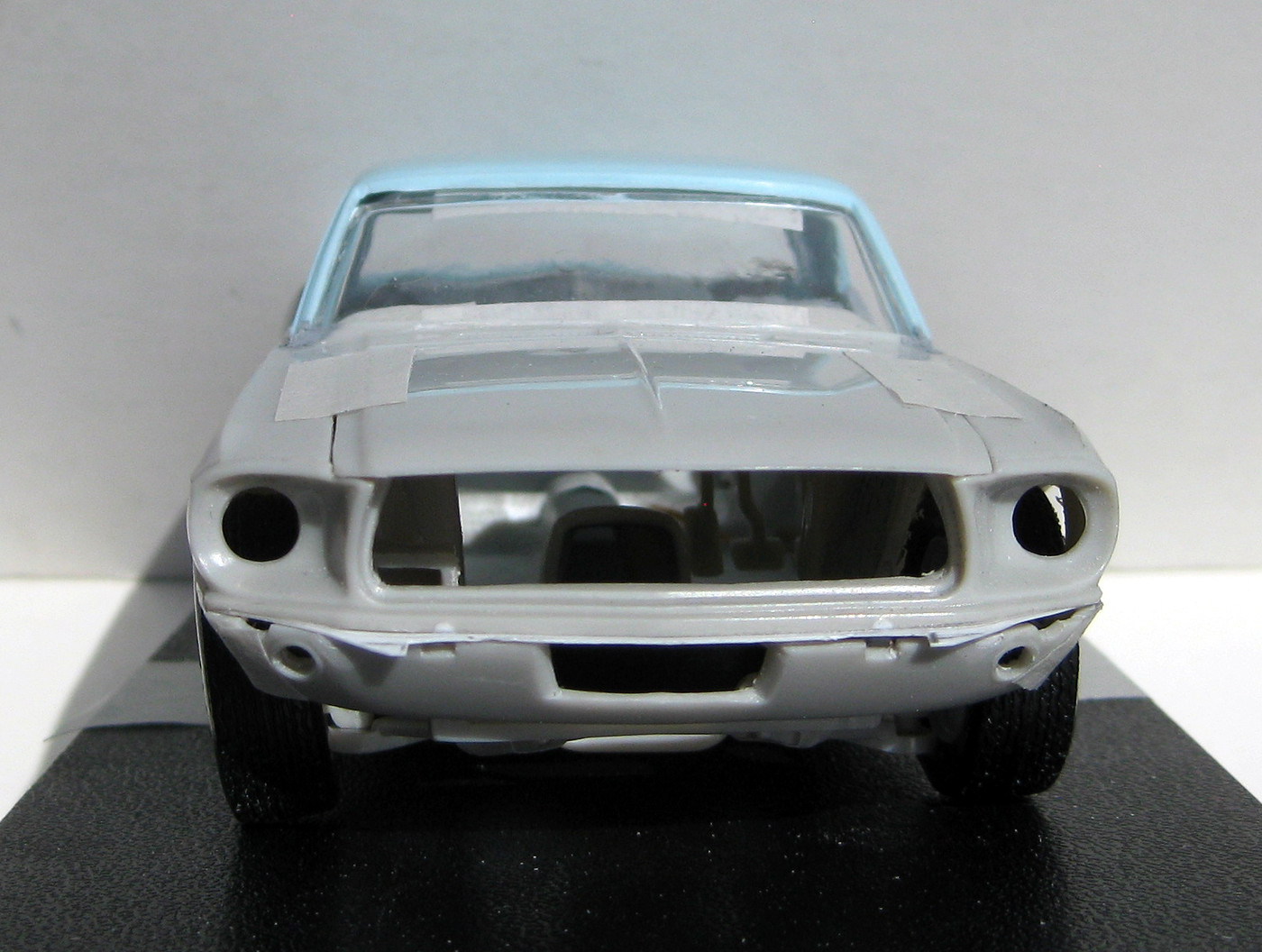

Modifications since previous update
-         Added extra detail where rear bumper would be mounted. Going to revise cover for stock fuel filler
DSCN3886
-         Separated engine compartment from body to facilitate separate painting but first drilled for hood pin location
DSCN3887
-         Separated front sub-frame from chassis again to facilitate separate painting
DSCN3889
-         Removed fuel tank also to facilitate separate painting. Widened rear wheel wells by cutting inner vertical section and pulling inwards. Also had to relocate forward end of springs to give enough clearance for wide tires. Cut holes for over-rider traction bars

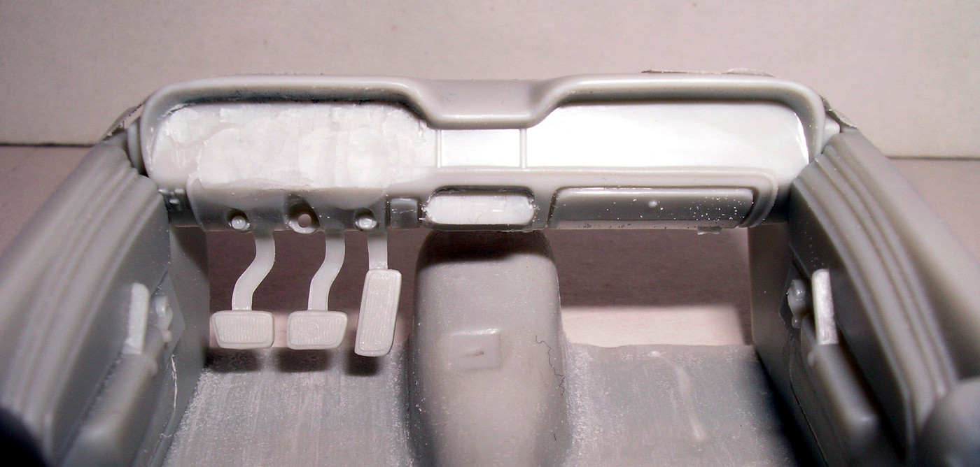

-         Interior – smoothed floor, fabricated panels where rear seat no longer is. Removed details from dash to make ready for racing instruments

Hey very nice and detailed planning here,, one thing,are the pedals going to remain as they are???  to my eye they are bulky,,.thank you
Share this post
Link to post
Thanks Guys - Yes I noticed the bulkiness of the pedals in the photo. Even though they will be hard to see in the completed model, I likely will modify them. I have pretty much finished with the other necessary modifications and am now getting parts ready for painting. I just got a new camera so hope to have an update in the near future.
