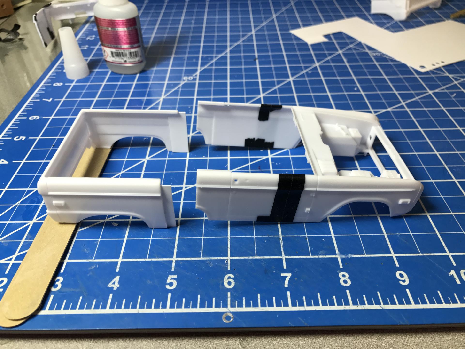

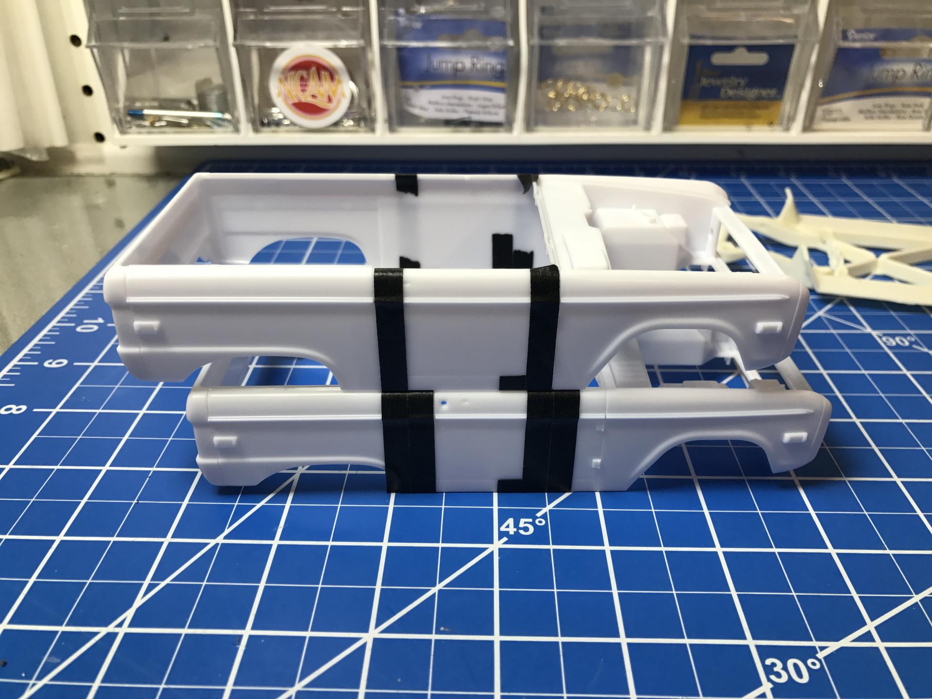

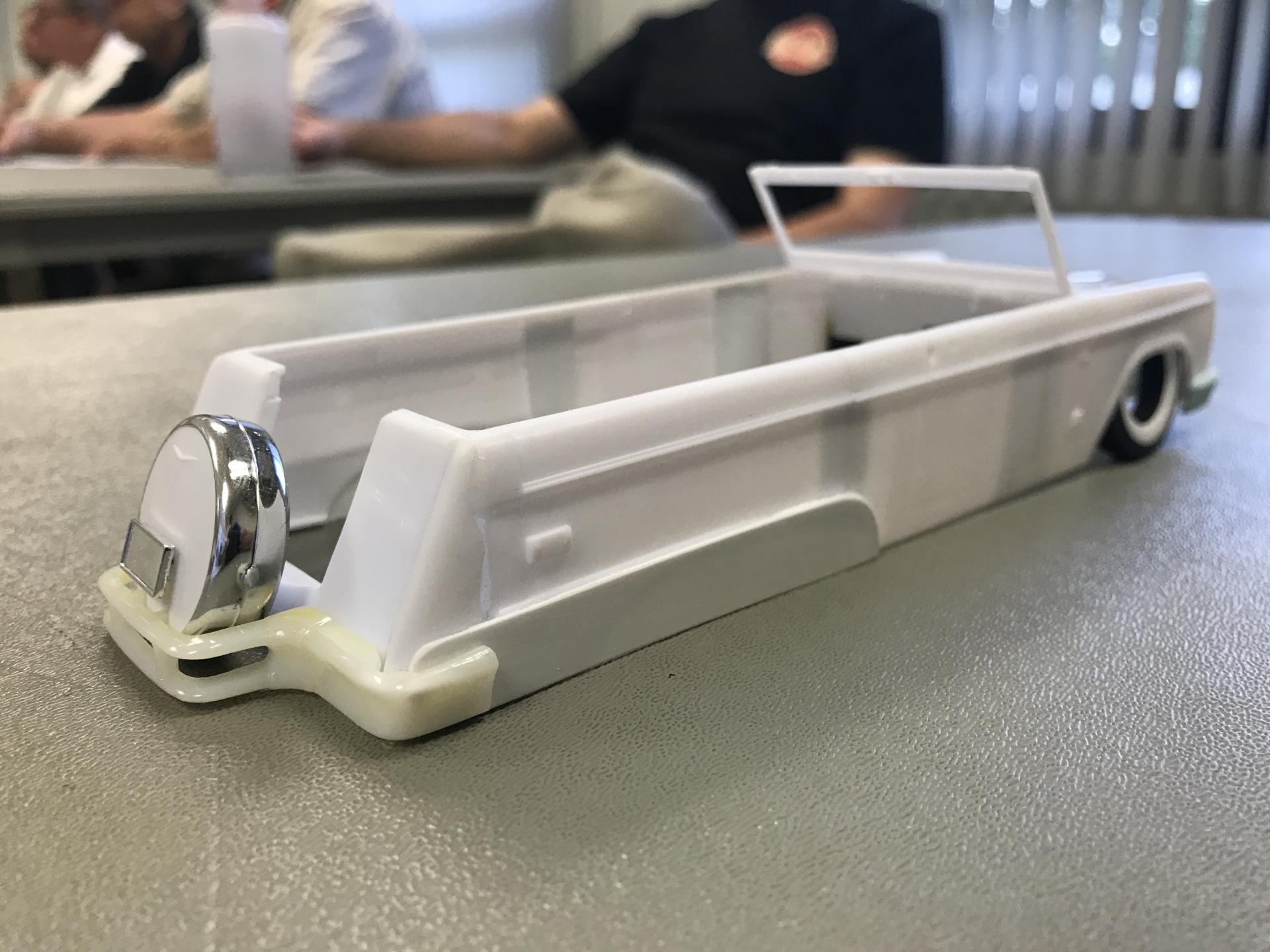

So first things first it needed to be a bit longer. so i had to buy 2 kits... and combine them.
Added about 5/8"behind the door opening... and about 1/4" to the door to get the proportions all to work.

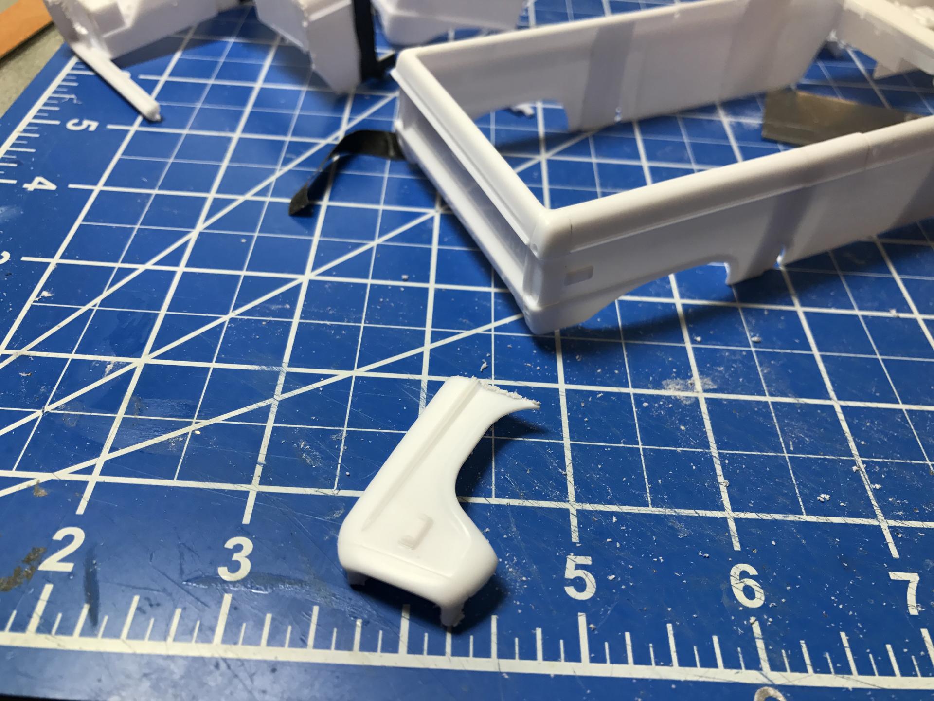

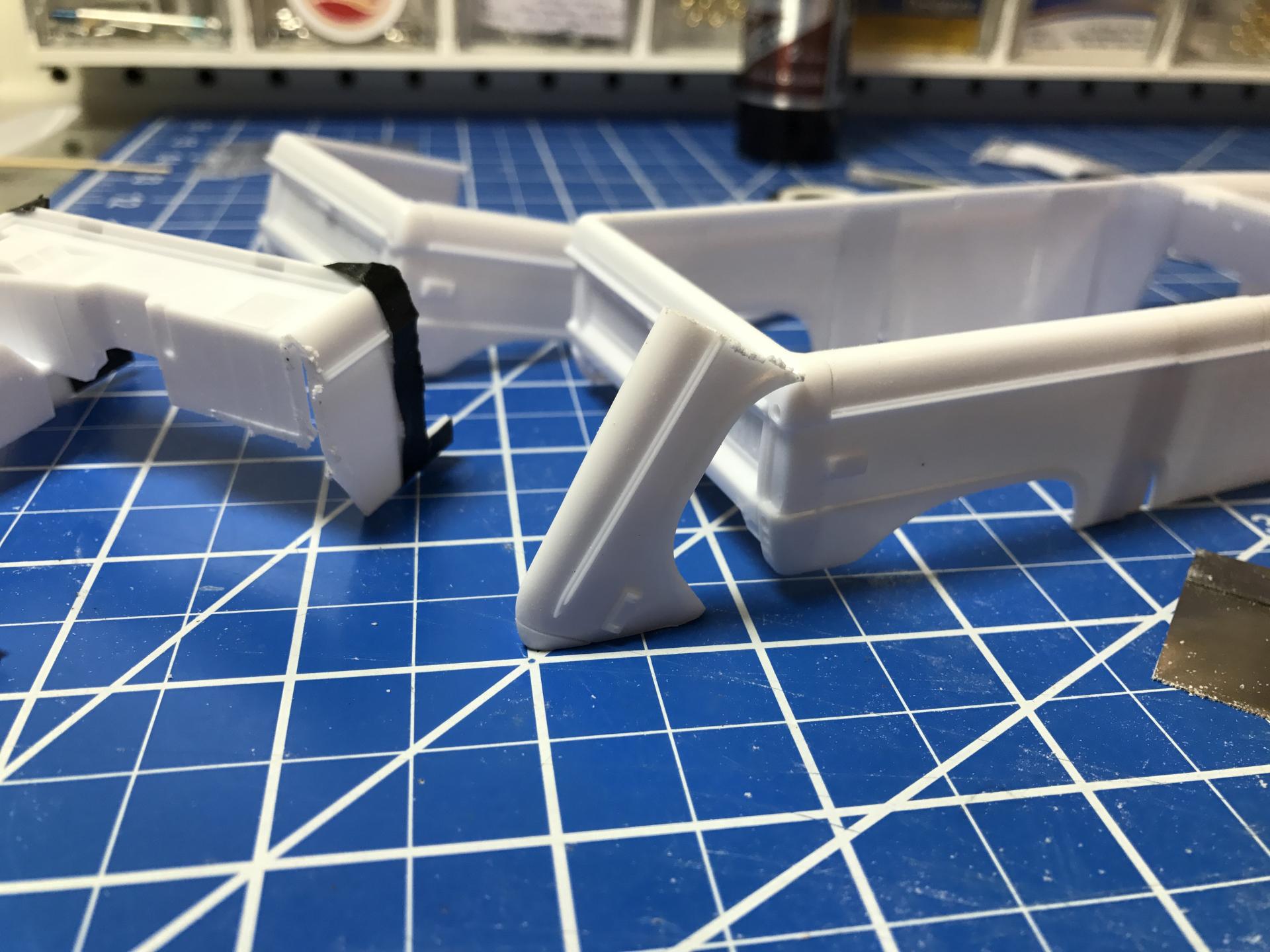

then i needed to tackle the angle back... so i used the front fenders from the scrap body.

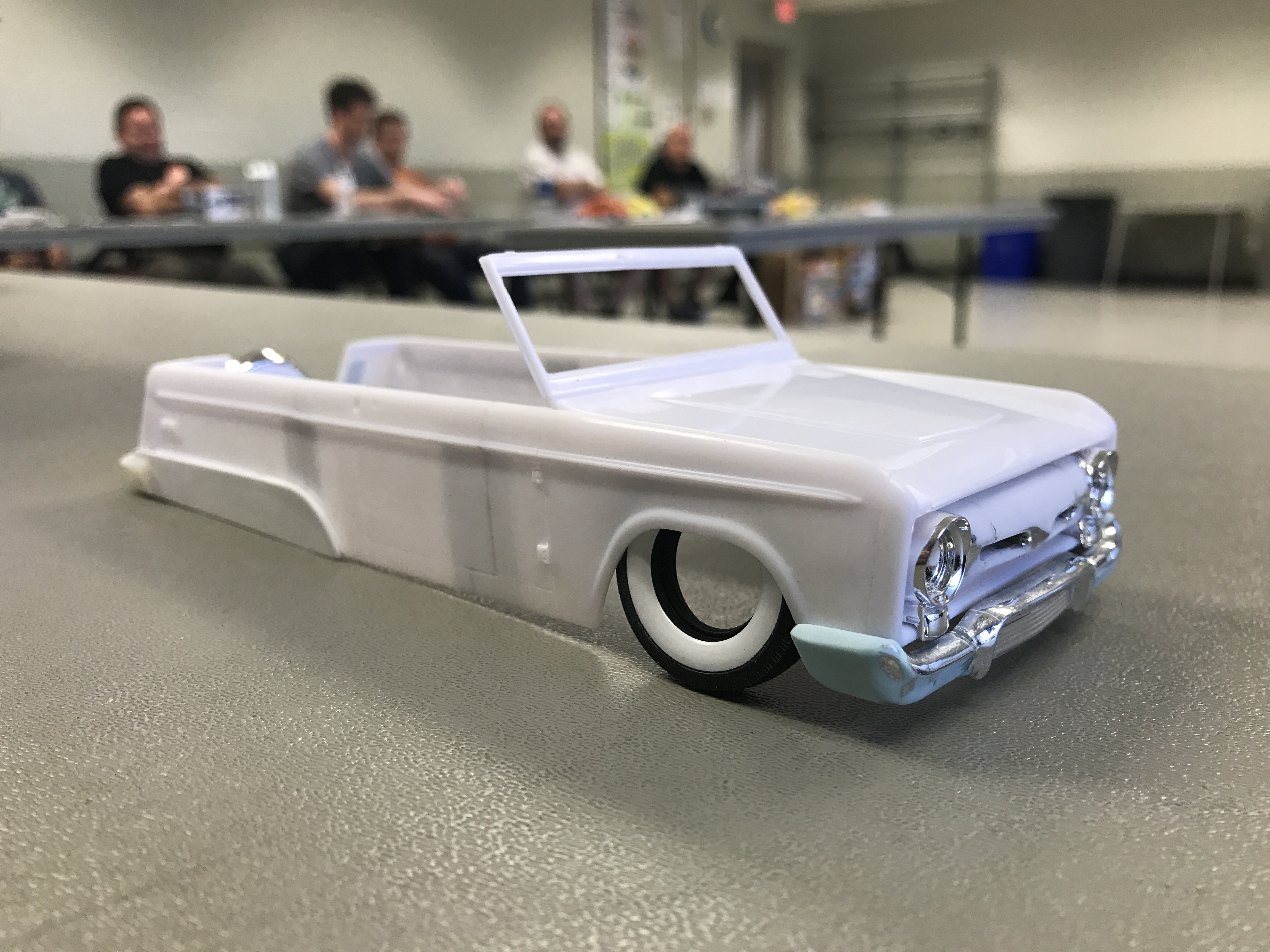

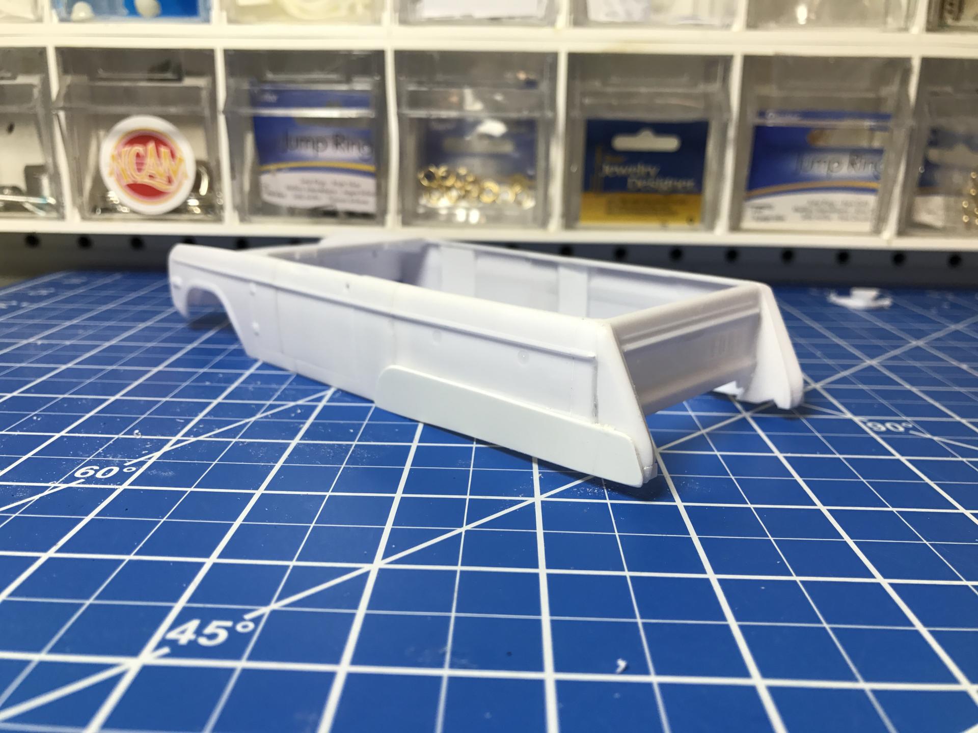

After some sanding and some fenderskirts this is how it looks now:

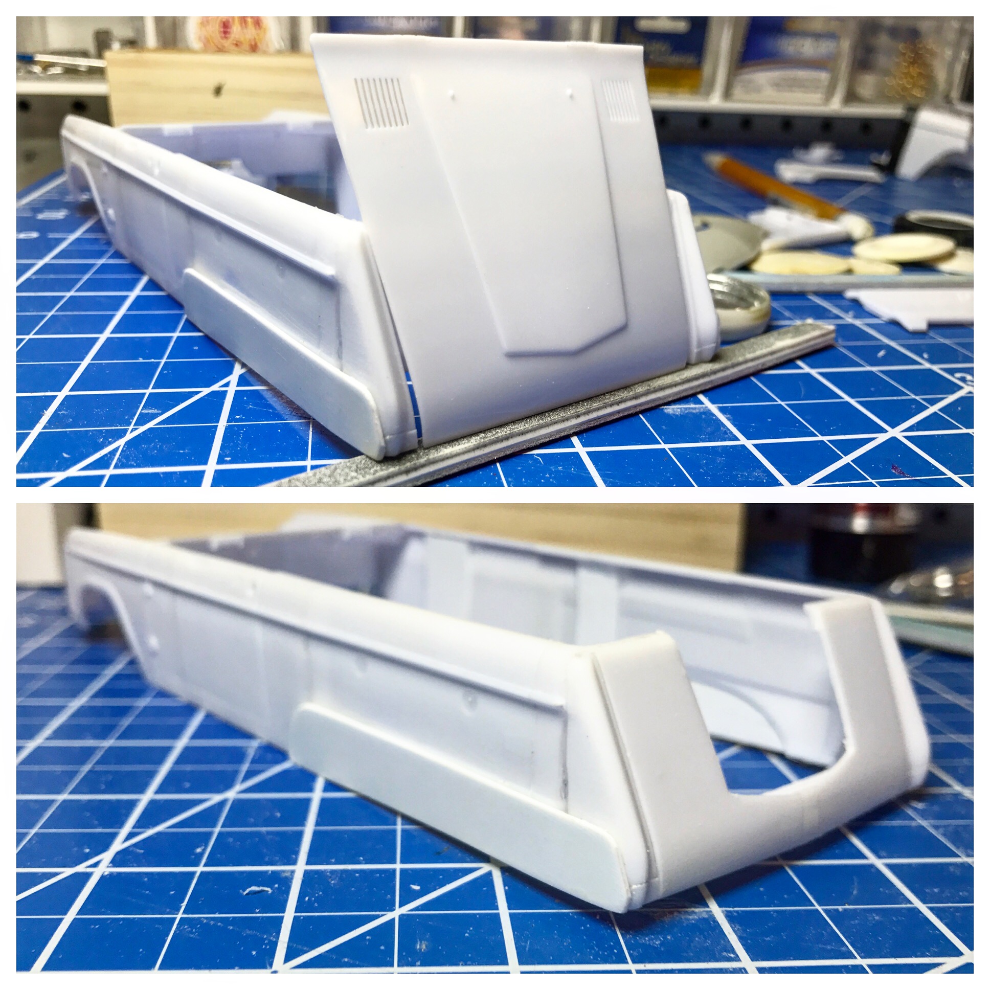

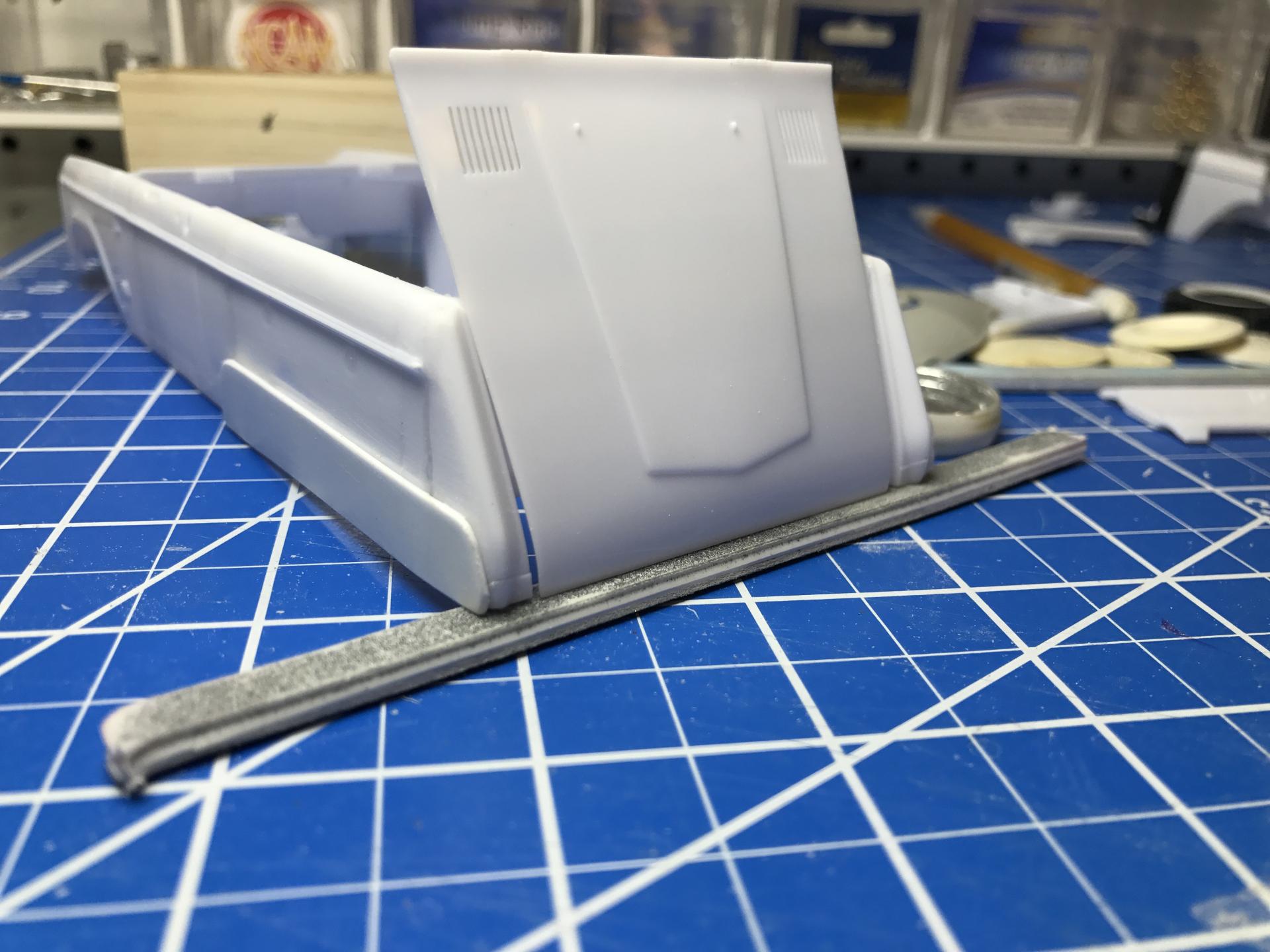

working on finishing off the slantback with the extra hood... hopefully that happens tonight.

I am going to use this idea of flipping the hood around to make a custom rear end

Pretty cool idea. The skirts don't look quite right to me but can't put my finger on why. I am probably alone on that . This will be very cool in any event.
Share this post
Link to post
First off, I like this project. Very original and cool. But, the skirts as the are, stick out like a sore thumb, in my opinion. The rear wheel well opening helps form a very clean body line. A shame to lose that. Maybe consider just a skirt that fits the wheel opening or something like the '58 Impala skirts. The piece of sheet stock doesn't really have much character, it's just flat. Maybe add a character line to with some half round stock? My $.02.

The hood for the tailgate is a very clever idea. I like the look of the angled rear end.
Thanks Rob!  I agree the skirts aren't 100% there yet.. Im still going to add some trim and some other detail to them.
My inspiration was from the old cruiser skirts which mostly share the same basic shape as the bronco rear wheel lip.  softening the edge a bit more, adding some trim and rock gaurds should make them look really close to these:  (its also getting a wrap around bumper and continental kit)
Here is a bit of progress from the weekend.. although not a ton... I did get the tailgate fitted and blended.   The center cutout will be for the bike to roll up, the continental kit will fold down to make the bike ramp and fill that area up visually.

I think the skirts could maybe use a larger radius on their top edge, or perhaps more pronounced roll-under like the original rocker panels.

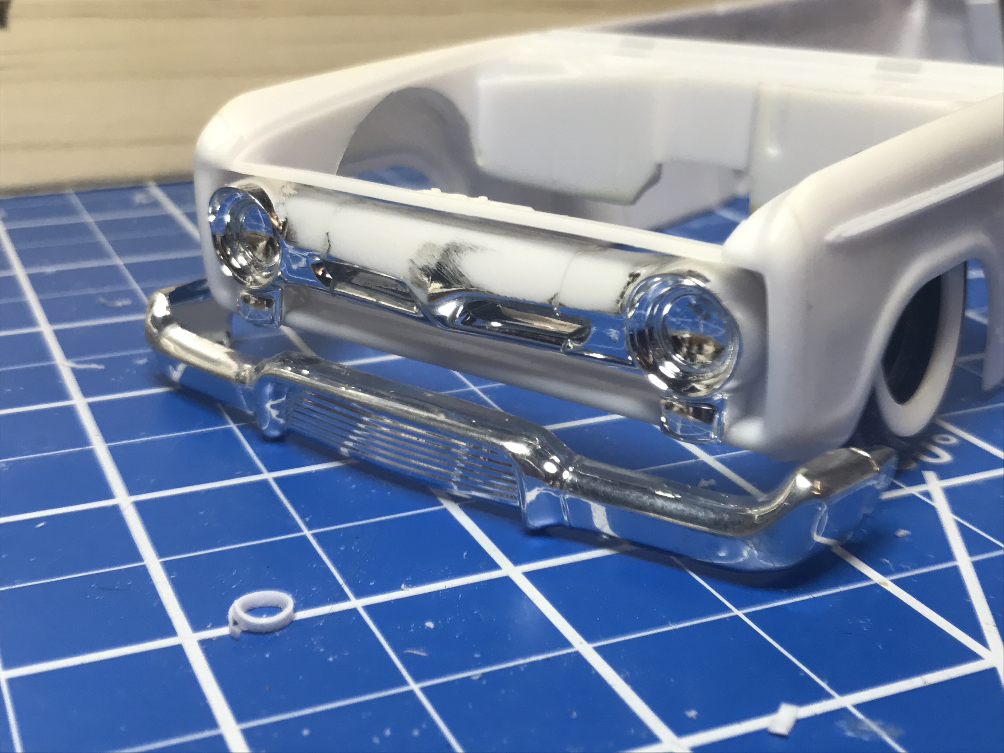

I think im going to use this old amt 1958 impala front bumper.. it seems to have just the right amount of character and wrap around. just needs some reshaping and to be a bit narrower.

I like that '58 Impala bumper for those same reasons - stylish wraparound and you can narrow them at the 1:1 factory seams. Thumbs up.

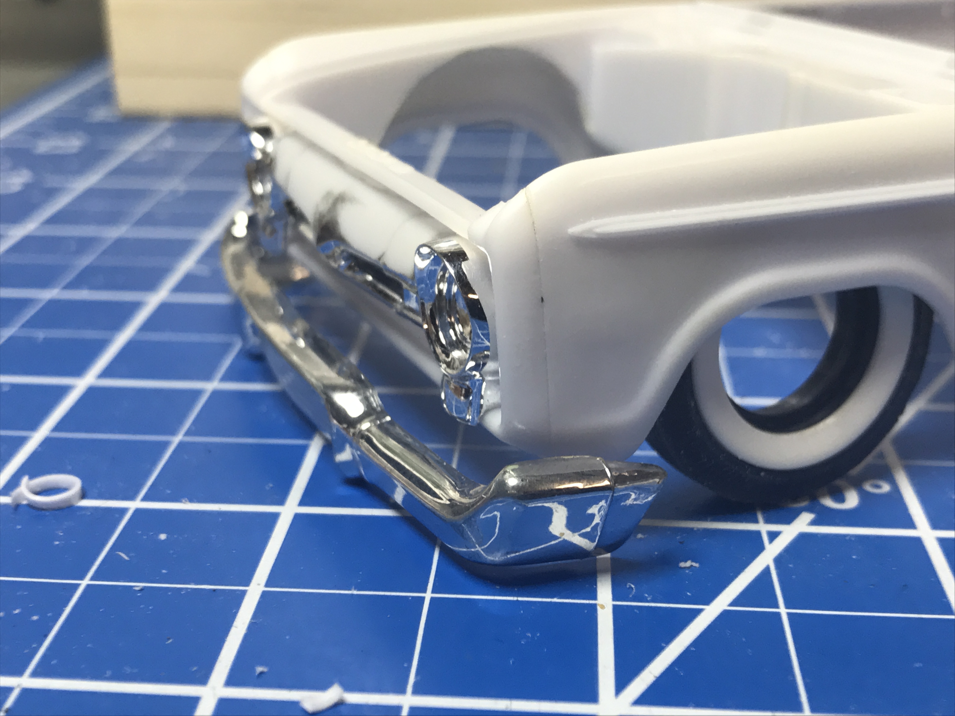

Messed around with the bumpers a bit more last night... the front is pretty much there, the rear needs some more massaging but seems close.    Probably going to work on the windshield frame angle and chop next. (its just sitting there in these pics)
