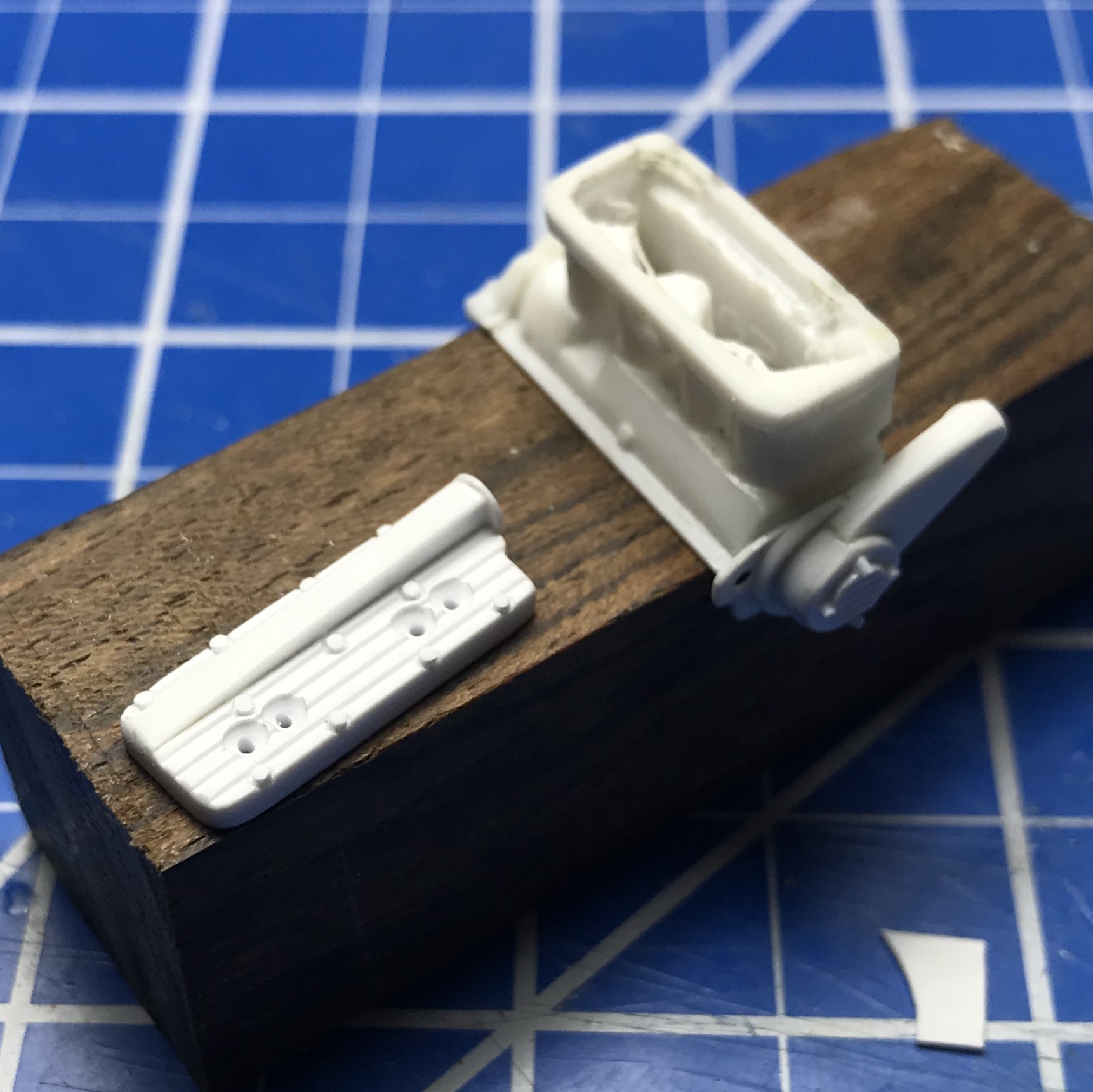

Question on head and oil pan. Are they layered styrene?  How did you get the fins on the head to line up?
Share this post
Link to post

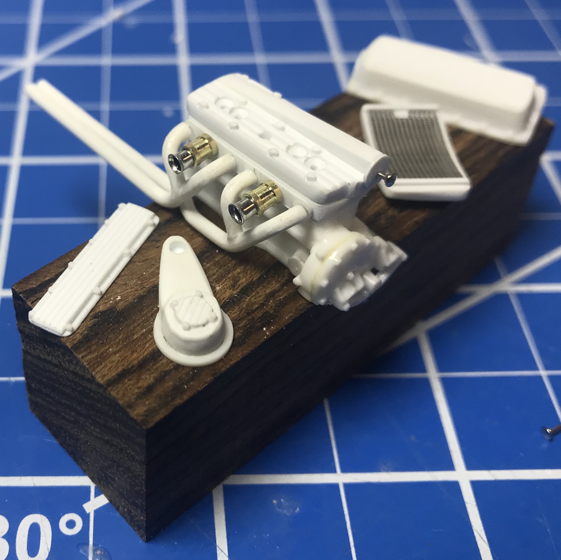

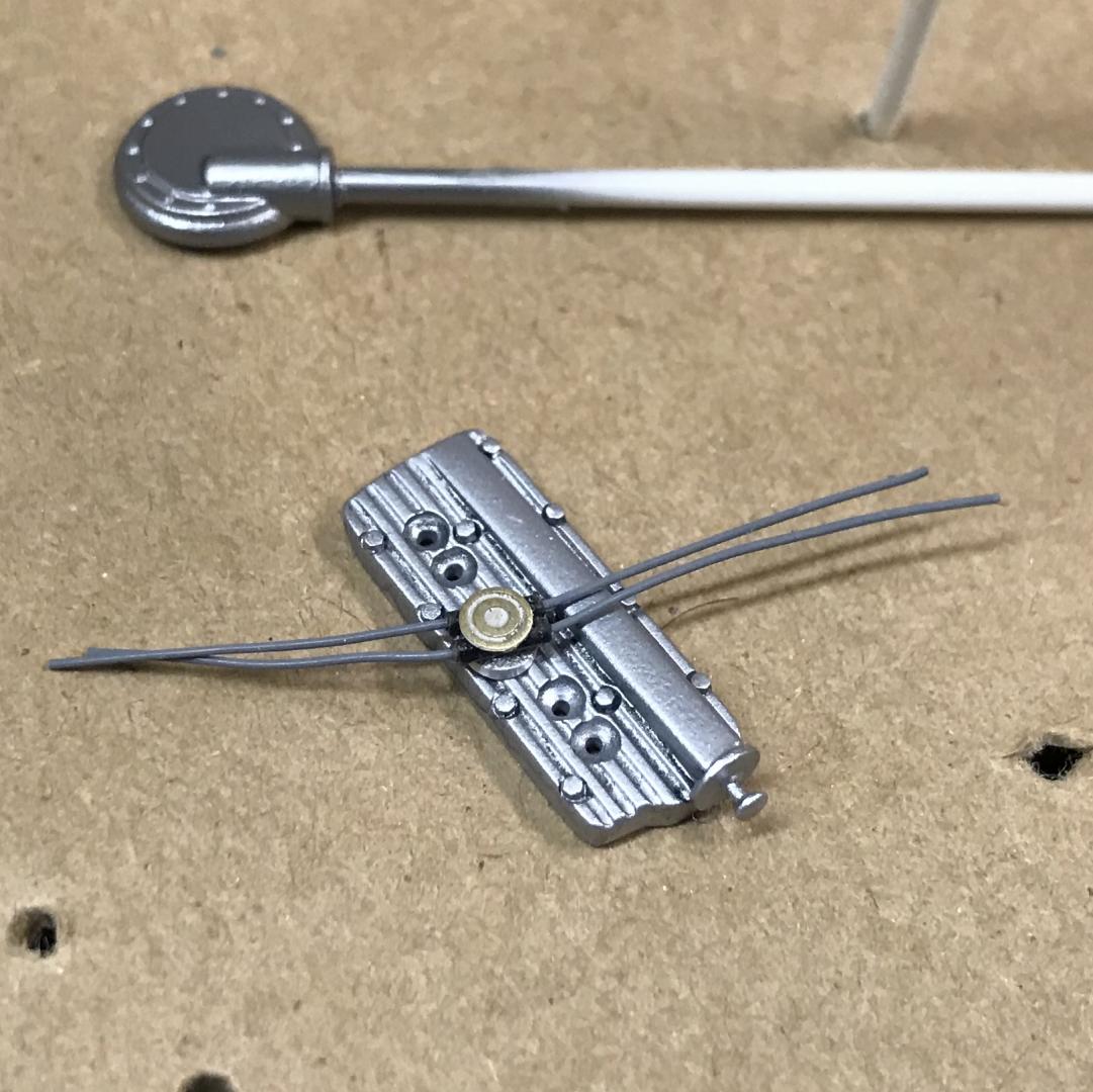

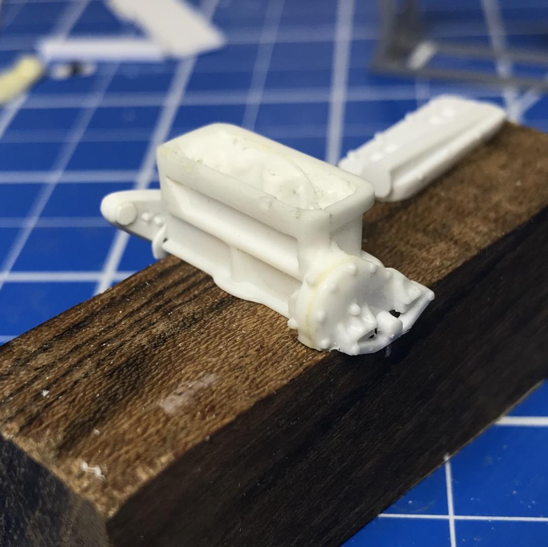

its actually just the ribbed and V-grooved evergreen styrene... I got really lucky with the material I used on the head, the fins fell in the perfect spots like the 1:1 finned head.  I detailed it with .30 hexagon rod cut into bolt heads,  after the glue drys I go back and sand the bolt heads flat. It really cleans it up nice, and it looks like a kit part in bare styrene.
Here is a better photo of the cleaned up head:

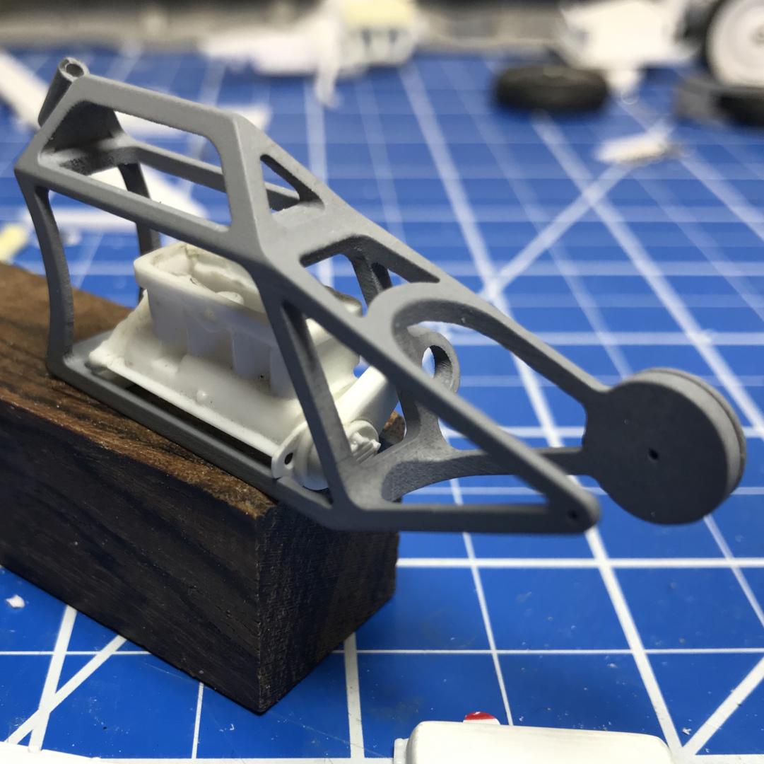

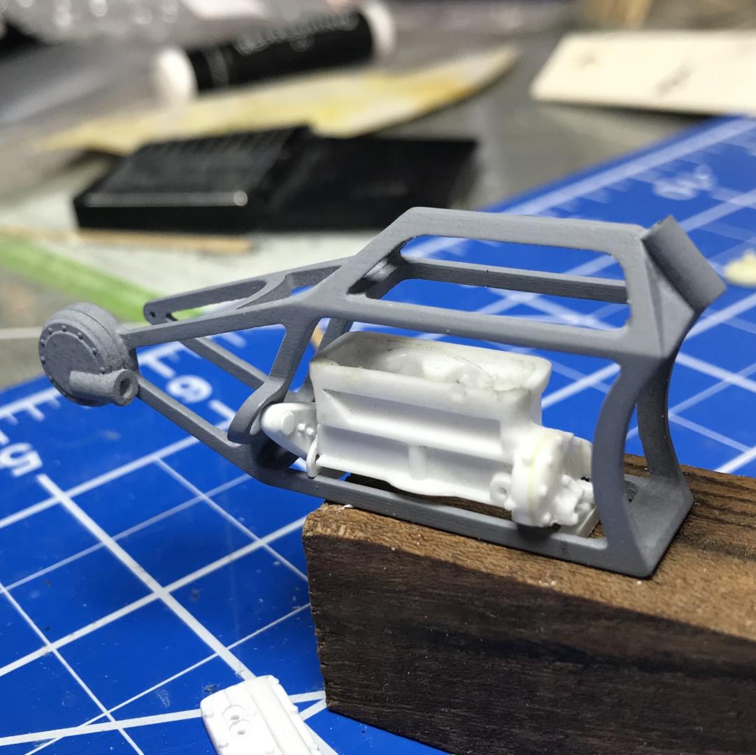

And a little bit of progress last night.... scratch built a transmission/drive... it would have to have a pretty small flywheel, but it looks the part.... nothing like scratch building in a bottle. haha
IMG_E0637.thumb.JPG.097413f6e722783ec3c56bba3098f359.JPGIMG_E0638.thumb.JPG.142df10bd9123b555a442f6f116b38ca.JPGIMG_E0635.thumb.JPG.bdf6797db84466ae06948ca02f97463b.JPGIMG_E0636.thumb.JPG.2f170b1ae54c74f76b4d20a52bf536e1.JPG

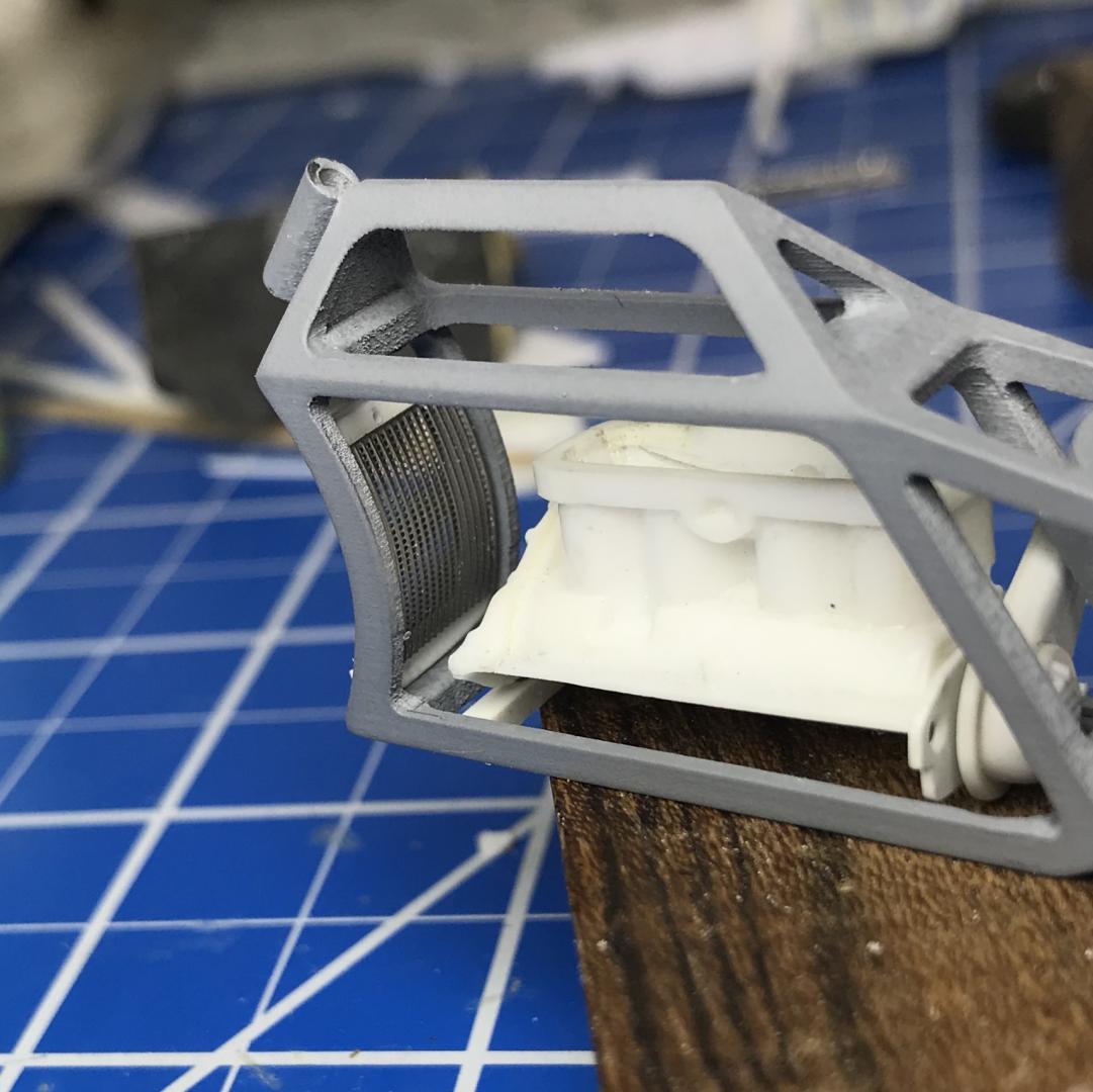

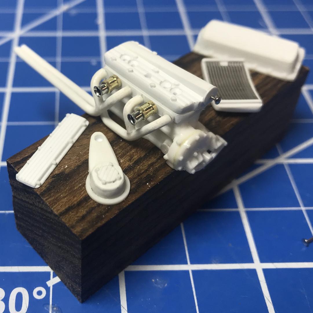

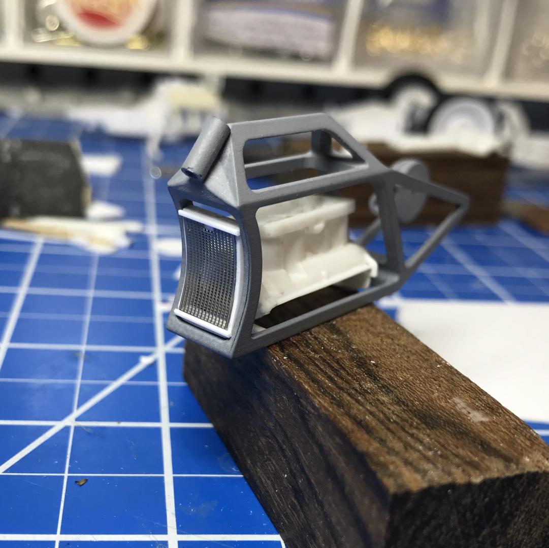

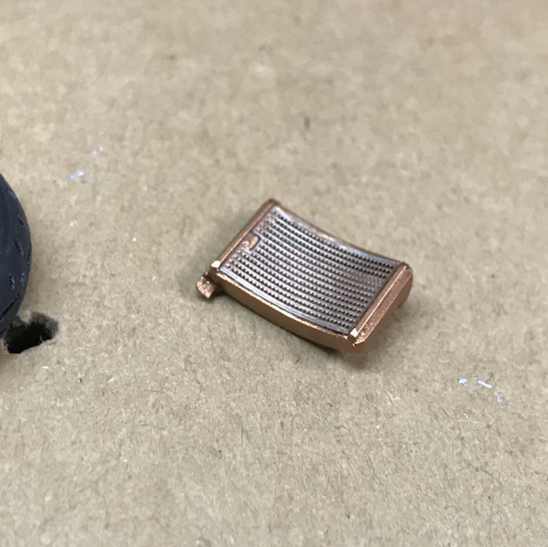

Here is a quick update....  just made a curved radiator, Ive always wanted to make one that you can see-through.... this seemed like a good chance to do that.   I scratch built a surround then added photo-etch screens from a crazy modeler Ferrari FXX detail set.  It really worked out nice
IMG_E0671.thumb.JPG.bc9b1aaf2b593f151a9c282444702f33.JPGIMG_E0673.thumb.JPG.a47931ff23b3a471cef0759707b62ef5.JPG

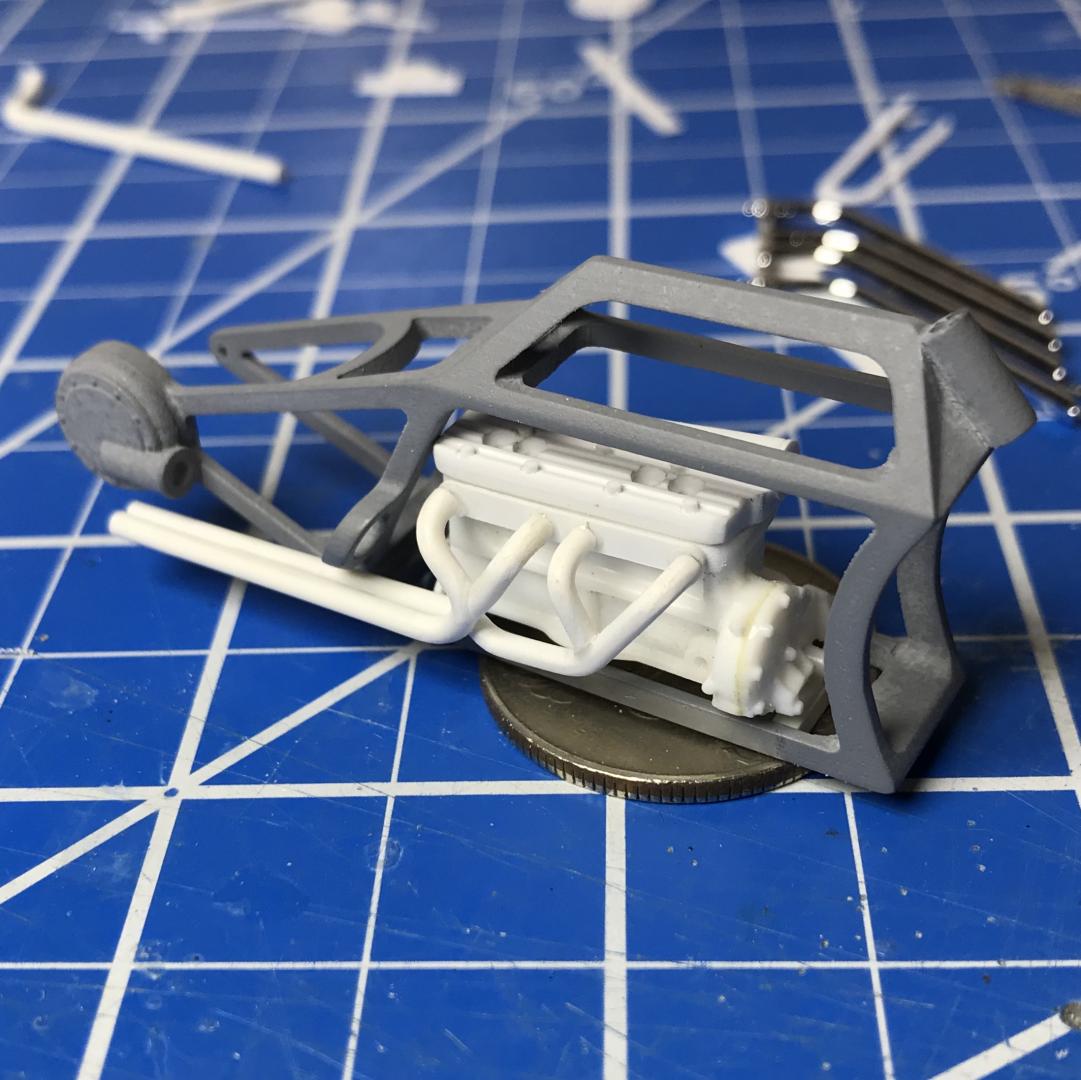

Got the exhaust all bent up last night!   Still need to figure out the tail section, but ill figure something out... maybe some oval tubing... Next up is the injection... have i mentioned this thing is tiny... :blink:

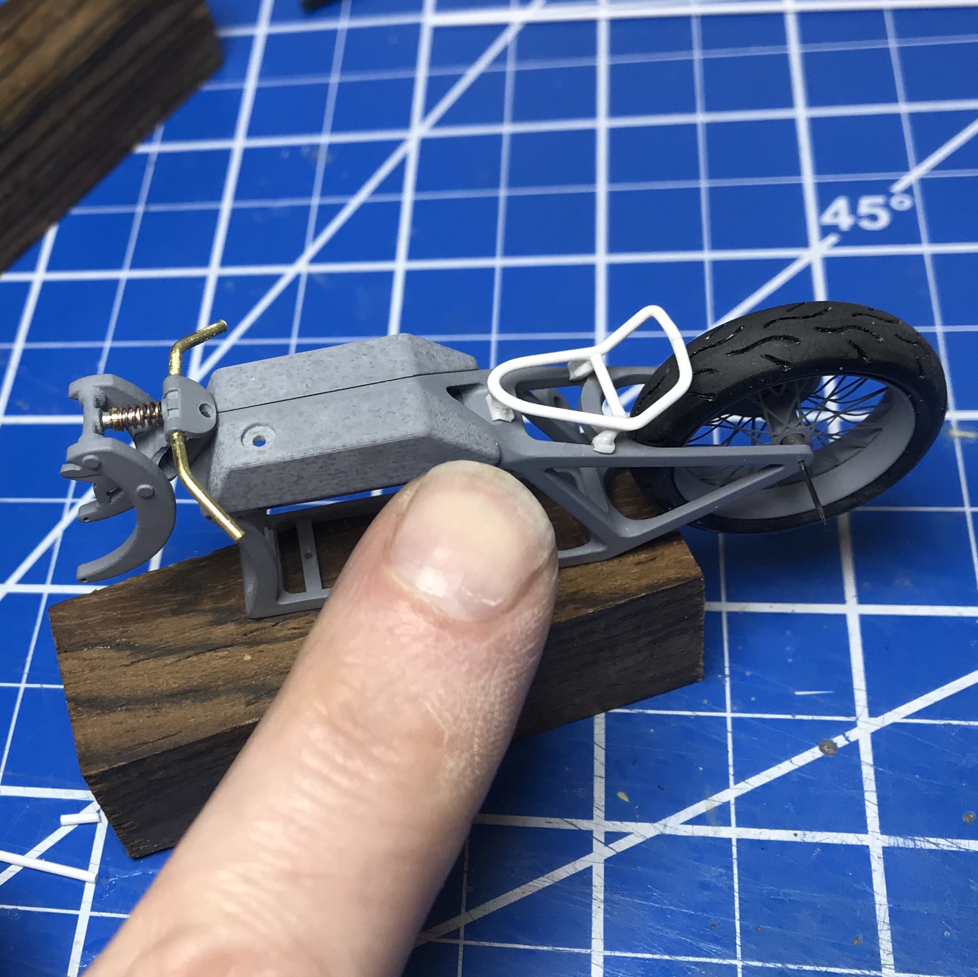

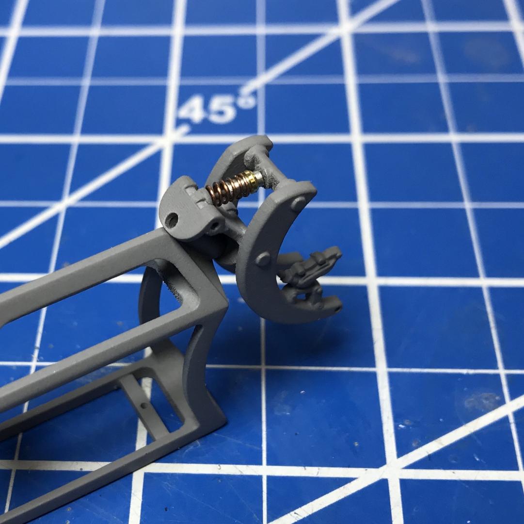

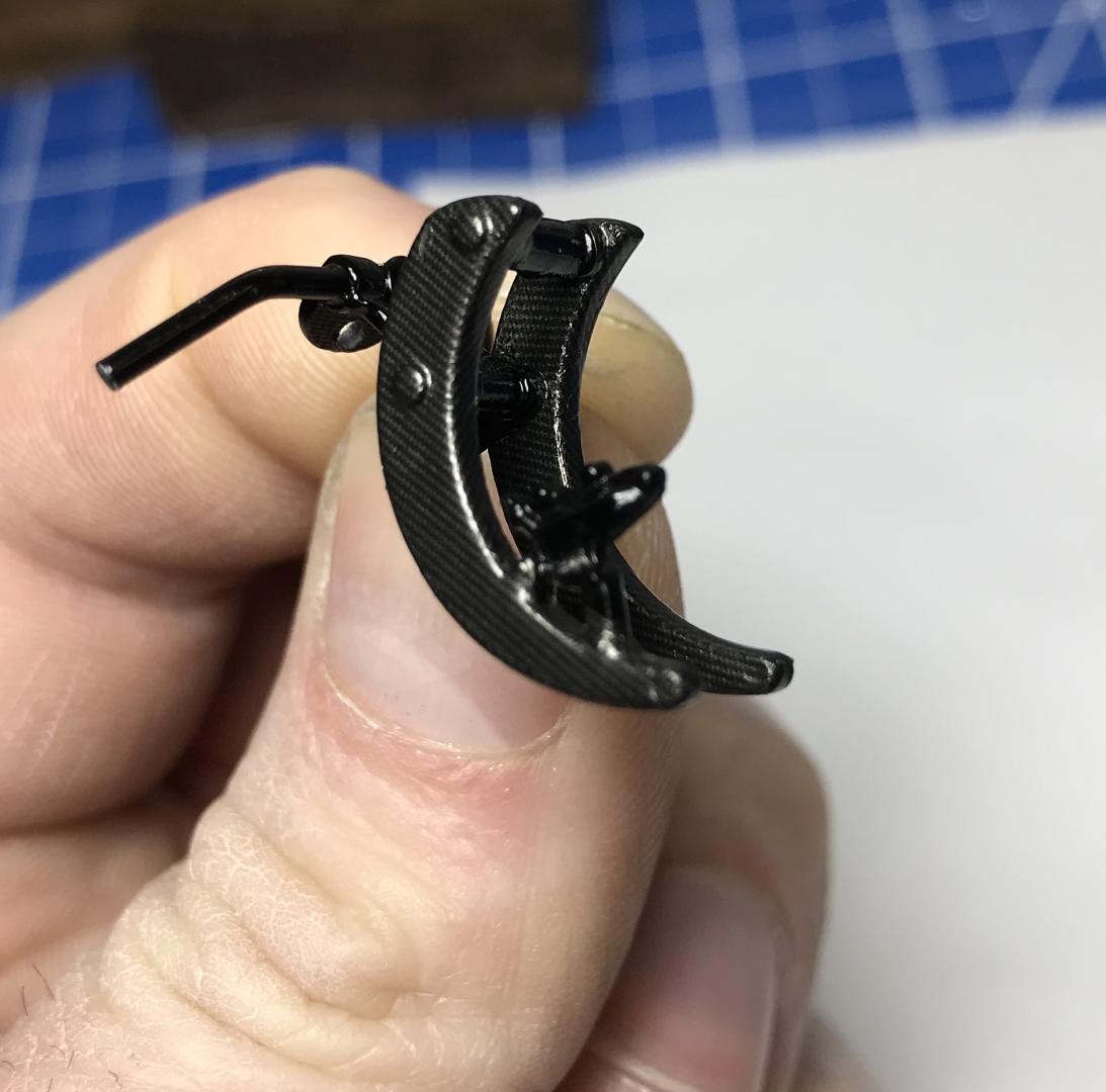

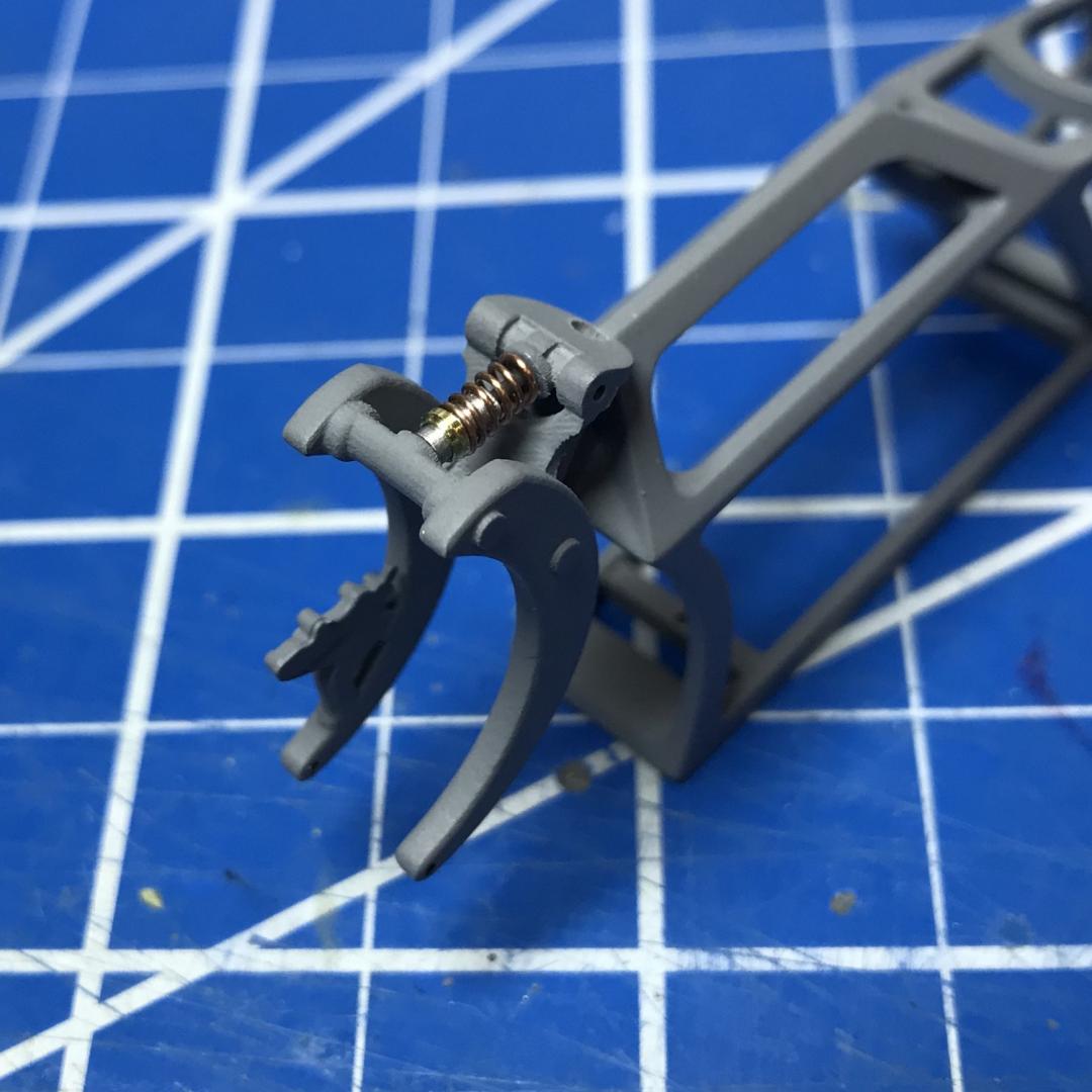

Thanks guys!    Still fab'ing away at this bike....   almost time to start painting...  Basically just the seat insert to fabricate.
IMG_E0737.thumb.JPG.680e10918791a98f1494831507e107fd.JPGIMG_E0736.thumb.JPG.bae22e36b27611f772d0bf533c1c933b.JPGIMG_E0741.thumb.JPG.cbbba8ecc0fc1155bf7f998dce65b312.JPGIMG_E0742.thumb.JPG.0ea5d190d1dca5949fbaa43a70f9383b.JPG

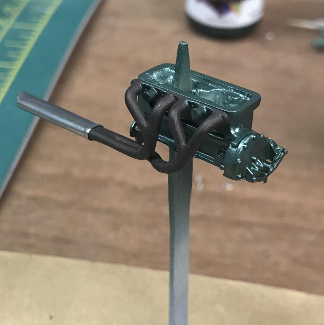

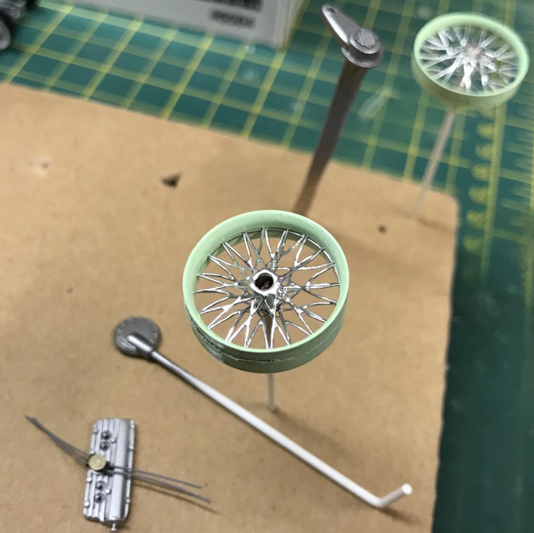

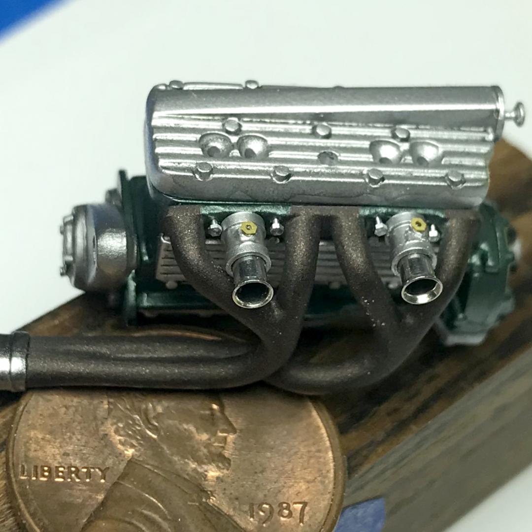

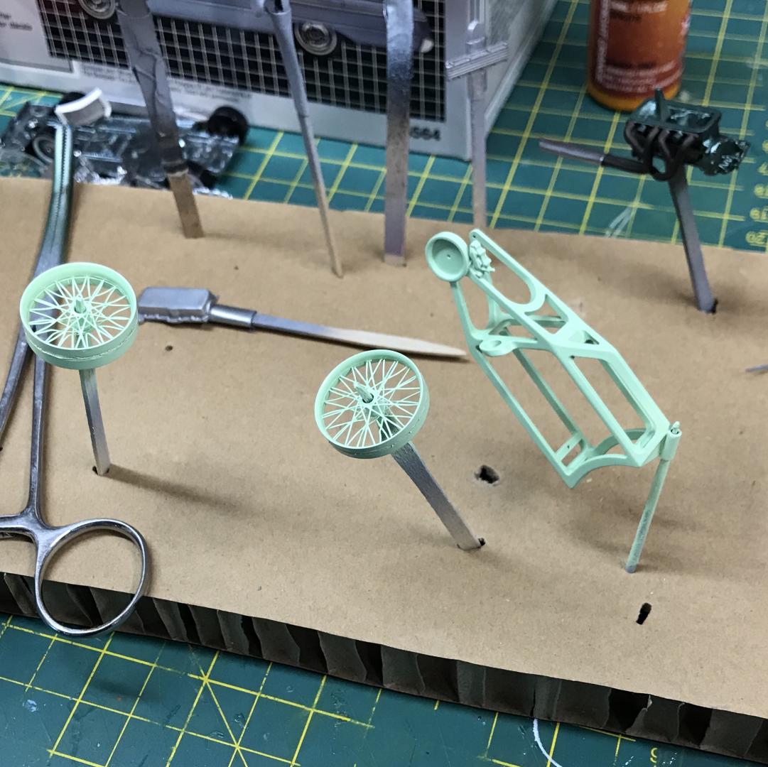

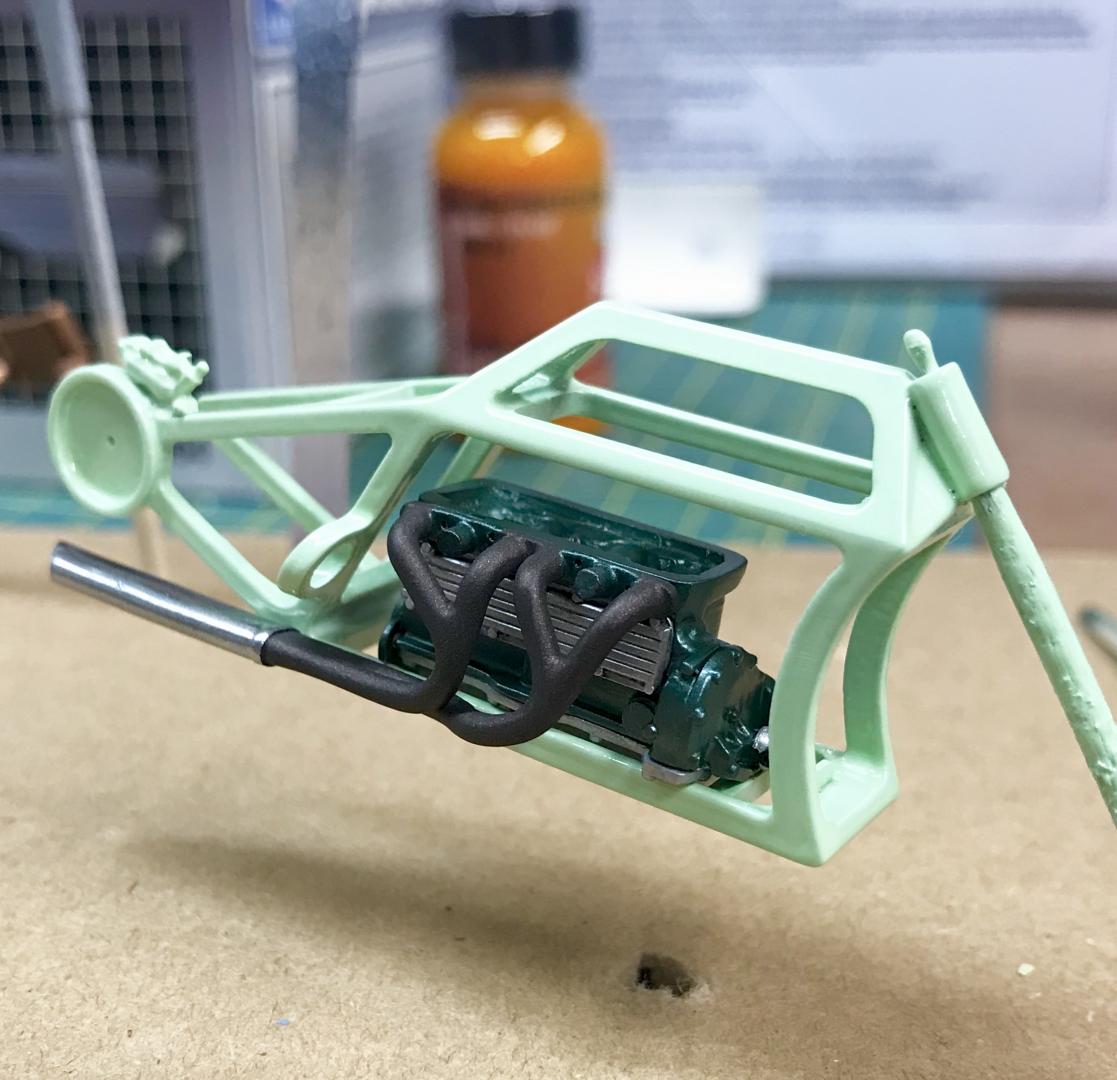

Started spraying a little paint last night.... I really like the engine block color , it is Splash Paints Aston Martin Almond Green just feels like a modern take on the original ford green.   The header is Alclad exhaust mainifold and Alclad chrome.
Im really getting excited to see this little guy come together.

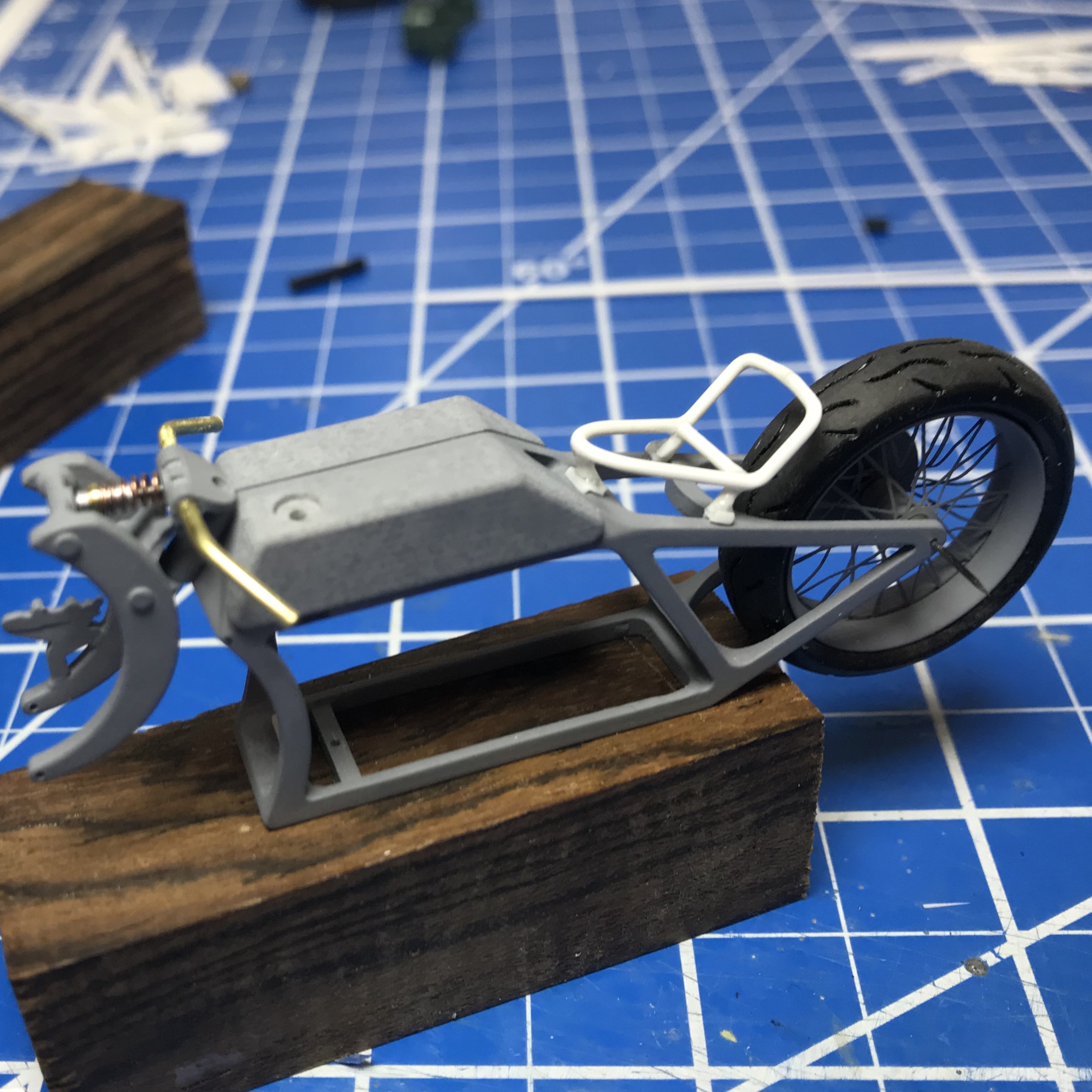

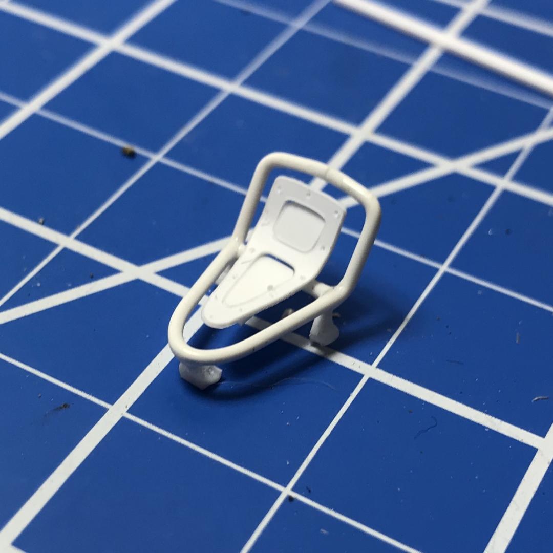

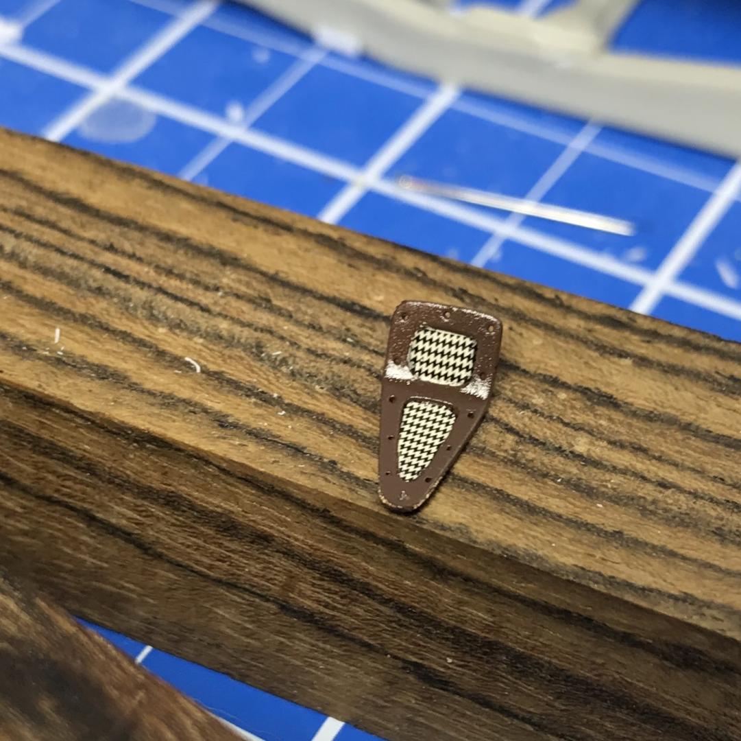

More Progress....   new seat insert is made!  I feel like i've done this before.. haha.. at least its only one this time.   Incase anyone is wondering the white grid is 1/2", and this thing is so tiny. IMG_E0753.thumb.JPG.5e3451400c9498c2a05cb6cd11901c94.JPG
and a little mockup to see the colors better...  hopefully I can wrap this guy up in the next week or so and get back on the bronco.

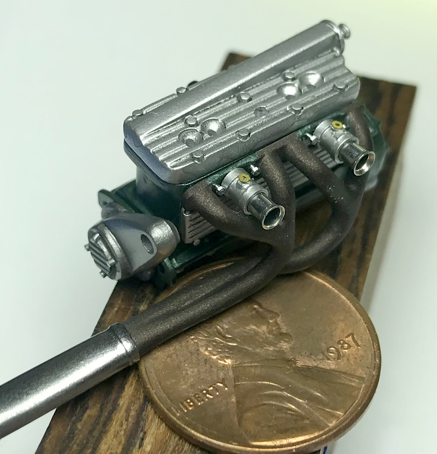

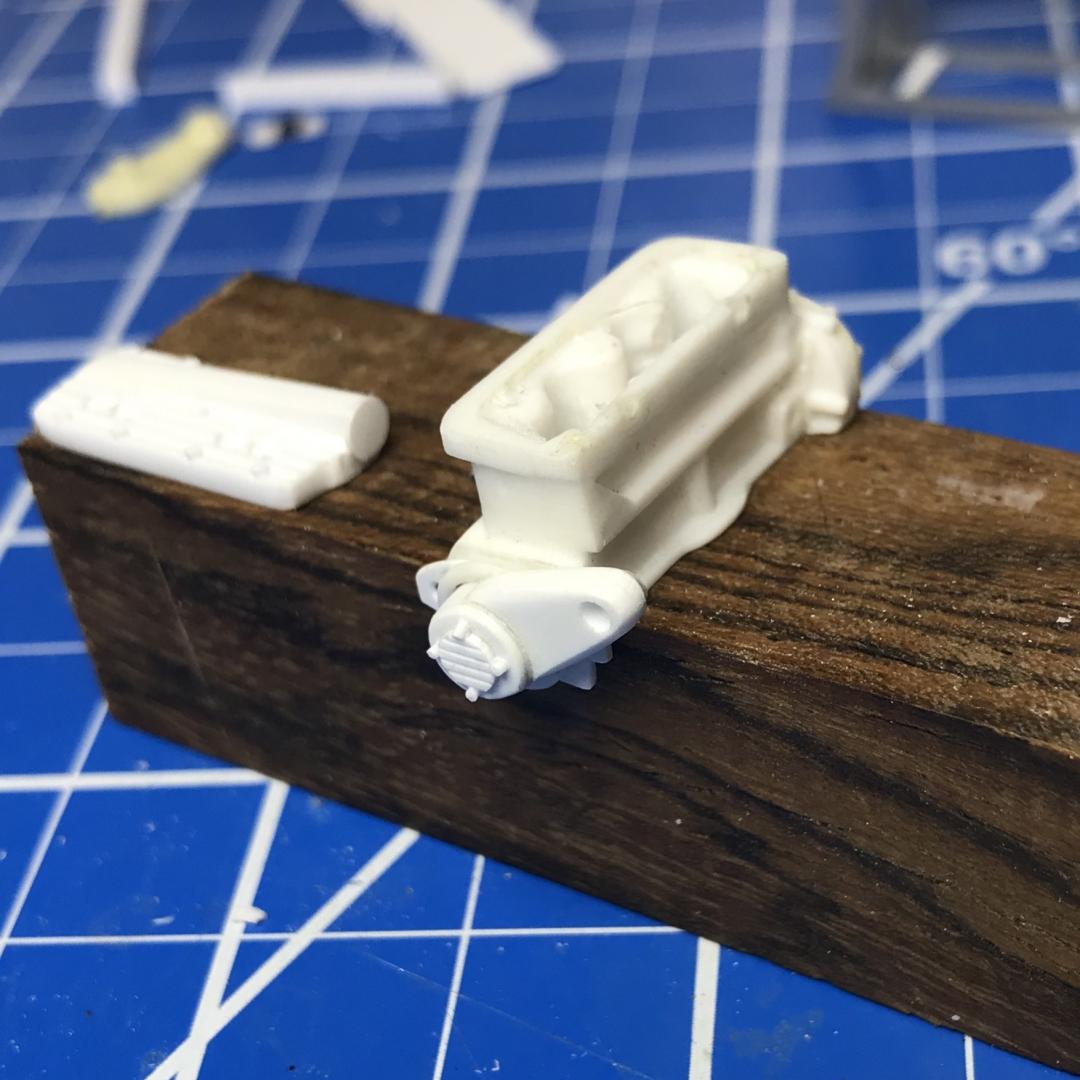

Thanks guys!  im still plugging away on this little guy.... Hoping to have it done as a stand alone item for the Columbus show in a couple weeks... then back onto the bronco hauler.
Here are some progress shots:
IMG_E0773.thumb.JPG.2dad908adb8a733c816271ff789f5575.JPGIMG_E0775.thumb.JPG.835f887e9cca77c00793943314fdb31b.JPGIMG_E0774.thumb.JPG.90794b242d343db570e6b665aad4a7e8.JPGIMG_E0776.thumb.JPG.502ff18350c3e62ef00aa86493932422.JPG
And starting the engine assembly... those RBmotion manifold bolts were fun...
IMG_E0793.thumb.JPG.8cf8517c5c299c183d7811ea877ae72e.JPGIMG_E0794.thumb.JPG.2aa6c76adb8619a7e0d4df84430cb364.JPG

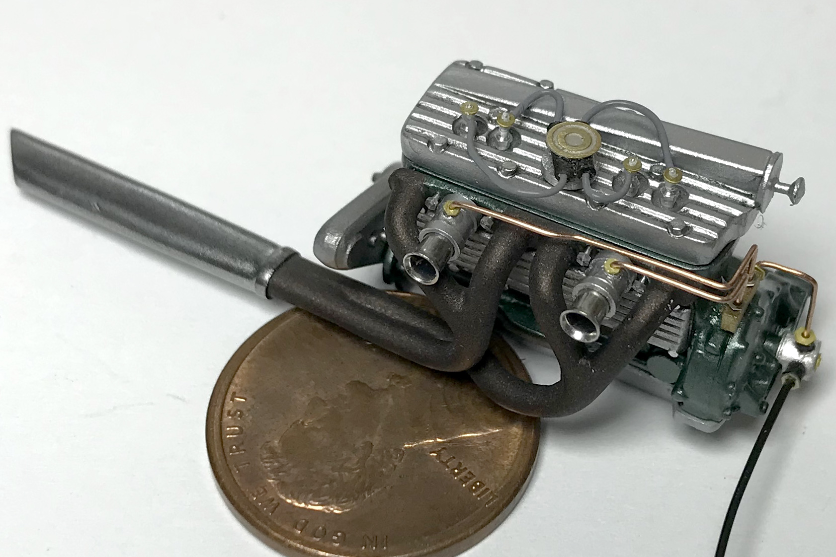

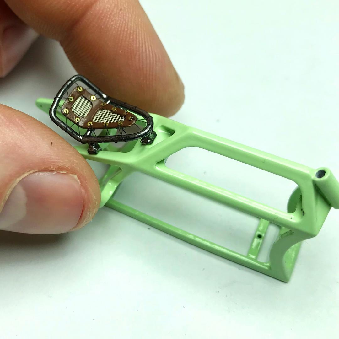

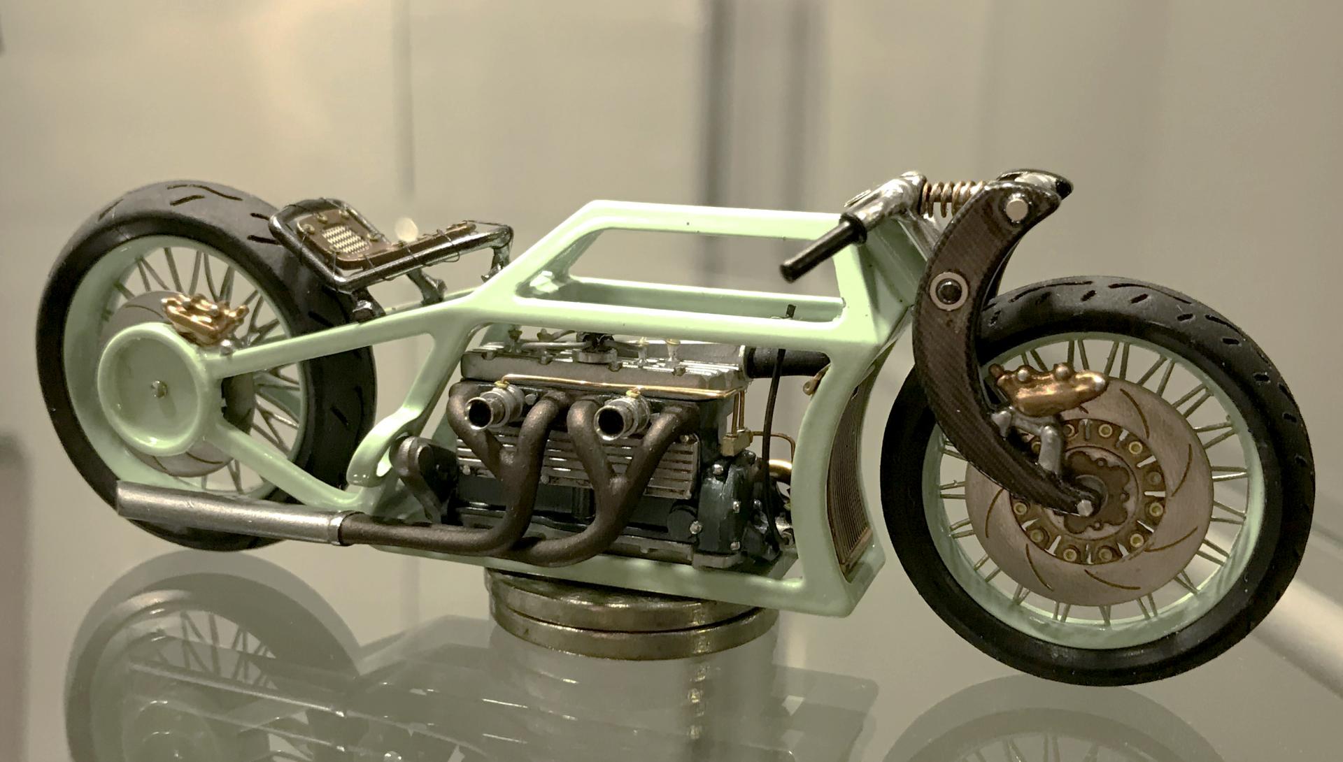

Thank you guys!!   im almost done with this bike!
Here are a couple photos of in progress...   the seat lacing was especially tricky on this one... everything is just so tiny.
and all wired and plumbed..
and where it sits now....   just need the tanks and driveshaft and this puppy is done!  IMG_0834-retouch.thumb.jpg.4ea118d22a2b6acae6695e87269e7b1f.jpg
