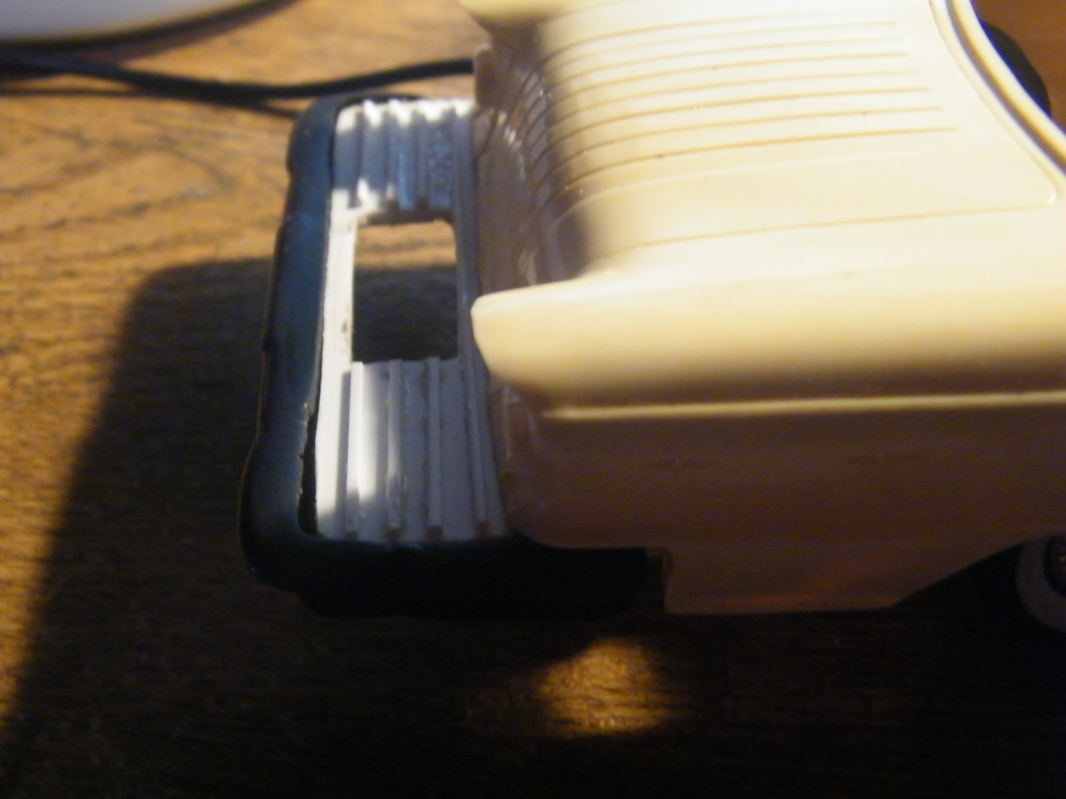

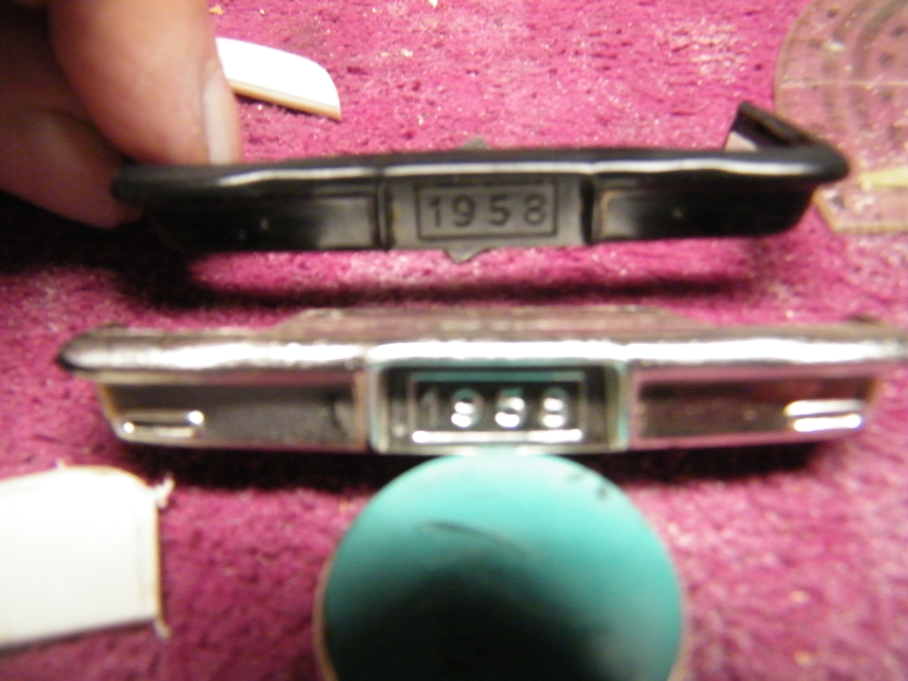

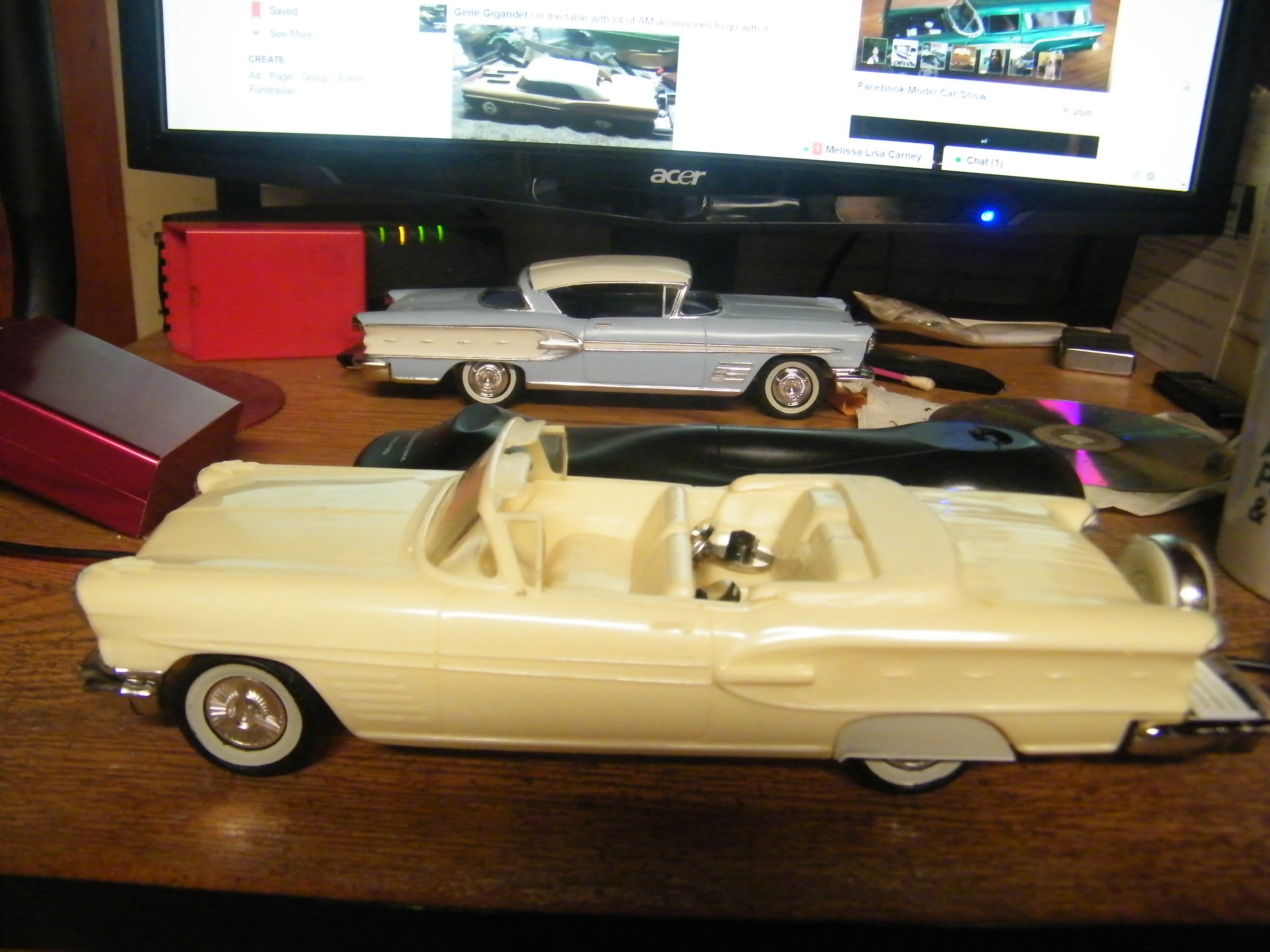

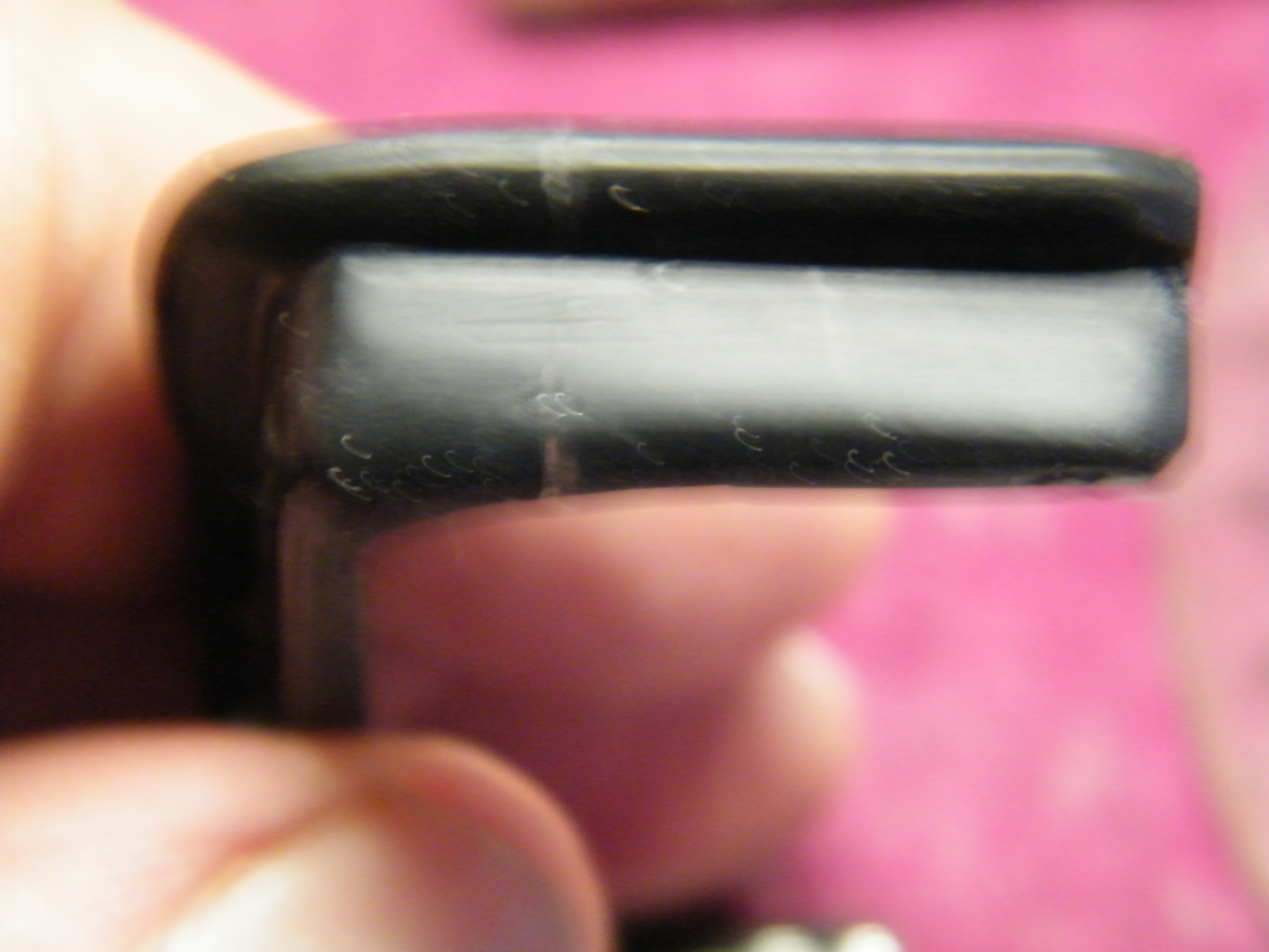

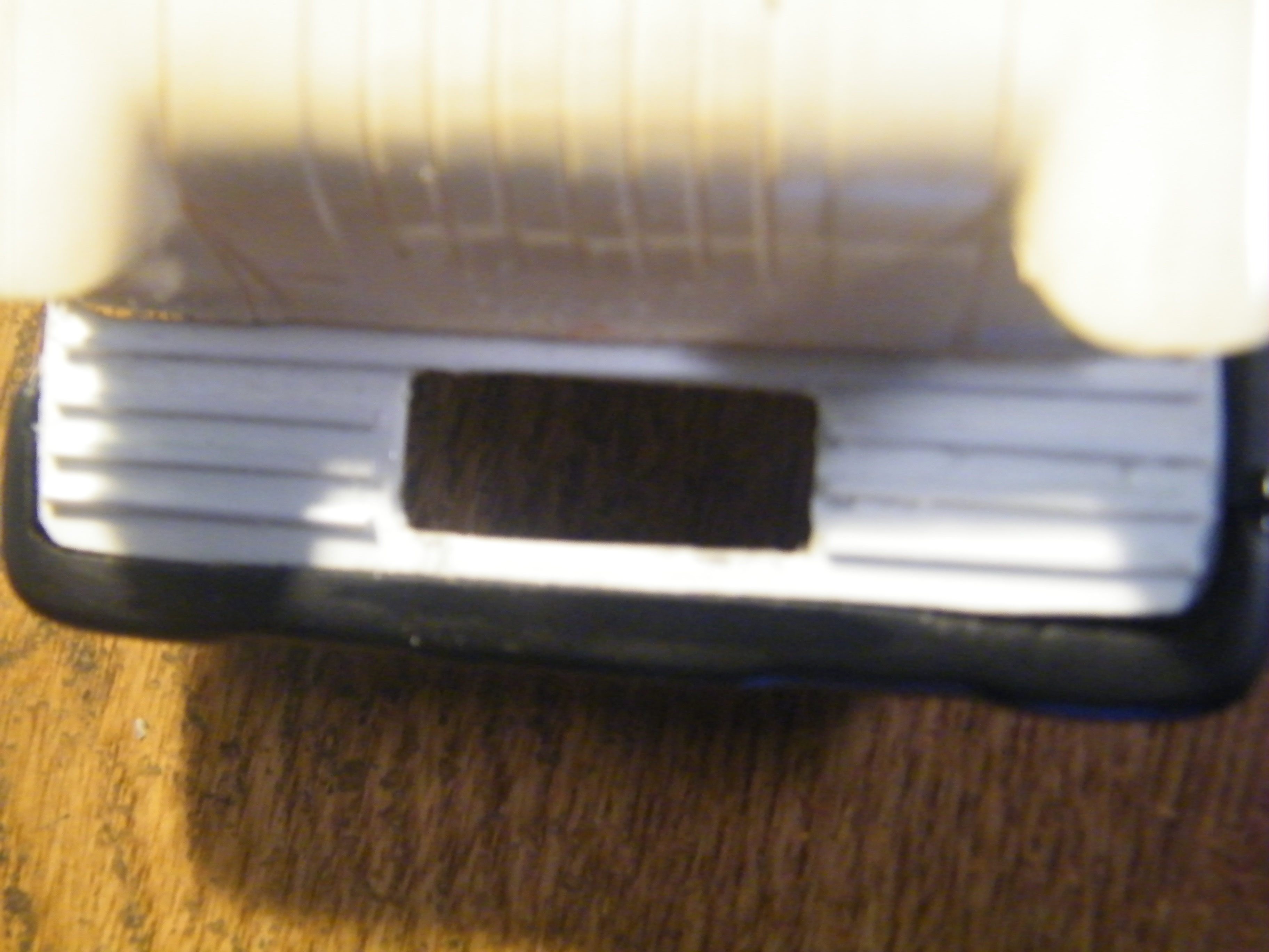

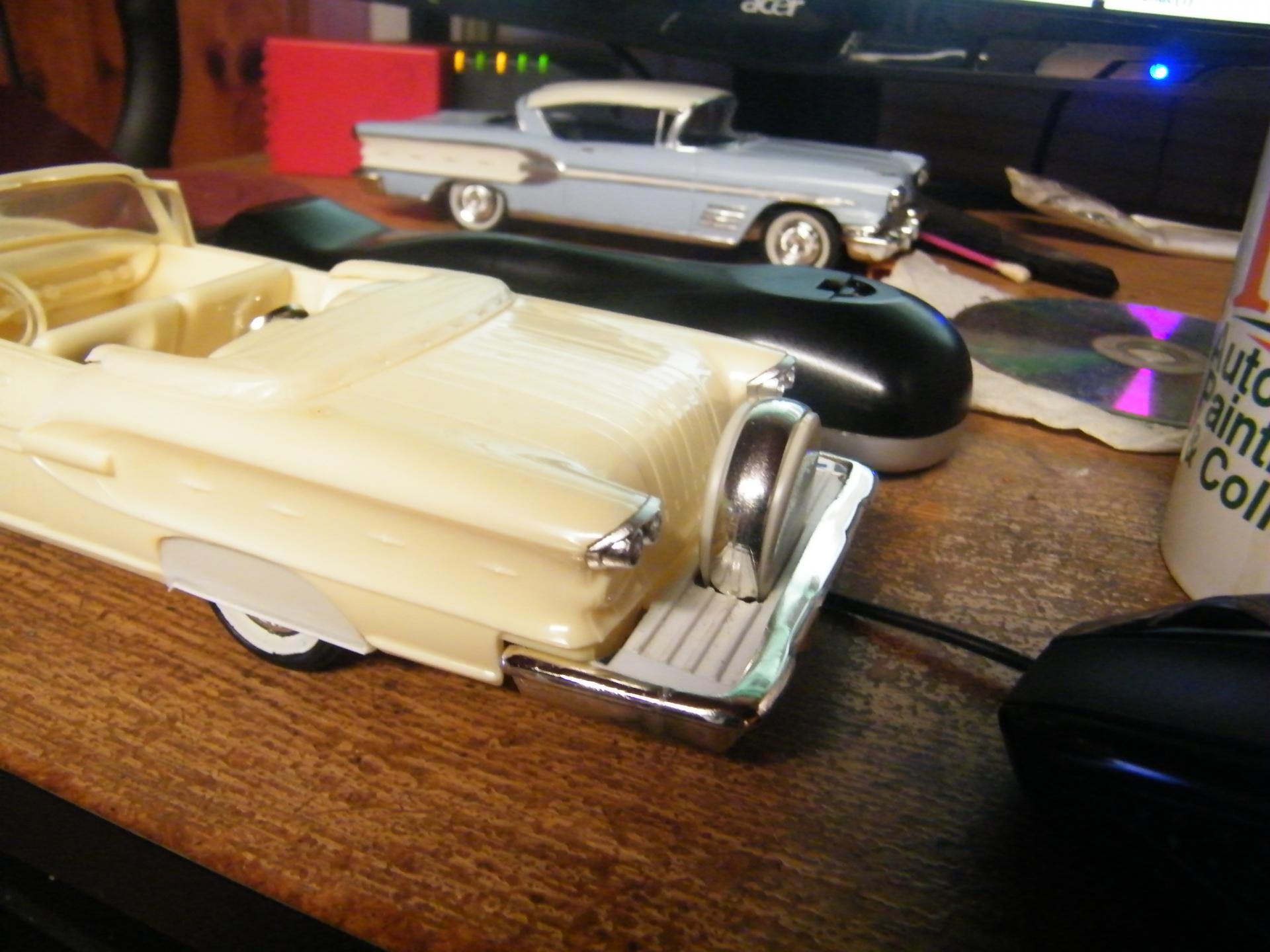

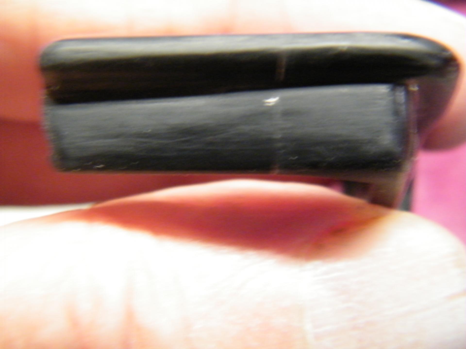

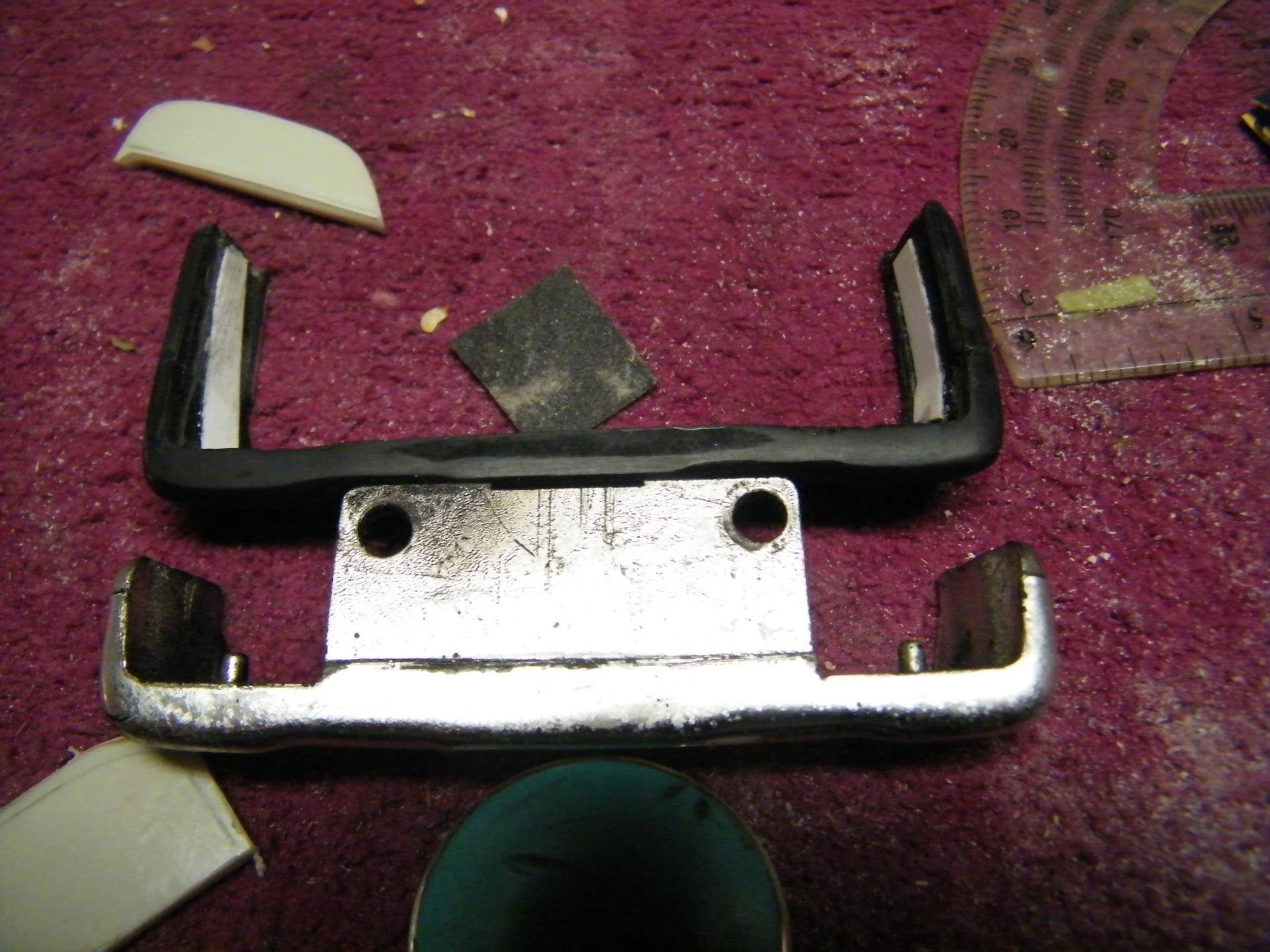

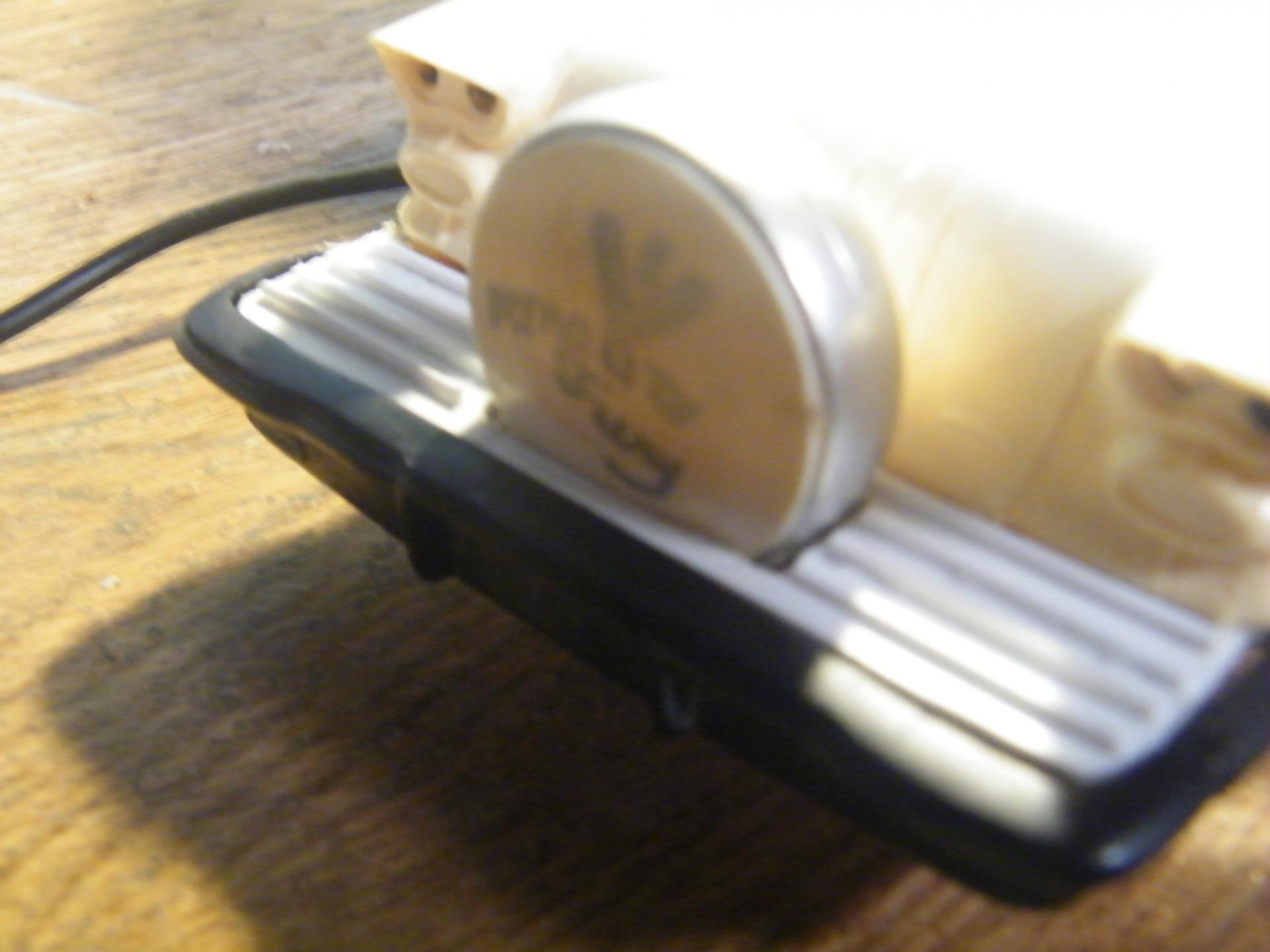

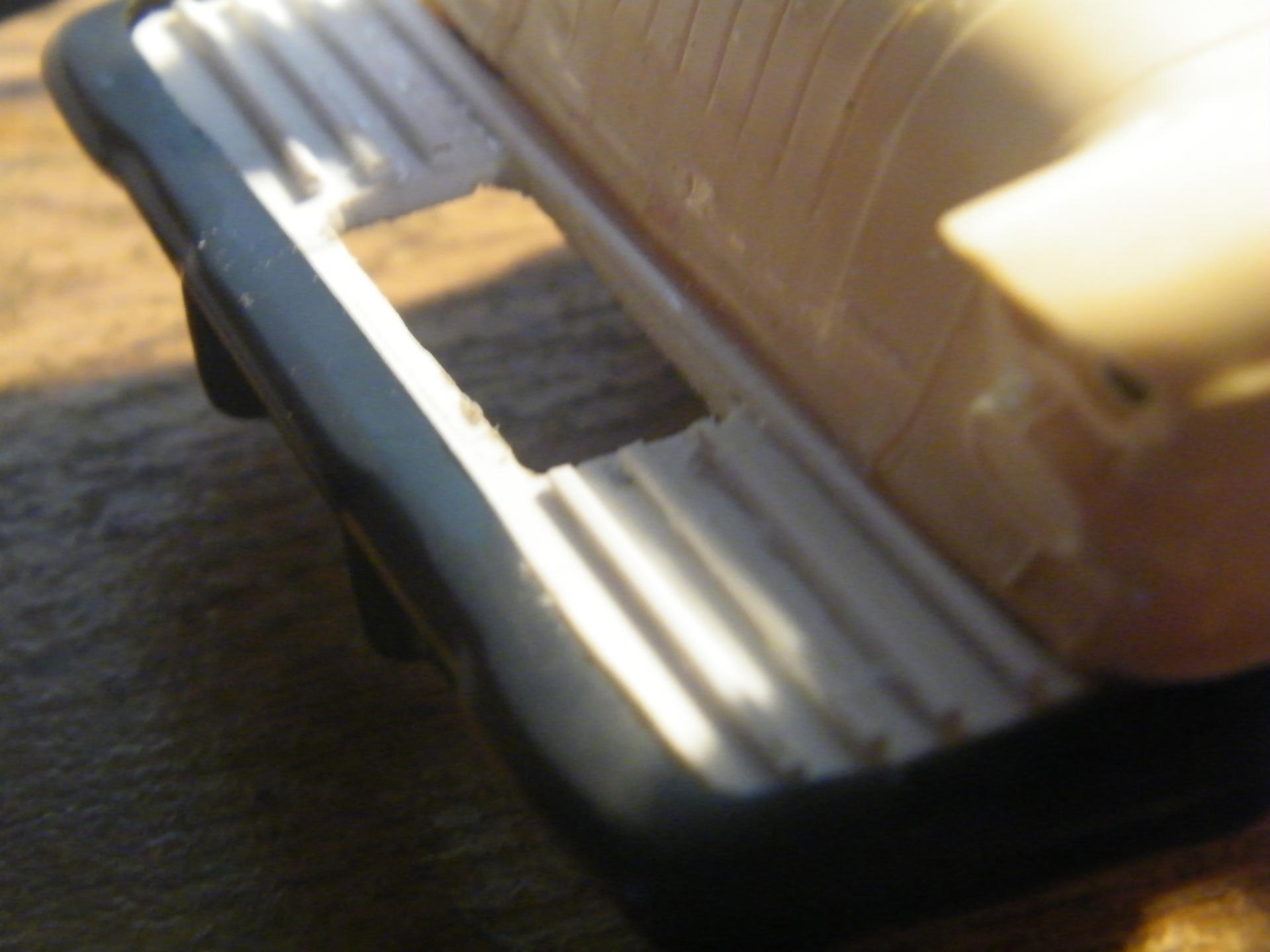

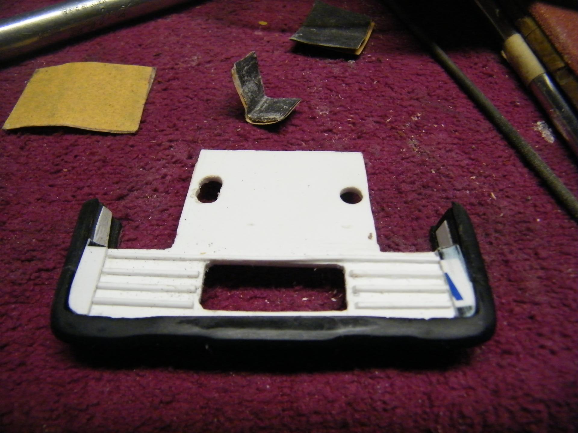

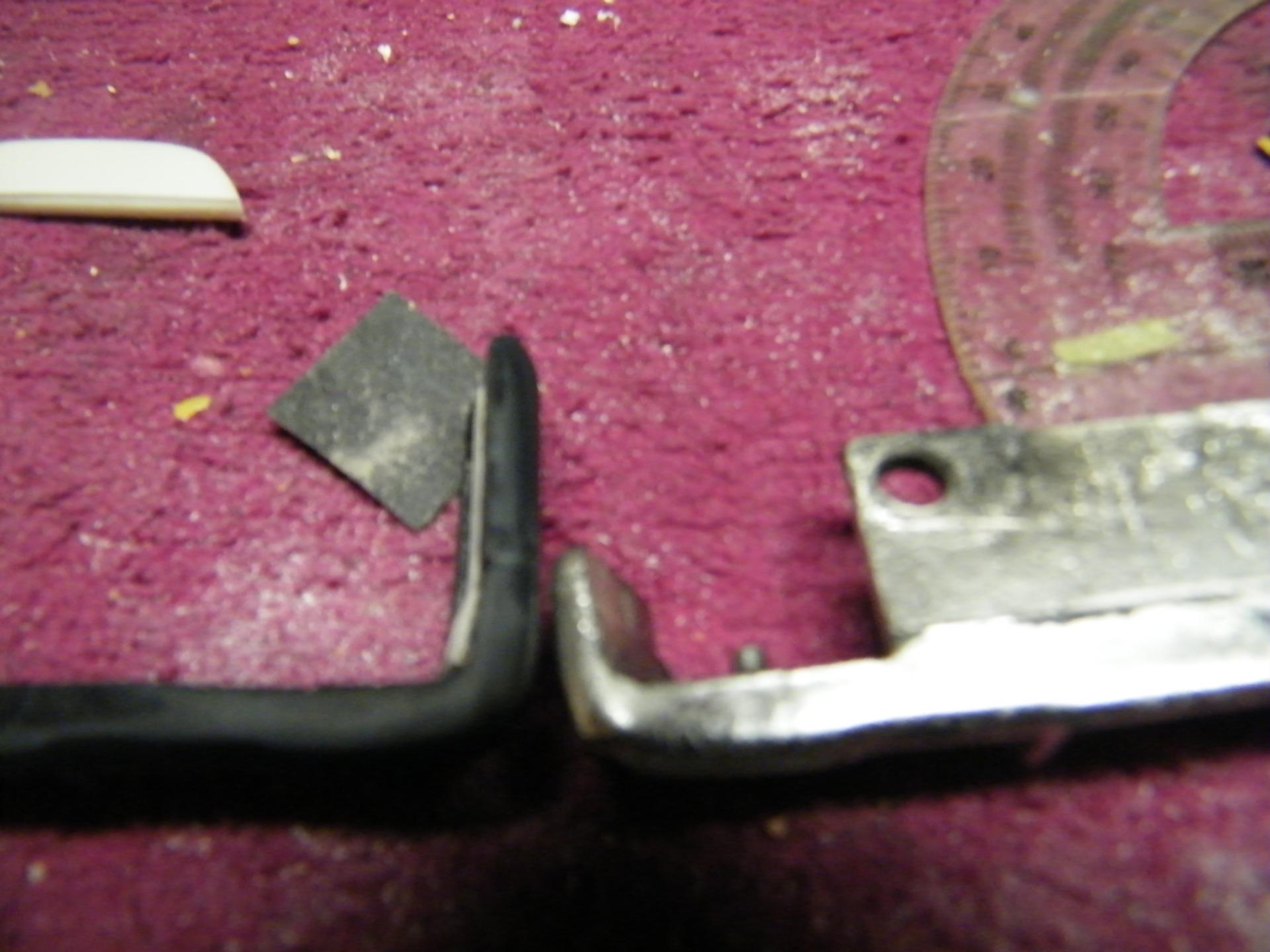

Want this one to reflect a true 50ies look from those days gone by, I made a correct connie kit using styrene and had to cut up two perfect original bumpers to create that look, I'll also need to remove one bar from the side od both front fenders as the kit has 5 of them and the real cars only had 4.
 Also I'll be removing the lettering from the hood and deck lids and replacing correct lettering with photo-etched  letters

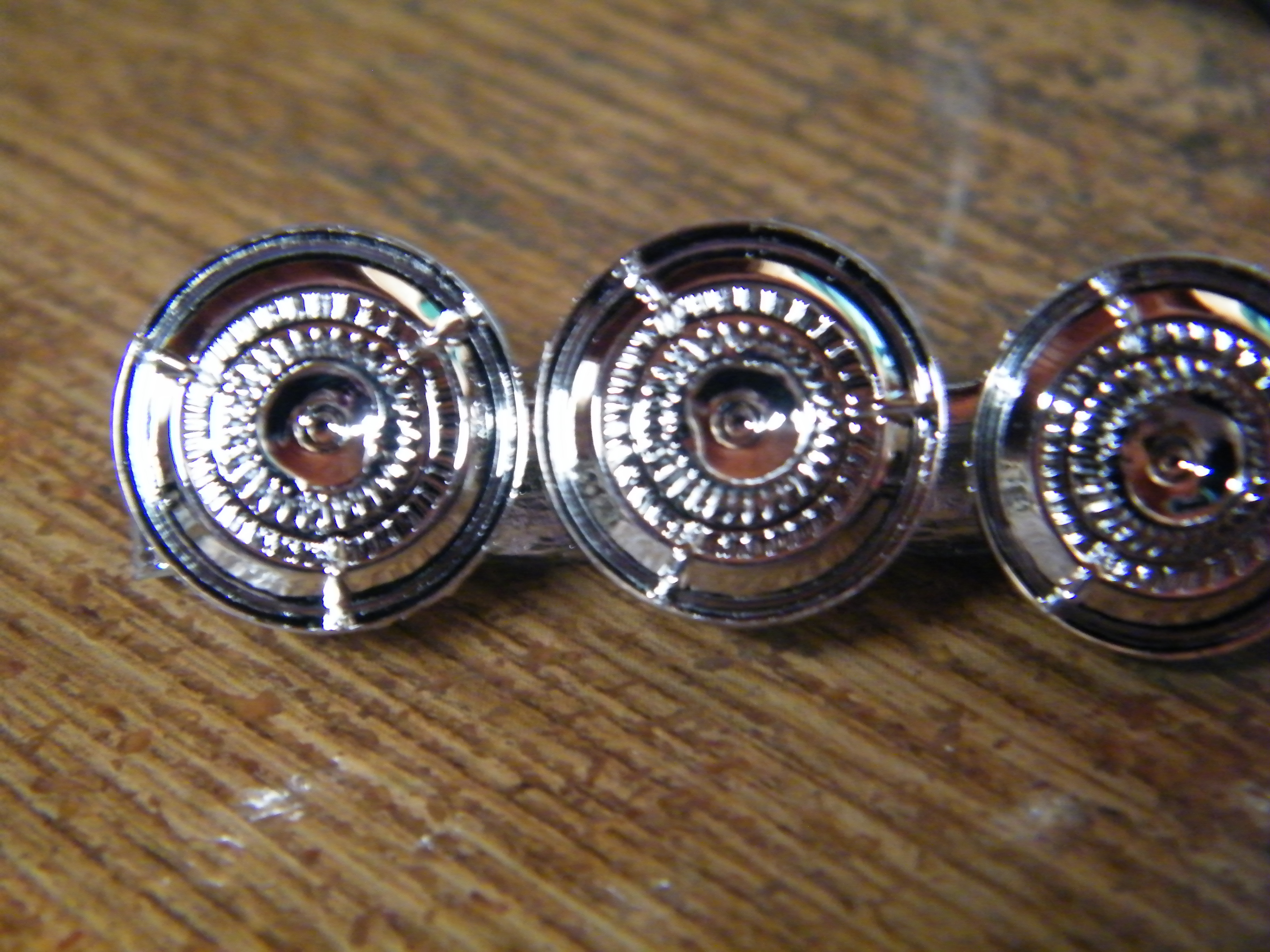

I'll have to get this paint specially mixed at the local paint store and not I'll be replacing the  the kit hub caps with corrected wheel covers

I made the connie kit Albert as well as the skirts using styrene plastic , the bumper I had to cut up two originals to create a correct bumper to fit the connie  , got lucky and score the car on E Bay

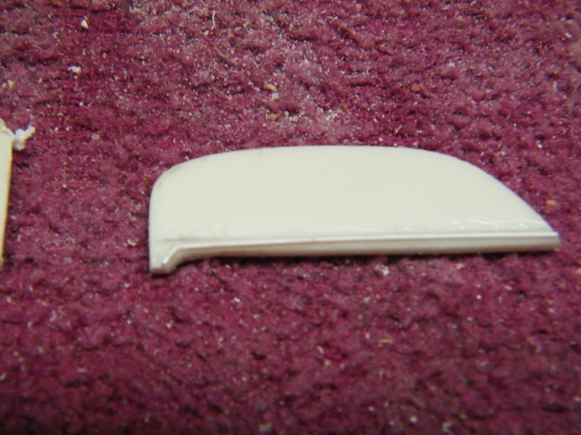

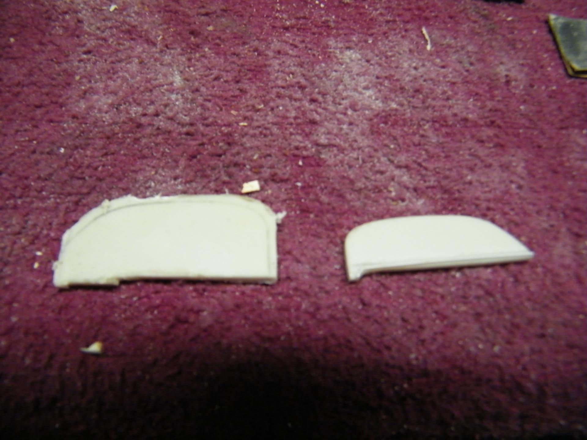

How did you make the fender skirts start to finish including thickness of styrene as well as lip on bottom of skirt. Thanks

John I use a sheet of .060 styrene for the shirts and use a .030 styrene square rod for the lip, there was a little shaping to be done but wasn't a big deal an the lip. As for the skirt I placed some tape on the inside of the body and cut it with my exacto knife, then stuck it to the styrene sheet  and made a ruff cut and used a file to work it down till I had my skirt. Had to use some light heat to give it a little roll to fit the body using a round number 2 pencil
Just as a suggestion, when you are ready to install the skirts, you can just tape them in place from the inside of the body.
That way they can be removed later if you so wish without any damage.
It will also save you from worrying about winding up with a glue mess trying to permanently install them.

I plan to make some kinda pins to hold mine in place from the inside, a guild pin at the top and one that will run length of the skirt that will hook into a hinge of short. Much  like the 1:1 cars did
