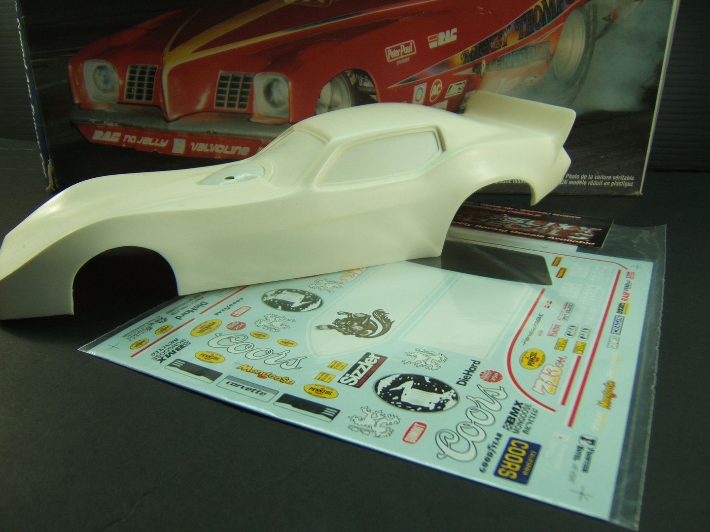

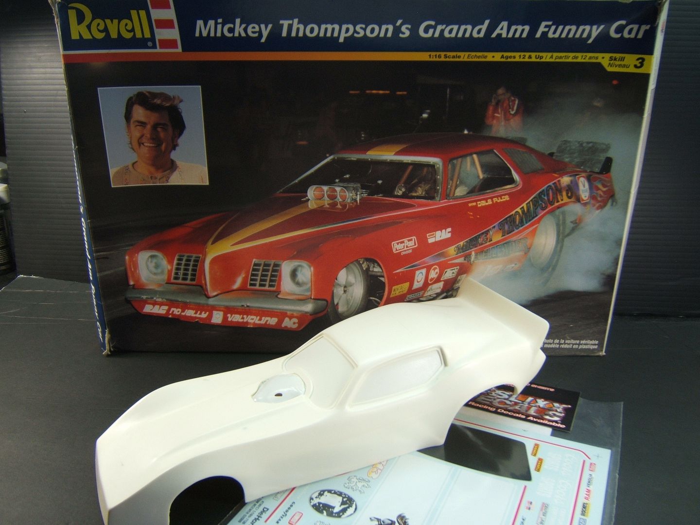

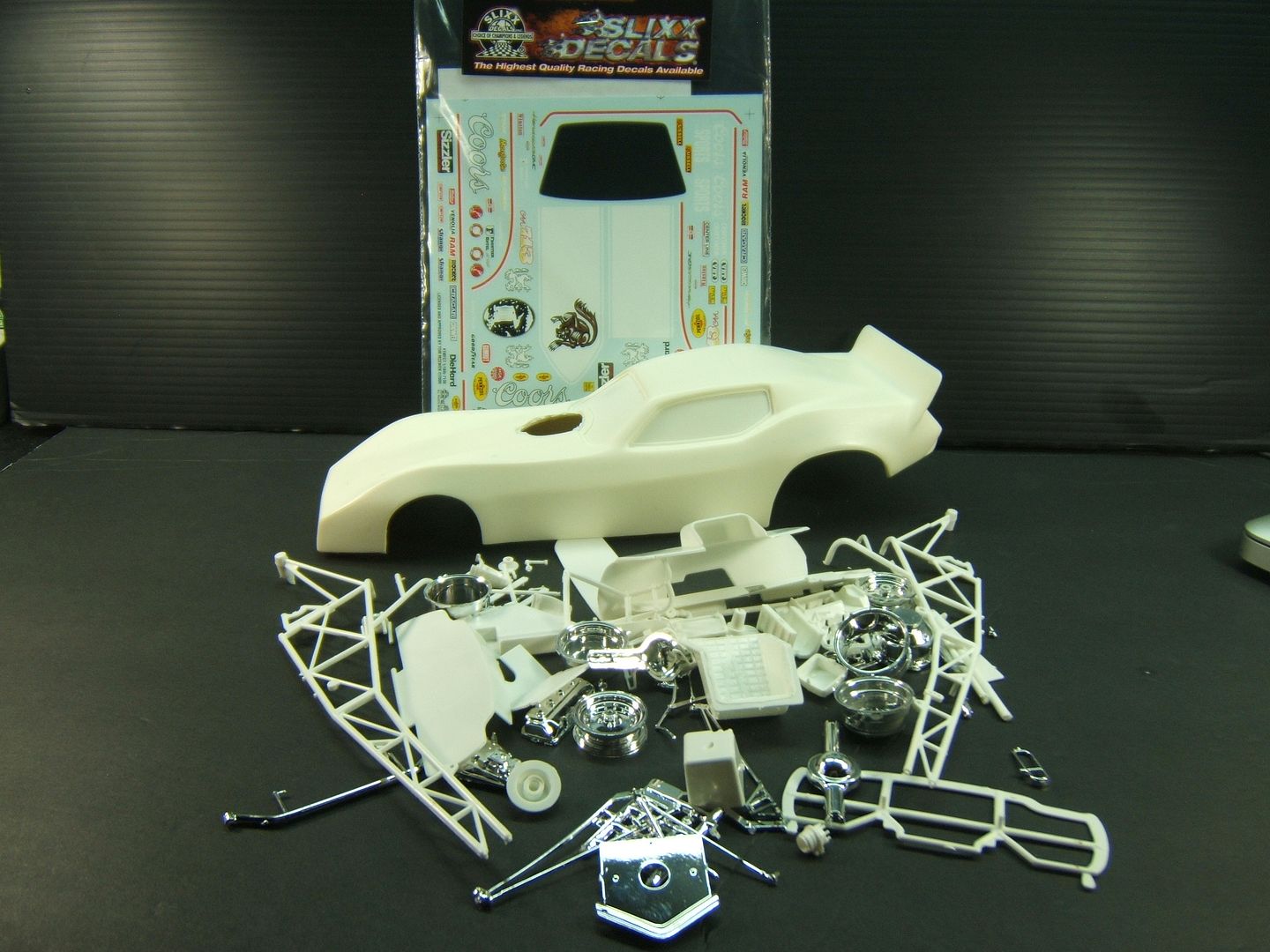

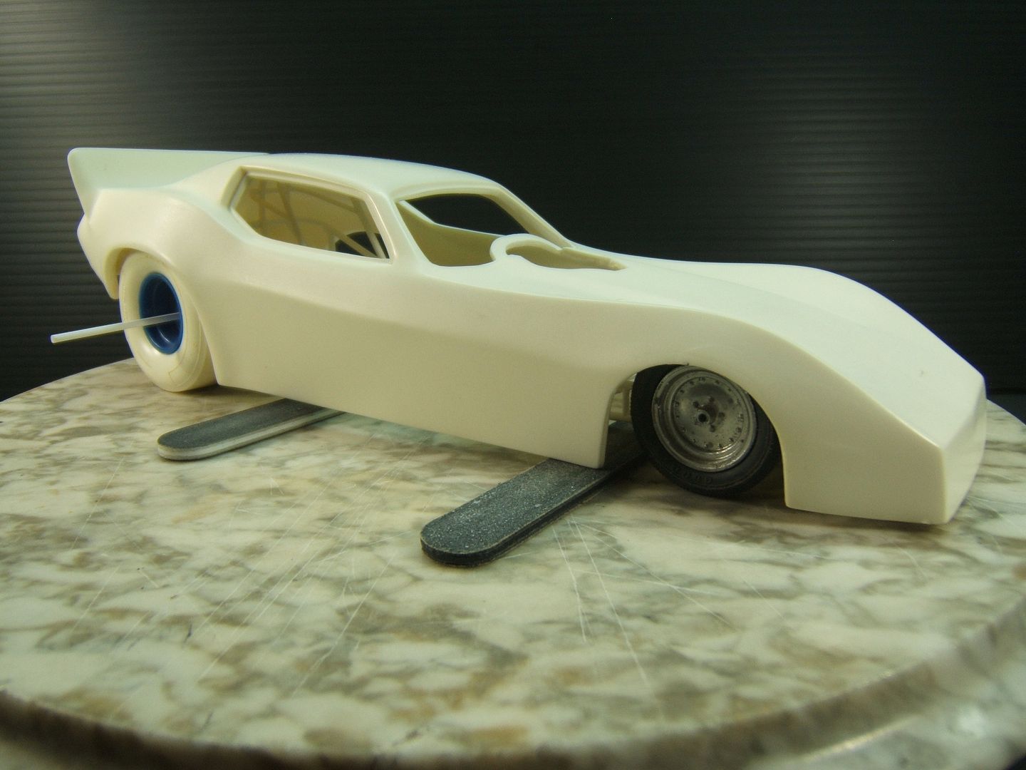

Hello......Out with the Old ......In with the New......this is on the workbench : a  Tom "Mongoose" Mc Ewen Silver Bullet Coors 1/16 Corvette F/C.......and My "Little Brother" AKA Chris Sobak comes thru again......he sold me his 1/16 Corvette Resin Body from 'Flashpoint" Resins ......I tried to look for one but,they are no longer availabale .......couldn`t find one anywhere .........So my "Little Brother" hooked me up with the body and Slixx Decals......thanks Chris so much ......you are one heck of guy.......I am using a M/T Grand Am F/C as a donor......since I have aother one to build.......I will start this build after Art Laski`s L.A. Roadster Show this Fathers Day Weekend in Pomona......see you there.....thanks for looking

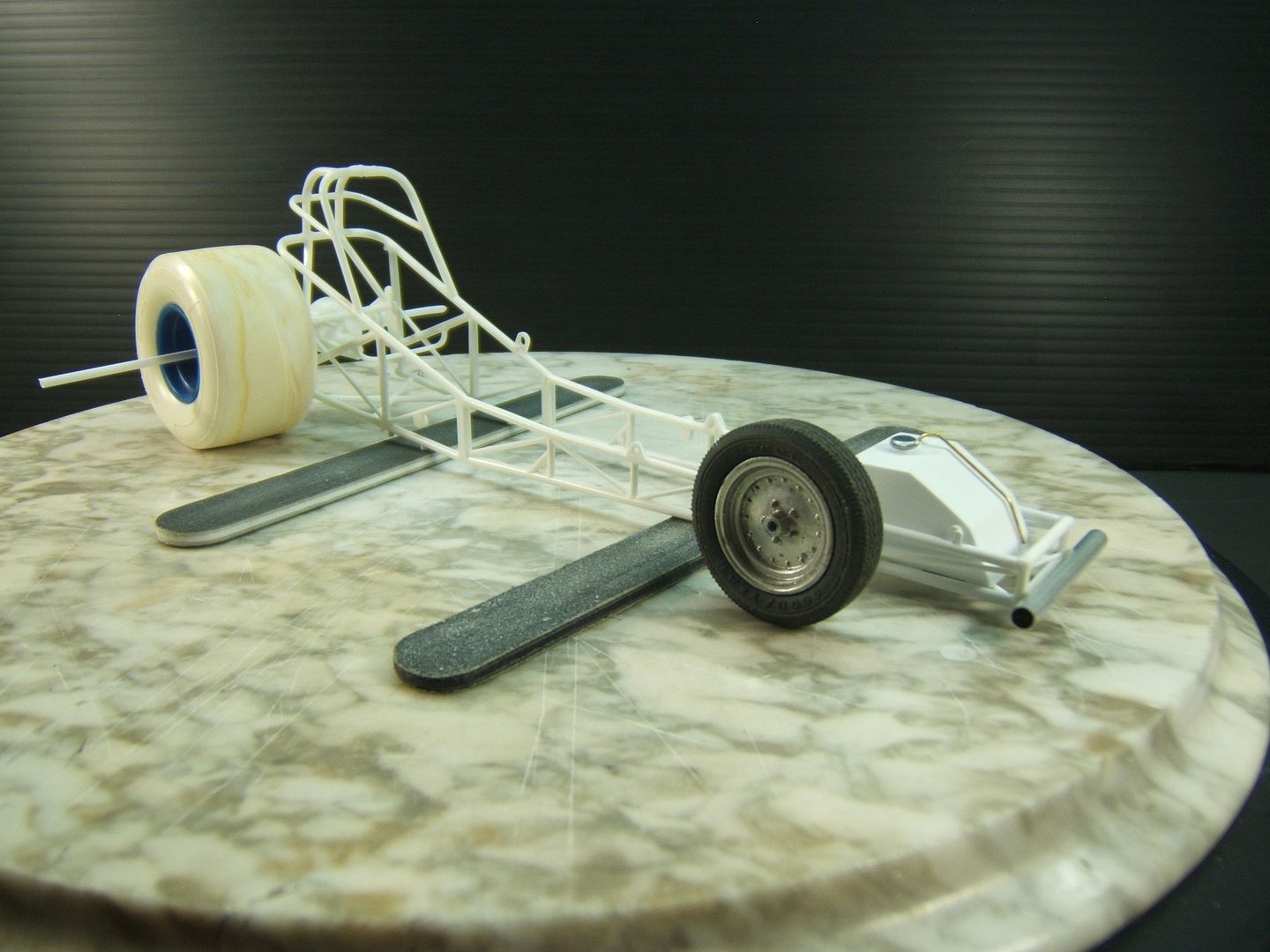

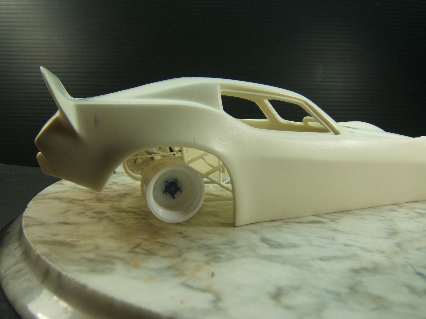

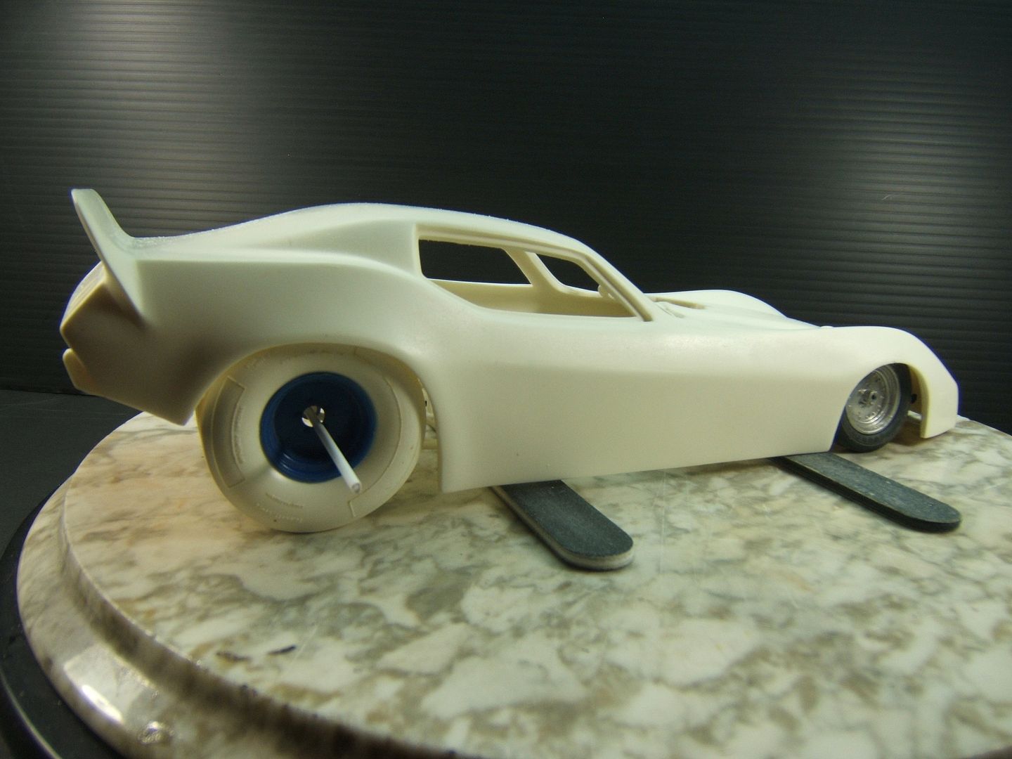

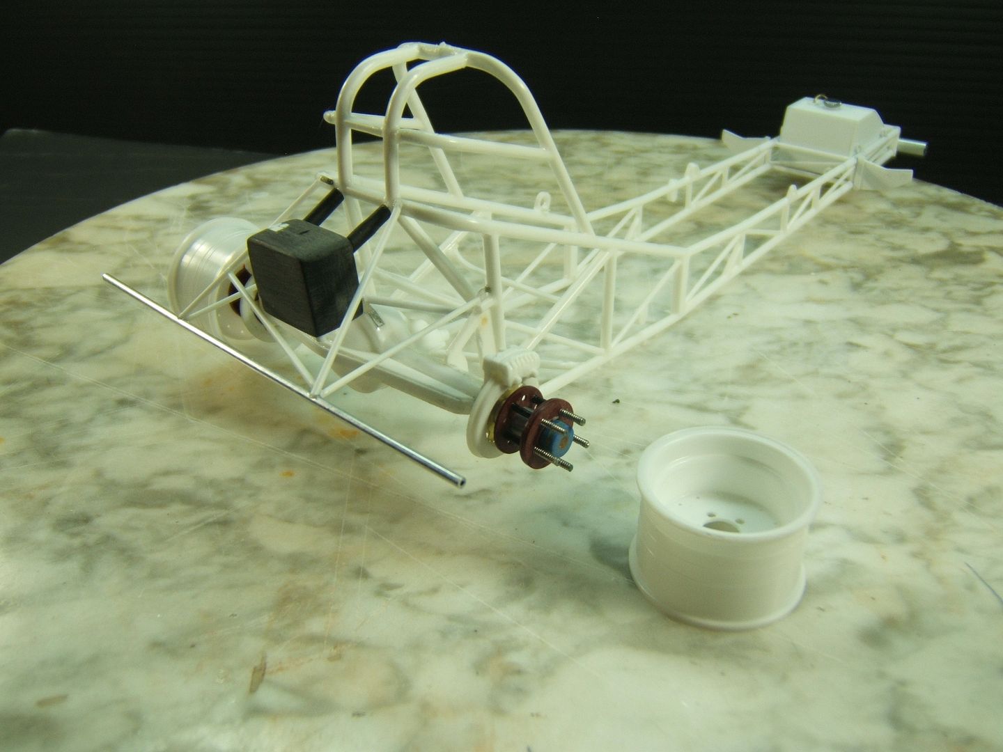

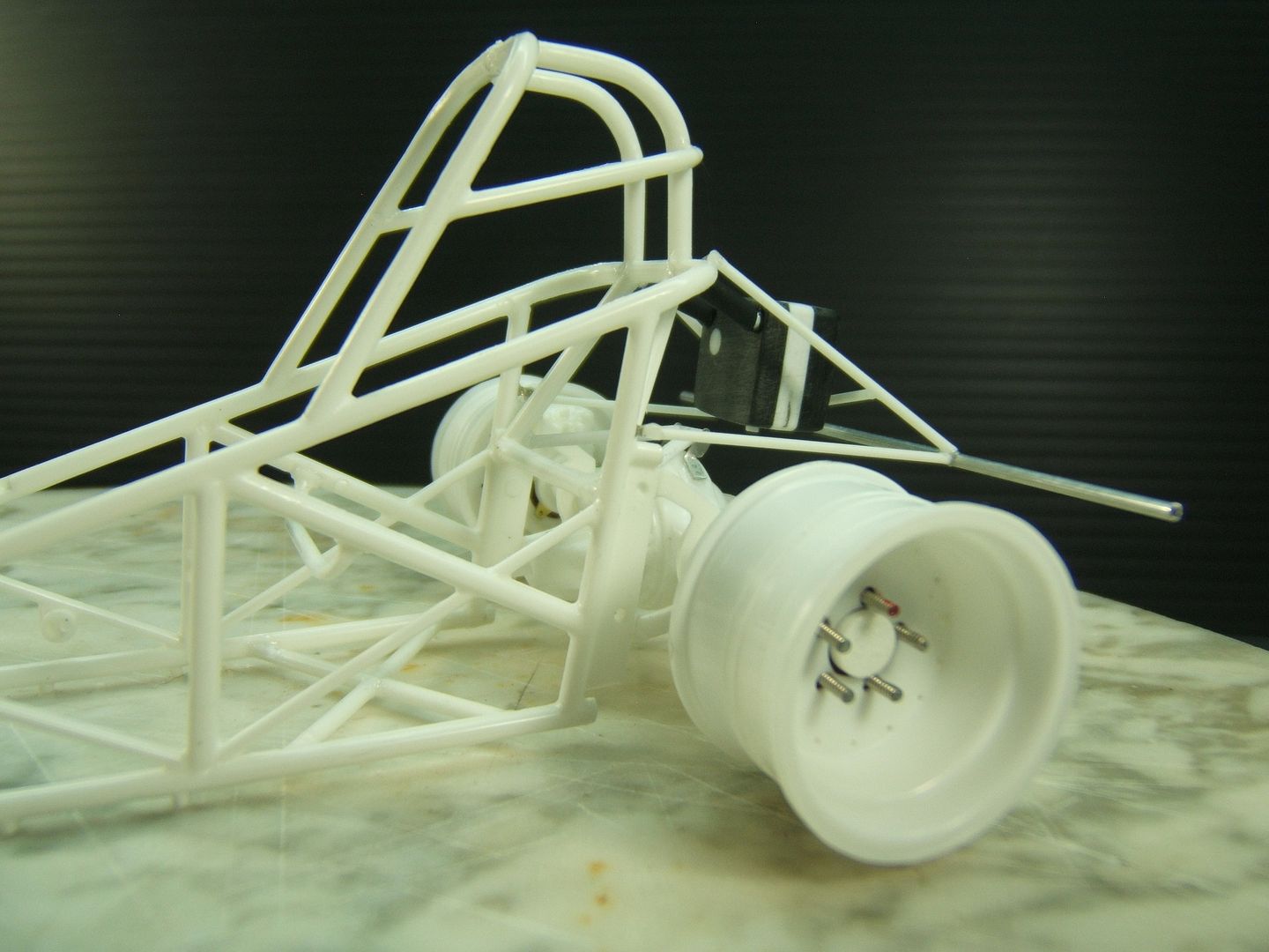

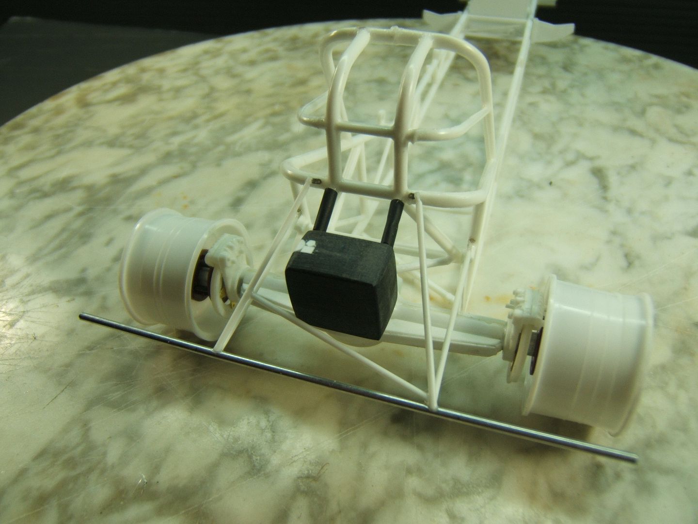

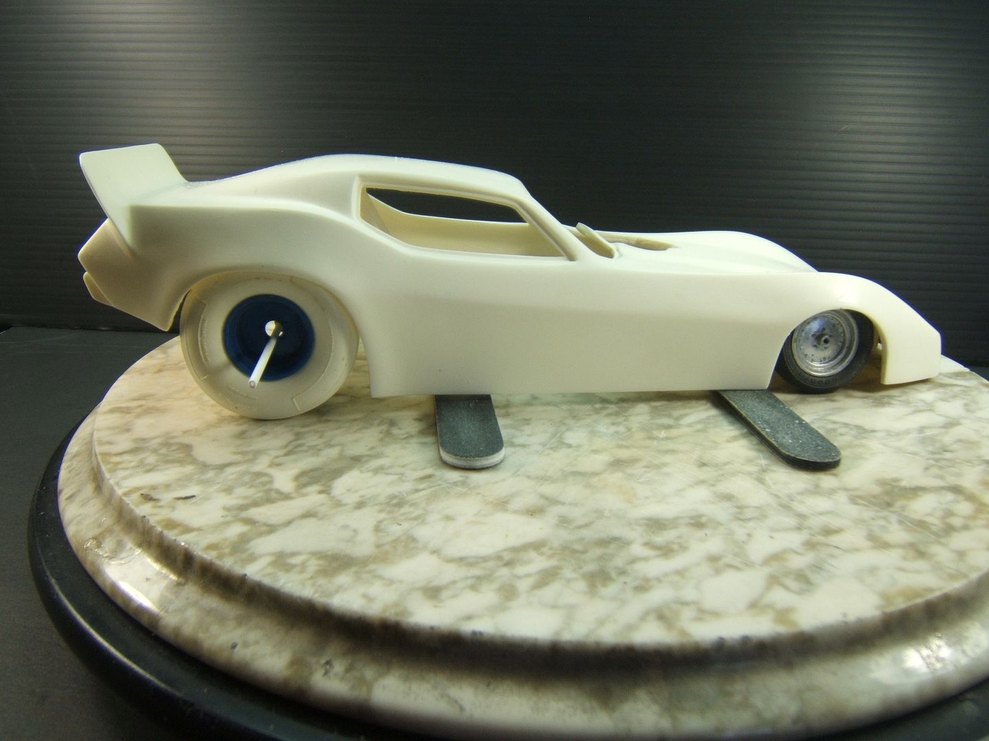

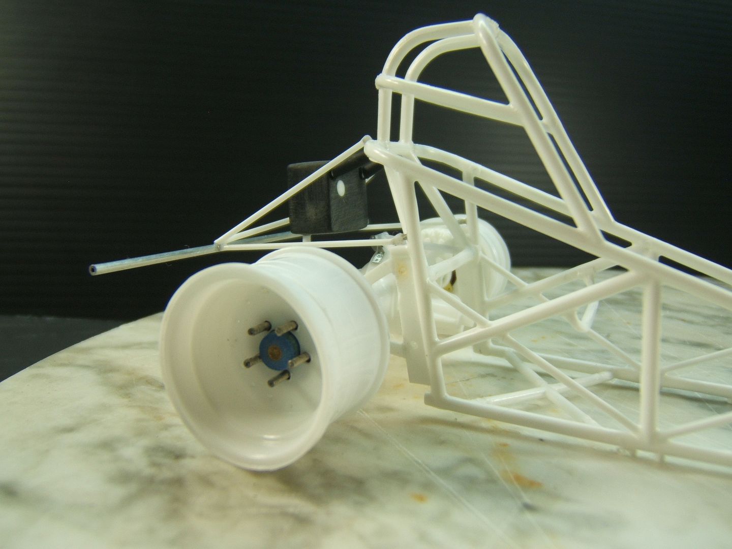

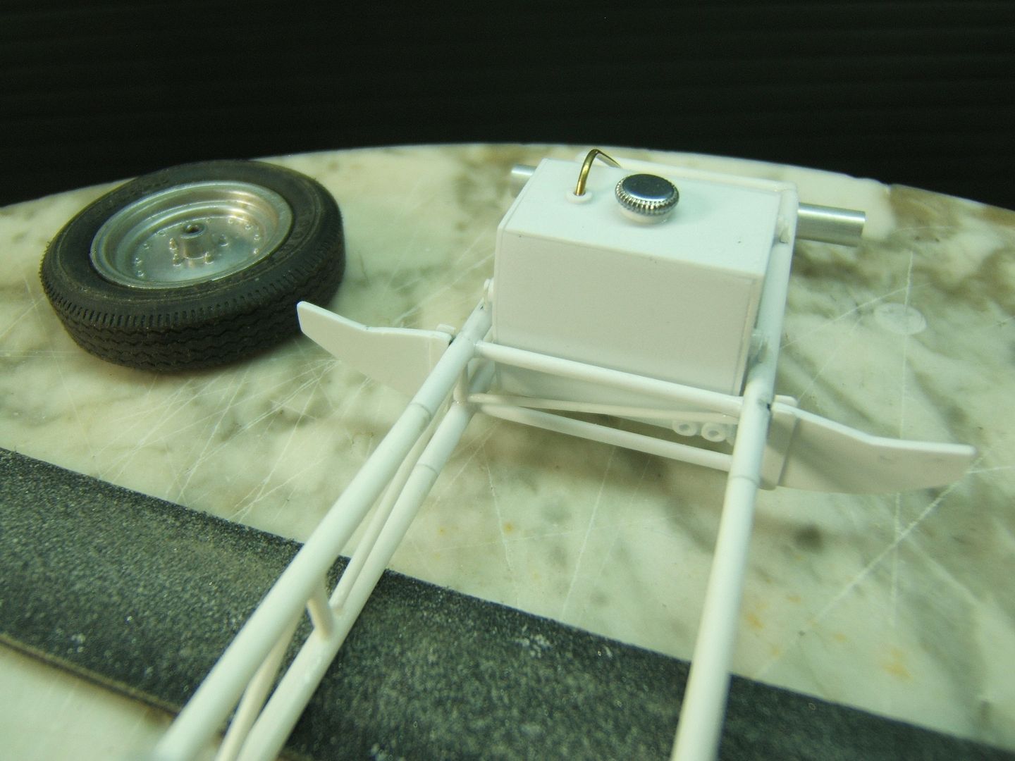

Hello......thanks guys for the kind comments......I really do appreciate them:)......I assembled the Revell kit frame and I will be doing some major modifications to it......I added over an inch to the frame and I will be changing the rear of the frame too........ I will be making a new front end system......I also made a new fuel tank......and I cleaned up the body a little bit.......and all the chrome will be striped and painted Alclad.....thanks for looking

Can you tell me how you lengthened the frame? I've tried before but I get so frustrated I give up! Any help would be great.
Share this post
Link to post
Hi Craig.......It`s not perfect but,heres what I do........I assemble the kit frame .....then I cut off the end piece "Front".......then I try and make sure each of the 4 post of the frame are even by cuting them all the same length and sanding the ends evenly......then I drill 4 holes at the end of each post #73 drill bit......then I glue 4 sraight pins about 1/2 inch long into each hole with Super Glue with the red cap.....that you can buy at the 99 cent store 2 bottles per pack......great glue for gluing styrene ........then I use the same width styrene tubing but,It needs to be hollow so that the straight pin with go through the hole with ease......Super Glue all for new styrene post all the same size that you need for the length you need.......jusy try and keep them straight ......after drying you can bend a little if needed.....then glue the end piece back on......with straight pins as well.......it will be strong and sturdy......hope that made sense .....thanks

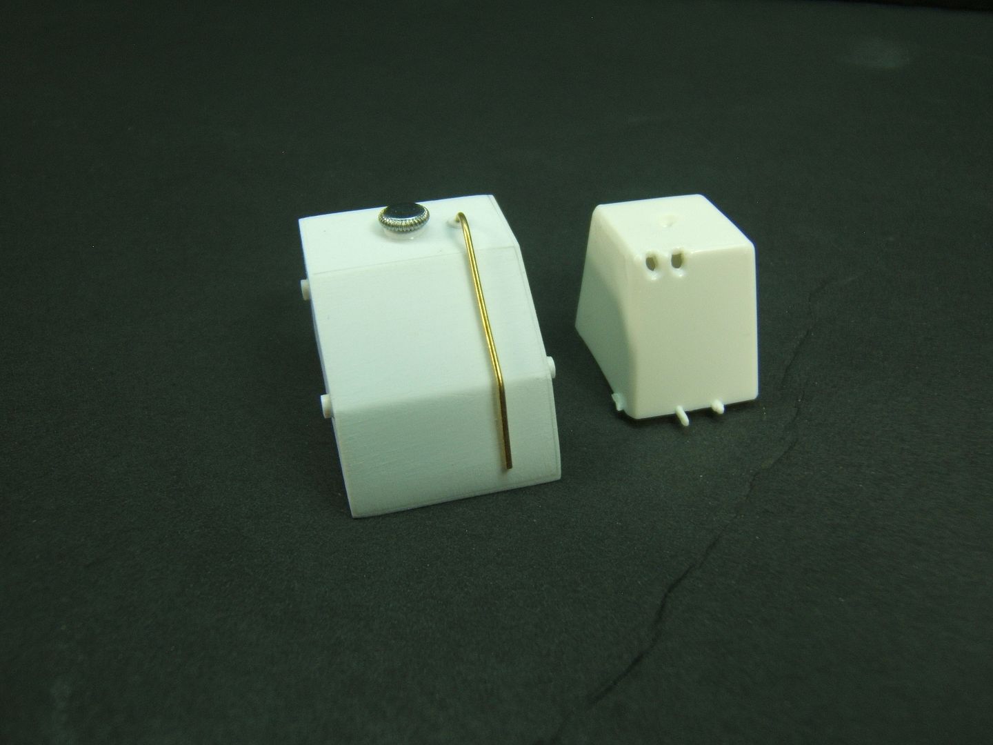

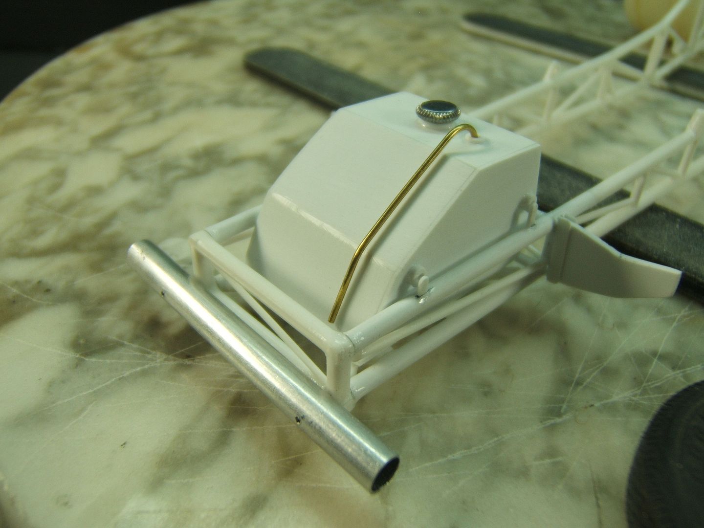

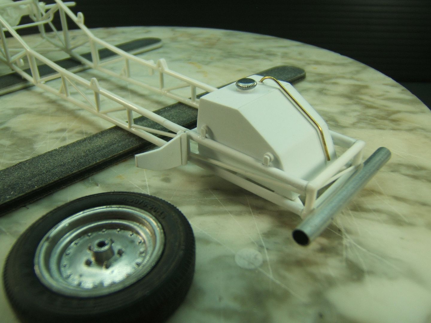

For the radiator cap I used a mechanical watch winding knob. Any chance that's what's sitting on top of your fuel tank?
Share this post
Link to post
Joe .....yes Sir......that is a watch winding knob......Art gave me a box full of watch parts......I love the parts......and I finished my Drag Bike a little earlier than I expected ......and got bored waiting for the show ......so I started working on the F/C:)

I use locktite superglue myself, good stuff. I was looking at the frame, I can't even tell where you added to it man. Good job!

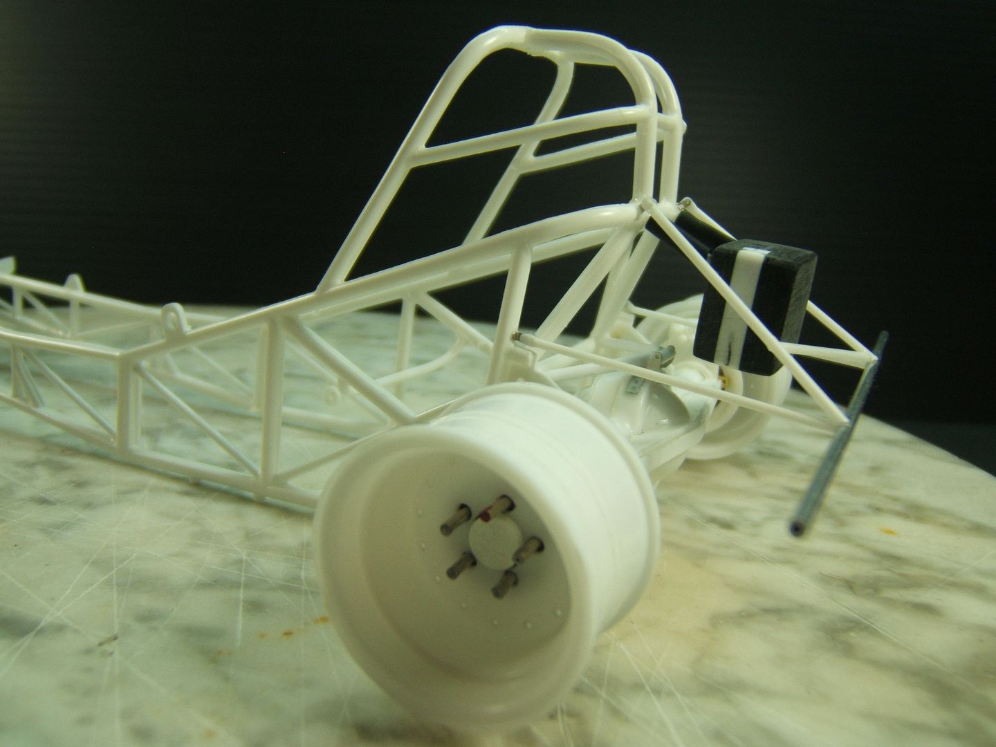

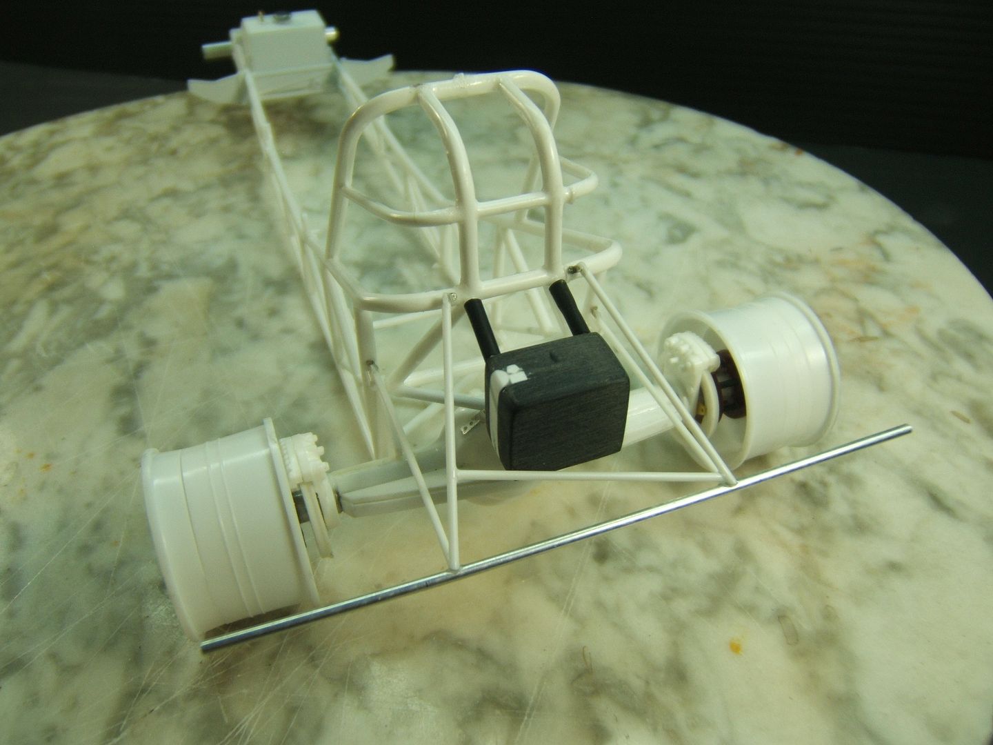

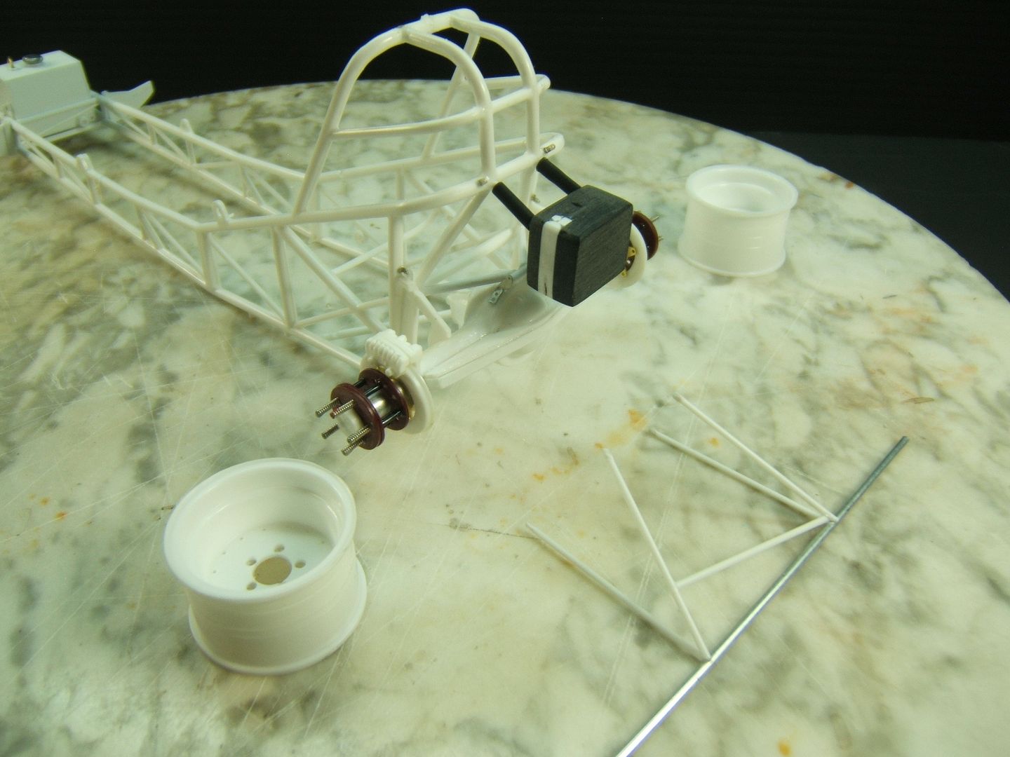

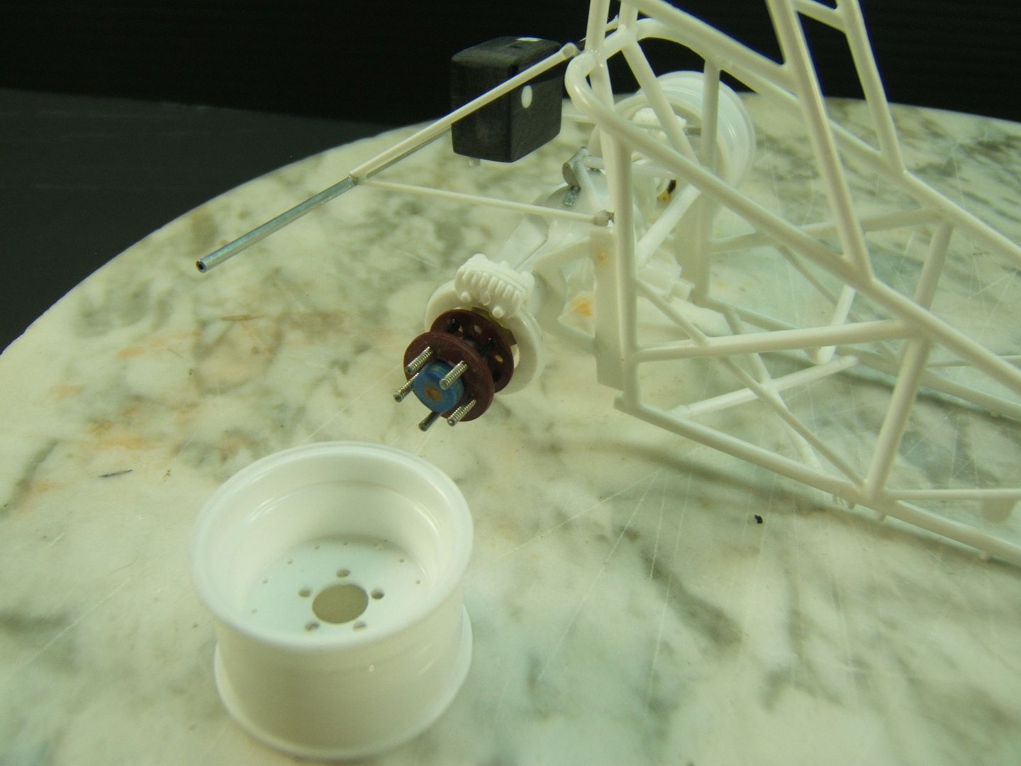

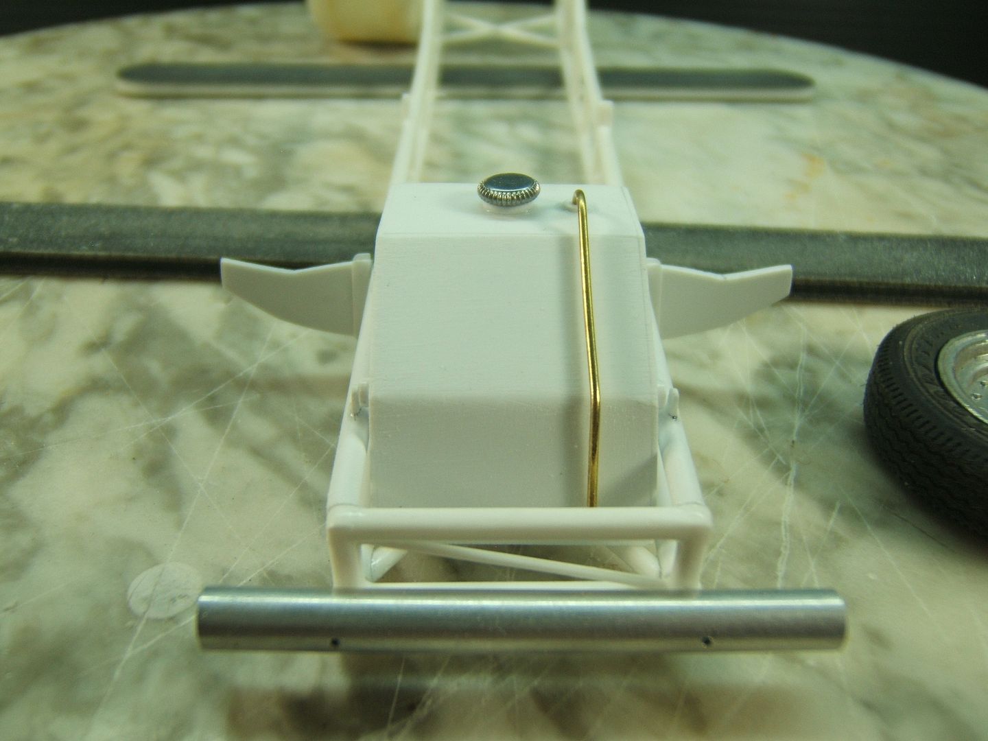

Hello.......Thank you all so very much for the kind comments ......I really do appreciate them:).......and thank you "Superman"  for checking in......always happy to get a comment from you:).......I made a Puke Tank and a Rear Body Brace.......I made some Hubs and modified some rotors......I have alot more mods to do on the frame......thanks for looking
