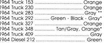

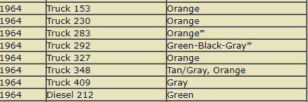

chadrob30 Posted July 4, 2017 Share Posted July 4, 2017 "#1 The engine should be Gray, specifically, Chevrolet Gray, which is a blueish gray. Battleship Gray is a close match. Orange engines were Passenger car only. Trucks did not get Orange engines until '67"This is not entirely true. I did have a '65 with the 292 six that was the blue gray...the 283 V8's were orange. Quote Link to comment Share on other sites More sharing options...
Longbox55 Posted July 4, 2017 Share Posted July 4, 2017 "#1 The engine should be Gray, specifically, Chevrolet Gray, which is a blueish gray. Battleship Gray is a close match. Orange engines were Passenger car only. Trucks did not get Orange engines until '67"This is not entirely true. I did have a '65 with the 292 six that was the blue gray...the 283 V8's were orange.Not from the factory. Maybe a replacement 283 or one that has been rebuilt in the aftermarket. According to GM, they were gray.http://1954advance-design.com/Web images/PPIP/PPIP-1912-1966-EngineColors.html Quote Link to comment Share on other sites More sharing options...
chadrob30 Posted July 5, 2017 Share Posted July 5, 2017 Well you can't argue with that lol. However, I did find the exact same list used by permission from the author and it is different. The list you posted shows 1964 as gray. The list that was used by a different site has different info. It shows 1964 Truck as orange. No wonder nobody can get a straight answer. Quote Link to comment Share on other sites More sharing options...
