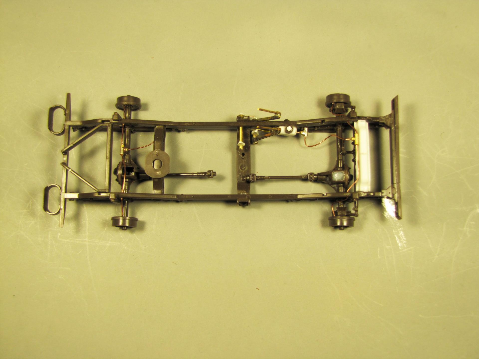

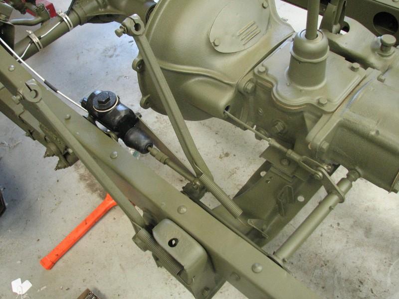

Next up, and more than a bit complicated and frustrating, was the clutch throwout linkage setup--all done in small brass rod, but "anatomically" correct.Ford_GPW_brake_and_clutch_pedal_assembly

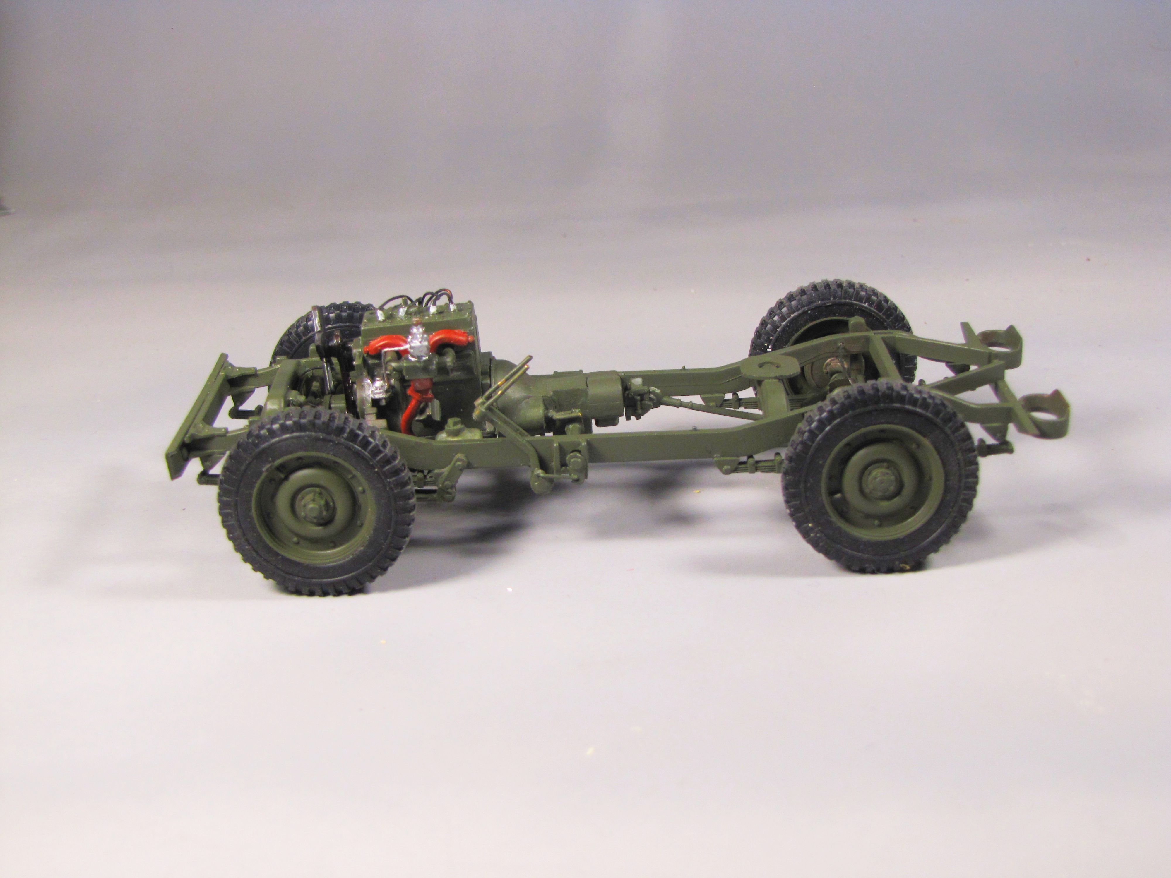

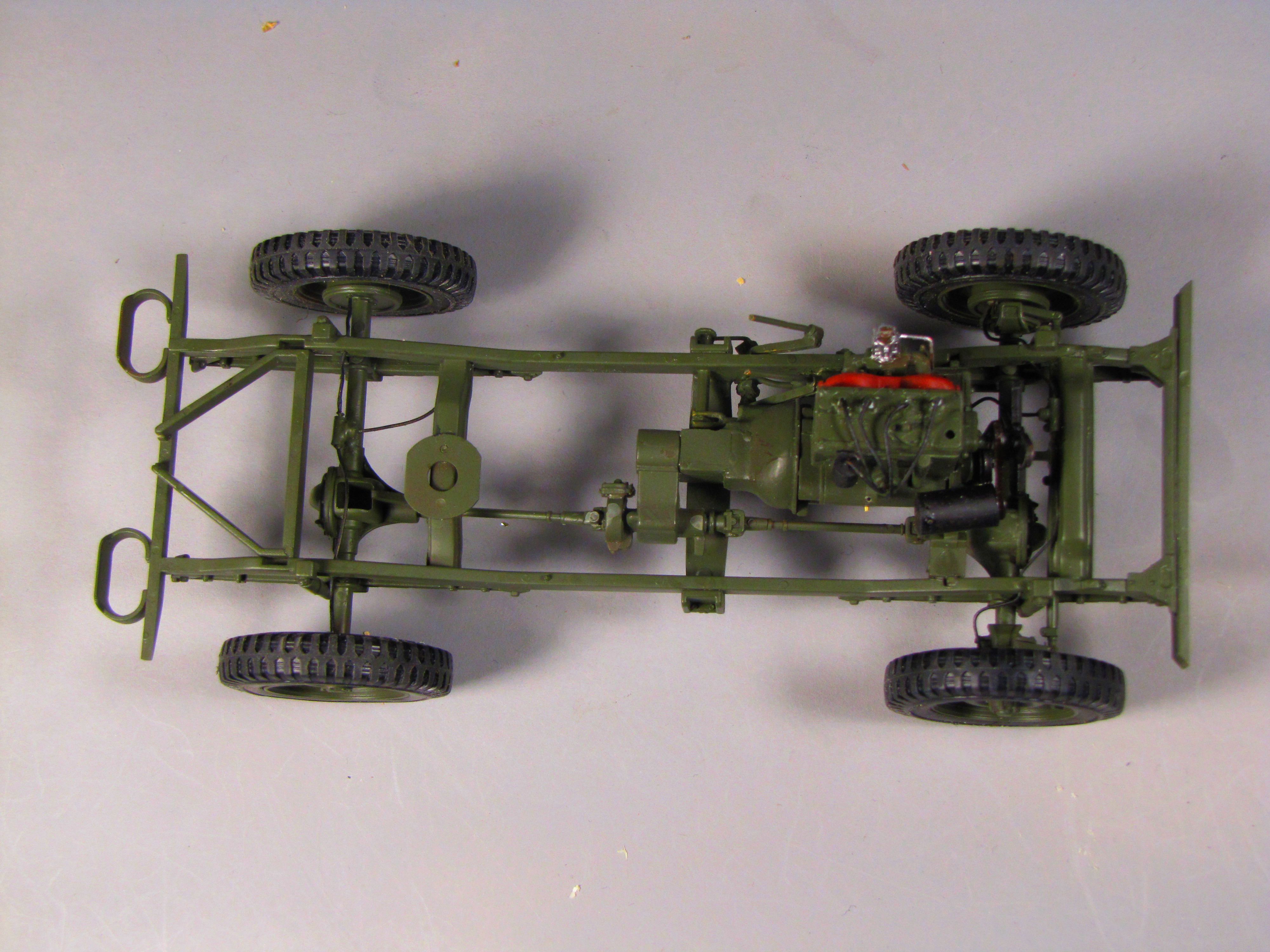

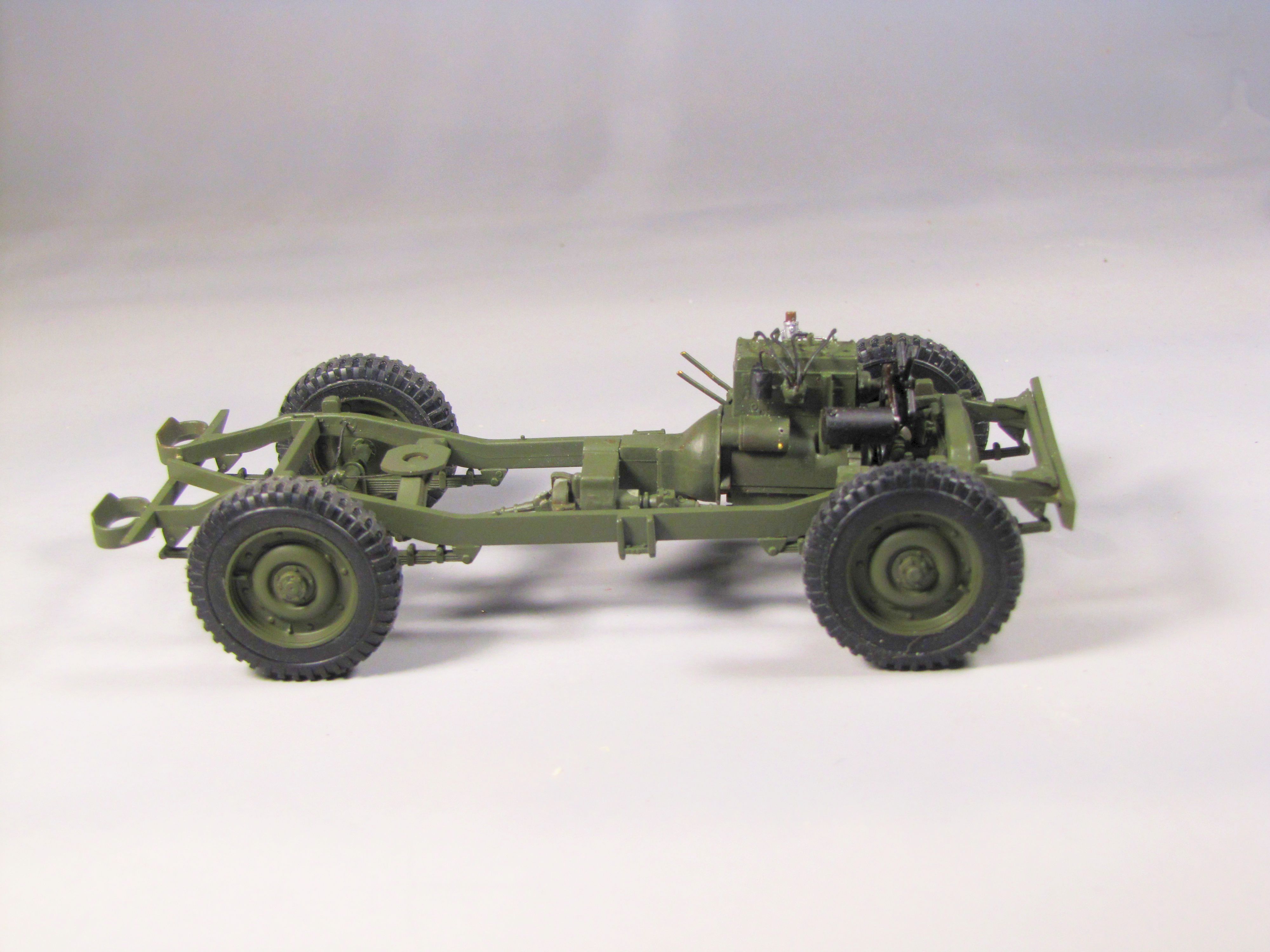

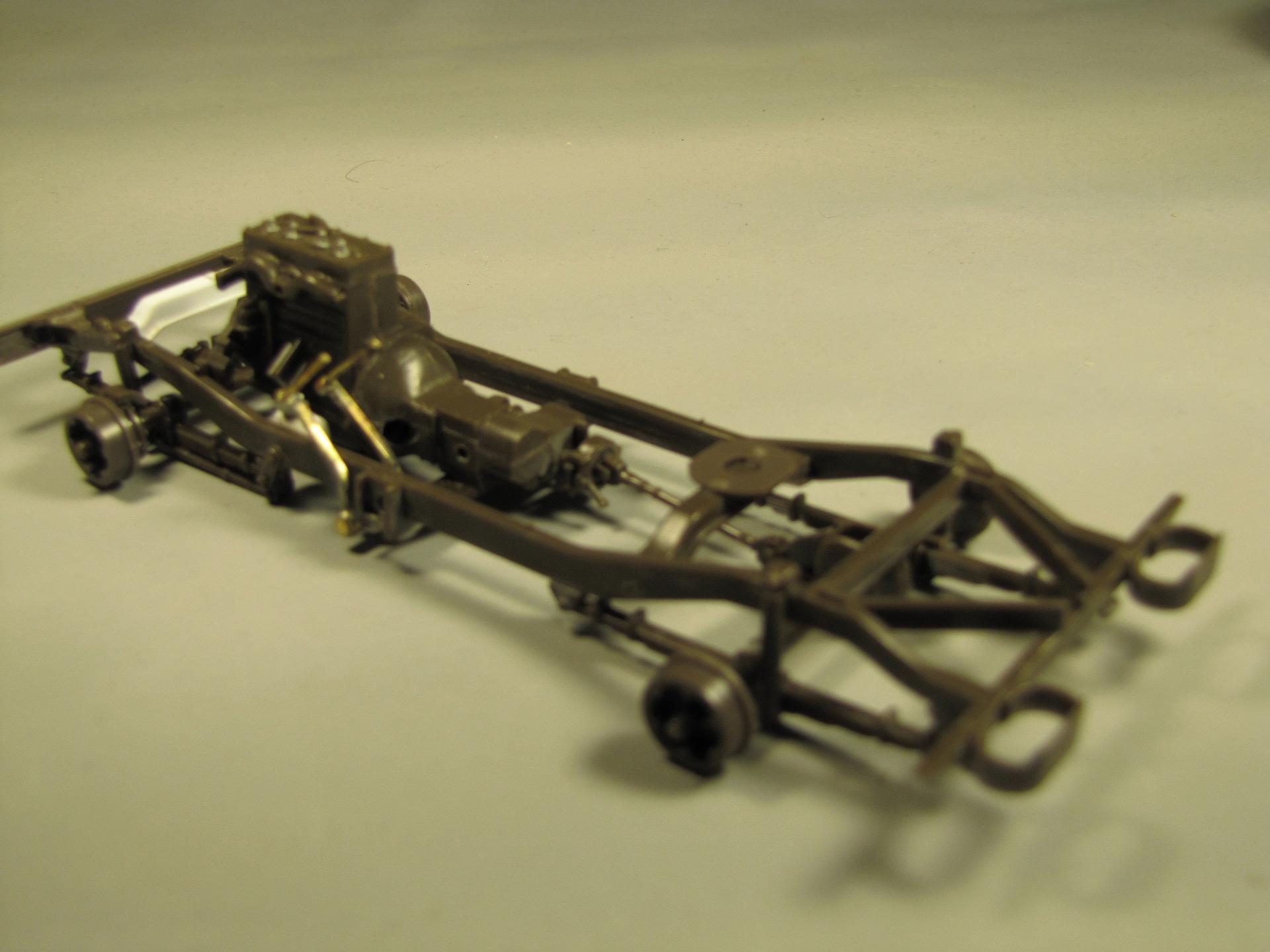

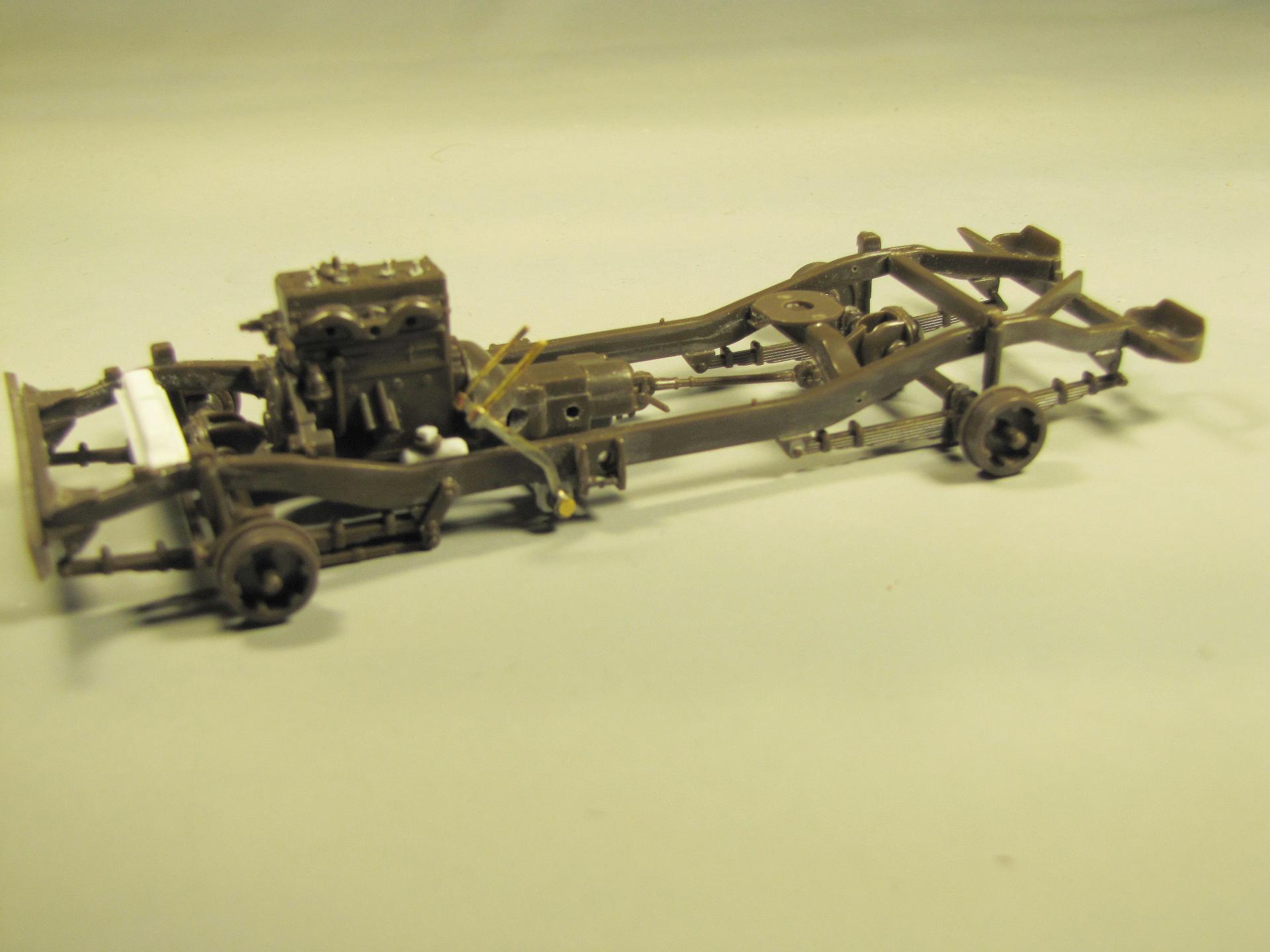

Chassis got wheels and tires installed on the 4th,  and has it's completed clutch pedal and throwout rod assembly done.
Ford GPW scrtchbuilt brake and clutch pedals wtih master cylinder installed 1.jpg

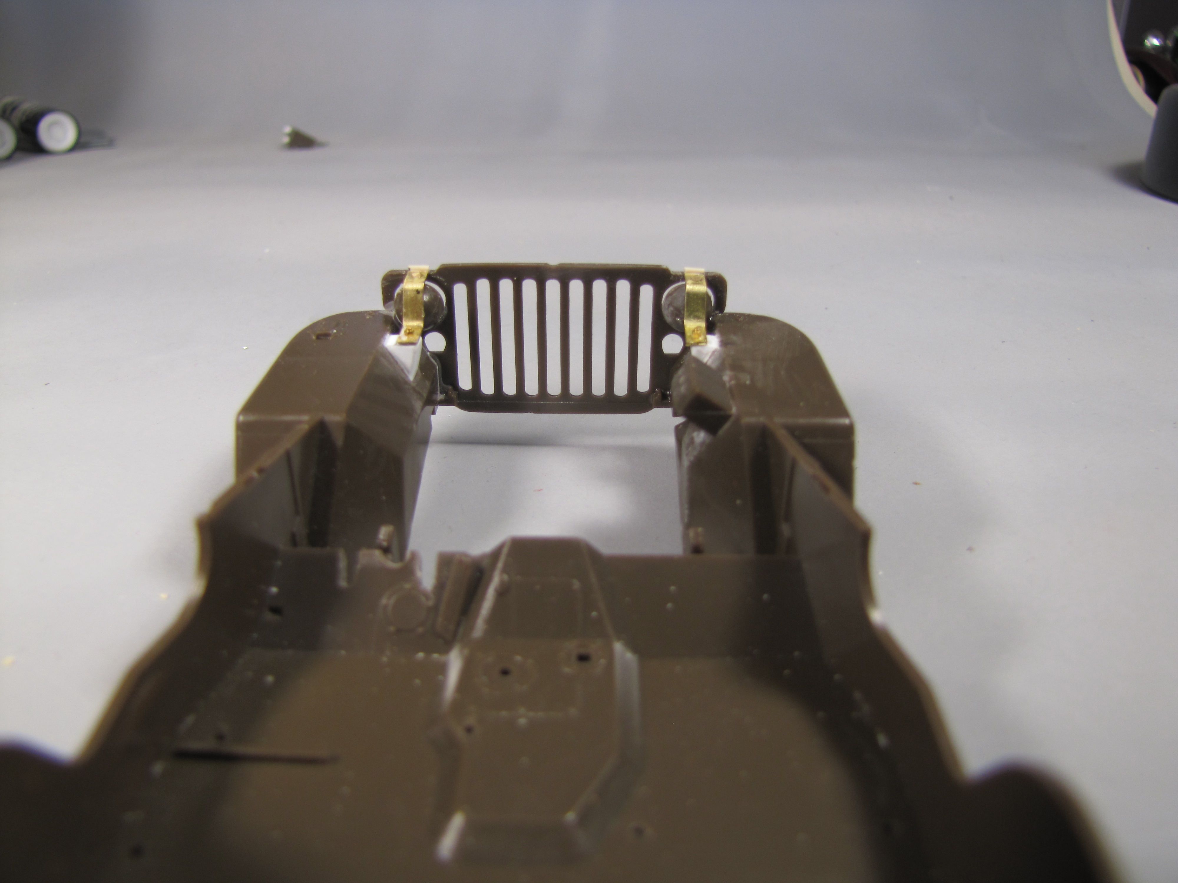

But wait!   There's more!   WW-II Jeeps had headlights that were uniquely mounted--BEHIND the grill panel.  This was so the headlight brackets used, could be unbolted from the inner fender panel, and then the headlight swung up and over the front of the grille panel, and the headlights themselves swiveled so as to provide "floodlighting" for maintenance work in the field. My brackets are done in 1/64x1/8 inch brass strip, simplified, as they were just too small to allow me to recreate the "channel section" appearance of the "upright leg" on them.  Still though, I think I captured the look, and the principal of the concept.

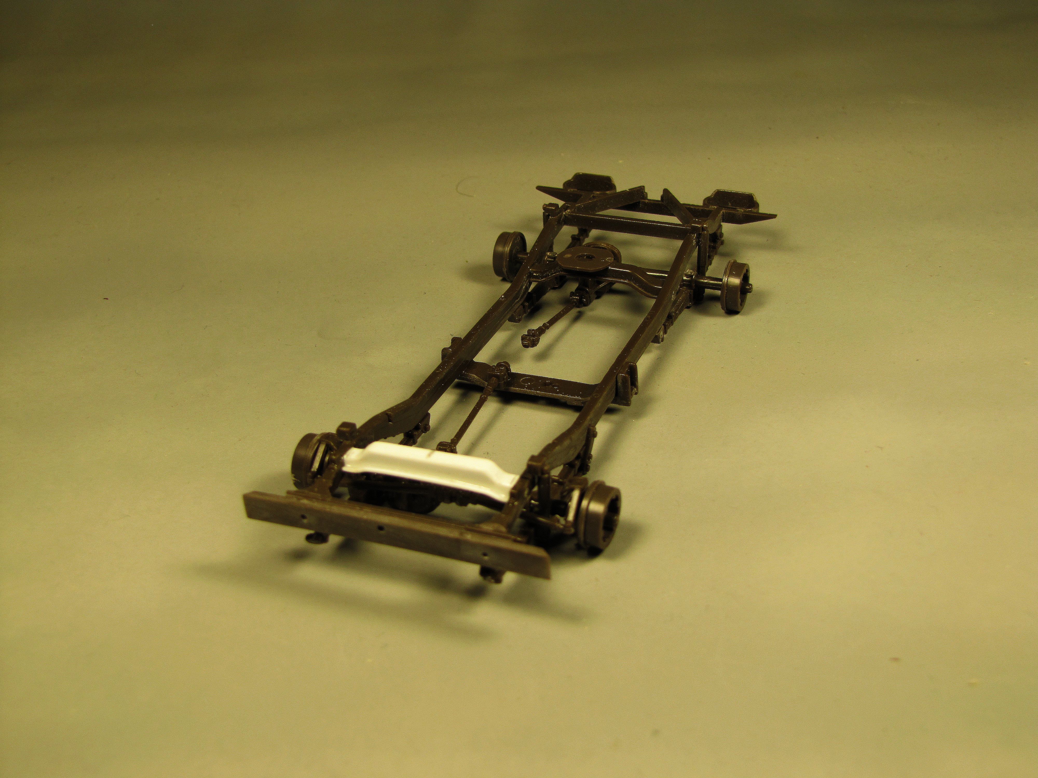

Uh, don't forget that this one is a FORD Jeep (Ford Motor Company produced about half of the over 500,000 Jeeps during WW-II).  The front crossmember I scratchbuilt for my project is the real "identifier" here
Art
