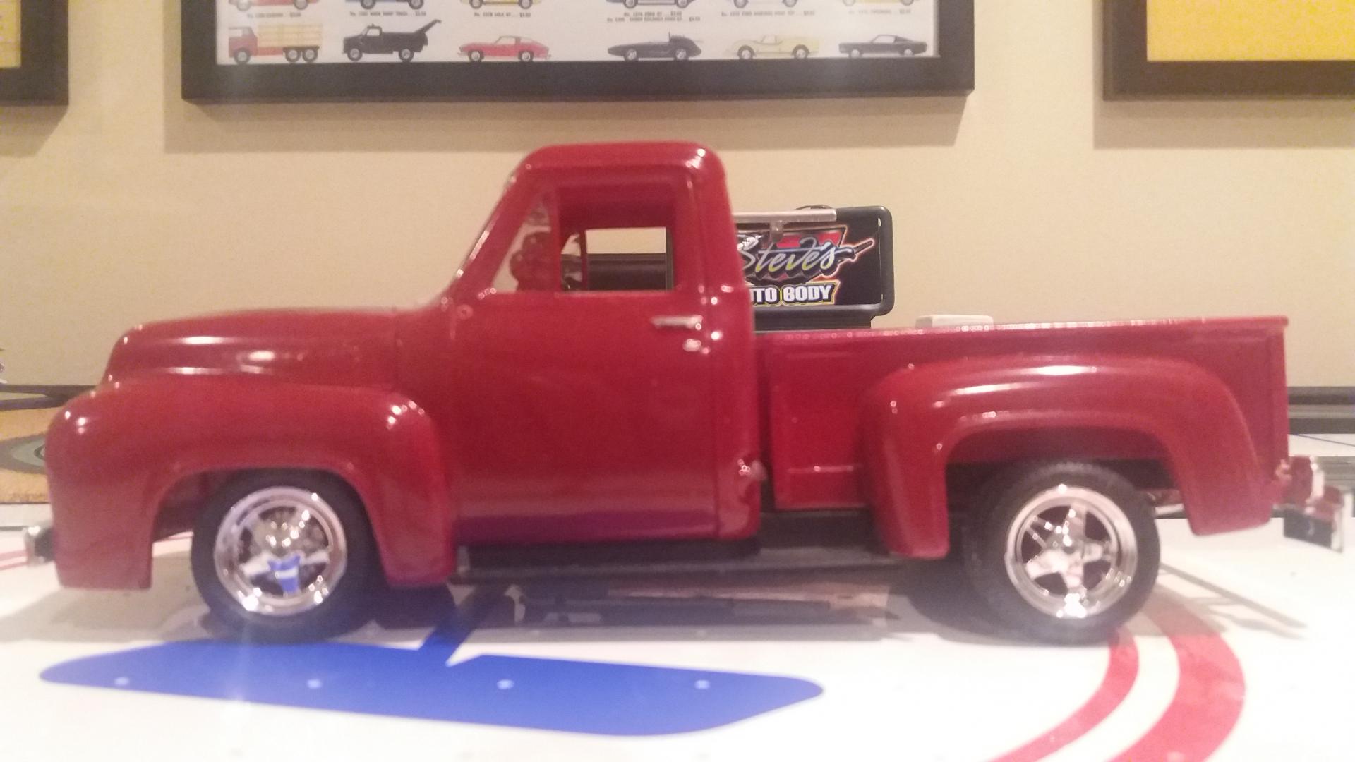

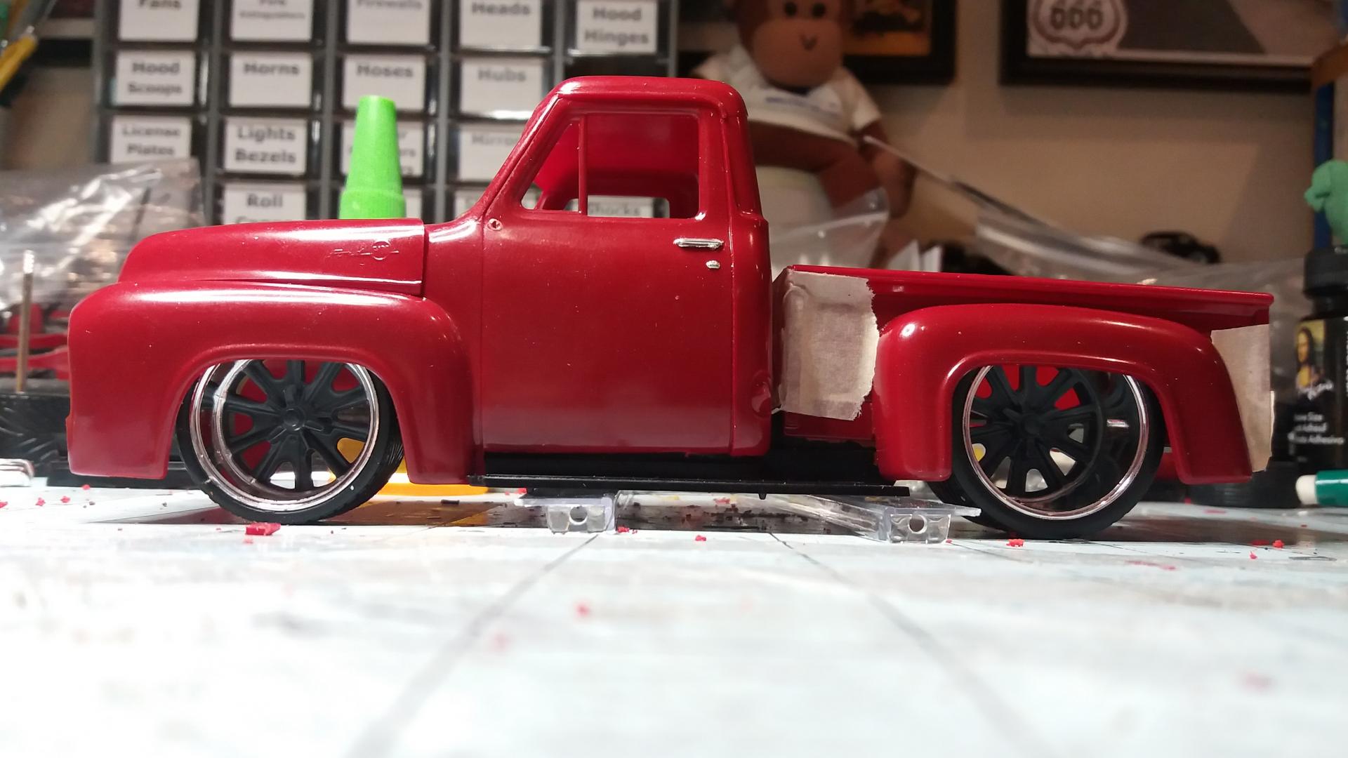

I was going thru some of my built ups and came across this interesting piece. She was built about 20 years ago. I thought this one needed to be brought up to date, So...

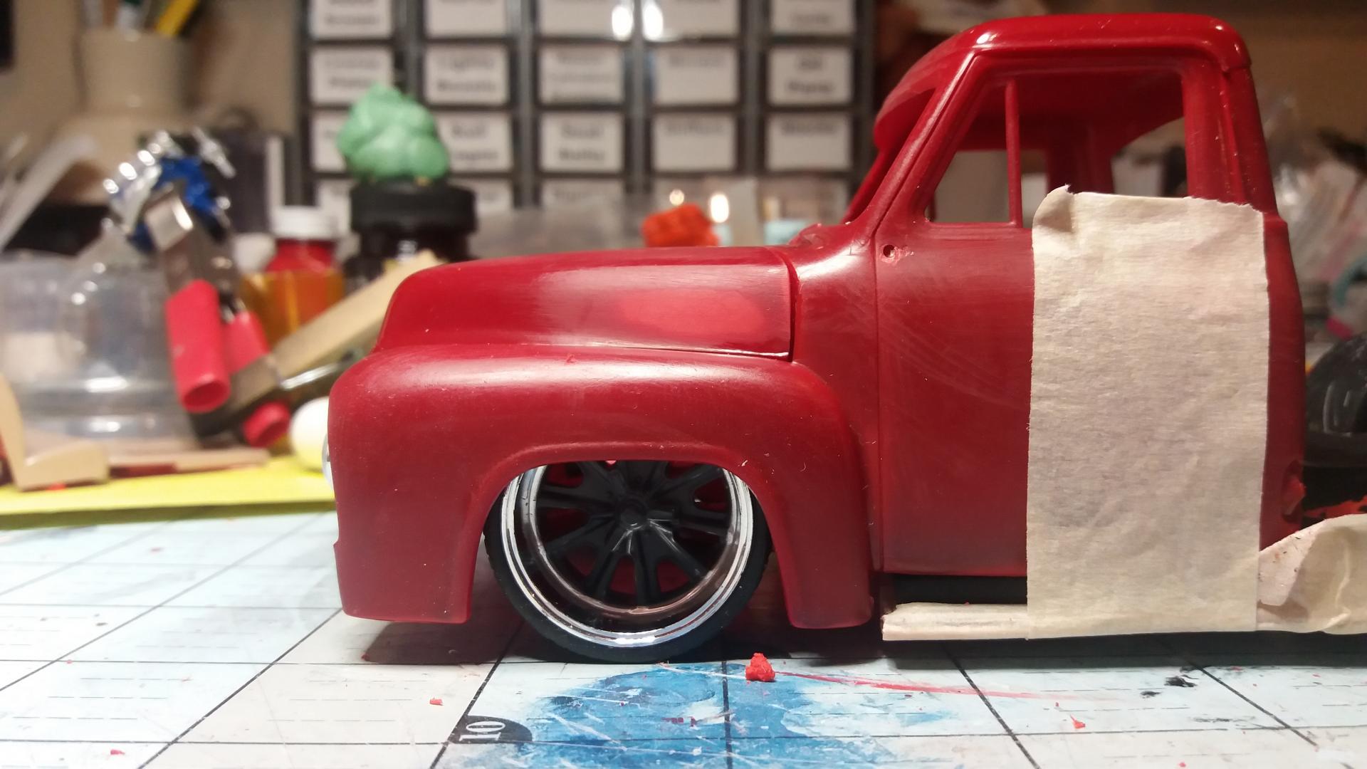

It looks like you already had a very nice looking build going in. I'm glad to see you got the front tires centered in the opening. This is a problem for the 1:1 truck also.

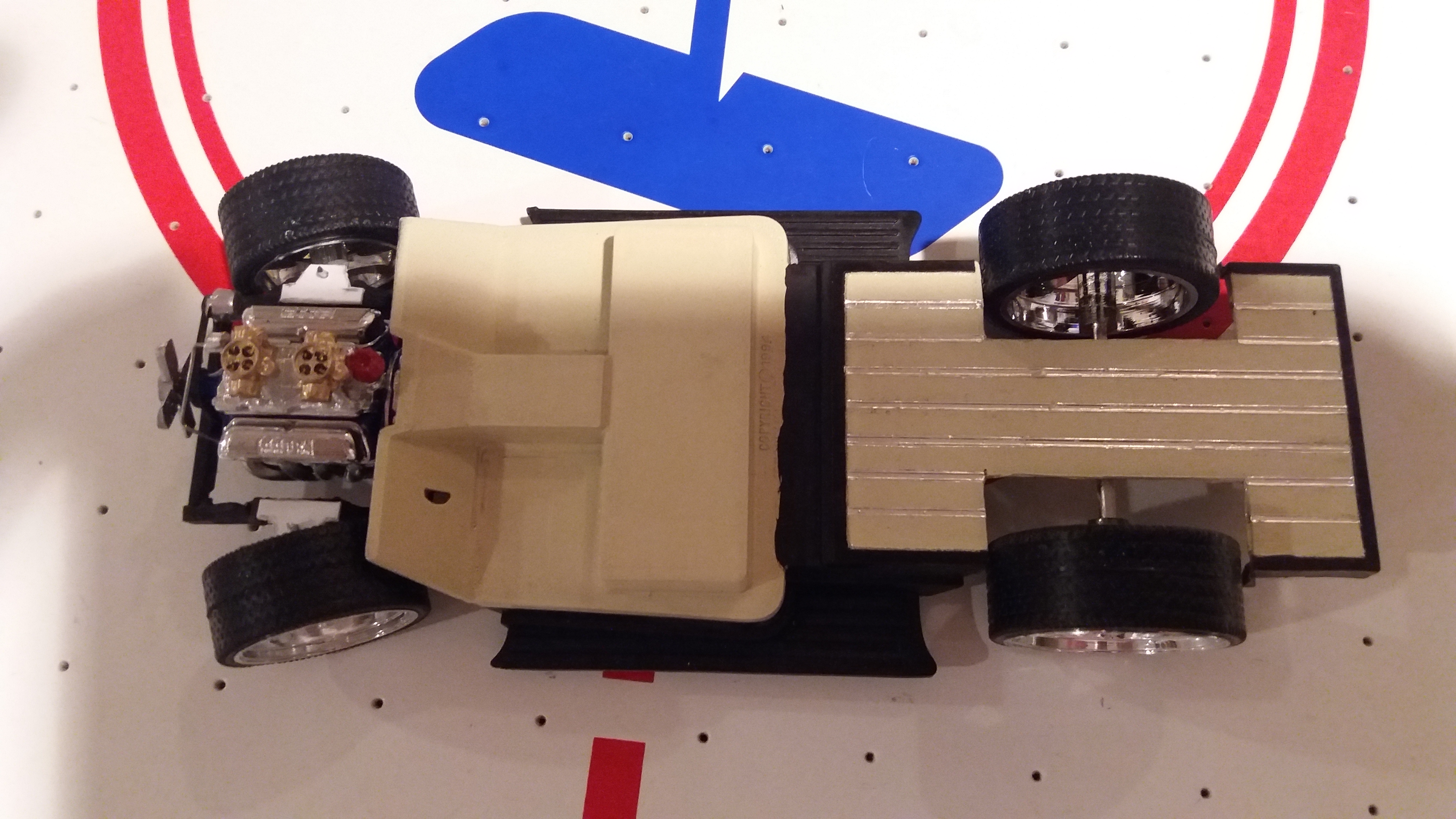

20170709_214121.thumb.jpg.09581e1e883c56
20170709_214130.thumb.jpg.d39962b8959f7e
20170709_214202.thumb.jpg.69f25dd9361d17
20170709_214222.thumb.jpg.ae416ffb955b12

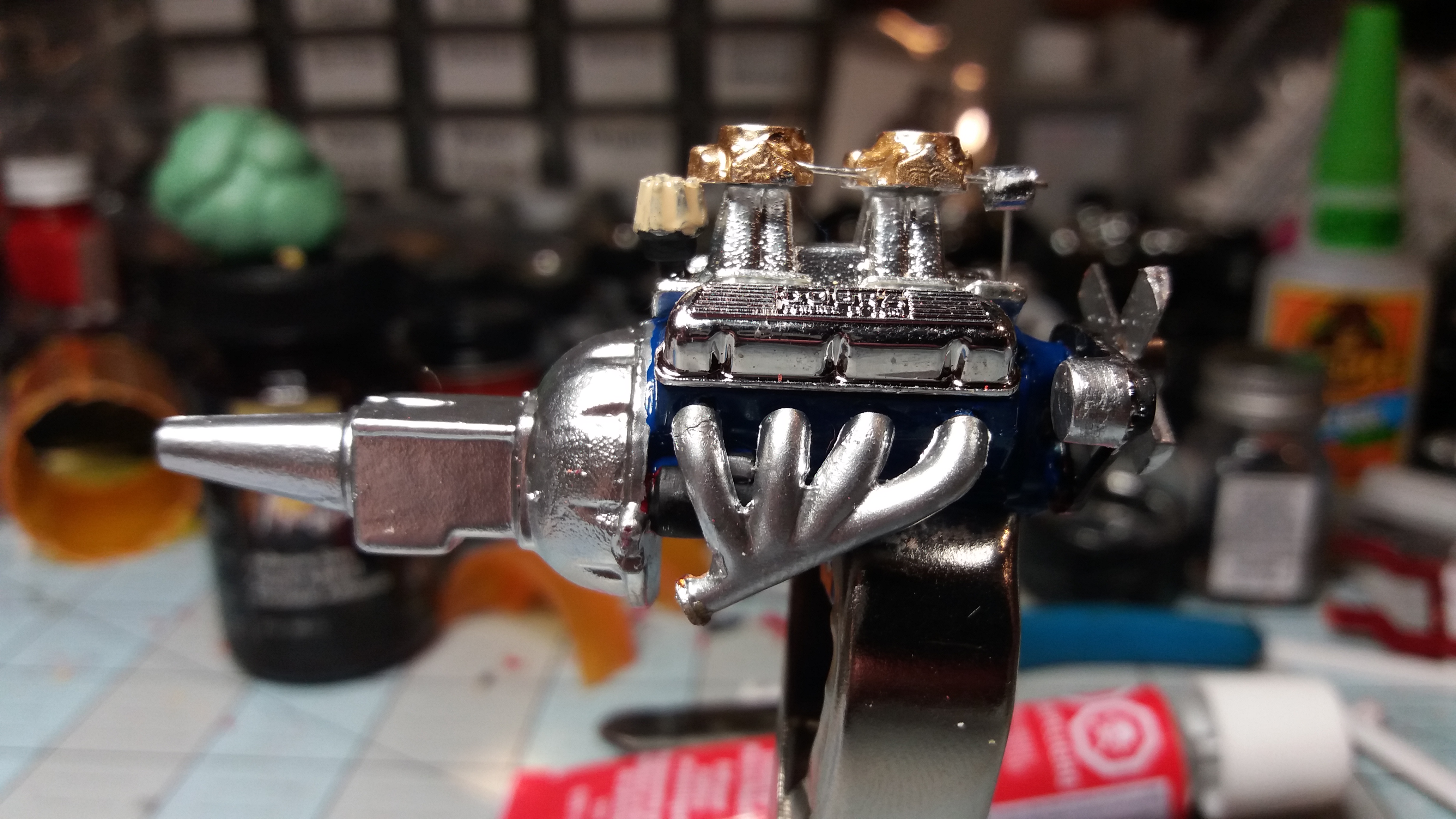

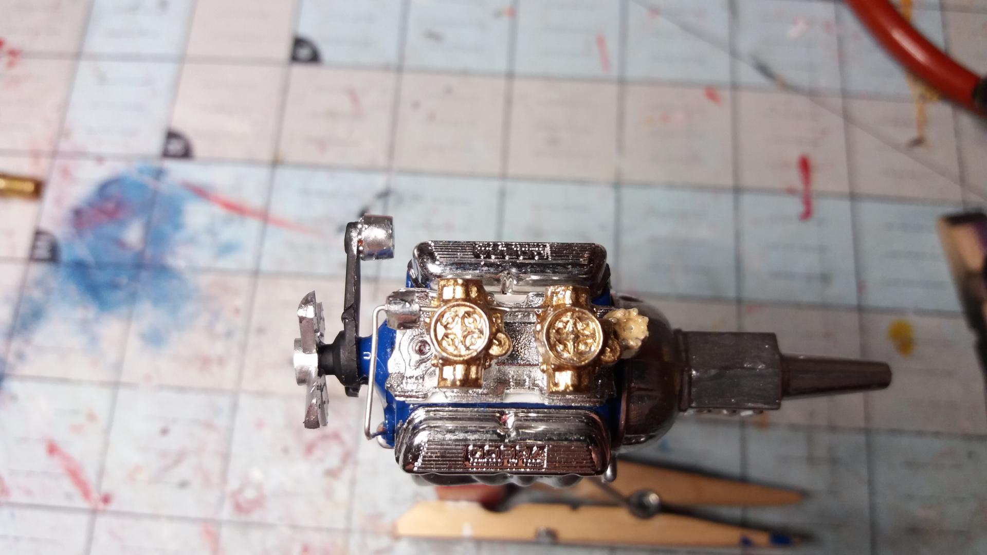

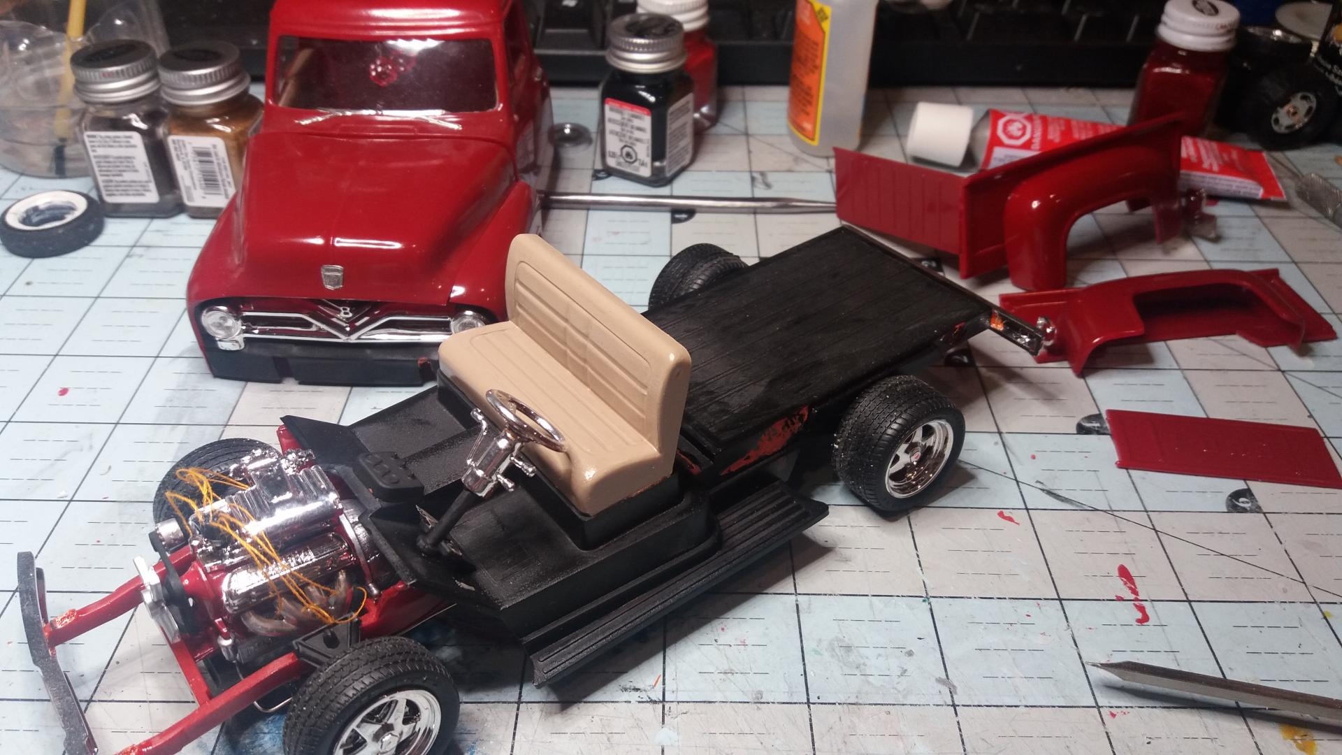

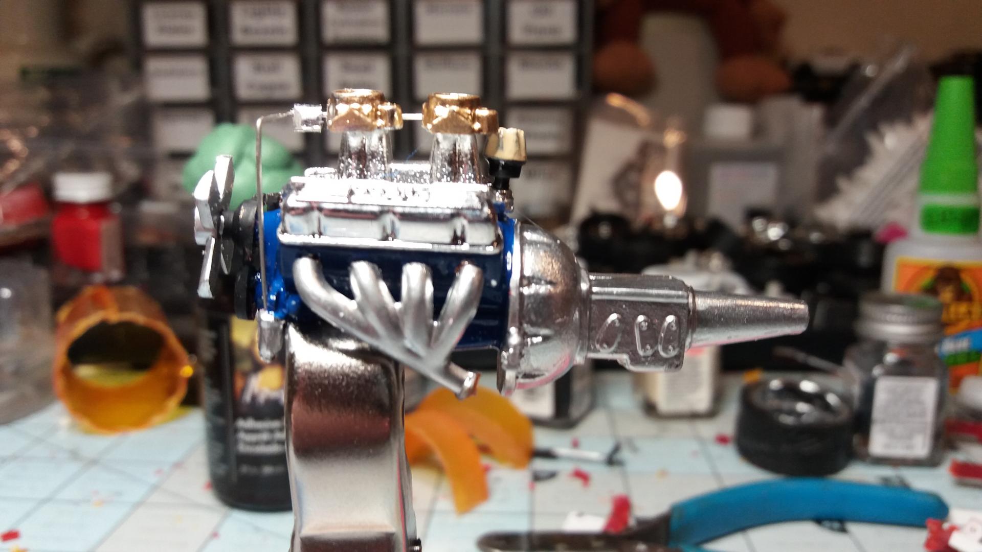

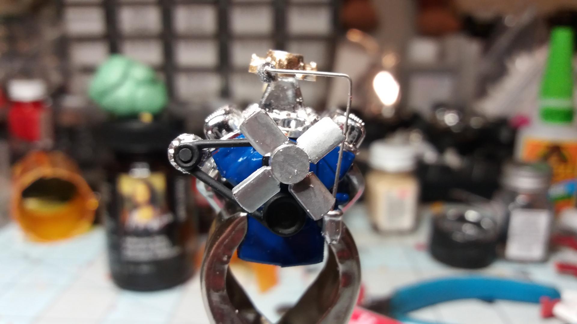

So far I've shaved off the badging, hood trim and the door handles from the body. The body is in the stripper now. Still working on the tubs. Freshened up the engine by adding input and output for the heater hoses and added a different intake and carbs. Added fuel line and a filter.

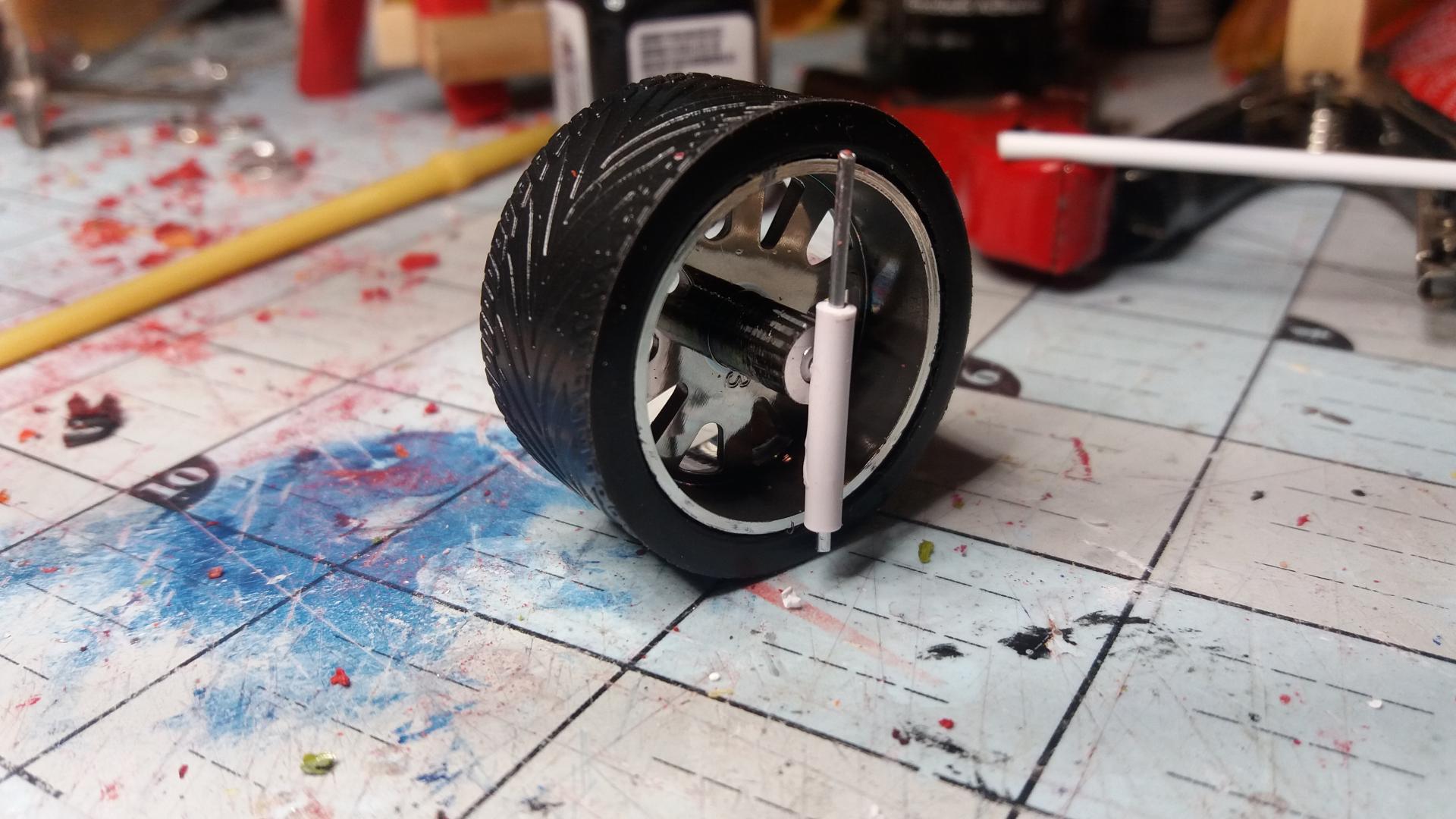

I've been beating my head against the wall trying to come up with a way to make the front wheels poseable. Not for this build but for all builds. Today, I came up with this...
20170710_085656.thumb.jpg.d079ea4f7c4c59

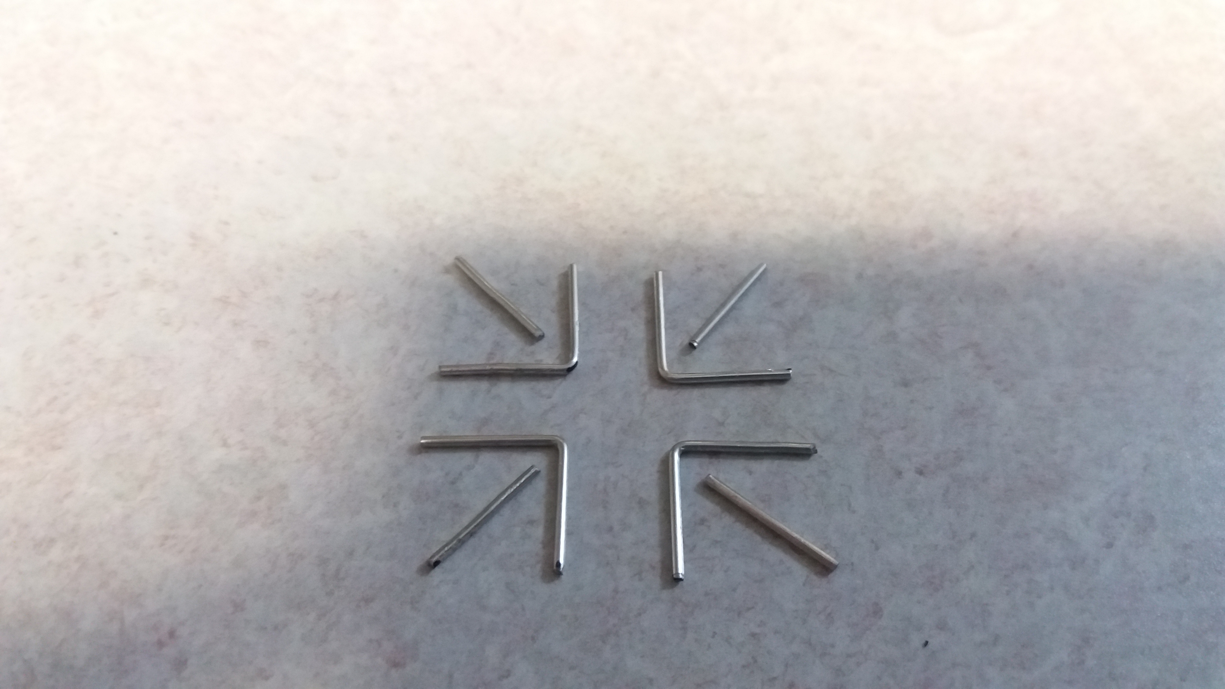

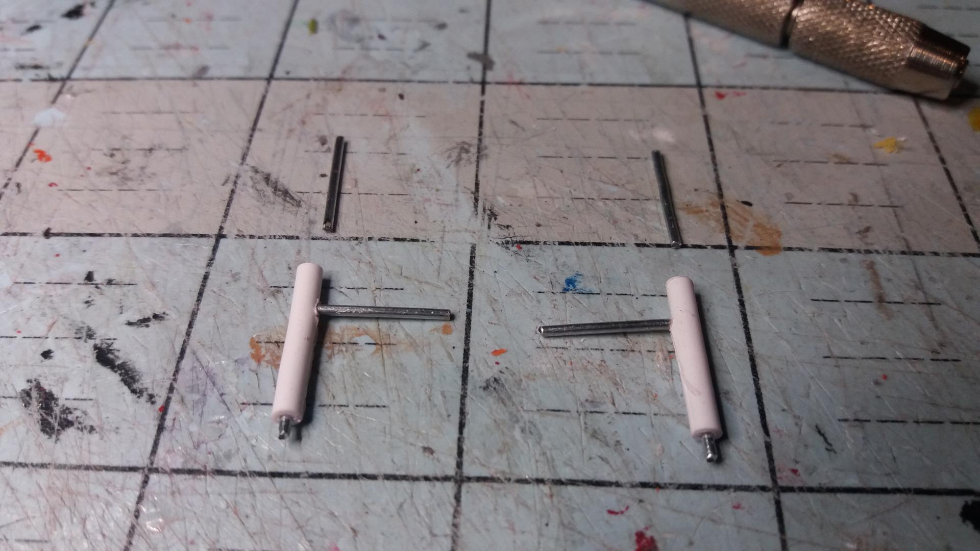

First I cut one paper clips in 8 pieces. 4 - .5" long and 4 - 1" long and bent these 90 degrees.
20170710_194006.thumb.jpg.71fc203a874d03

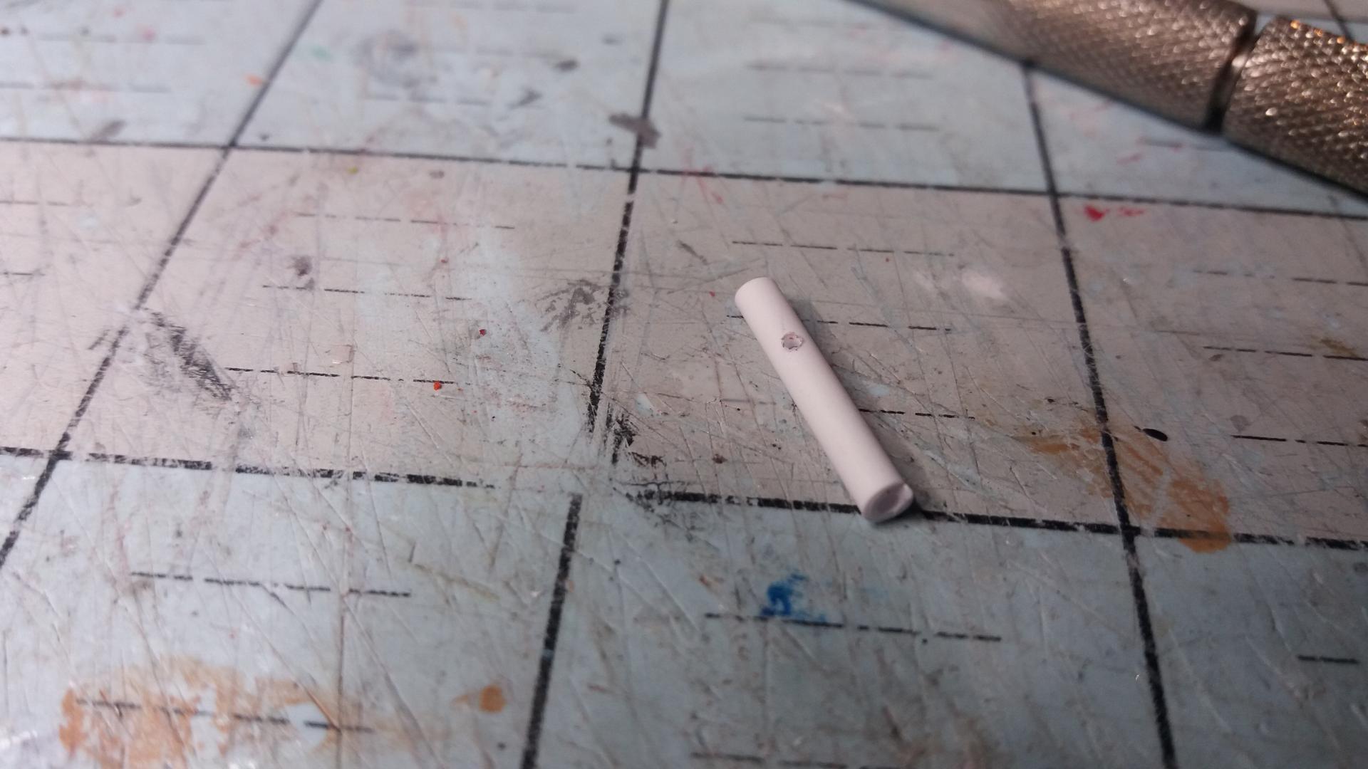

Then I cut some plastic tubing and drilled a hole in the side.
20170710_193946.thumb.jpg.40ee5bfc8faa3f
Then I inserted the 90 degree paper clip pieces inside the tubing. And saved the smaller .5" pieces for the top.
20170710_194232.thumb.jpg.e30ae76fe47cc8
This will allow the wheels to roll as well as pose. Next I'll work on the upper and lower control arms.

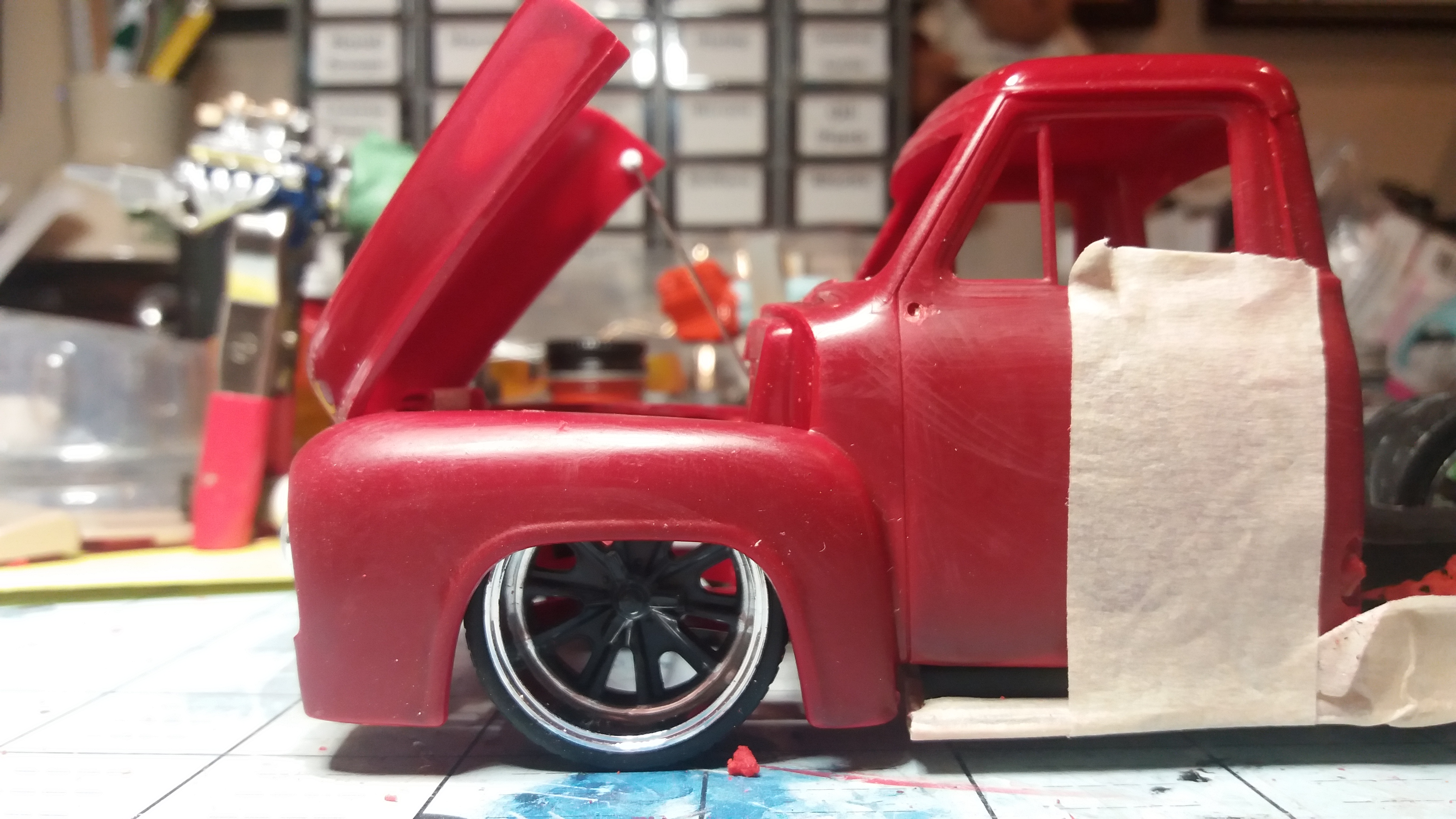

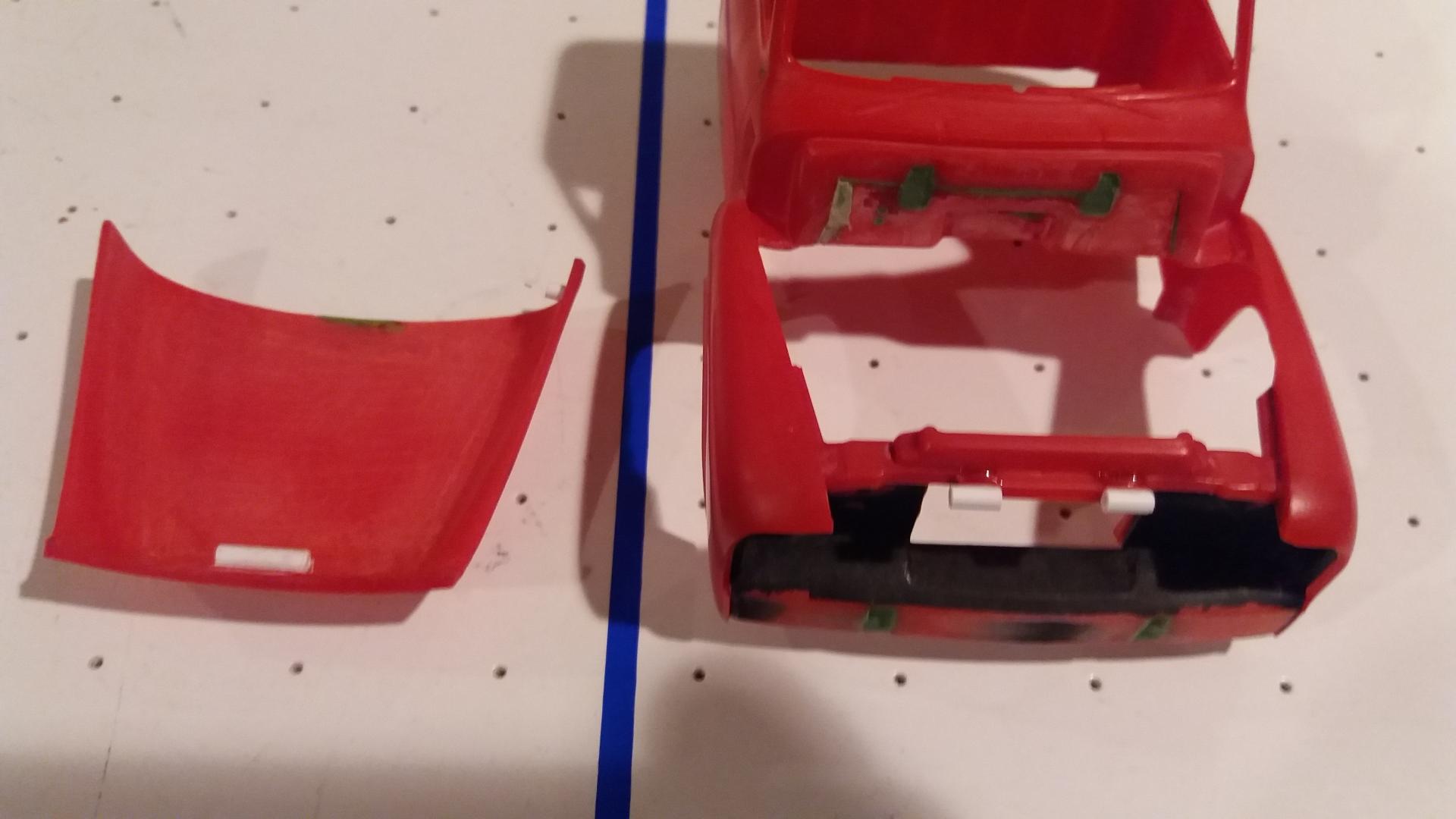

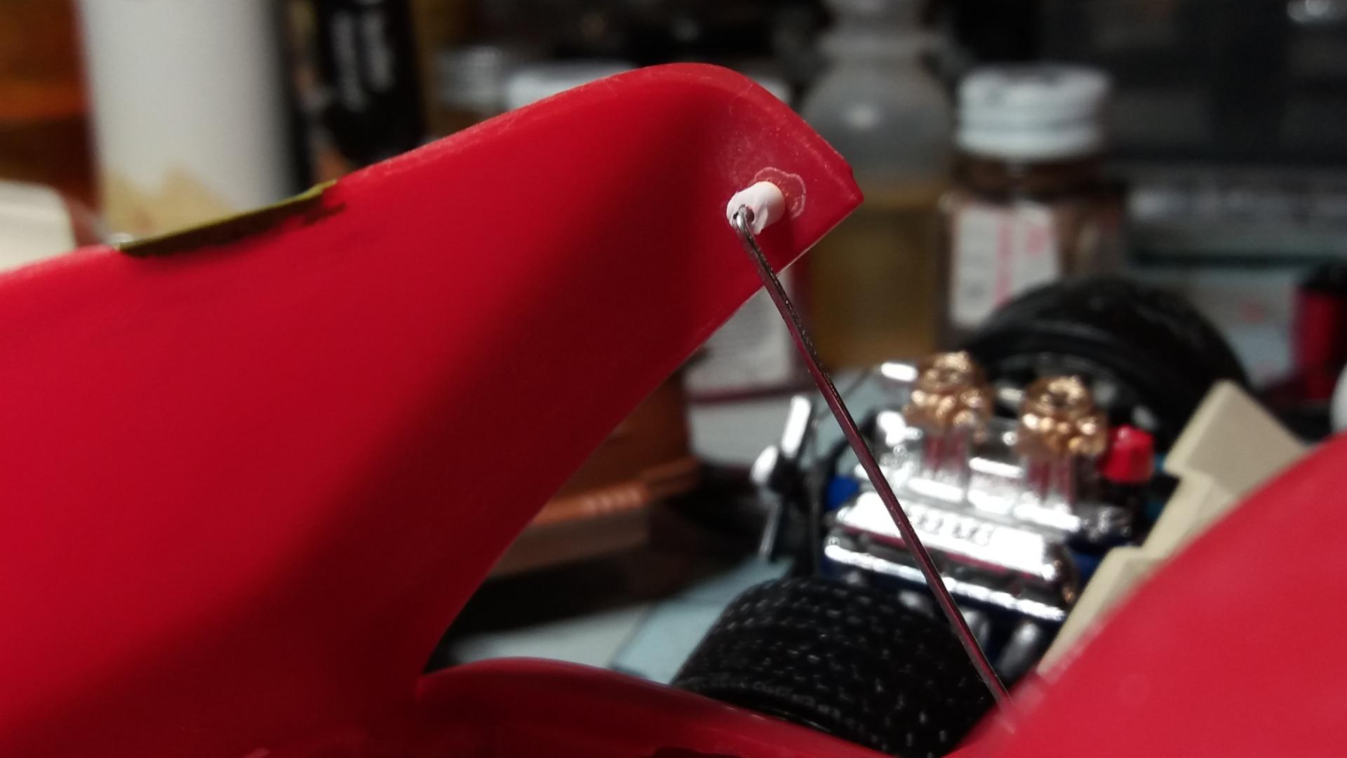

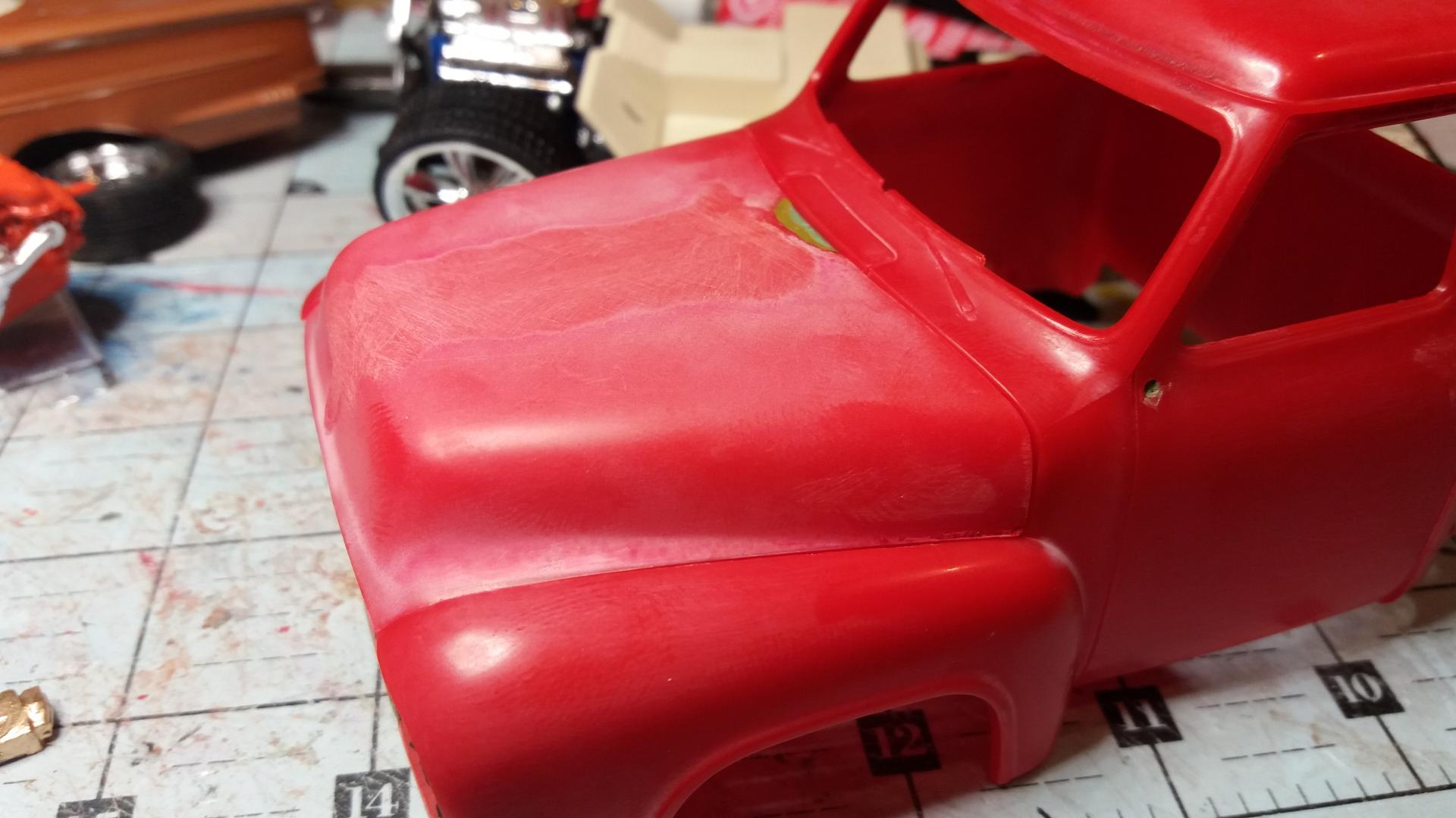

Still mocking things up and getting the front wheels situated. I started to think about the hood when I saw it wasn't sitting right on the body. It was warped. So I added  little flame to bend it back in shape. Sitting much better now. Then I wanted to get the hood to open backwards. So today I came up with a 4 piece hinge and in under 30 minutes it was installed along with a prop rod.
20170712_165951.thumb.jpg.fd52b66ab39d25
20170712_165937.thumb.jpg.0e7a7f12b5a2c8
20170712_170202.thumb.jpg.98c6e8509cd32a
20170712_170218.thumb.jpg.592509e2bbedfa
Next I'll be filling in the bumper slots. I want that smooth look. No bumpers on this piece.

Man those front tires are WIDE...are you sure they will be able to turn tucked up in there? BUT I LIKE it..
Share this post
Link to post
With those tires that close to both the inner fender wells and fenders there is not going to be much room for posing those huge wheels.

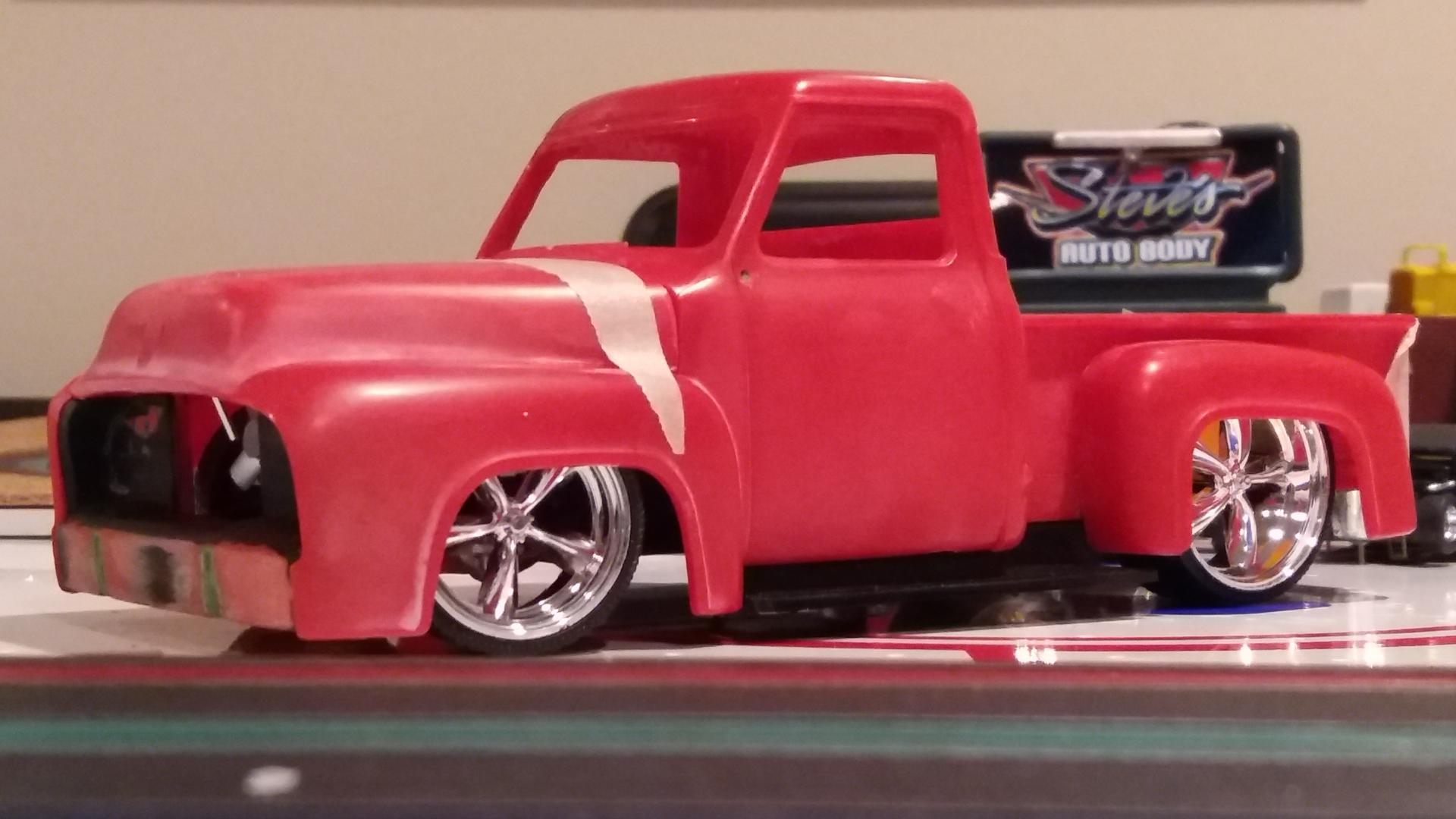

I like the mesh you added to the grill. Are you planning on front bumper or a roll pan ? The leading edge of the hood on this model always stood a little "proud". If you are thinking of changing it you might do something like the Foose truck but not quite as radical.

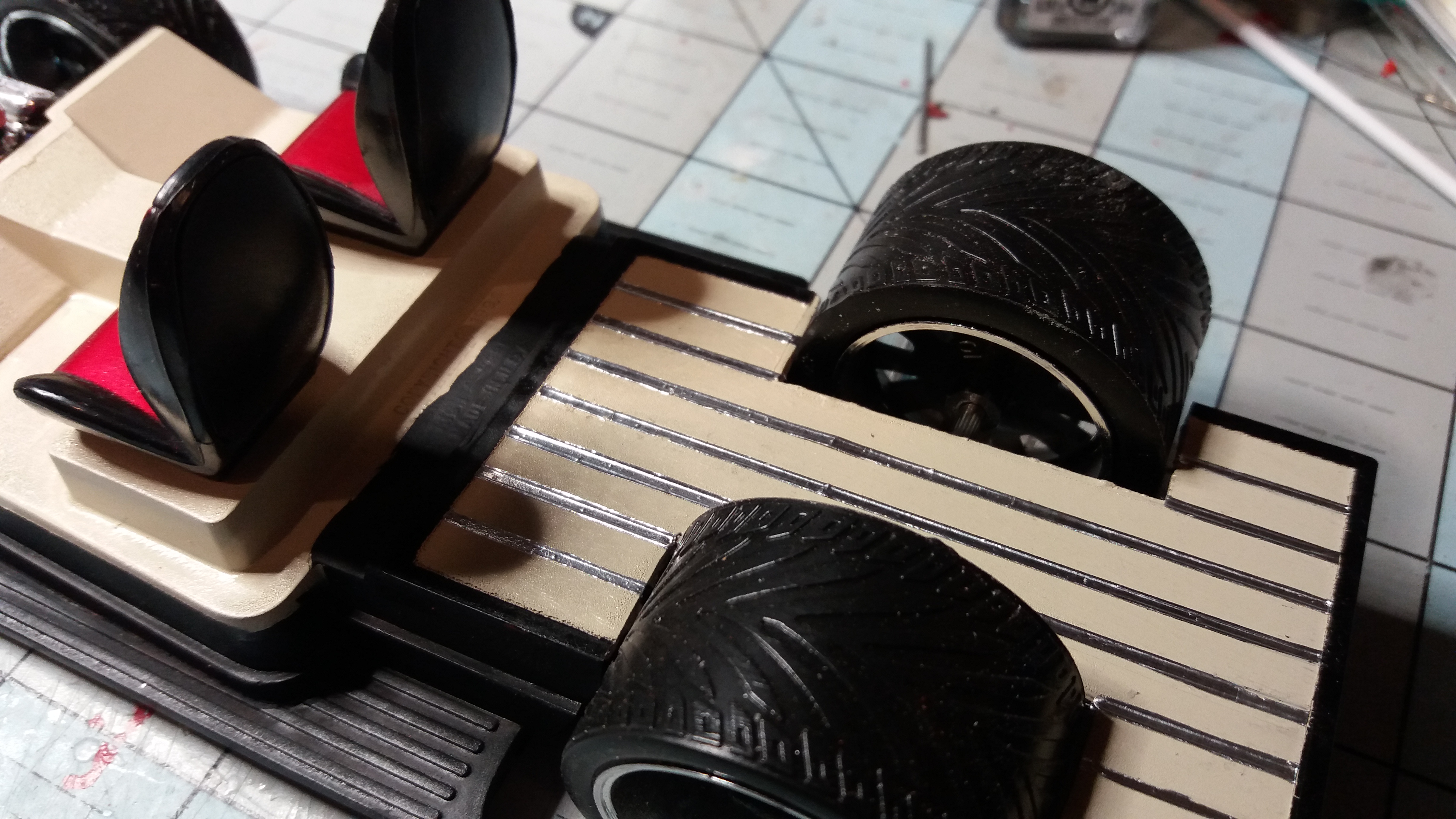

20170715_203130.thumb.jpg.53b643c76f2749
20170715_203140.thumb.jpg.c93e7c2468ff79

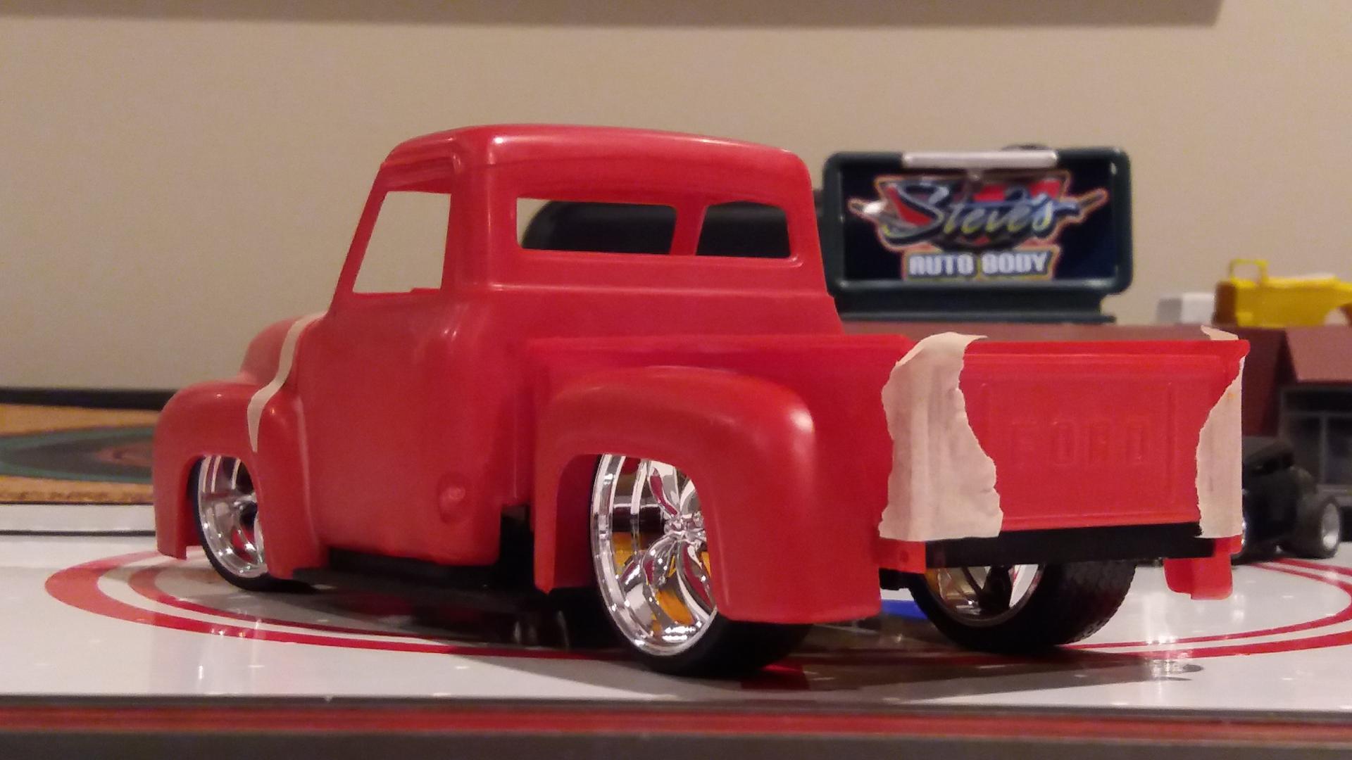

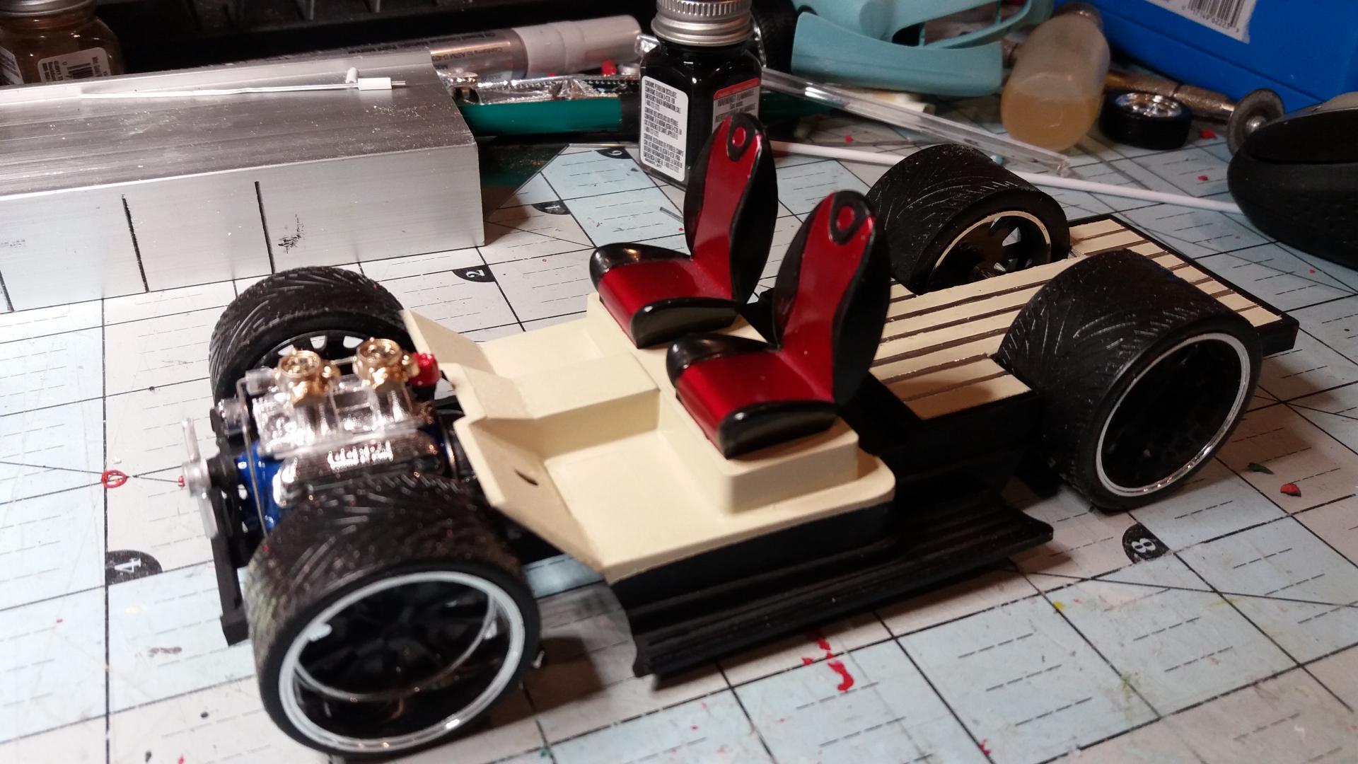

Taking care of some things on the body and the bed walls and tailgate are in the stripper.Should have them primered by tomorrow evening. Last few things on the chassis. I sprayed the bed the same color as the interior and used my home made BMF on the metal rails separating the simulated wood. These seats came from a die cast piece that kindly sacrificed it's life. The centers will be painted same as the interior.

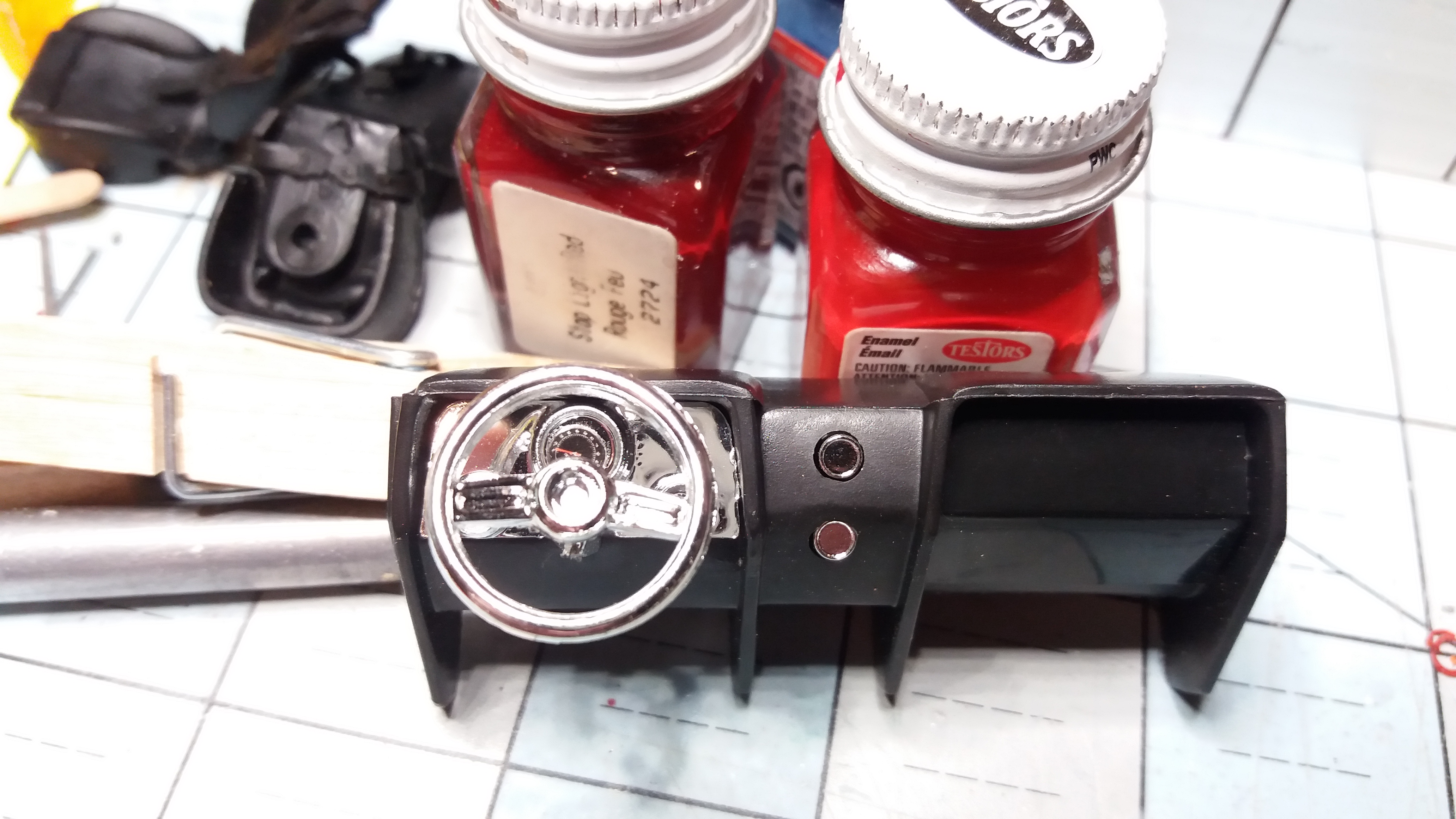

20170715_203253.thumb.jpg.203c54a9dc9c95
This is the dash I will be using. I plan on giving the steering wheel some attention. All of this came from another die cast doner.

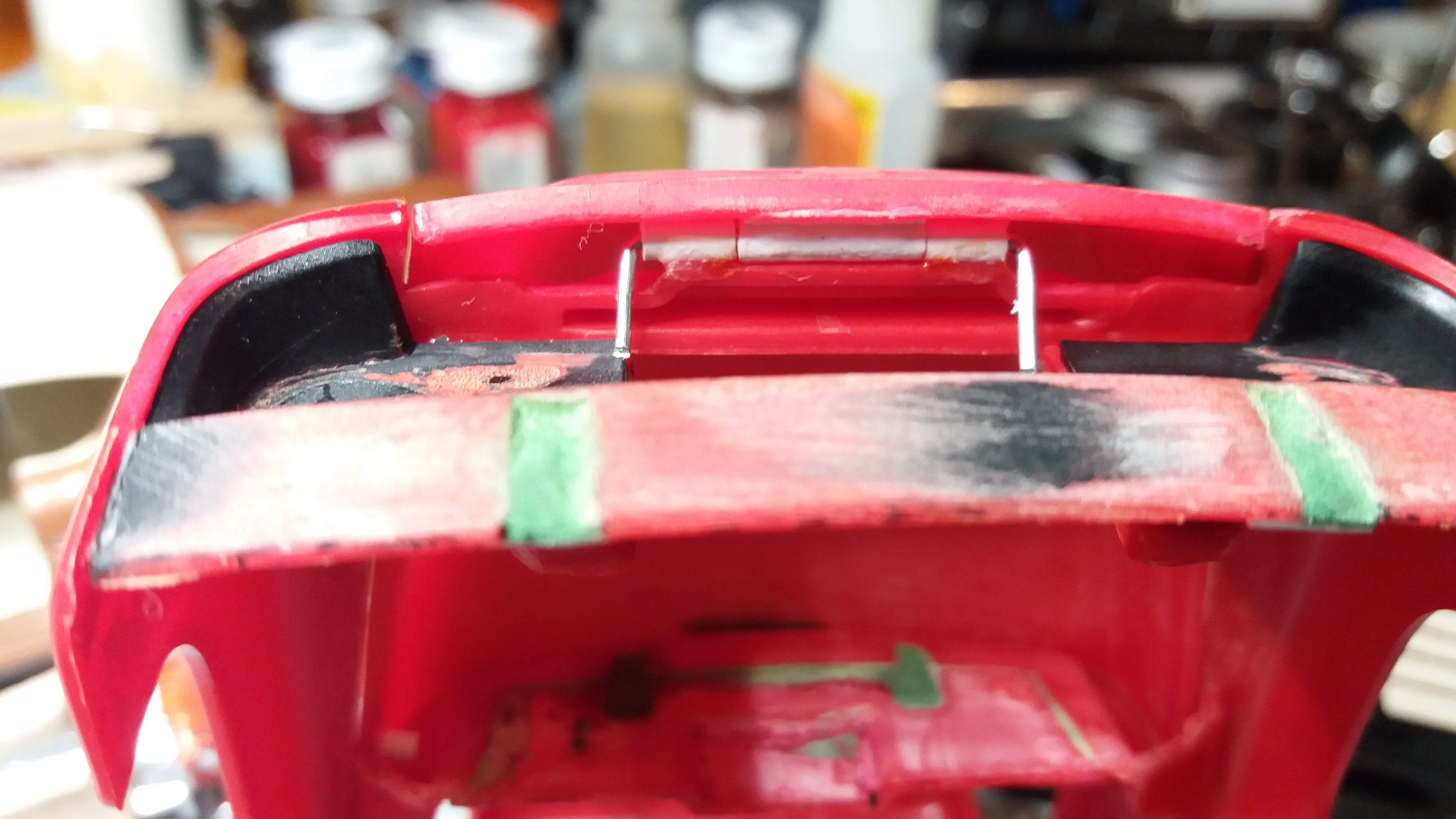

Could you post up some detail pics of how you made that hood hinge? i want to do that to one of mine but i cant figure it out. thanks!!
Share this post
Link to post

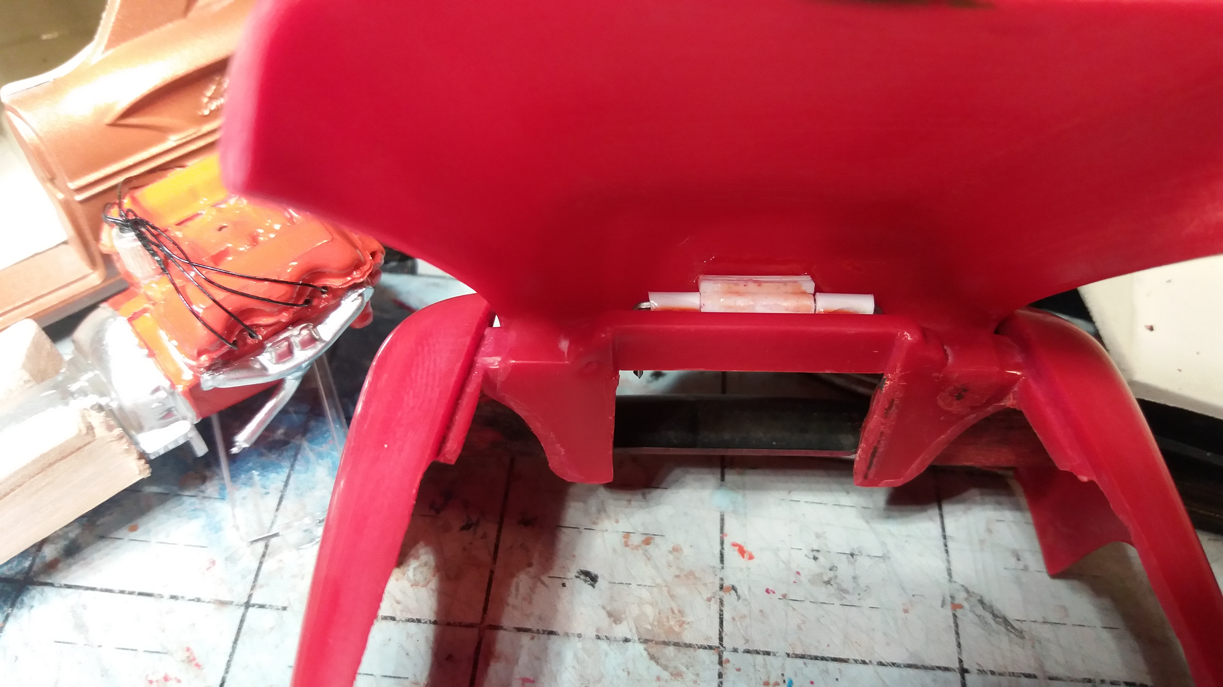

Hey Jeff, thanks for looking. I knew I wanted the hood to flip forward so the hinge point had to be in the front. I held the hood in place and looked at the car from the bottom side. The most logical place for me was at the top front side of the core support. I worked it back and forth as if it were opening and found my anchor points. First thing you'll want to do is make sure that your hood closes nice and flat. Mine didn't so I had to heat it up a little and encourage it back into place. Once your hood is fitting nicely, tape it down so it doesn't move. If if moves before you're done, you're hosed. Next I took a piece of plastic tubing and a straightened paper clip (they should go together kind of snug or the whole think will open quite sloppy). I took the plastic tubing and cut it into 3 pieces. The 2 smaller pieces I anchored to the core support and the bigger piece I anchored to the hood. When I mounted them I did it as one assembly so you'll have to put the pieces together then bond them to the model.
20170717_180525.thumb.jpg.a8f0b3500160f3
Shown above is 2 bent paper clips to hold it all together. This is because I plan to take off the hood many times before I'm done with the build. And I will be painting the hood and body separately.
20170717_180542.thumb.jpg.fb0177d77bc335

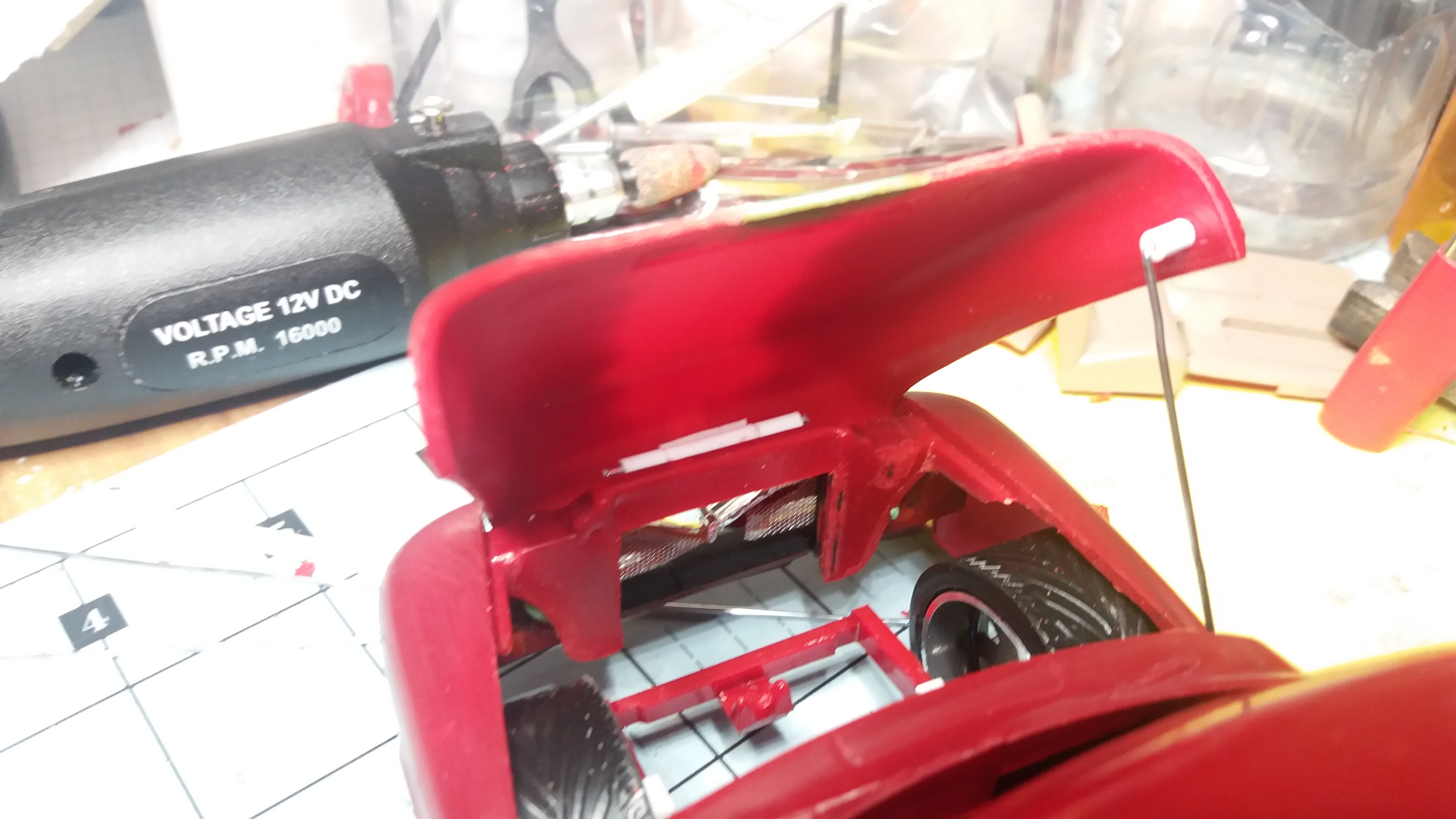

This is a shot of the hood open and you can see how I mounted things.
20170717_180725.thumb.jpg.79a3461991e950

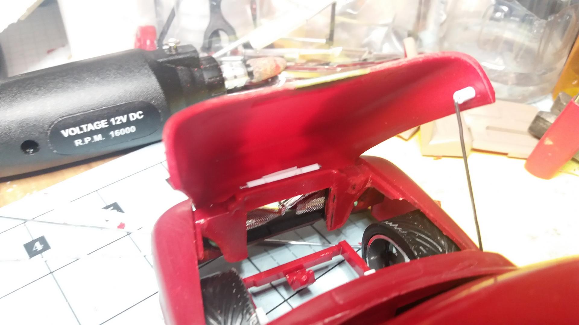

The prop rod was a last minute thing I came up with. Pretty self explanatory.
When you're done, it should look like this...
20170717_191420.thumb.jpg.39d21a18e1f278
20170717_180825.thumb.jpg.7c562ad11e4a73
Hope this helps...

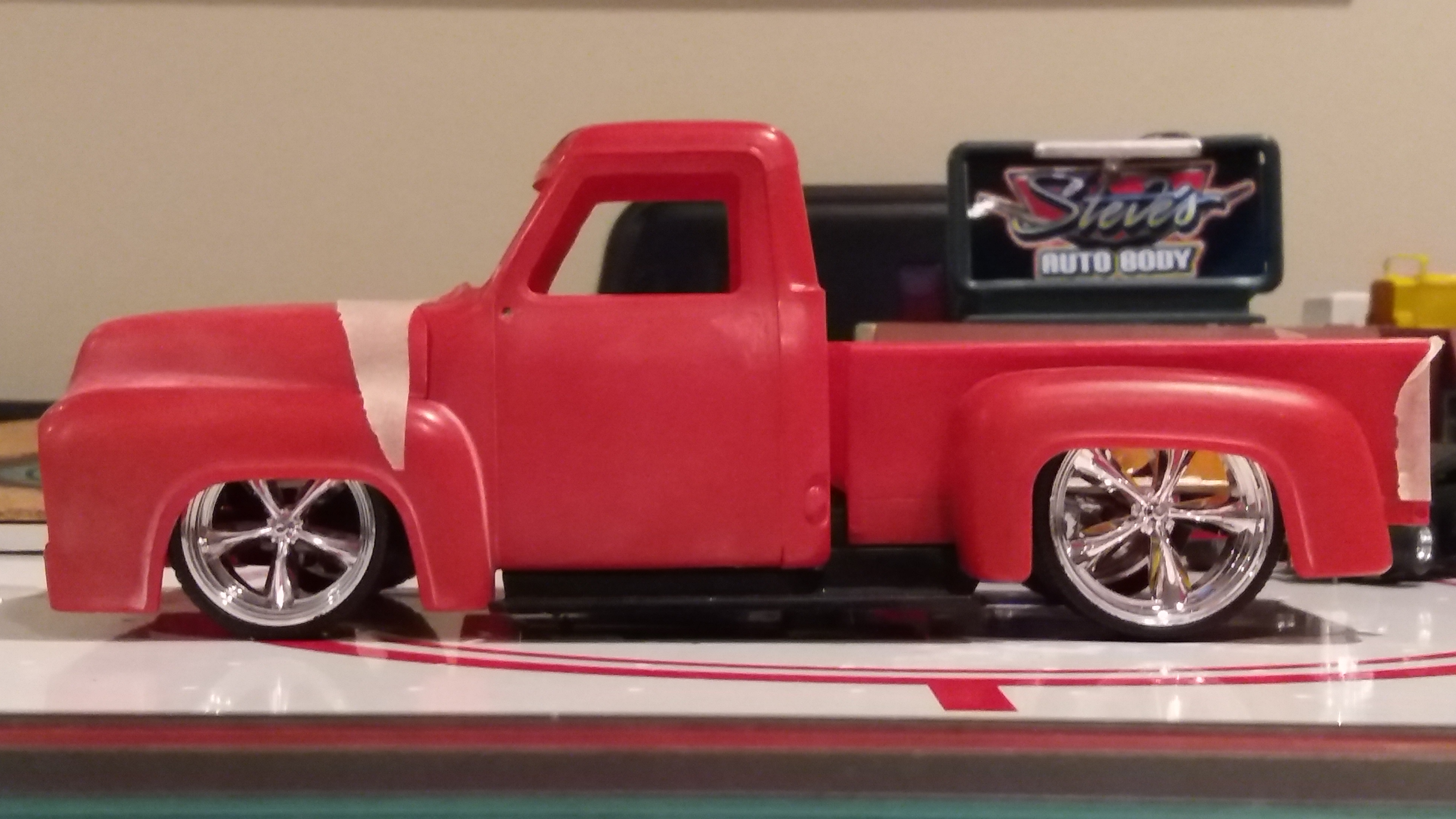

Major breakthru! I did a wheel swap to something just a little bit smaller. These wheels came from 2 different Jada toys. The cool thing is they match. Now I can get the fronts to pose.
Stay Tuned...

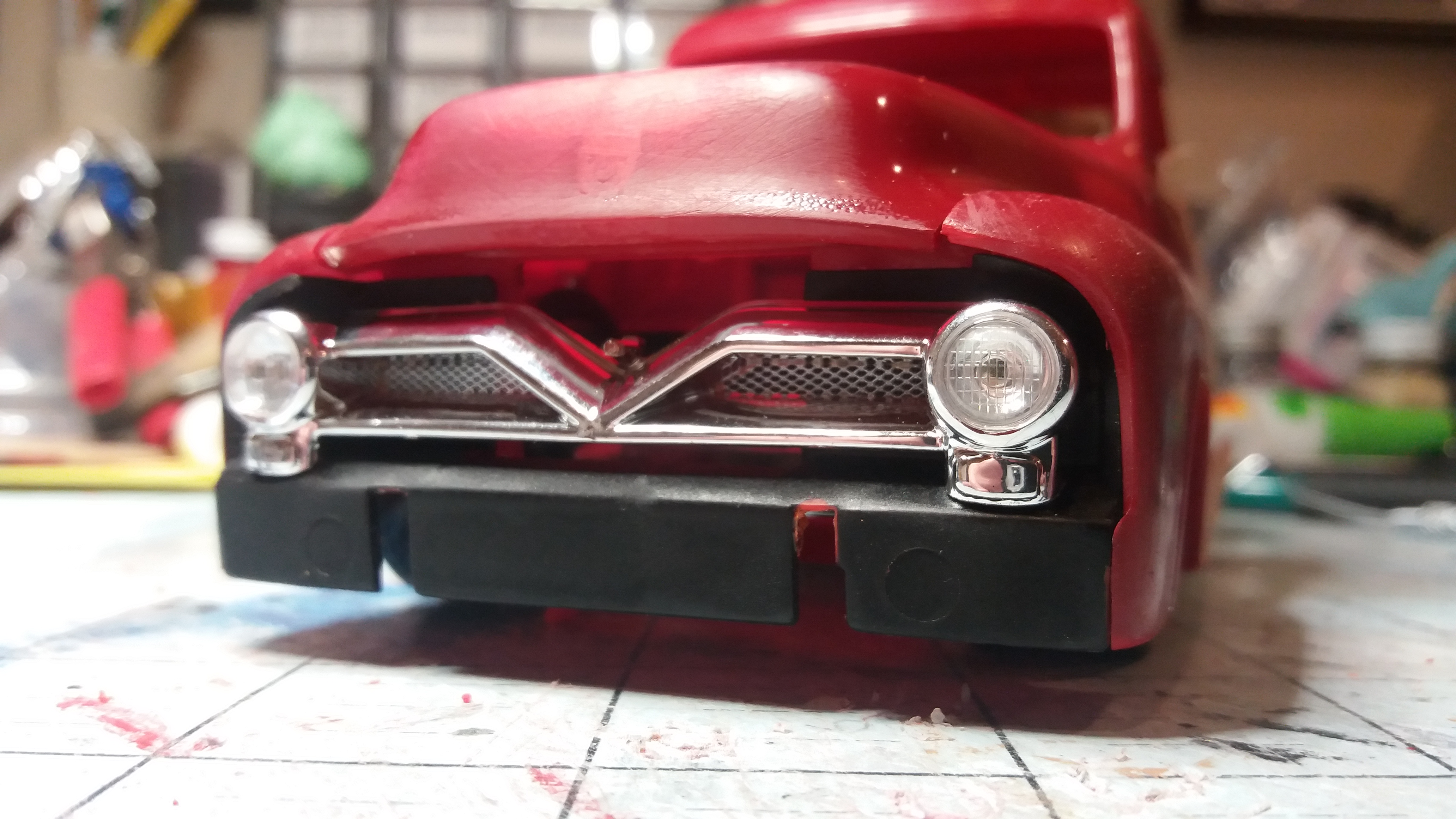

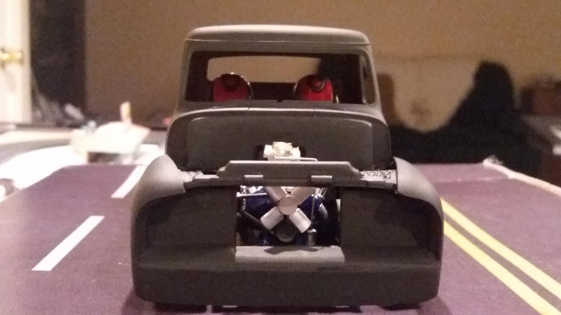

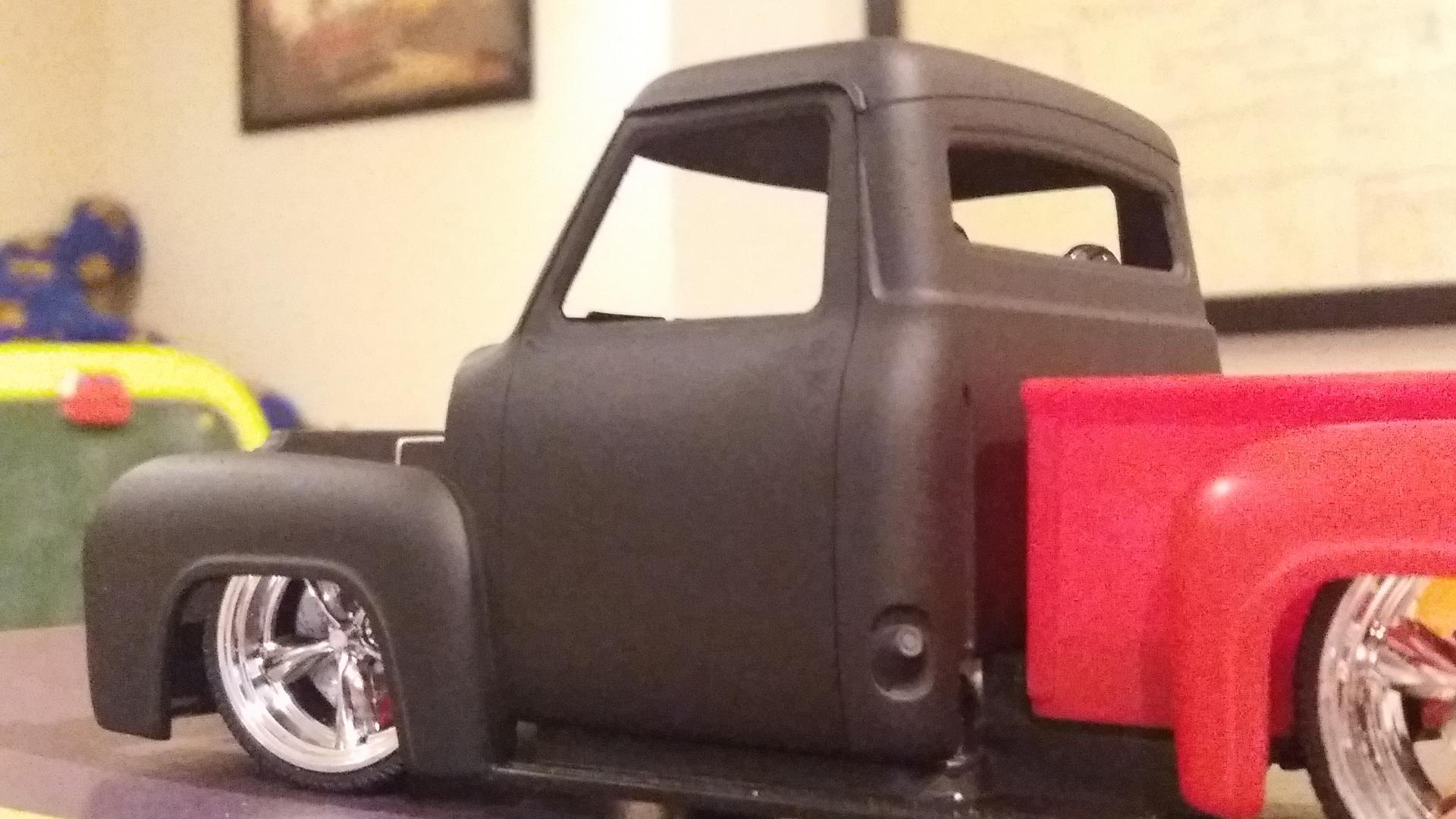

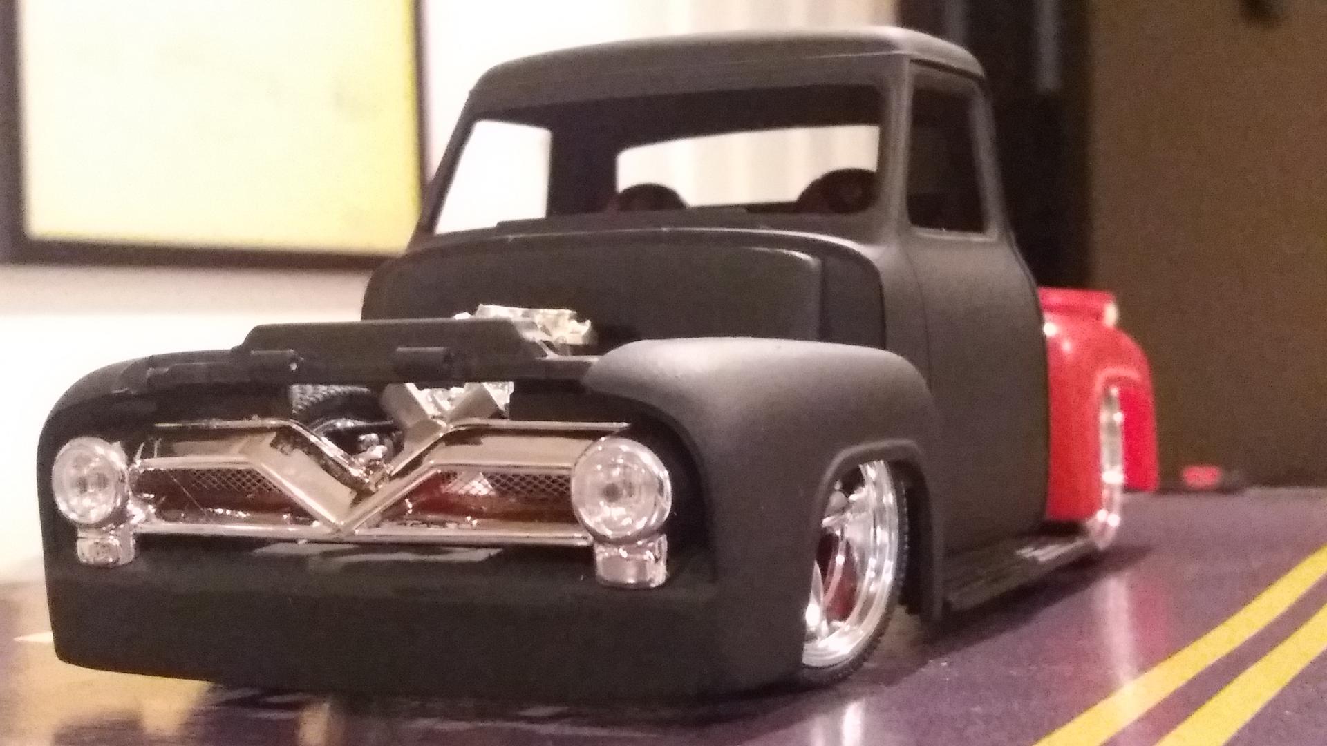

Mini update. I removed the wing windows, smoothed out the firewall, filled in the front bumper slots and shot a coat of black primer. I'm glad I switched out the wheels. I love chrome!

I ran into a little problem with the top coat. I was sanding down the cab to remove some orange peel and burned right thru the finish. I stripped it down and reshot it this time with Tamaya. The top coat on the wheel tubs began to peel using the same black Toyota Duplicolor paint so I stripped this too and reshot with Tamaya.

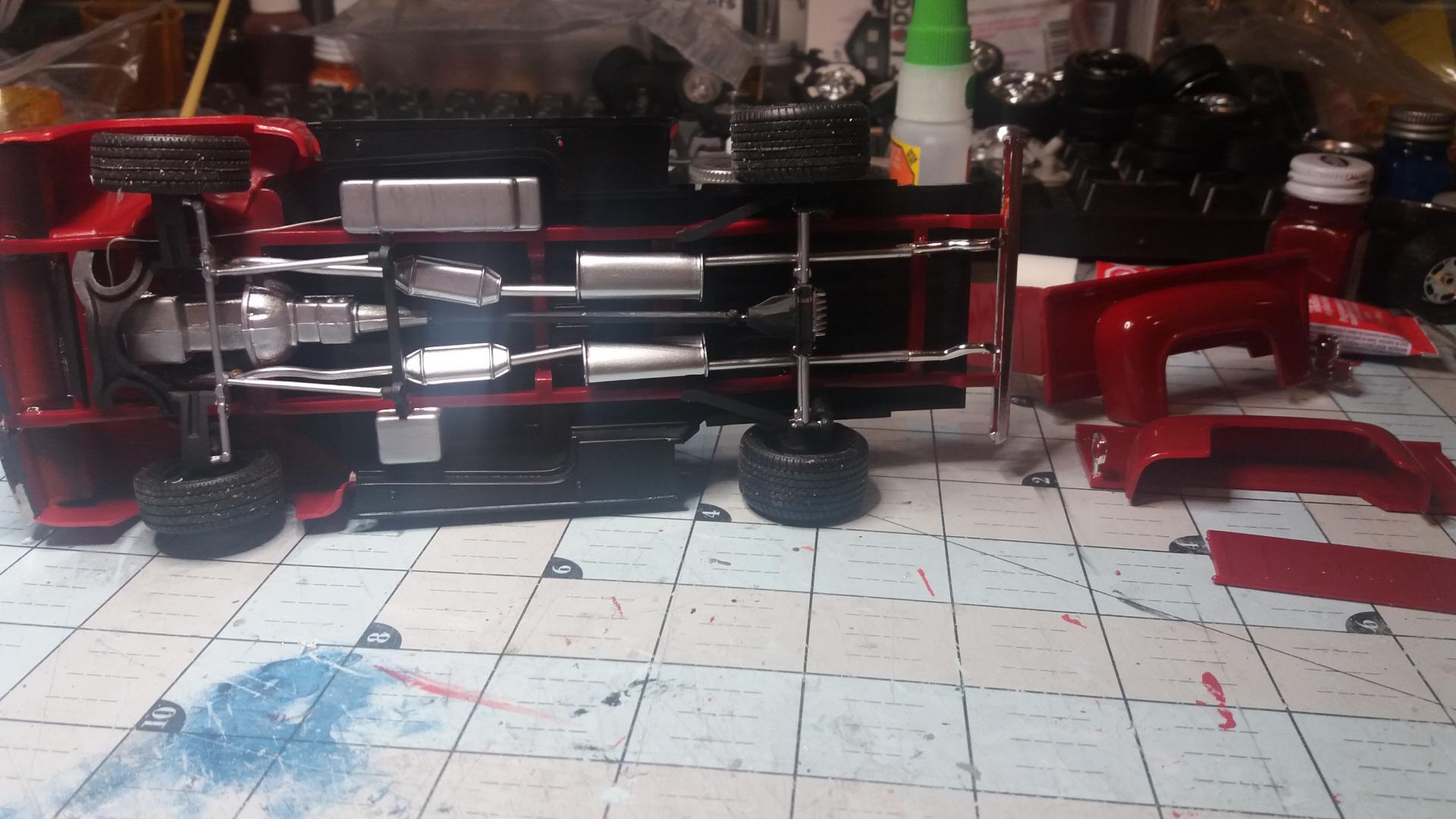

Only thing left to do is the rear suspension and run in the exhaust.
