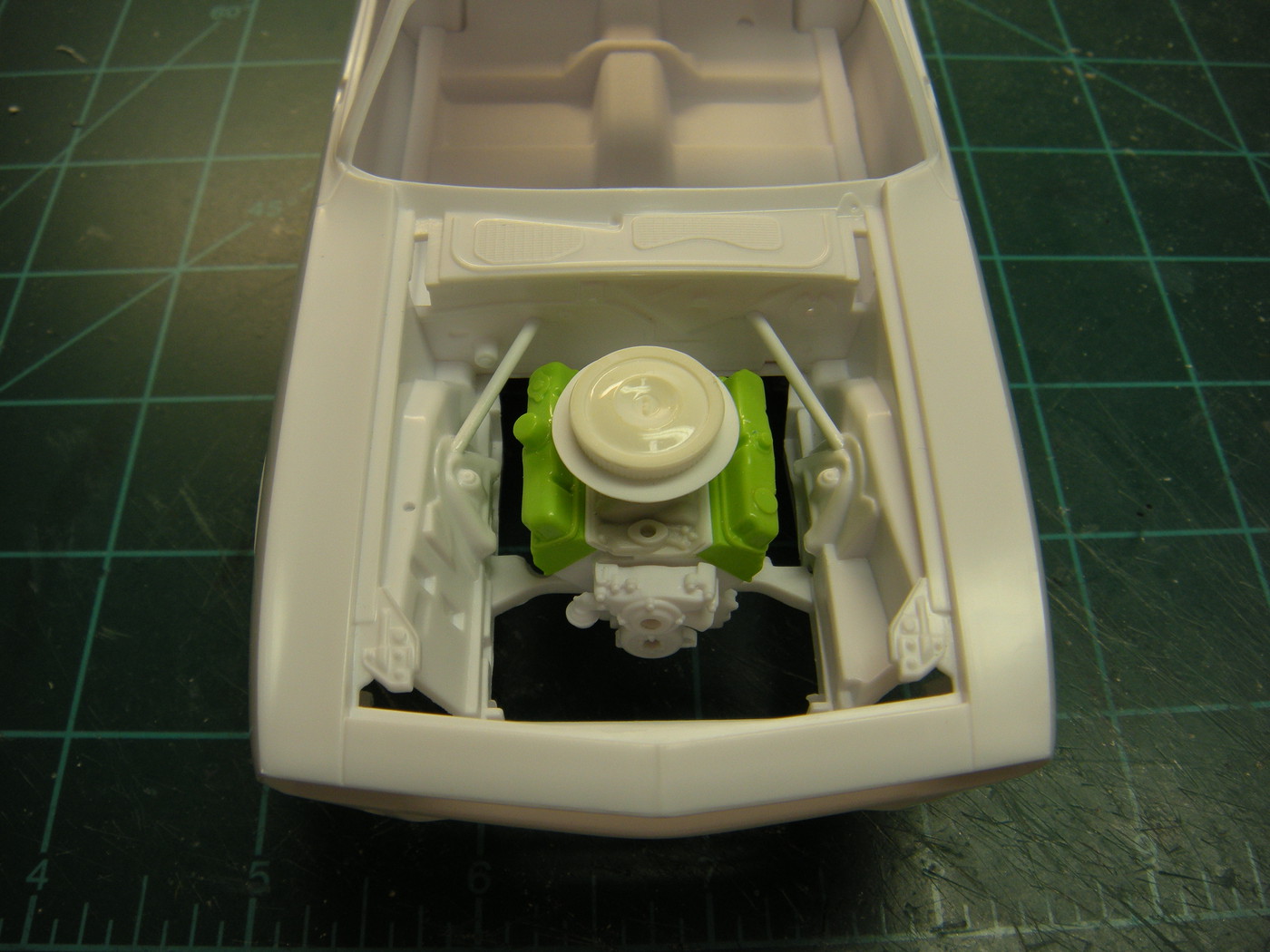

I’m in a trans-am mood so I’ll take a whack at converting the Revell kit into a road racer.
The hood is from the 1:24 scale Monogram AAR Cuda kit modified to fit.
DSCN4697
The head and valve covers are also from the AAR kit, intake manifold comes from the AMT 340 Duster, carb is a resin Holley.  The block is the 426 from the base kit used to hopefully avoid fit issues down the road.
DSCN4712
The kicker bars are .062 rod. I removed the water outlet from the top of the timing cover. The air cleaner is from the Revell '66 Mustang with the sealer flange cut from .015 flat stock.
DSCN4715

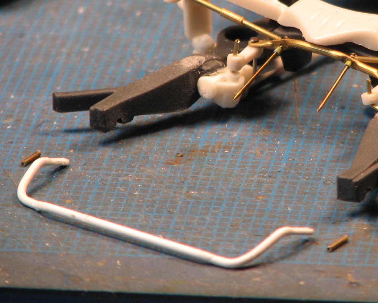

Took some pretty fancy pipe bending to get the headers to fit around the steering box!

Any tips on bending plastic rod JC?
Share this post
Link to post
Buy extra and practice.:D
I use solid rod Shay in lieu of hollow tubing.  I bend the rod either with my fingers or round needle nose pliers.  Once I am happy with the shape I heat the bent area over a candle flame to relieve stress in the material and set the curve.

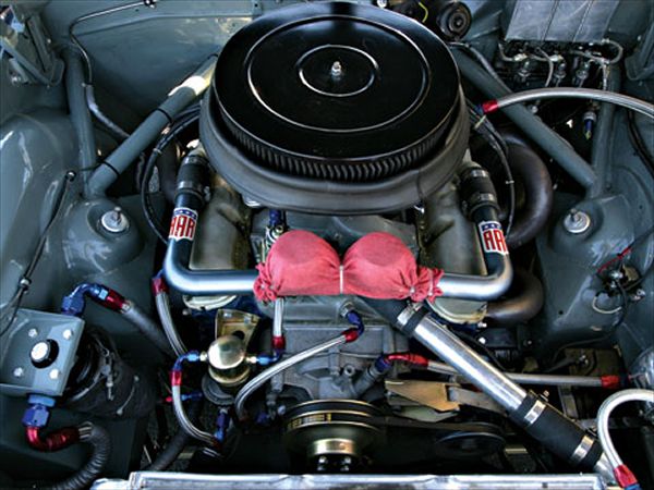

I'm displaying my ignorance here, but what are the two chrome wotsits ahead of the air cleaner, and what kind of plumbing are they sitting  on?
There's a place in England that sells bendable styrene rod. In the U.S., Midwest used to market it as "Super Styrene". Alas, it is no longer available here, as far as my research has led me. I ended up buying it here:
http://www.cornwallmodelboats.co.uk/acatalog/raboesch-styrene-profiles-1000mm.html
You can bend this by hand. It works great for headers, roll bars, sway bars, etc. I used it to make the sway bar for my Malibu. I've used it in other applications, too, and I love it so much I actually ordered some from the U.K., when I began to run low.
Share this post
Link to post
Thanks for the suggestion Daniel.  Does the rod have a metal core?  I have some metal core styrene rod IIRC was made by Evergreen.
