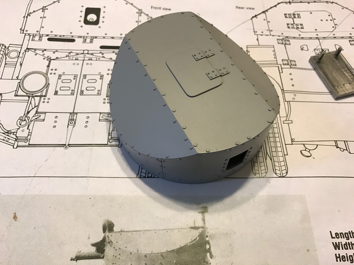

I'm looking for info on the chassis and drivetrain for a scratchbuilding project of the 1914/1920 Rolls-Royce Armored Car. It is pretty much just a rebodied Silver Ghost.
My main source for plans for this build is an article in the September 1989 Fine Scale Modeler. The article was about building one in 1/24 scale and used the old Heller 4.5 liter Blower Bentley as a chassis and drivetrain donor. I would rather have Silver Ghost reference info. The Silver Ghost chassis was also used for armored car tenders (resupply vehicles) and at least one military ambulance. A cool diorama would be a soldier being evacuated during resupply, and another soldier taking a picture three different Rolls-Royce military vehicles.
Just getting started on the project. Turret is pretty much done. I had a cowl section and hood, but the geometry was not right so they didn't make the cut. It's in 1/12 scale, BTW.

My turret is 6 layers of .030" Evergreen styrene wrapped around a 3" PVC pipe coupling. The coupling was not a straight cylinder. It was slightly bowed out at the top and bottom. It took a couple of hours with files and sandpaper to make it straight. It is thick as heck, but for me it was a way to get the right O.D. in a (relatively) short amount of time/minimal cash outlay. (I'm a plumber. I had the PVC part in my van)

I came across a plan view of a Vickers online, and a length, so I just worked out all the dimensions from that.  The Vickers is basically a box with a cylinder attached, and all the details were all boxes and cylinders, so it was just a matter of puying the right styrene stock, cutting it up, and sticking it all together.
The body and turret are .5mm styrene, which is almost the perfect scale thickness for the armour at 1/16.  I tried to follow the construction of the original wherever possible, since everything was going to be pretty visible at that scale.  I  have a 3D modelling program to work out a pattern for the turret armour plates.  I glued them together  in a ring, and I cut an internal ring of thicker styrene to hold it in a circular shape.  For the body, I took measurements off a plan I found in a WWI armour modelling website, scaled them to 1/16 in Photoshop, and measured and cut from those.  Those plans were for a 1920s vintage AC. and since then, I've found some better references of WWI vintage ACs, including photos of what is possibly the only surviving WWI vintage Rolls AC, so I want to redo the body.
