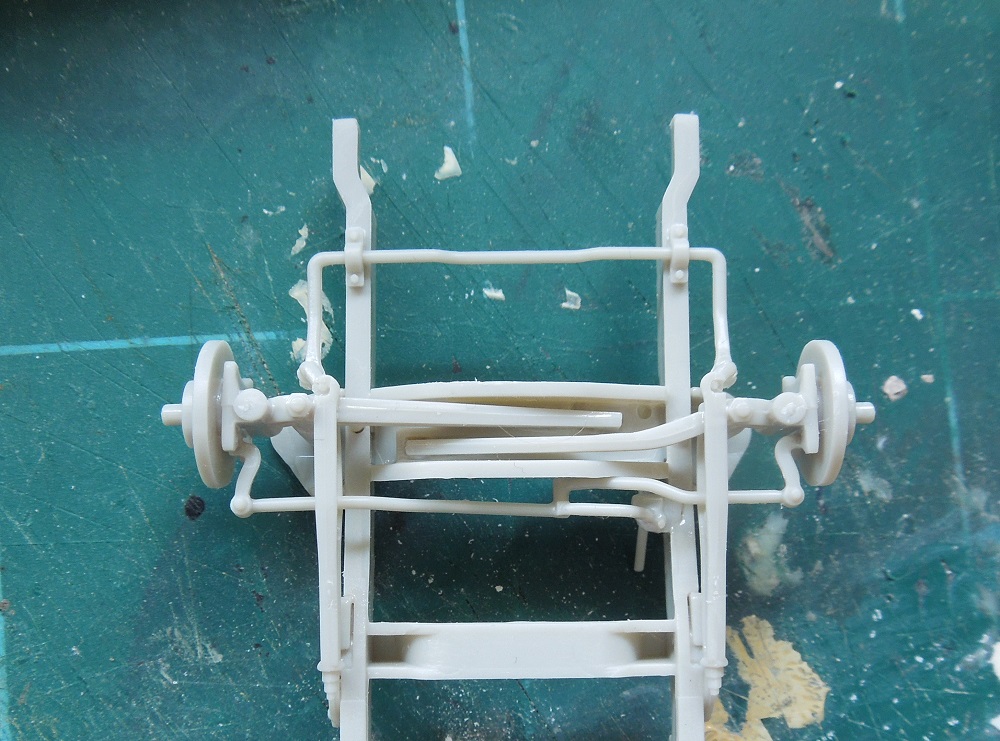

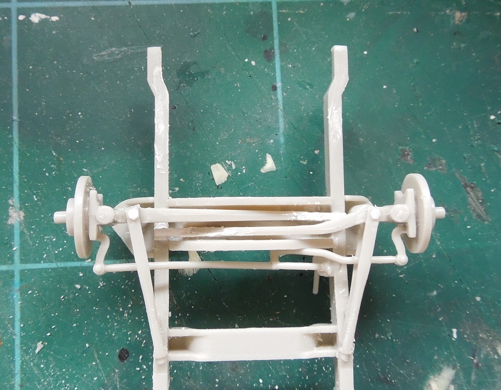

Aside from those problems, the chassis and FE engines appear to be mostly cribbed from the '70s AMT pickups.  The front suspension attachment is completely wrong, having the radius arms mounted outside the frame rather than underneath, and the twin axle beams are far too short - they should also mount under the frame rails, not part way along the cross member.  I reworked mine to look more a bit more prototypical.  I could have done more - that huge kink in the driver's side beam is still wrong, but by that point I was questioning why I was spending so much time on this...

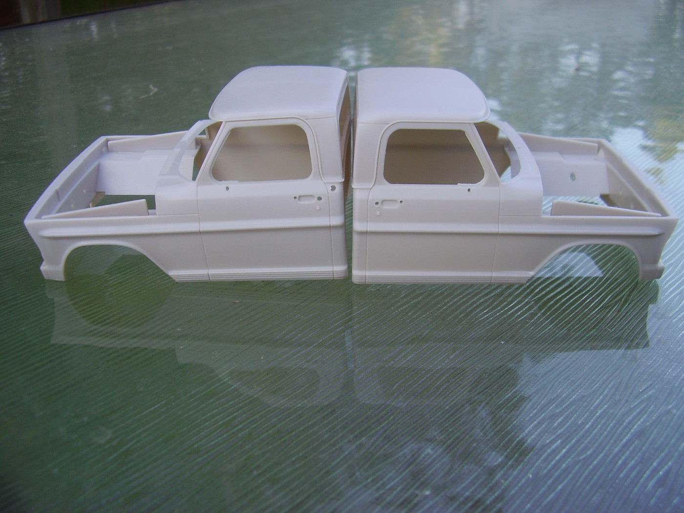

This afternoon I took a few rough measurements from my 1:1 truck and attempted to attach them to a picture I found. I'm hoping this will be a help to those interested in attempting to correct some of the roof/window shape issues on these scale truck cabs. Unfortunately, some of this involves serious reshaping skills and may not be for everyone.
70f1flrsd
Correcting the window opening will involve removing the rear half of the rain gutter, tightening the upper radius and adding material to the forward edge of the back of the window opening, rescribing the door opening line and adding new rain gutter- without the curved bottom. The horizontal line at the top of the C pillar measures 9" from rear to door opening.
After doing some measuring on a '78 F100 1:1 that recently followed me home, it's obvious that amt wanted their cab to be right. Aside from the upper windshield trim, the majority of dimensions are spot on. A nice piece of work.
Those familiar with these trucks are aware that differences between the 67-72 and 73-79 cabs are mainly cosmetic; ie  reshaped, simplified roof, back window and doors, two inches added to the cab length below belt line behind doors, dash. The basic superstructure is carried over, including roof size and crown. I pulled very close to the same general roof area measurements from both my '68 and the '78.
75xltstbxfrd
Turns out that the '67-'72 C pillars, behind the door windows, actually slope inward from behind the vertical rain gutters toward the back window. This makes the rear side to side measurement on the back of the moeb cab almost five inches too wide :blink:   Now we're entering the realm of back window size issues as well. The rear window area is both too short and too wide. Interestingly, the upper rear of the original amt cab is very close to the correct width but of course lacks the fancy sculpting around the window.
68f1shrtbx
...And we haven't even addressed the lack of roof crown yet  :P
Intriguing that all this was missed in development. Some serious issues and disappointment with a recent 'new technology' tool, but please note this information is not being shared to elicit negative comments or as an attack on persons or motives. Strictly commentary on how to correct or improve a product if one so desires.
More to follow...

Good thoughts on the roof crown, Bill. I'm coming at it from another angle...
Turns out the roof on the new kits is not only out of kilter by crown, rear window width and C-pillar shape, it is also too long front to back. The front overhang projects about 2mm too far forward. One other thing to note is that on the 1:1 trucks the cowl accent lines are exactly the same distance apart from '67-'79 but the new cab has them spaced wider (incorrectly). This in turn shows that the new hood body lines are molded wrong. It's far too much trouble to correct the hood so if you use the more correct amt cowl grill area, you'll just want to section it into the area between the new cab's cowl accent lines.
P1019221
Some rough lines indicating where cuts may take place on mine; changes may happen as project progresses. Vertical lines on back of cab show what actual width of rear roof should be. This window area will be cut out and sectioned to match rear of amt cab roof. Rear of side window opening will be grafted into amt c-pillar with appropriate revisions for accuracy. I've tried to give a general guide for revisions here; you may want to doublecheck measurements on a local truck for your own project. Measure twice, cut once ;)
The windshield is a fine piece of engineering but, because of a subtle flaw in it's designed curvature, the front roof edge projects 1-2 mm too far forward, contributing to the 'off' look.
 Interesting that the tooling mockup pics show the rear of the roof was 'off' from the start, though the C-pillar was actually closer to correct at the back door edge.
My eventual 'fix' may be to use the complete amt roof (and possibly part of the more accurate cowl as well ) with appropriate alteration of the side window frame, back wall angle and the grafting in of the sectioned back window frame.
