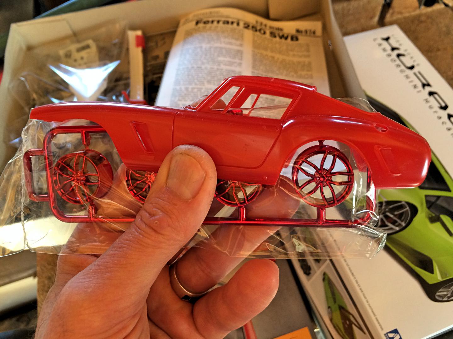

This project constitutes a first for me, or maybe a couple of firsts. After nearly 10 years back into auto modeling this is the first non hot rod/custom/straightline racing subject I have started. It may also be the first Ferrari I've ever done, unless you count a Merit Lancia-Ferrari D50 when I was a kid. I was fairly conscious about what model to pick for my First Cavalino. I had scored a Hasegawa 250 TR incredibly cheaply on eBay by being essentially the only bidder but, frankly, that was way too nice a kit to cut my teeth on. Then one of the dreaded ESCI/ERTL/AMT 250 Berlinetta SWBs popped up for cheap and I thought I'd start with that one. It promised to be less intricate and perhaps would look OK with less finesse than the Testa Rossa.
Building iconic cars that are well known to everyone is not what I normally do. I build hot rods, lakes cars, customs and drag machines strictly from imagination. I'm a hard-core kit basher and I almost never have built a replica. In fact except for a few months as a child I've actually never built an airplane or ship model or gotten into model railroading. So even this relatively straghtforward project is quite a departure for me. My plan is to build a street Gran Turismo Berlinetta as opposed to the Competitizione variant, so it'll have bumpers. One reason for this is because the little vent nacels on the corners of the front valence of a bumperless SWB are not on the ESCI molding and I couldn't figure out how to model them. So bumpers it is. I'll try to detail it as best I can within the limits of my abilities, but you can be sure that it won't be up to the standards I've seen for many a museum-quality full-detail Ferrari build (Alex Kustov for example). So clean and simple but with enough detail to be somewhat convincing will be considered an overwhelming success by this humble hobby builder.
The kit isn't quite the horror-show that many led me to believe. It's got plenty of parts and detail to work with. But I can see the deficiencies in the body shape. I tried to re-contour the areas around the grill opening where they meet up with the ends of the fenders so it didn't look quite so flat faced. It seems to have helped a little. Other than that I cut open the hood and the roof vent but forgot to do the same for the rear fender vents. It's small and dark enough in there that hopefully it won't be noticed. I went with a metallic silver color to emphasize the voluptuous contours of this extraordinary design (the paint is Duplpiocolor Silver over dark gray primer). It happens also to be a classic Gran Turismo color for these cars. I made Italian Tri-colore decal stripes that extend from the grille to the edge of the rear pan. The whole thing is sealed in 4 coats of clear. I'm going to let it harden thoroughly before any polishing.
The kit is engineered so I can set the body aside and install it on the chassis and interior at the very end of final assembly, so now I'll focus on motor, chassis and interior detailing and paint colors. I'm resigned to having to spend real money on decent tires and wheels, too. But I'm no die-hard Ferraristi so I'm sure there will be plenty of mistakes. Nonetheless, I've been around these cars all my life so hopefully I've picked up a few things that will aid me in making a respectable effort. In the meantime here's where I'm at thus far.
