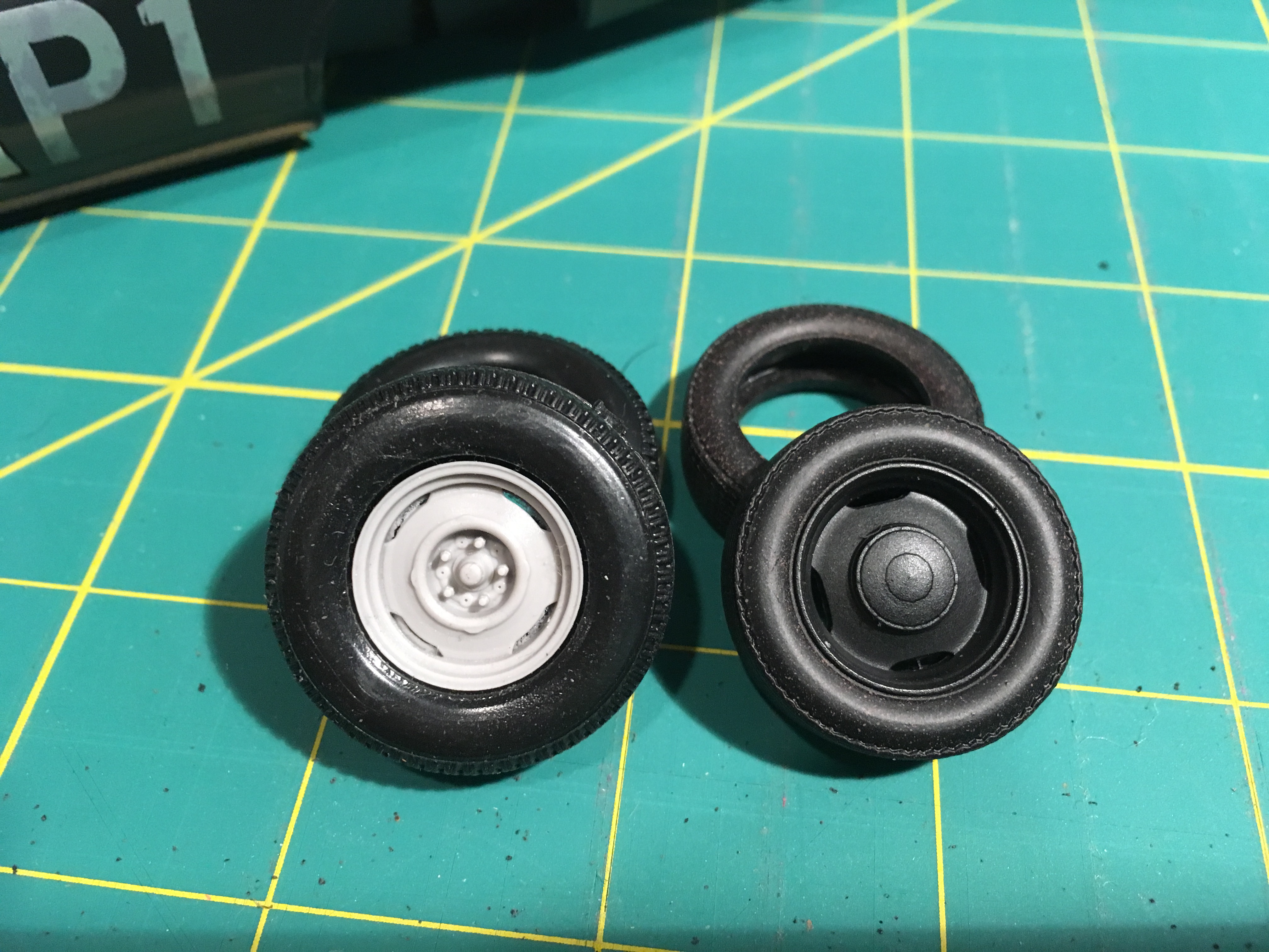

I tried eyeballing a place where I could cut away the wheel face and keep the post for the axle in each wheel back. It seems that if I cut about 2/3 of the way towards the front on the middle retainer ring (I really have no idea what to call these features!), that would do it. I cut back too far on the first one, but got it right on the other three. I used a hand held razor saw, I seem to have the best control that way. You can see the first one laying flat on the bench, and the 2nd attempt as the one with the axle still in it.
Share this post
Link to post
When sawing to the middle of one with the axle still in, the saw hits the axle. What I did here was: I completed my cuts, and twisted the front off of the axle like I would one of the wheels off of the axle, until it was free.
Share this post
Link to post
The next order of business was to remove the tire retainer ring from around the outside of the rear section of the wheel. I used a Drexel cutoff to do that.
After that, I was left with a spindly, weak axle mount. Since this is a fairly heavy diecast, I went to work reinforcing it. First, I added a disc of sheet plastic to the back and glued it in. This also serves to close the gap between the new hub and the new outer wheel. As you can see, I wasn't very neat about it...
Share this post
Link to post
After mocking it up a few times, and thinking it over, I still felt that the new assembly would be too weak, especially the first one that I blew out and had to reconstruct (by gluing the remains of the axle retainer to the new disc I added to the outer hub- but you didn't see me do that!).
I started digging around in my old wheels-and-retainers parts box to see it here was anything I could fit to the inside of the hub, where the brakes would go. I found that with a little trimming, a set of wheelbacks from AMT's '70 Challenger R/T (last seen as the Vanishing Point Challenger) would do well.
Share this post
Link to post
I was still scared that there was some slack due to the gap between the axle retainer and the Challenger hubs. I decided to shim them up with some sheet plastic.
Once I did that, the axle hubs didn't move around at all. It's all sort of off-the-cuff-quick-and-dirty, but I think putting my mind to the problems yielded something that will work out in the end.

Fortunately, I did all that work a few nights ago. Mockup time!!!
Share this post
Link to post
I don't think the pics quite do it justice. Maybe it's my awful photography. Here are a few comparison shots.
Share this post
Link to post
I still want to science the fit of the tires onto the hubs a bit. Also, I want to dry brush and detail the wheels and scuff the tires. Admittedly, it doesn't roll nearly as well as it used to, but then again, I don't really roll models around on my kitchen floor, like I used to when I was little. 😀 Still, I like this model a LOT more now.
Eventually, I want to repaint the interior, make new side windows, and try to weather the body better. This is going to be an ongoing project, but the wheels bothered me the most, so it can rest for now.

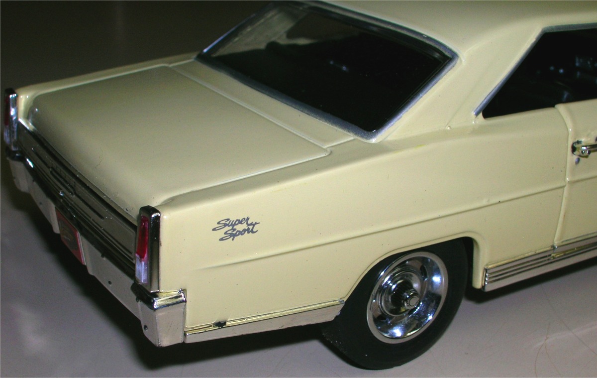

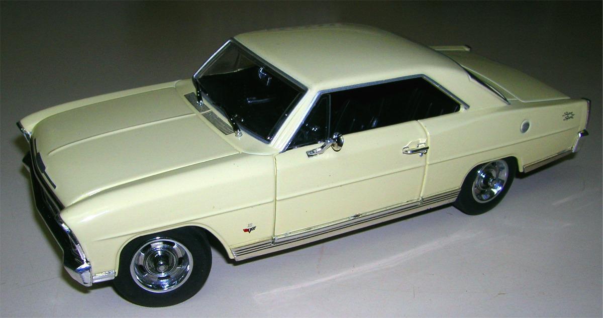

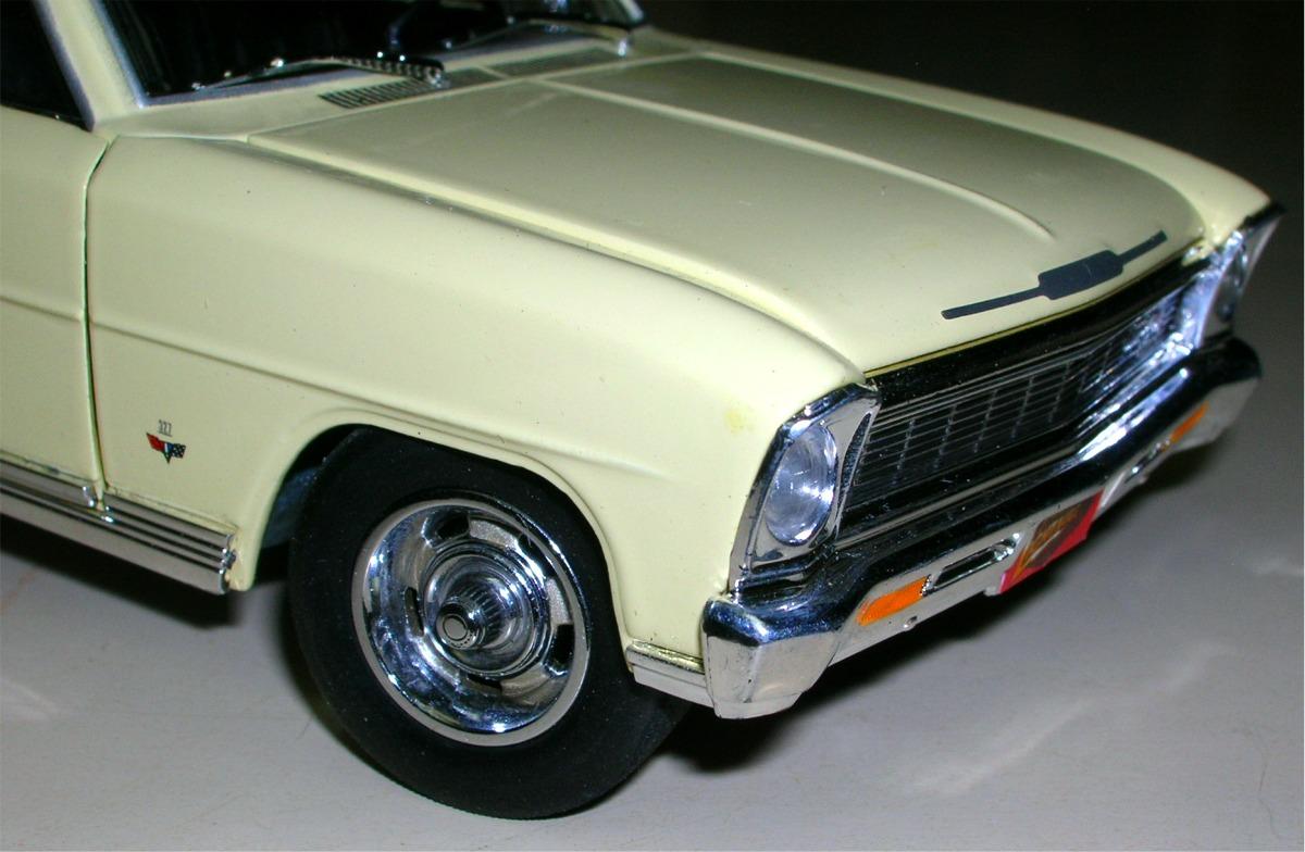

Absolutely!
Here's a Johnny Lightning '66 Chevy II in Butternut Yellow that I "tuned up" with a set of Danbury Mint Corvette wheels and tires.
Share this post
